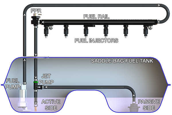

Dude that is awesome! Thank you. It replaces the jet valve that is already there. What people do is drill out the oem one to achieve the siphoning. Just seeing this kinda answers the question of whether or not I should drill mine out. So I think I will drill it out larger right off the bat. Info online and guys on Supraforums have said it will need drilled out. I was going to just give it a try leaving it alone first. But seeing that this even made really lets you know that it needs to be done. I'll try just modifying mine. But at least I'll know I can order this if it doesn't work.

Just found one offered from Radium too. So looks like there are options. I think drilling the oem one out larger does the trick though.

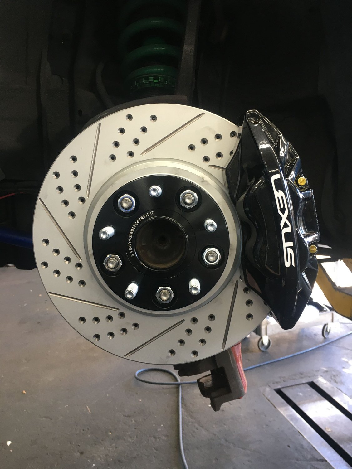

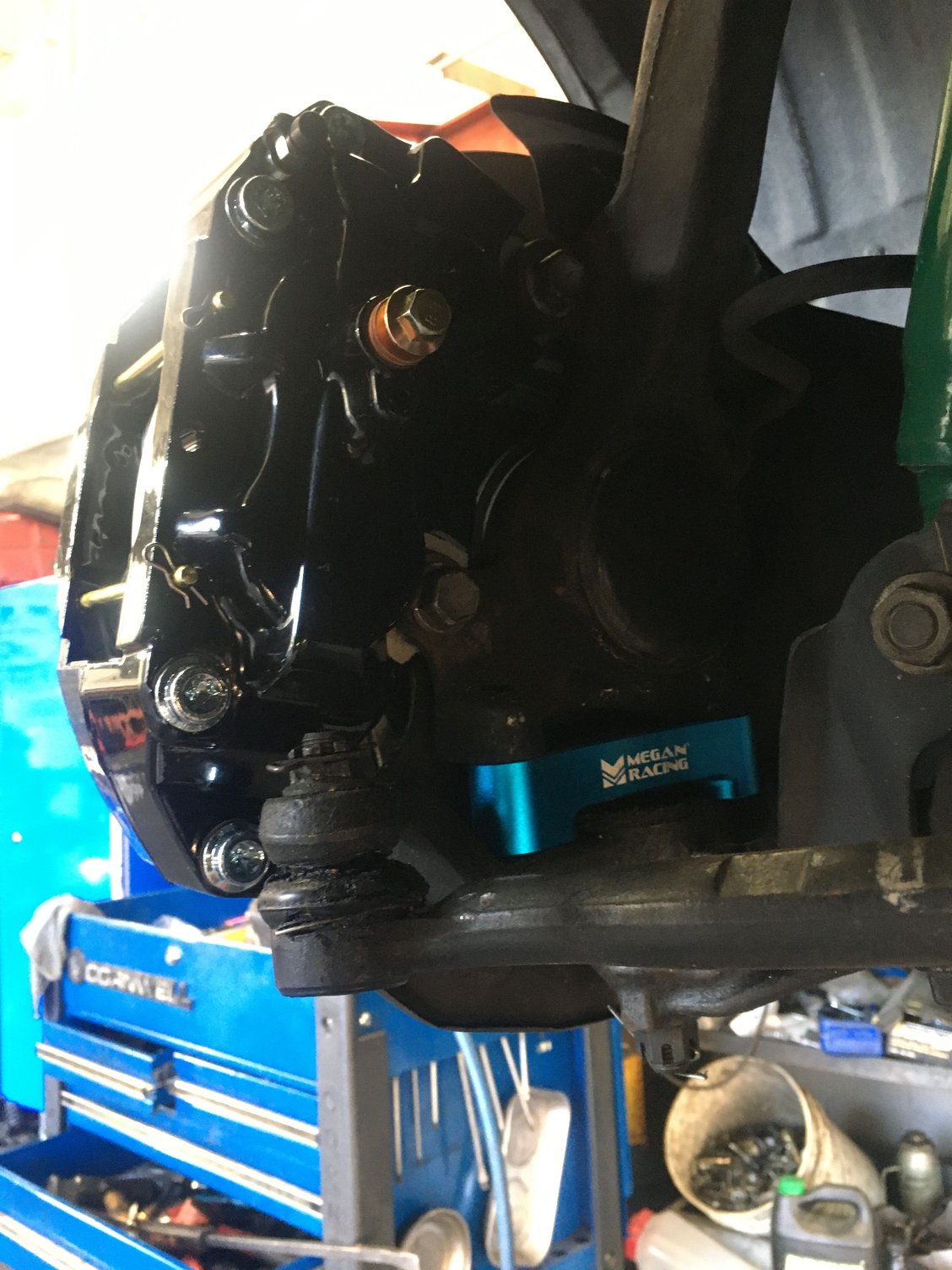

Got the LS400 brake setup installed. Pretty easy with the rca’s. 20mm rca’s and 20mm hub centric spacers. SS brake lines were the hardest part just because the old line fittings.

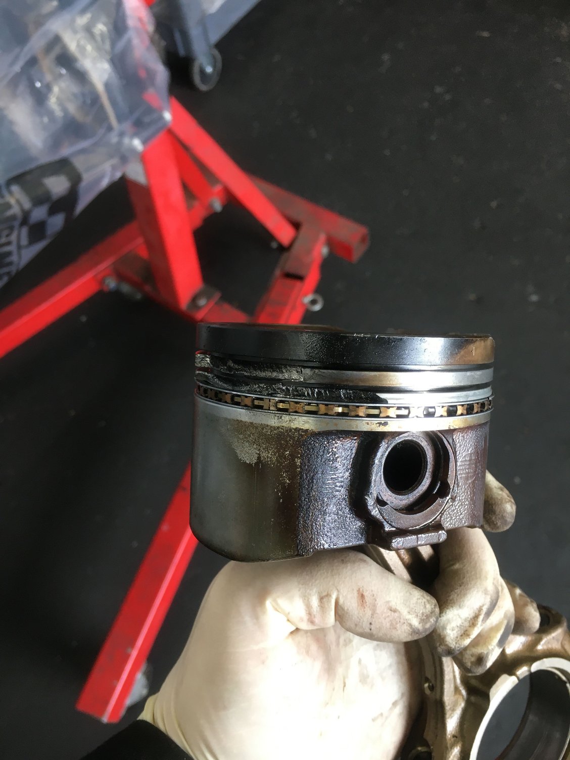

Finally got my engine back! Will be working on going back together shortly. Here’s what failed on me. Blew the ring land on cyl 1 piston.

New shiny engine! Looking forward to seeing the progress on the installation. I like the brakes. Did you have them powder coated or are they like that stock? Look great. Without the RCAs do you think you'd have trouble fitting the calipers?

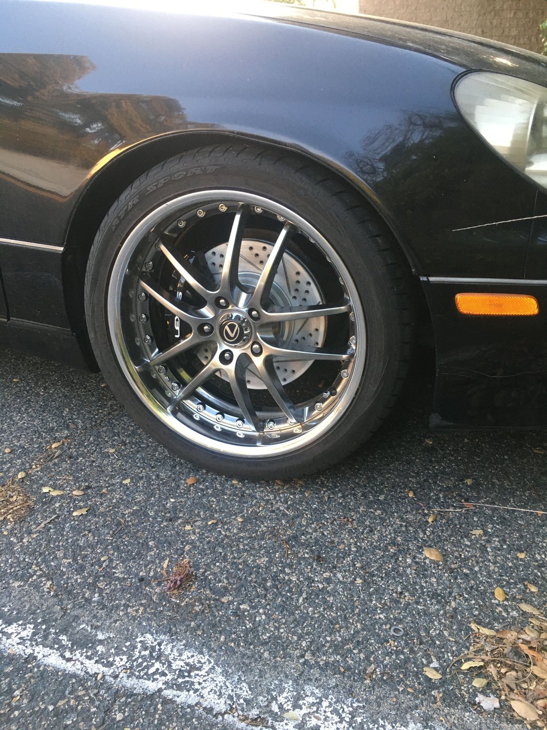

How do you like those Achilles tires?
I just got a set and they are making my Lexus ride like an old Volkswagen.

The calipers came power-coated black. Check out R1Concepts. They weren't even advertised with paint, just came nice and for the price of just cheap re-mans. Got lucky. They look great. I didn't want to hack anything, so I did the RCA's just to be safe. Looks like they are necessary. I would do them if I were you. Coilovers can be adjusted to make up for the drop if needed.

Dude these tires suck, they were just the cheapest 19" tires I could get at the time. Definitely noisy.

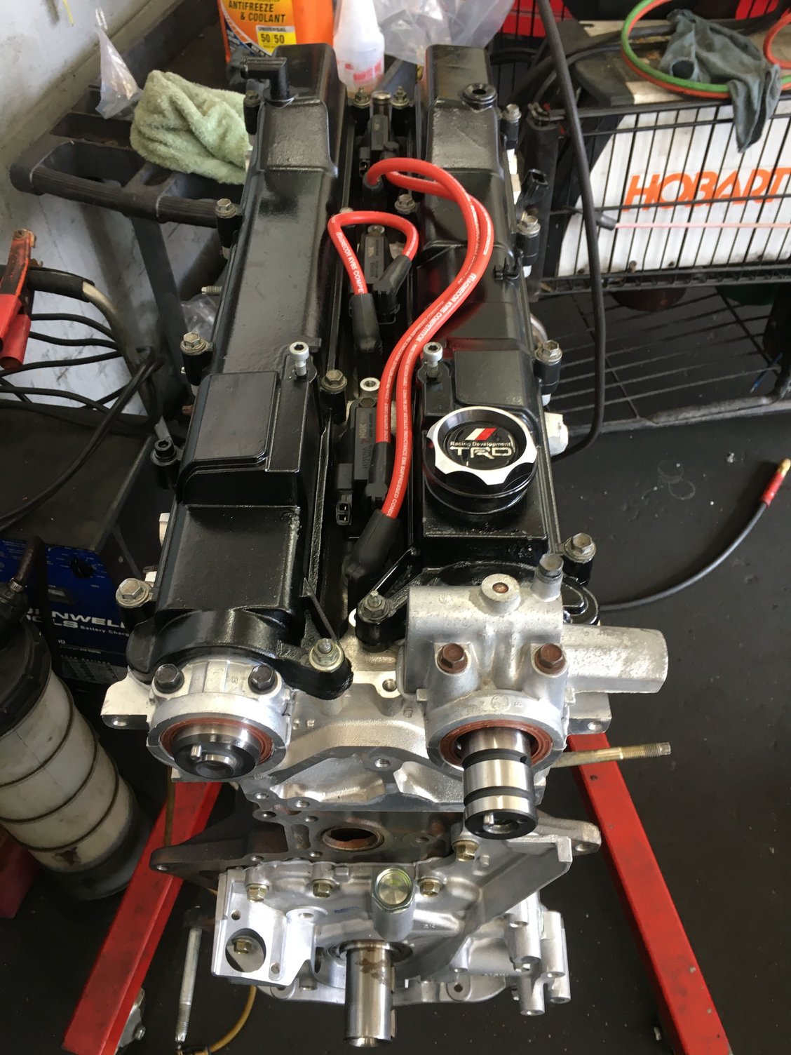

Found myself putting parts on between cars at work. Will have this thing back together in no time! Painted the cam covers black for a cleaner look. Those are Magnacore 8.5mm wires. NGK heat range 7 plugs for the boost goals this time around.
