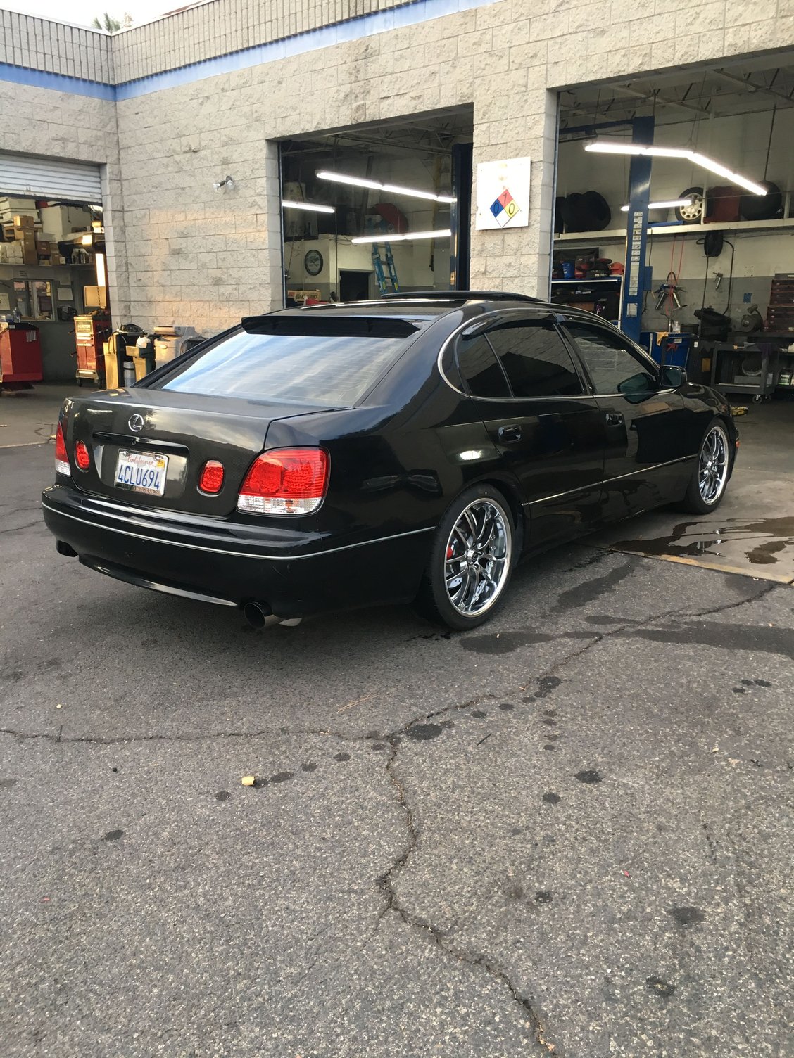

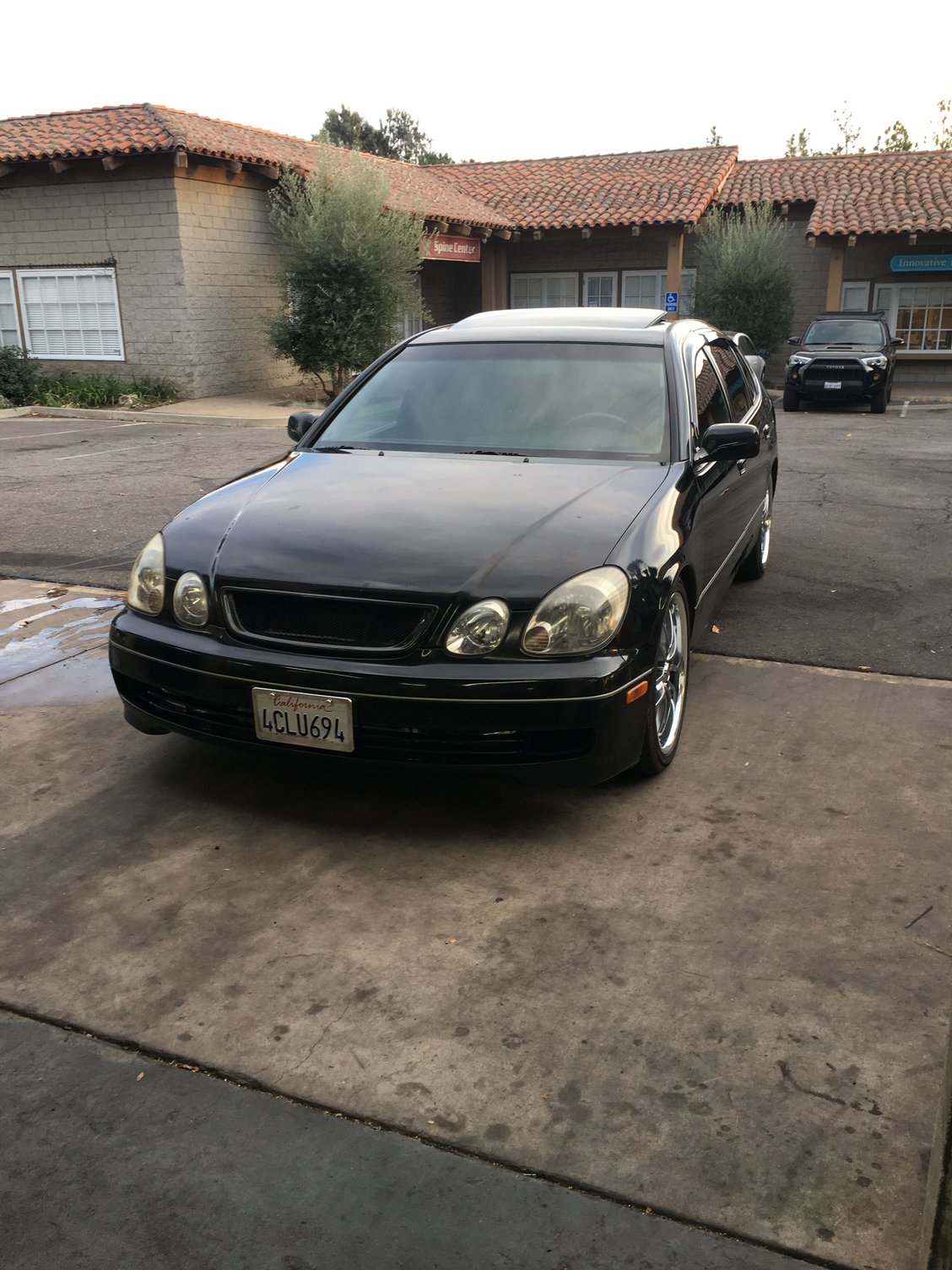

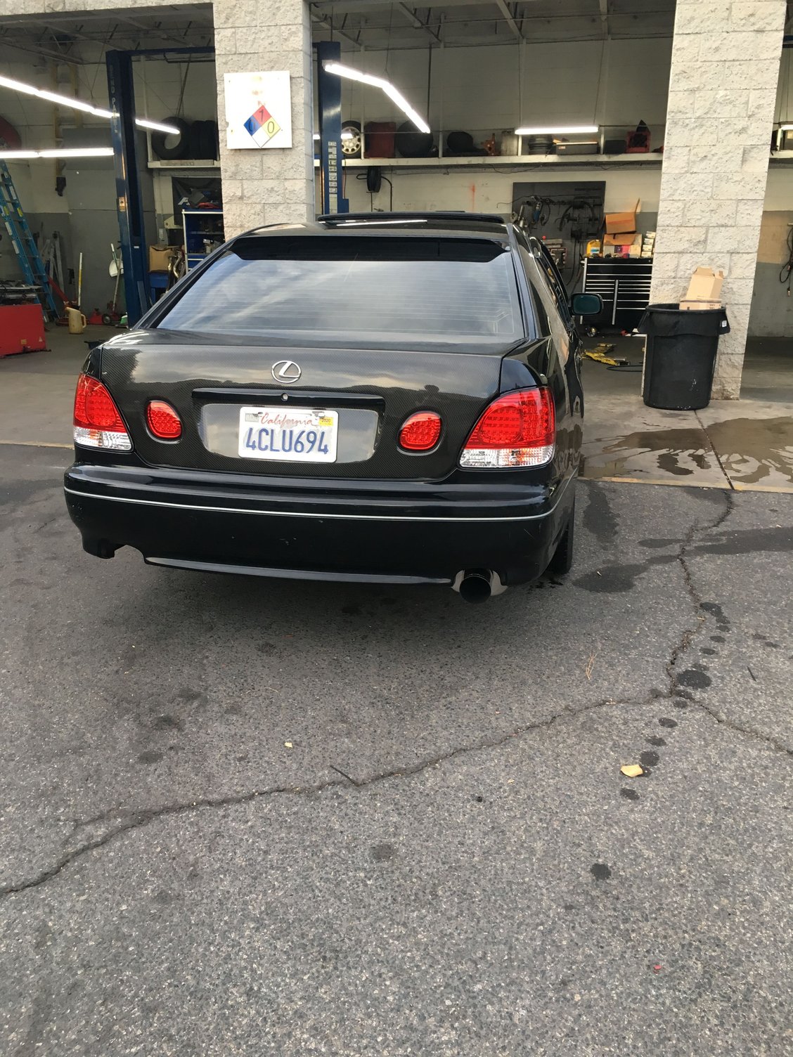

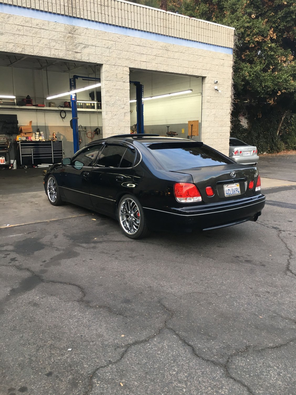

Well I had time today to get everything installed. The pulleys were a cinch. Cleaned it up and took some pics. Never posted one with my Seibon grille yet, so here it is too along with the new LED tail lights.

Nice grill. A red pinstripe on thd border?? Dont scoff at it. Might look good 😁

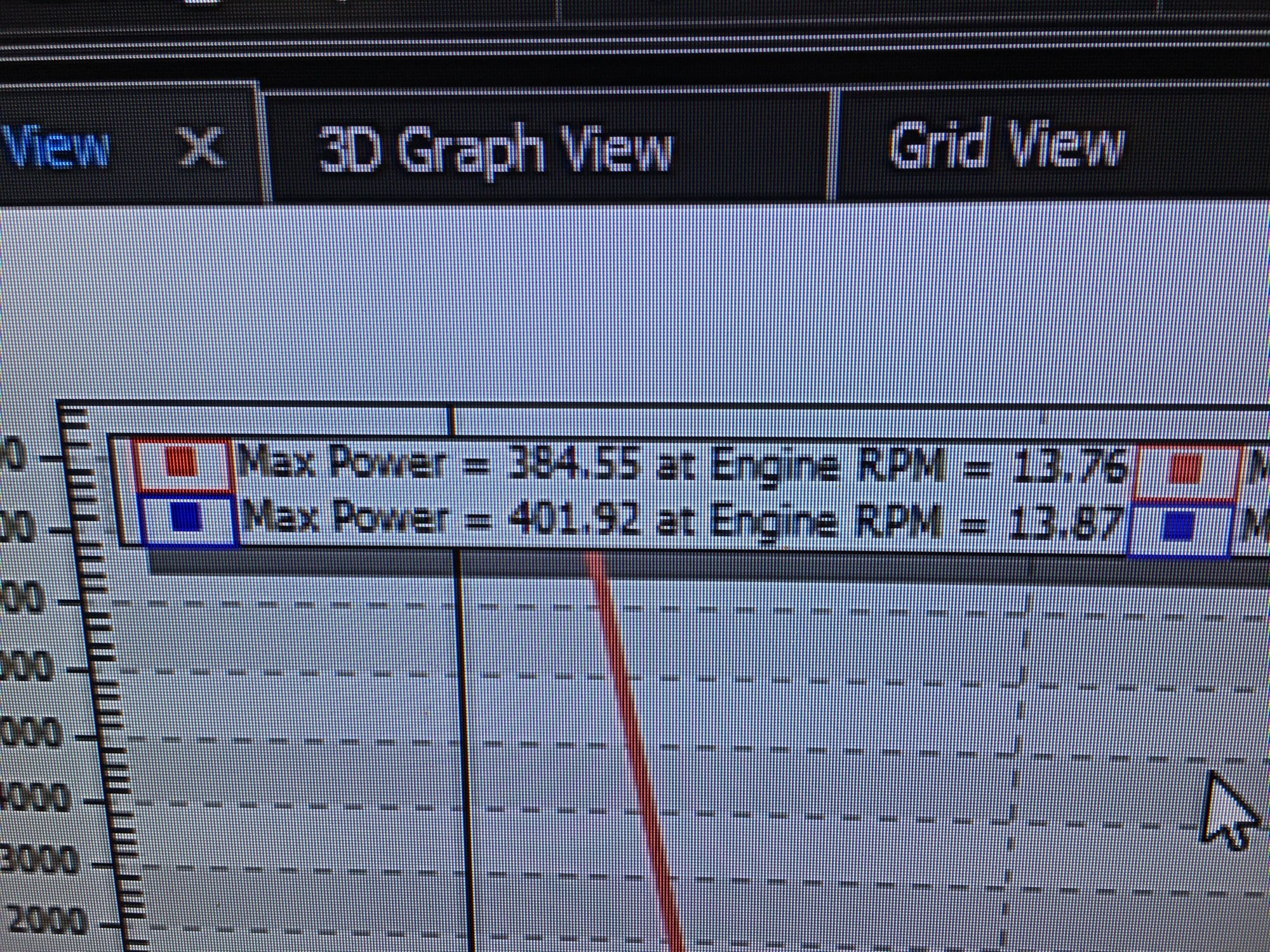

Got the car tuned and dynoed today. AEM infinity’s are incredible. 400whp 363 was the torque. I didn’t even want to make that much power! Worried about the transmission now. But wow those are some good numbers.
