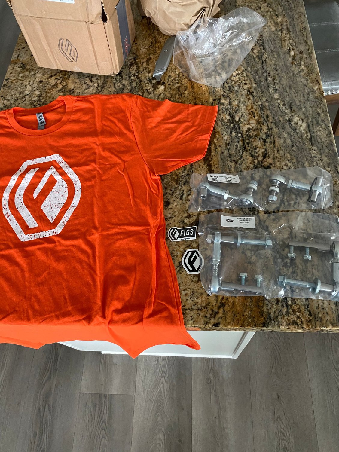

Some fast shipping, they must be amped up for Christmas. Already received the coilovers and links. Nice of Figs to throw in a t-shirt.
Old Dec 11, 2024 | 04:26 PM
  #342
Answer300's Avatar
Answer300
Joined: Sep 2005
Posts: 1,455
Likes: 122
From: Tennessee
How much were the links!?
Old Dec 12, 2024 | 04:39 AM
  #343
TrueGS300's Avatar
TrueGS300
Joined: Nov 2018
Posts: 2,077
Likes: 576
$380 with tax/shipping. Pretty crazy for what they are. But the car has a very different design than typical links, so no universal sets work for us.
Old Dec 12, 2024 | 05:50 AM
  #344
Answer300's Avatar
Answer300
Joined: Sep 2005
Posts: 1,455
Likes: 122
From: Tennessee
Yea but it’s worth it to keep the geometry, steering and angles in check. I had looked at these before and considering how much OEM is, I’ll probably go ahead and pull the trigger on em
Old Dec 12, 2024 | 04:42 PM
  #345
TrueGS300's Avatar
TrueGS300
Joined: Nov 2018
Posts: 2,077
Likes: 576
That's where my mind is at. At this point it's all that's left to dial in. It is more important than ever to keep the car glued to the road. Could be the difference between a safe drive or totaled car, or worse life and death.
