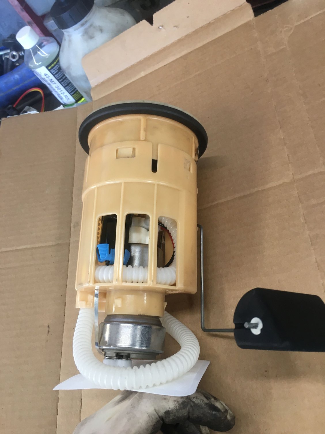

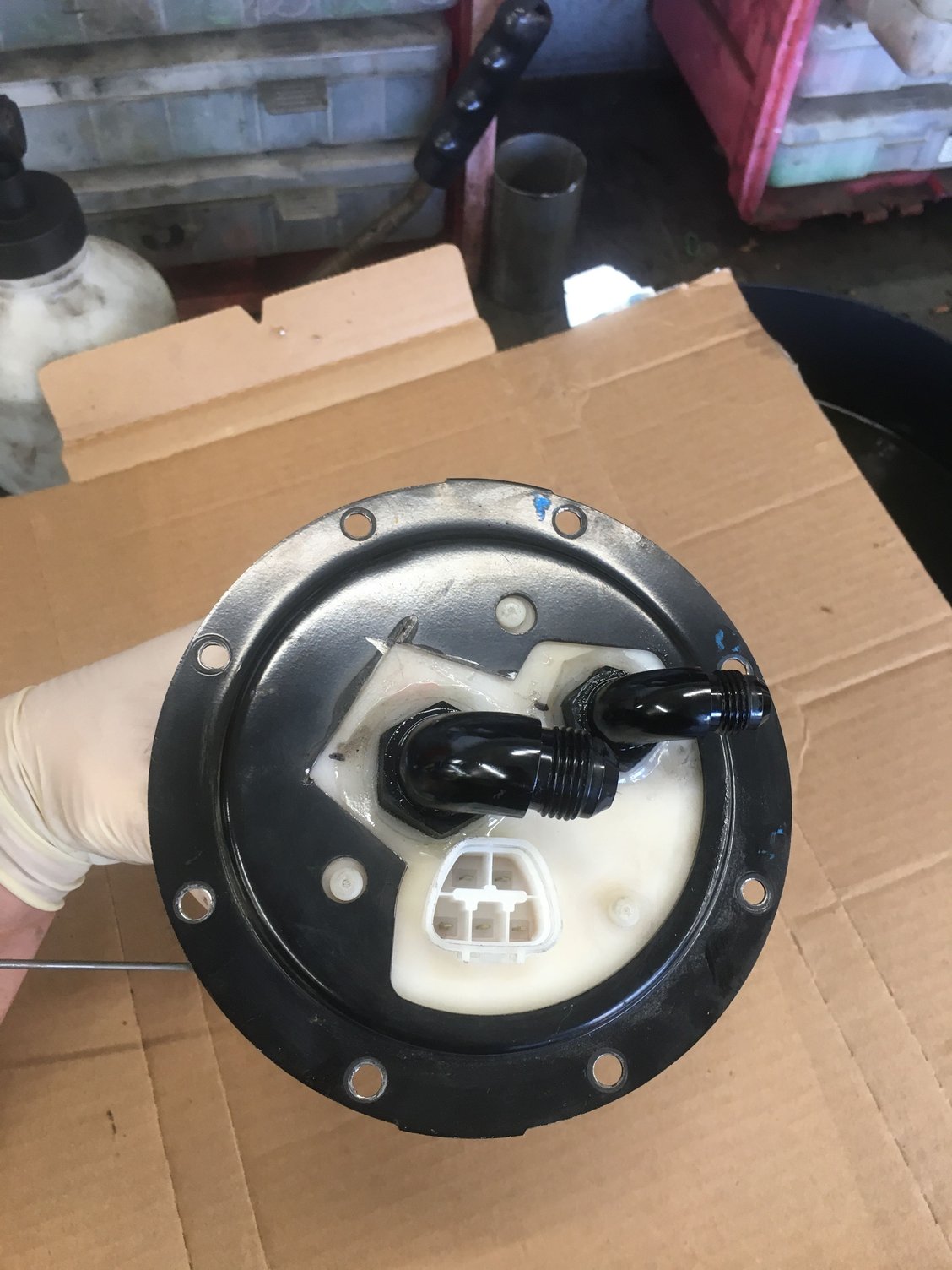

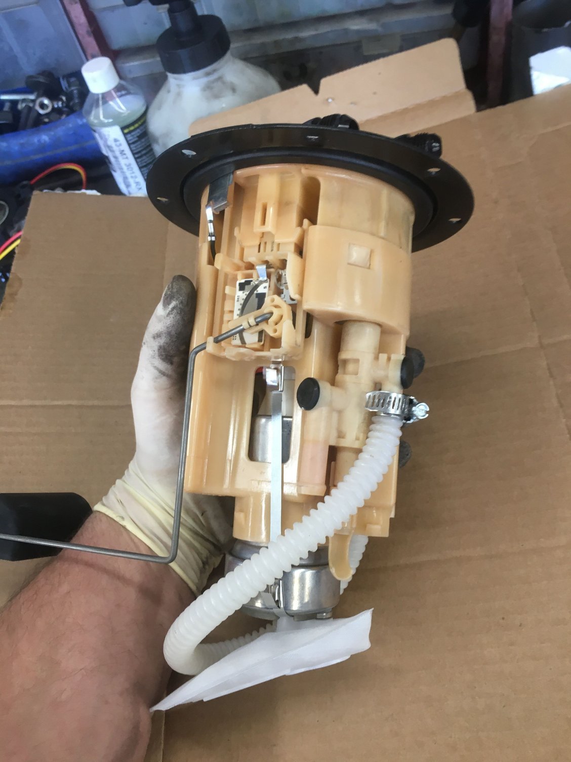

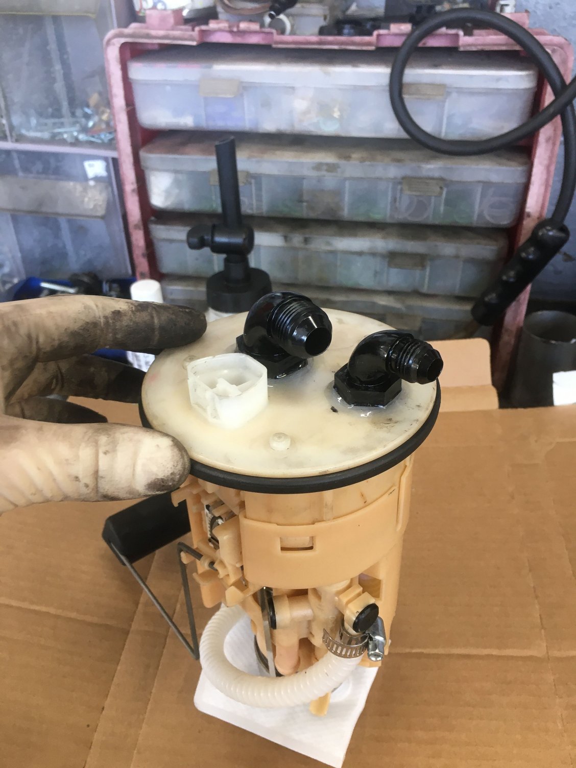

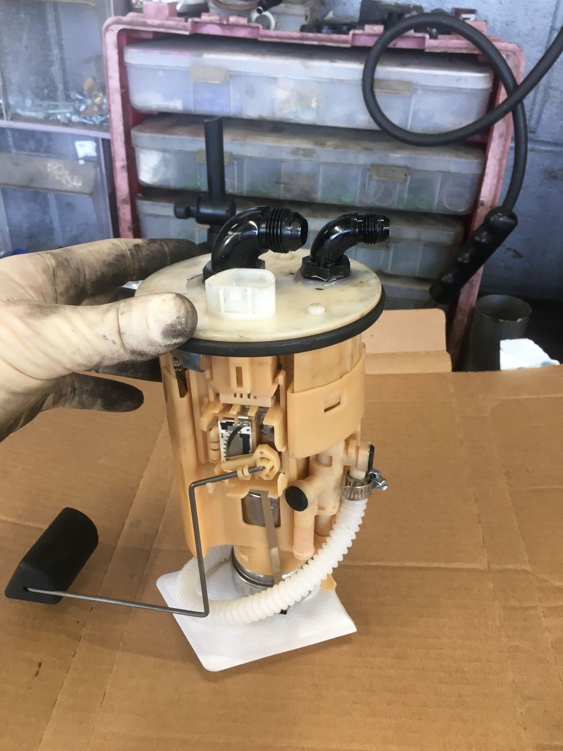

Continuing on my path to a one shot re-build and upgrade I've got my fuel system pretty much worked out. Just will need to cut and place fittings on the individual line lengths as I install. It will be a -8AN feed line and -6AN return, and all will be e85 rated just in case I ever go that route. So far I got a Walbro 525lph in tank pump to custom into the stock hanger. The -6AN and -8AN bulkhead 90 degree fittings to go in and out of the hanger, an in-line external filter (Radium) continuing with -8AN line to my -8AN rail (Radium), a Fuelab FPR and gauge (Radium) that installs on it, and upgraded to Bosch 1150cc injectors. All parts are Radium other than the FPR because Radium makes theirs unnecessarily complicated with several blocking adapters needed to run a simple line in and line out setup. All the lines are universal PTFE stainless steel. No barbs and clamps, all proper -AN type fittings to screw together securely. Other than that it's customing the hanger for the pump and return line. Doing the math and using several injector calculators, this will be a 800whp safe fuel system at 80-85% duty cycle.

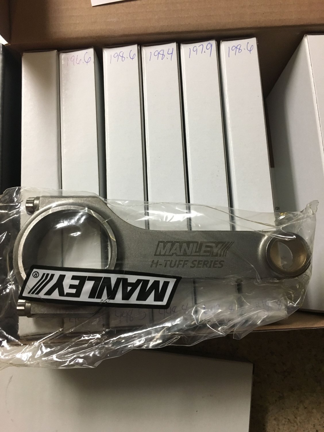

Been planning my engine build. Unless someone has any reasons why it's a poor plan, here's what I'm planning. The pistons will be JE in a GTE spec dish. The rods, Manley H-beams in stock dimensions. And the HG the oem GE thin gasket in order to maintain a proper quench. Been going over this with the guys on Supra-forums. The GTE gasket is too thick. And the pistons get the ratio down to 9.5:1 or a little less. Today's trend is to go higher compression with good tuning rather than way down in the 8.5:1 range the GTE came at. This should make for a snappy response and the ability to go into the 20psi range.

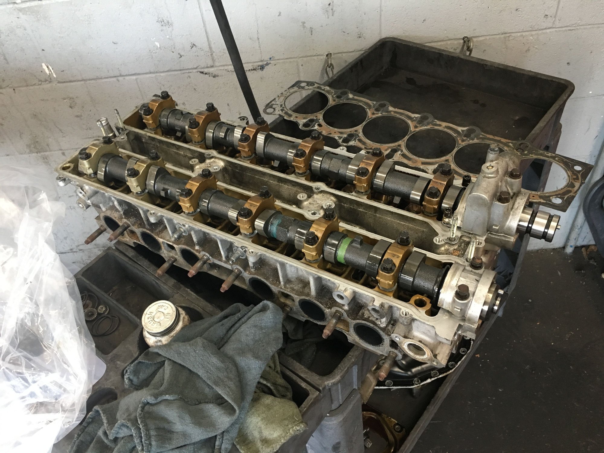

Tore down the engine today. Block and head being sent out for checks and possible machining tomorrow. Making good progress.

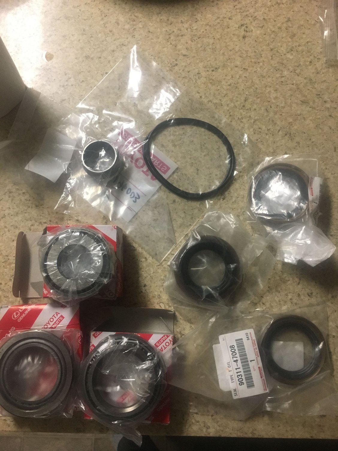

Damn that’s a lot. But I guess that’s if you don’t provide the parts? I got the rebuild kit from Driftmotion. All Toyota original. Might look into it.

Thanks. Ya it's going quick now. The car just sat for a while. Taking my diff in tomorrow for the LSD install, the trans is on the way, converter is here, and engine is at the machine shop. Already have some 1,200whp rated Manley H-tuff rods on the way. Waiting to hear if I need oversize pistons or not. Have a complete fuel system revamp to do too. 525lph pump, 8an feed, fpr with 6an return, 1200cc injectors etc.

I can’t find their kit. Can you post a link? I don’t see how it can be more complete since this one has every bearing and seal in the diff.. but I’m sure it’s a complete set like this one. This one is 100% Toyota OEM parts too. Not sure what theirs is.

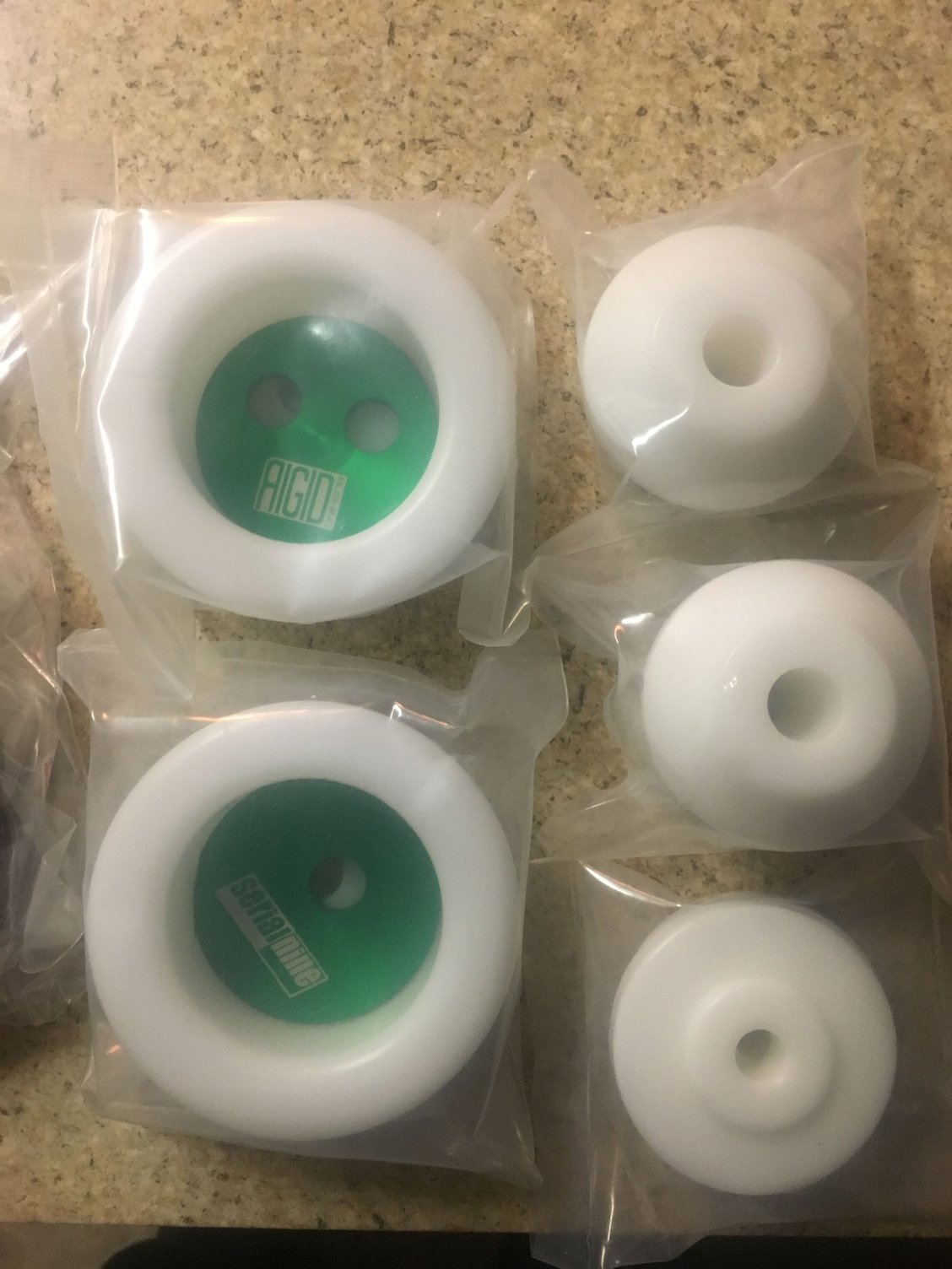

Got the diff bushing/mount kit in from Serialnine. Have everything for the diff now.
