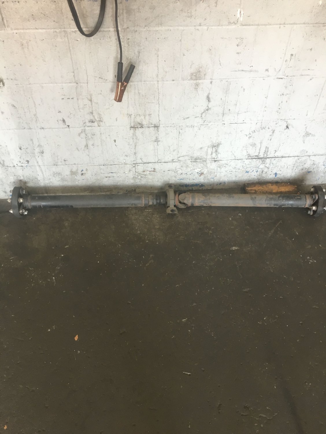

Finally had a free day to get going on this big project. Took the day to pull the engine, trans, and diff. All will be worked/replaced. I started with the driveshaft so I could measure for a one piece and get it ordered for reinstall. For anyone interested I measured 57.5" exactly from the 3 bolt flanges on the trans and diff. The cost to replace the rubber couplers and center support bearing and the work involved for pressing etc. makes the cost of a one piece shaft not bad at all. Plus I don't believe the old stocker will hold up to my power goals. Going with an aluminum one piece from Driftmotion. Best kind of weight reduction and way better torque transfer.
Driveshaft:

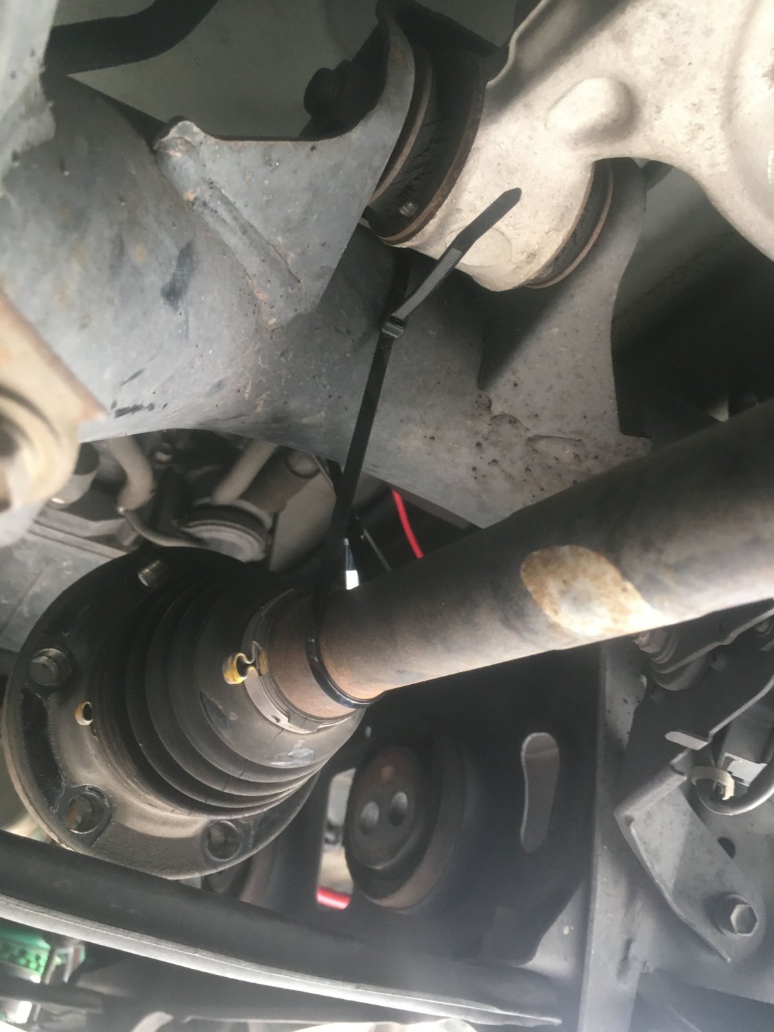

Here I wanted to show how you can support the CV axles with zip ties so they turn in the air rather than the boot against the sub-frame and get torn when pushing the vehicle in and out of the shop.

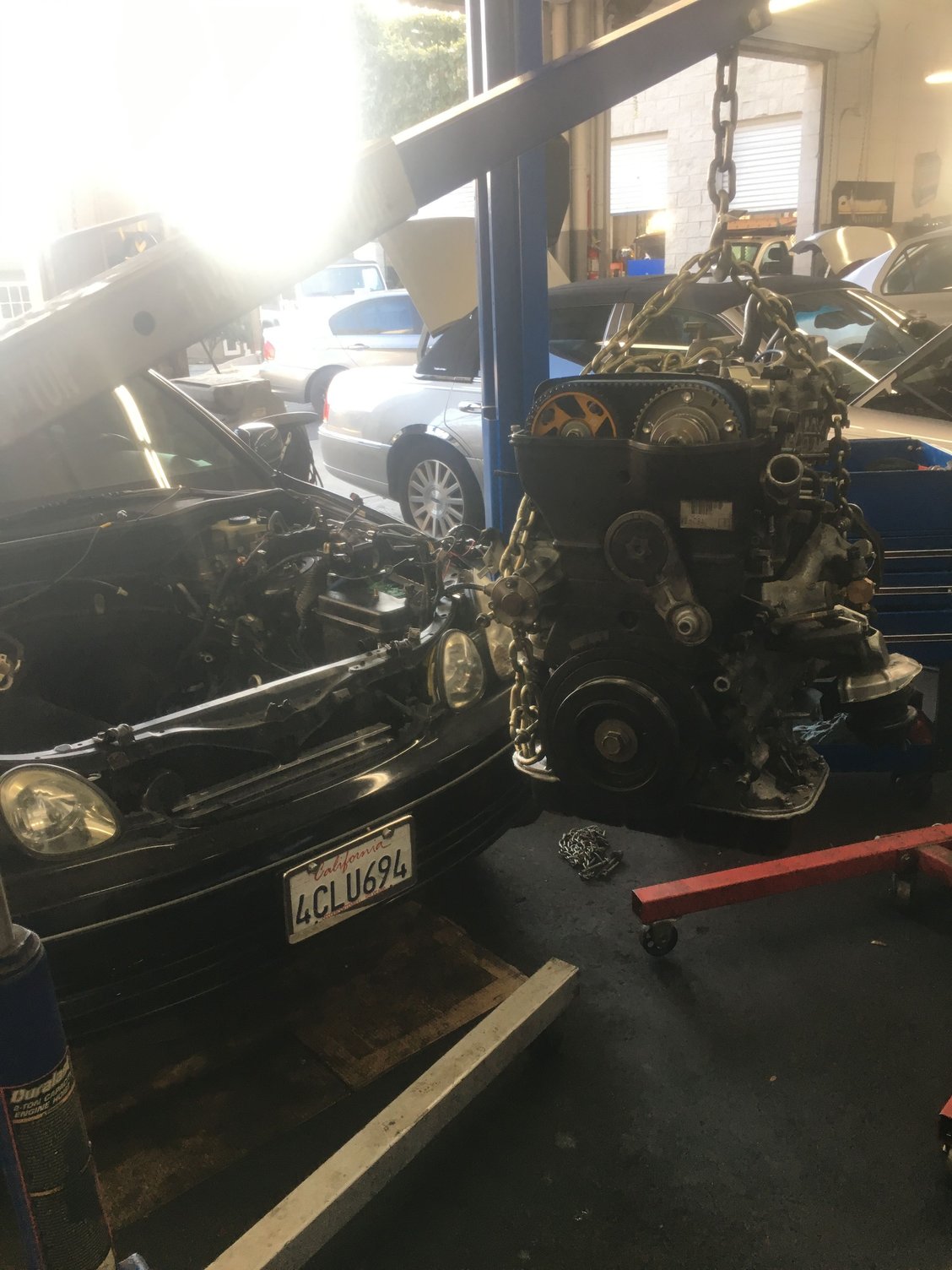

After those went so quick I just stared tearing on the engine and before I knew it, it was ready to pull.
You have to remove the hood to get the engine out.

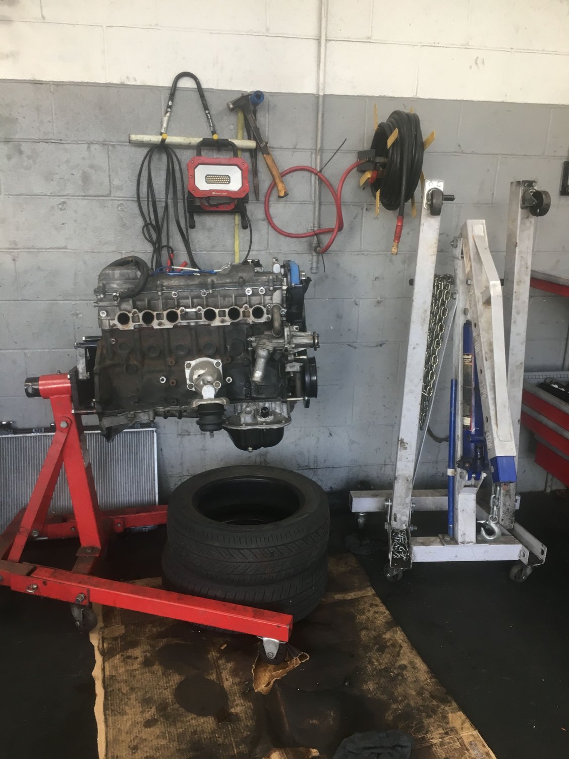

On the stand and ready for the next phase of tear down.
I have a fully built trans on the way, the diff is getting a full bearing/seal replacement with the LSD install and I"m thinking about a cryo treatment for the ring and pinion. The engine is going out for inspection once I get it torn down. Then a full rebuild/forged internals. More updates to come.
