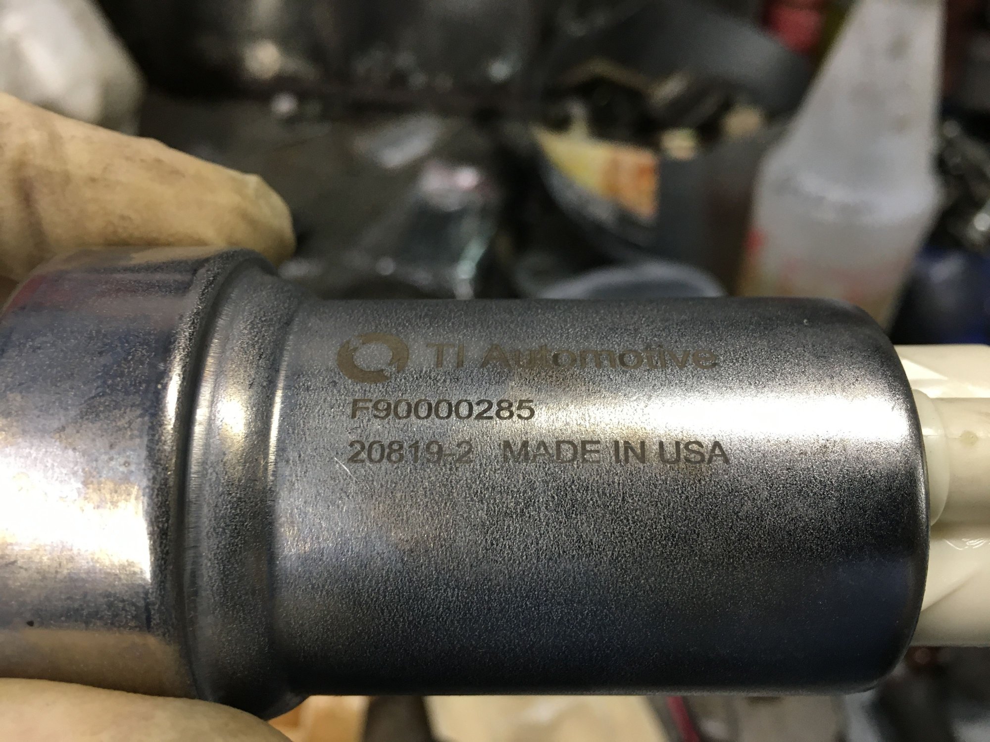

Big fan of Radium as well. I am running several of their fuel system parts. Ya I plan to modify my dual hanger into two separate singles and trigger the 2nd pump off my AEM Infinity ECU when tuning time comes. I'll just have a spare harness for something else someday.

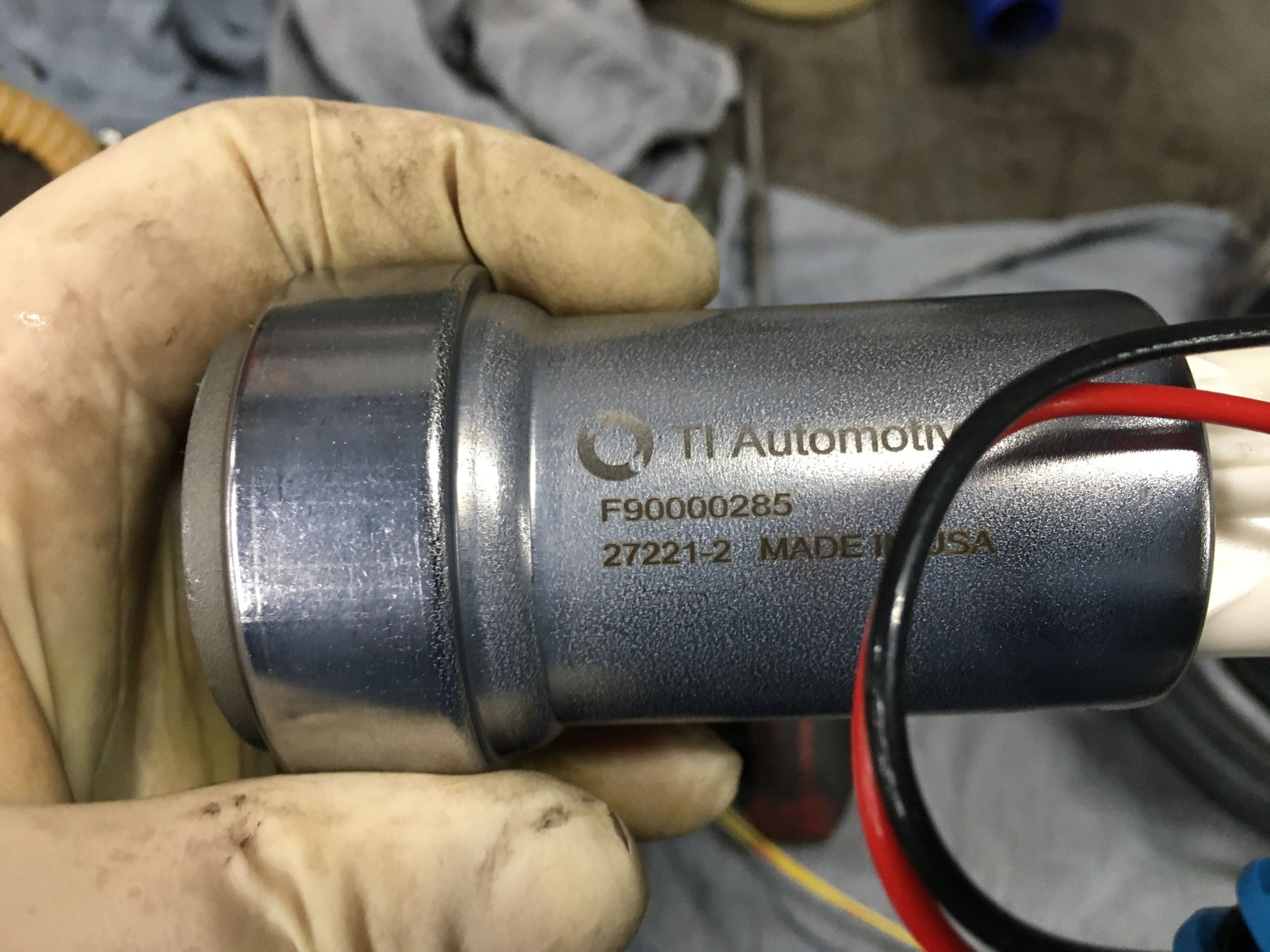

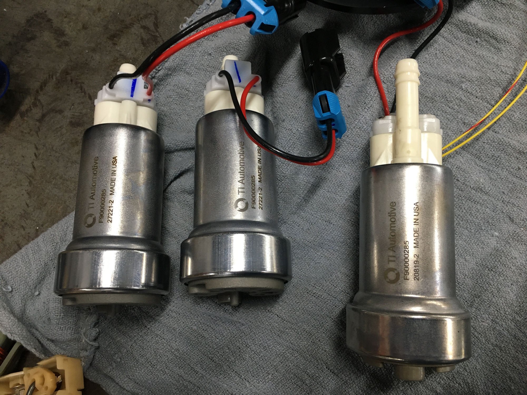

What do you think of these pump comparisons? You can see some differences in the one I had before (which I think is a knock off). First, there is a different number on it, Second, the real ones have numbers on the side where the wires come out, and on the knock off it's on the fuel outlet side. And third, from the bottom there is a totally different design in the metal.
I got the first one from a company I really like and have got great stuff from called DriftMotion. But I'm wondering if I should light them up about this or just cut my losses. It's possible TI/Walbro just changed the pump design..

For reference, here are my two pumps. The single pump pics are of my 295 (same as your 285, but no check valve) and the other came from PHR - 485 or whatever - I forget. Slightly less flow but with a check valve. I can see a difference in the pickup end of the pump that you suspect as a counterfeit. Can't know for sure though - maybe it was a change in manufacturing, etc. Regardless, for about $150 it's money well spent to be sure you have an authentic one.

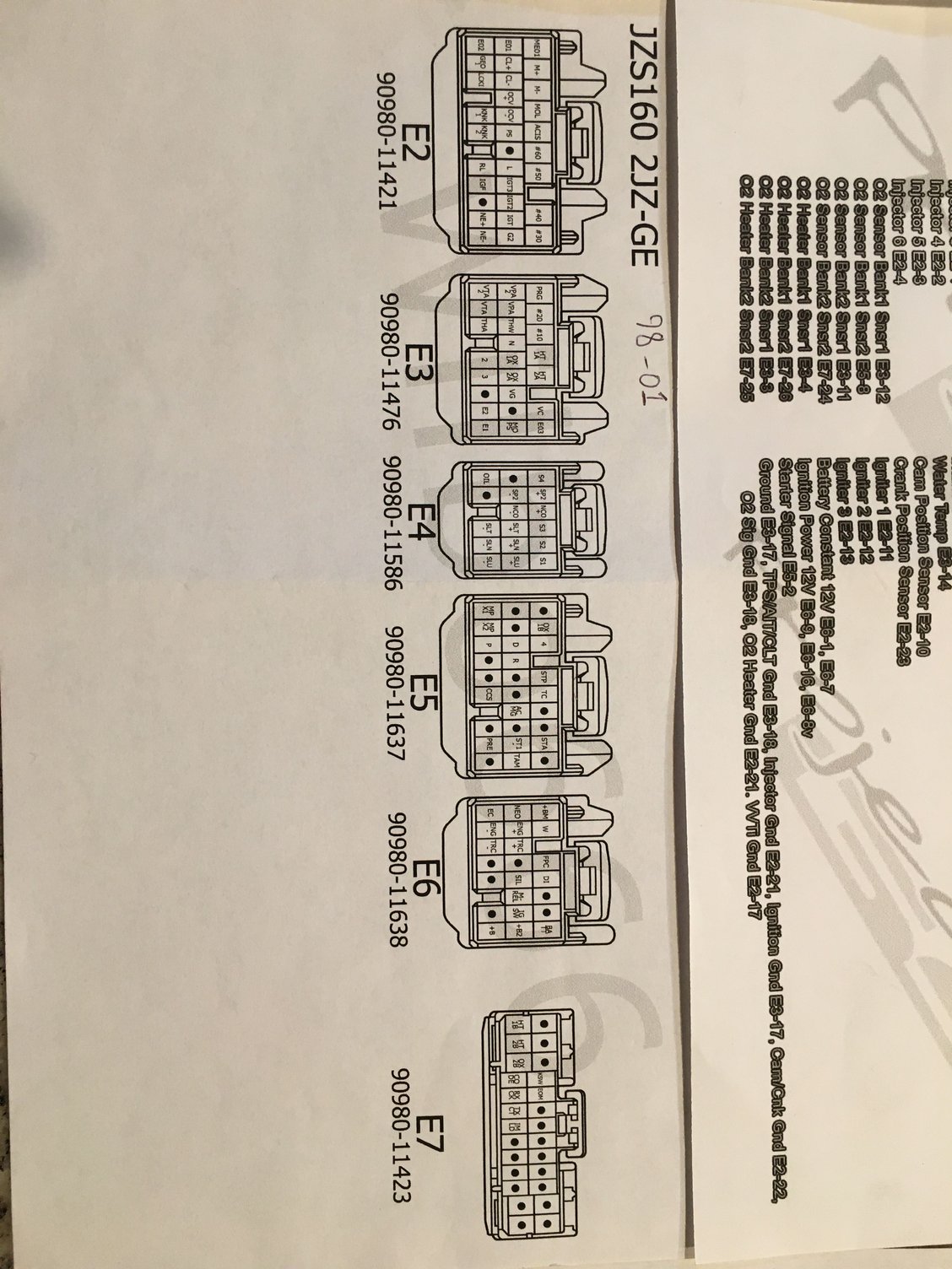

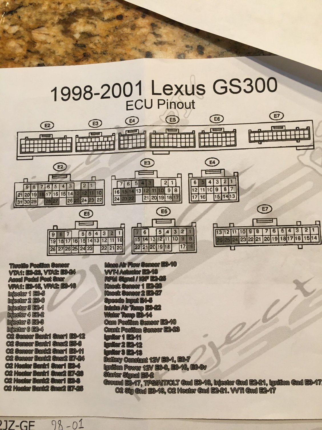

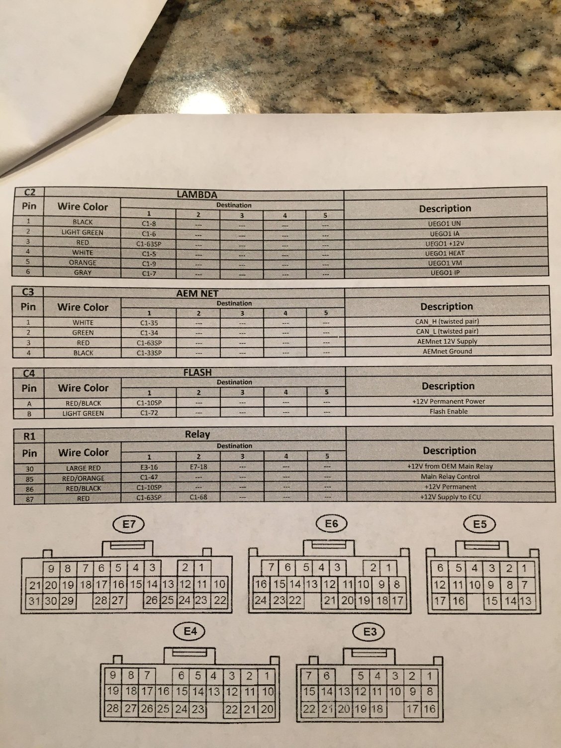

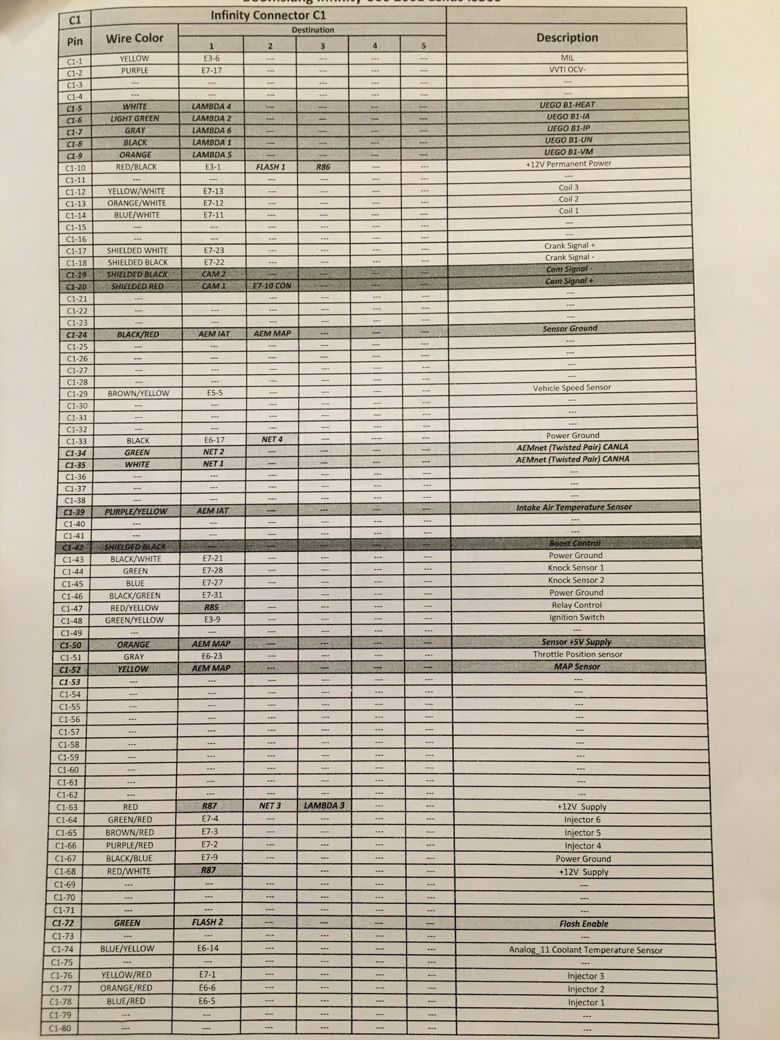

I’ve finally got it! The P&P harness has been the issue this whole time. I should have known when I had to pin for a EBC and try to pin for vvt. It is pinned for it, but in the wrong place. Look at this:
Here are the diagrams for my car’s ECU. And look at the ones Boomslang used for their pins.
Here is the rest of the Boomslang harness pins
If you look at the VVT OCV for example. It is in connector E2 #18. But in the harness it is pinned to E7-17. So my problem has been trusting this harness all along. I will have to find all the inputs that are incorrect and move them to the proper locations. I’m pretty sure this is the final answer on what’s been going on!
