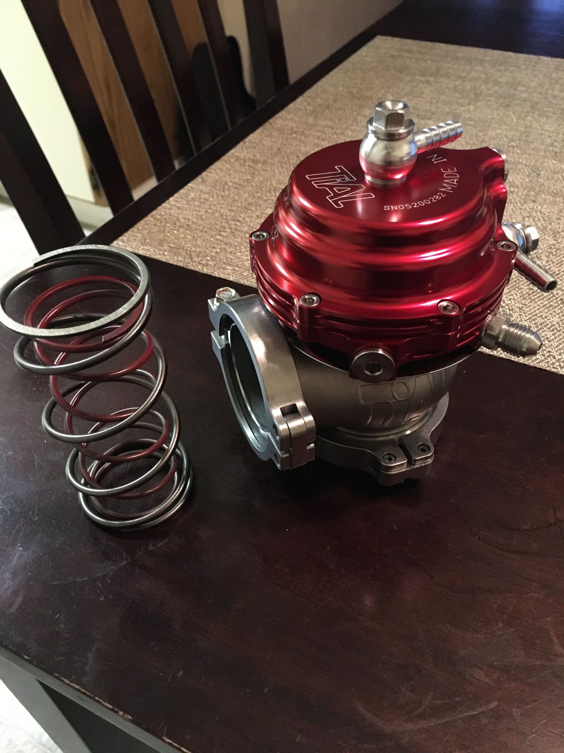

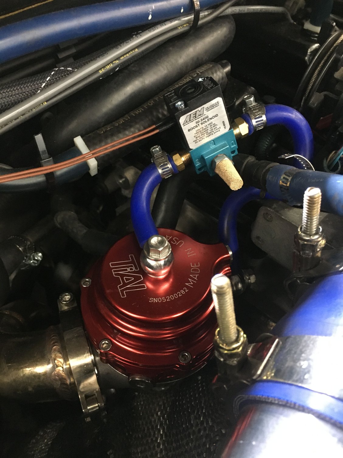

Received the TiAL MVR 44 and selected the right springs for 10.15 psi (the black and red in this case). Very high quality parts. Hoping to get it installed this week if time permits. Will be looking forward to actually being able to go into boost!
Quality wins everytime bro! Keep the updates coming in!

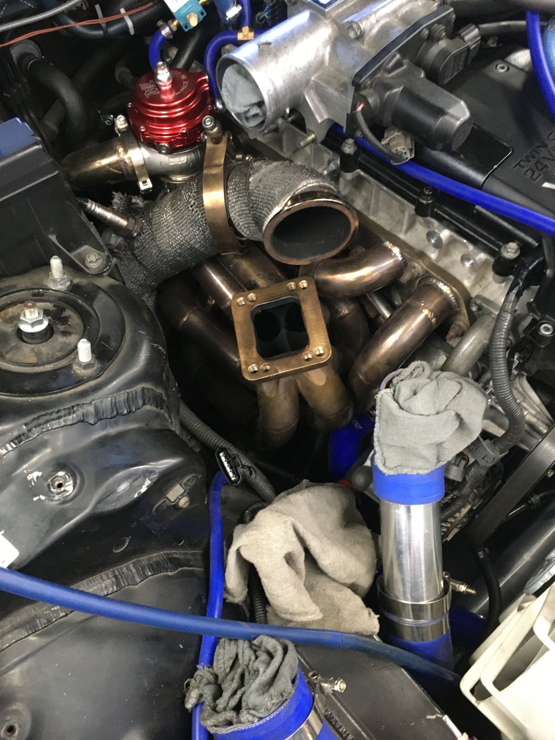

Purty. I see you installed the water ports. Are you indeed going to use them?
Old Jul 16, 2020 | 09:11 PM
  #213
TrueGS300's Avatar
TrueGS300
Joined: Nov 2018
Posts: 2,077
Likes: 576
No I don't plan to for now. They are supposed to be for extreme racing applications. I don't want to make a coolant mess right now and have more potential leaks. I don't plan to have any kind of road racing or circle track abuse going on either. But maybe in the future; just doesn't seem necessary for now.

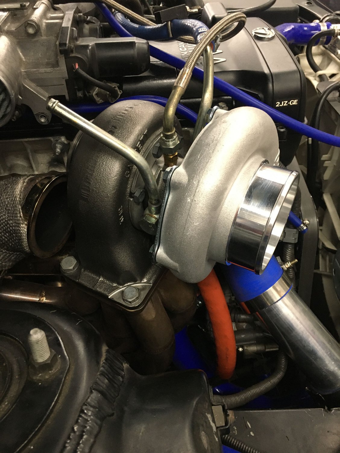

Made a big decision to really step up my build so I can stop having issues in the future. In addition to the Tial waste gate upgrade, I'm also installing a Tial Q BOV. And to make my power goal of 800whp, I am upgrading the turbo to a quality Garrett in a very nice late model design. The GTX3582R Gen2 with a .82 A/R. This will replace my .68 A/R CXRacing knock off of the old style GT3582R. The GTX is much better in every way and with the .82 turbine, I think I'll have a very quick turbo that can meet my 800whp goal. It will also pretty much plu and play to my existing set up. On top of that I installed an AEM electronic boost controller too. So things should be looking good for my performance goals.
I am also looking into PHR's dual/triple pump hanger so I don't FML by chancing any fuel starvation issues. I need to run good quality parts and very sufficient systems to protect my fresh engine build. No more cheap parts and hacked together fuel hanger lol. All expensive stuff. Wish me luck!

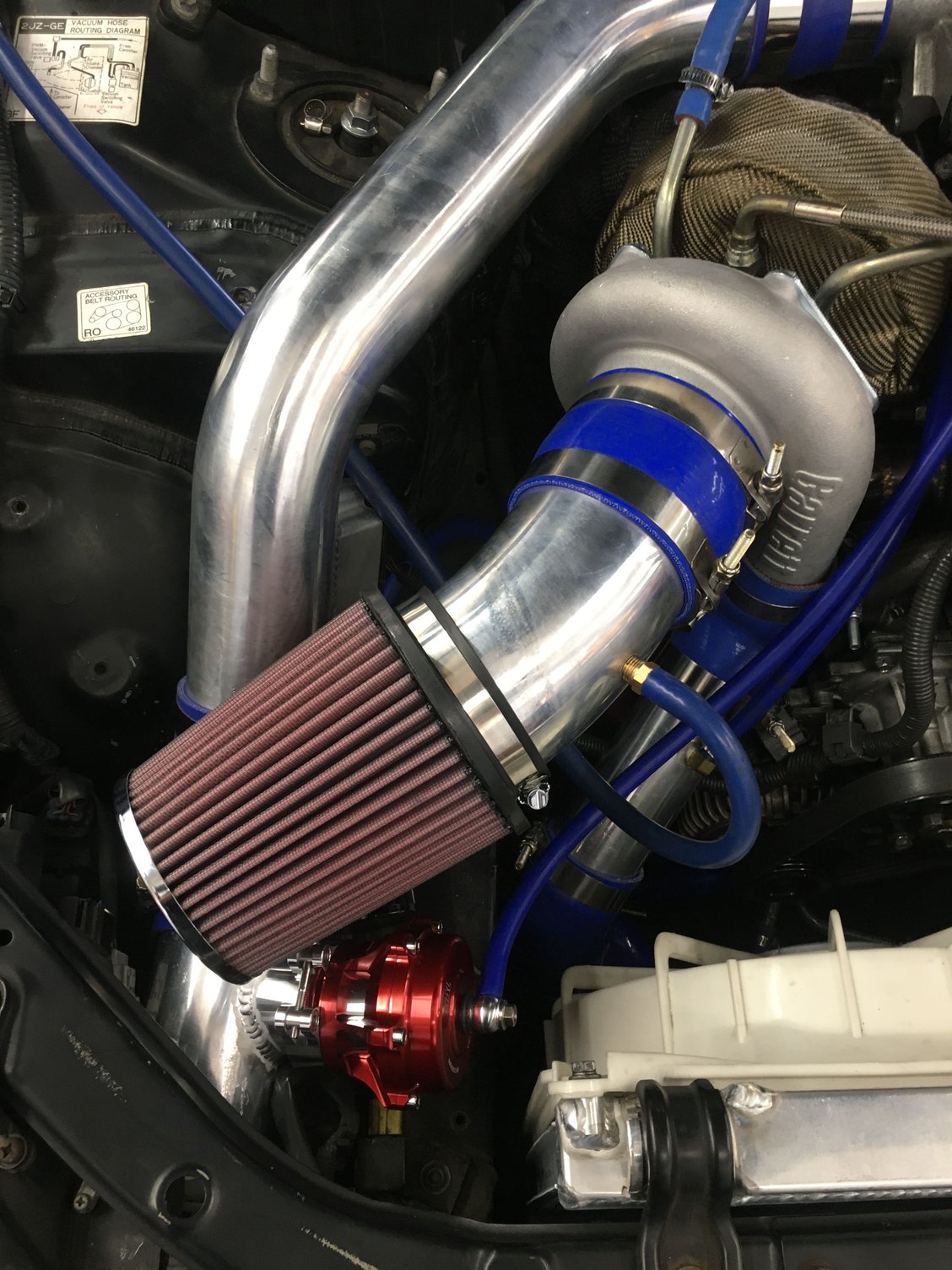

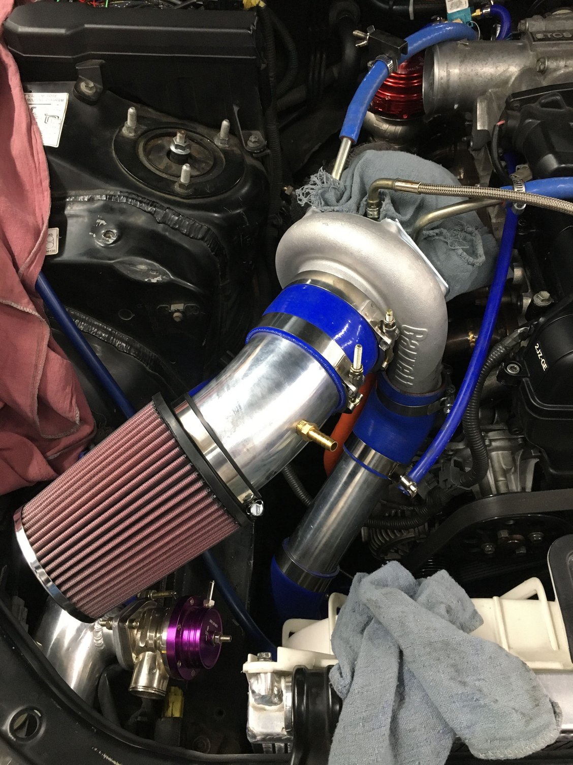

Garrett GTX3582R Gen2 installed . Next is taking the IC pipe that has the bov hole in it to a shop I know of that does good aluminum welding for my Tial Q bov flange.

New Tial bov installed, all back together and running. The Garrett turbo is audibly louder. Can hear the impeller spinning. Sounds cool. Just need to put a little miles on her, swap in my 1200cc injectors and go in for tuning. Hope break-in goes well. New engine, new trans, new diff, and new turbo + several other parts and fuel system upgrades.

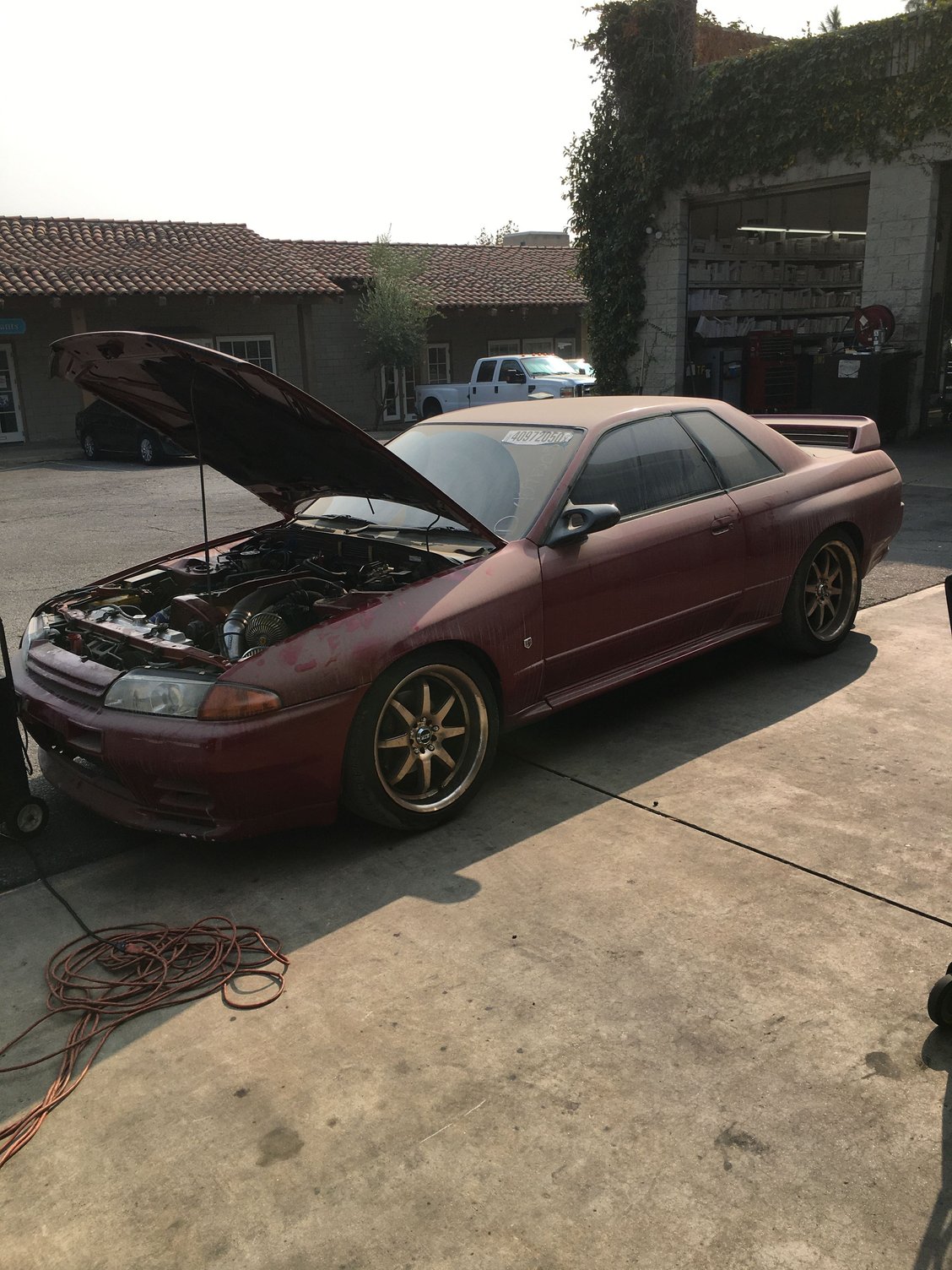

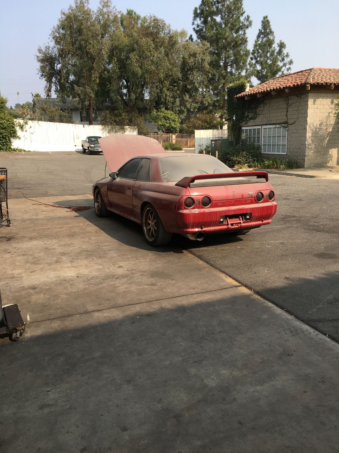

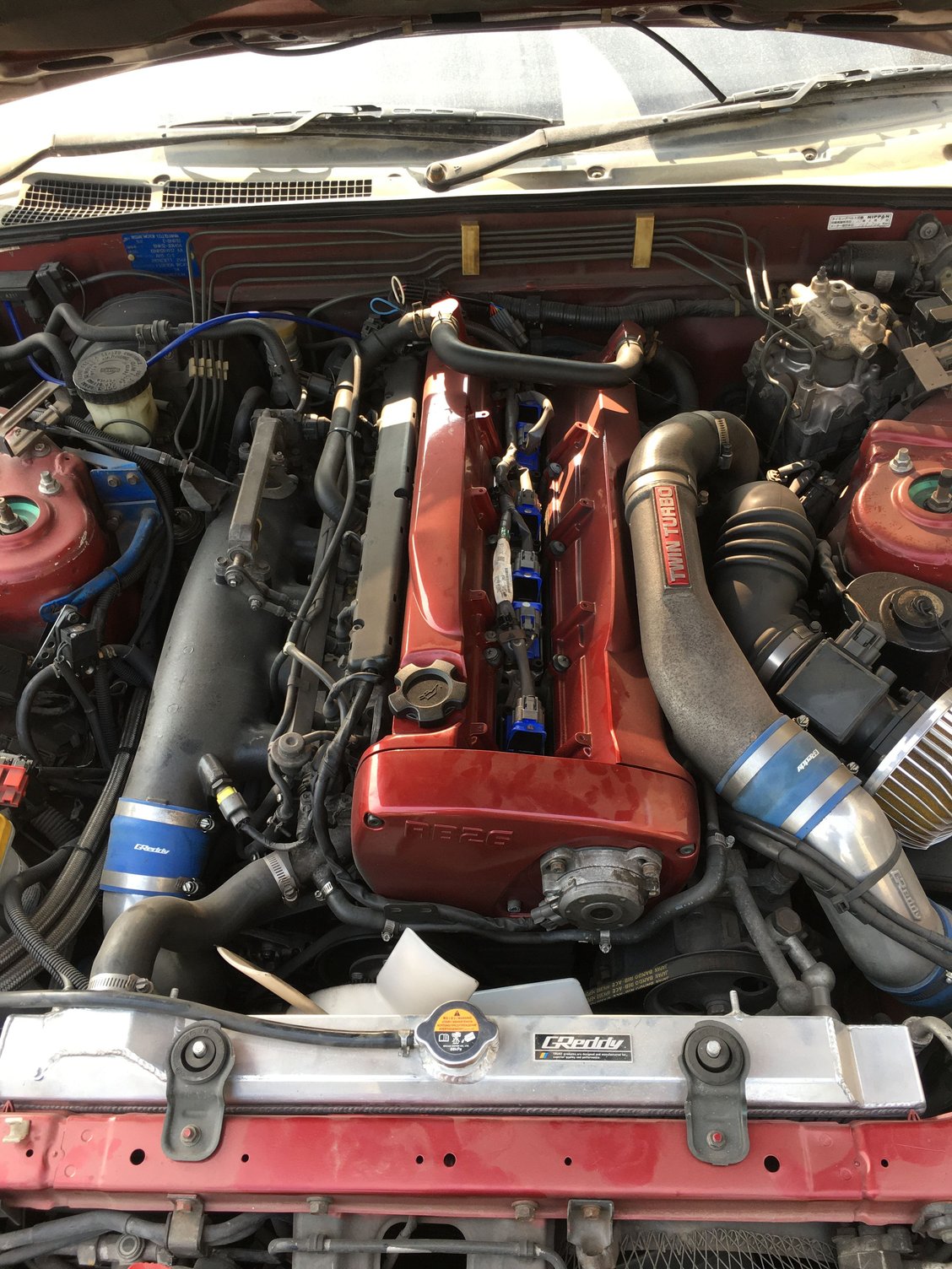

Got a new project to fix up. Thought I’d share. 1994 Skyline R32 GT
Charging after offloading
RB26DETT
Filthy
Filthy
Clean!
