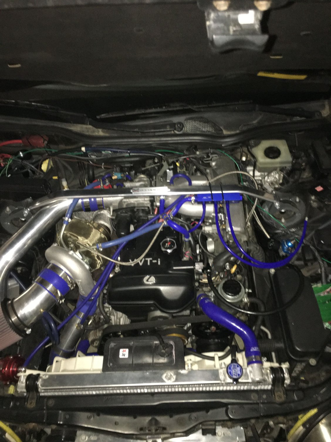

Things weren't as crazy as I thought and the car is ready to go again. Since there won't be a lot of down time I wont be messing with the fuel system or making any real big changes. Just the few small things the tuner suggested. I installed the vacuum block to give each vacuum operated sensor/component a proper source and especially the MAP sensor it's own source to the manifold. At this point I'm just ready to get the car running right. I'll be happy if it makes 600whp even. So not worried about further upgrading the fuel system to support big power anymore (for now anyways).
I know once I get the tuning done I will be finding out other things that need upgraded after driving it. I already know I need to upgrade my tires and coilovers. I've been driving a silly little 97 200sx with coilovers and got use to that. The GS is on Tein street basis z coilovers and feels like it's rather boaty in comparison now that I've been able to drive it again. I'll need a set with dampening adjustment so It can feel like it's on rails like my 200sx. I don't even have to slow down for corners in the little Nissan, the GS feels scary lol.
I'm also going to be looking into better cooling system components before the heat of summer hits. The car needs a better radiator than my little 1" thick single core ebay cheapo and factory fans. Considering an oil cooler as well. I'll have to custom in my own coolant fed fluid cooler for the trans as the good radiators don't have an auto trans cooler integrated. All things I'll plan for at the same time as a lot of the same work is required to route and install.
Anyways, first thing's first. Going to get this thing back on the dyno!
Here’s how I plumbed the vacuum block:
