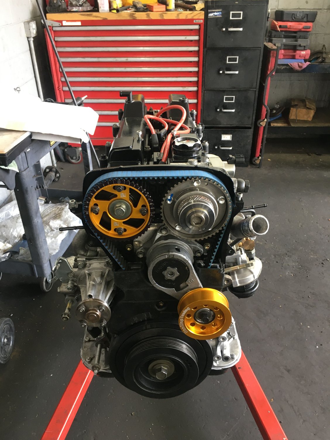

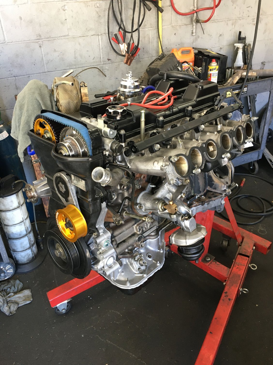

Got a little more done between work today. Oil pickup, pans, mounts, timing/water pump, all the sensors on the sides, oil filter housing etc. ready to drop in soon.

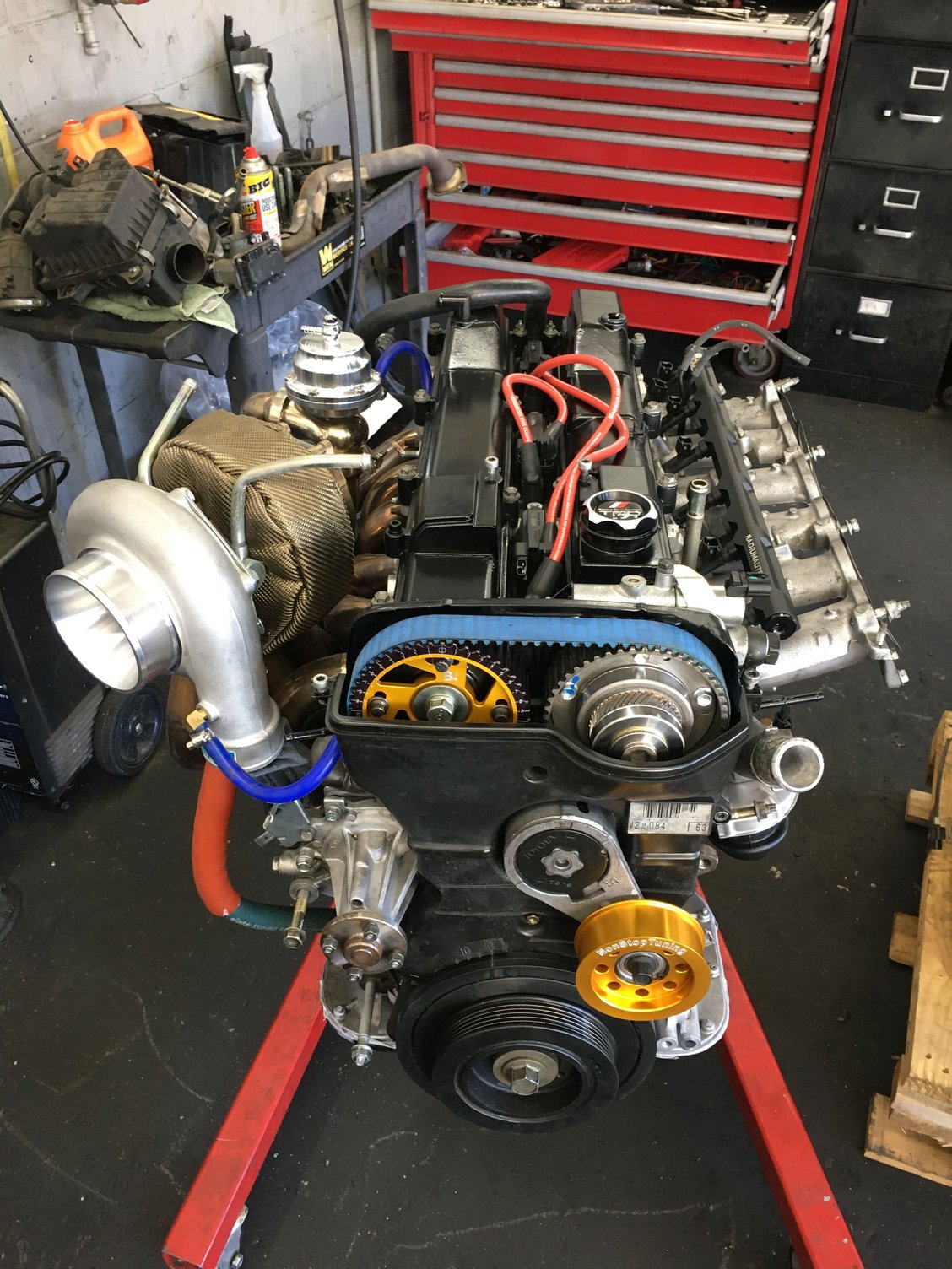

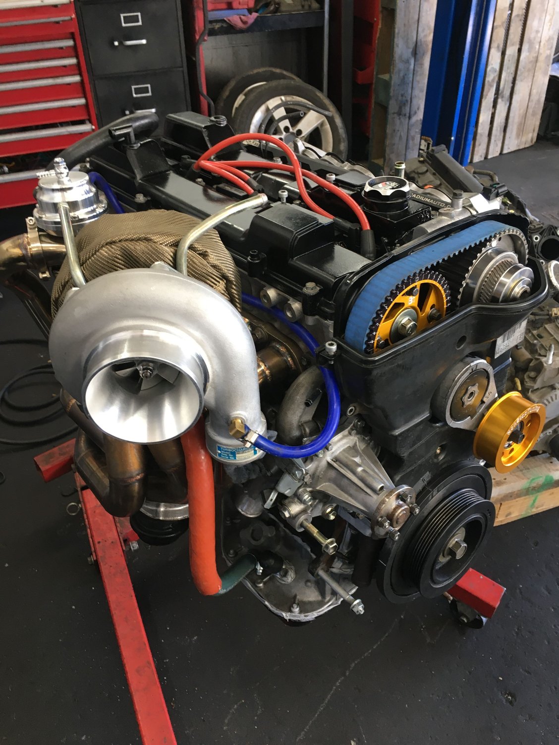

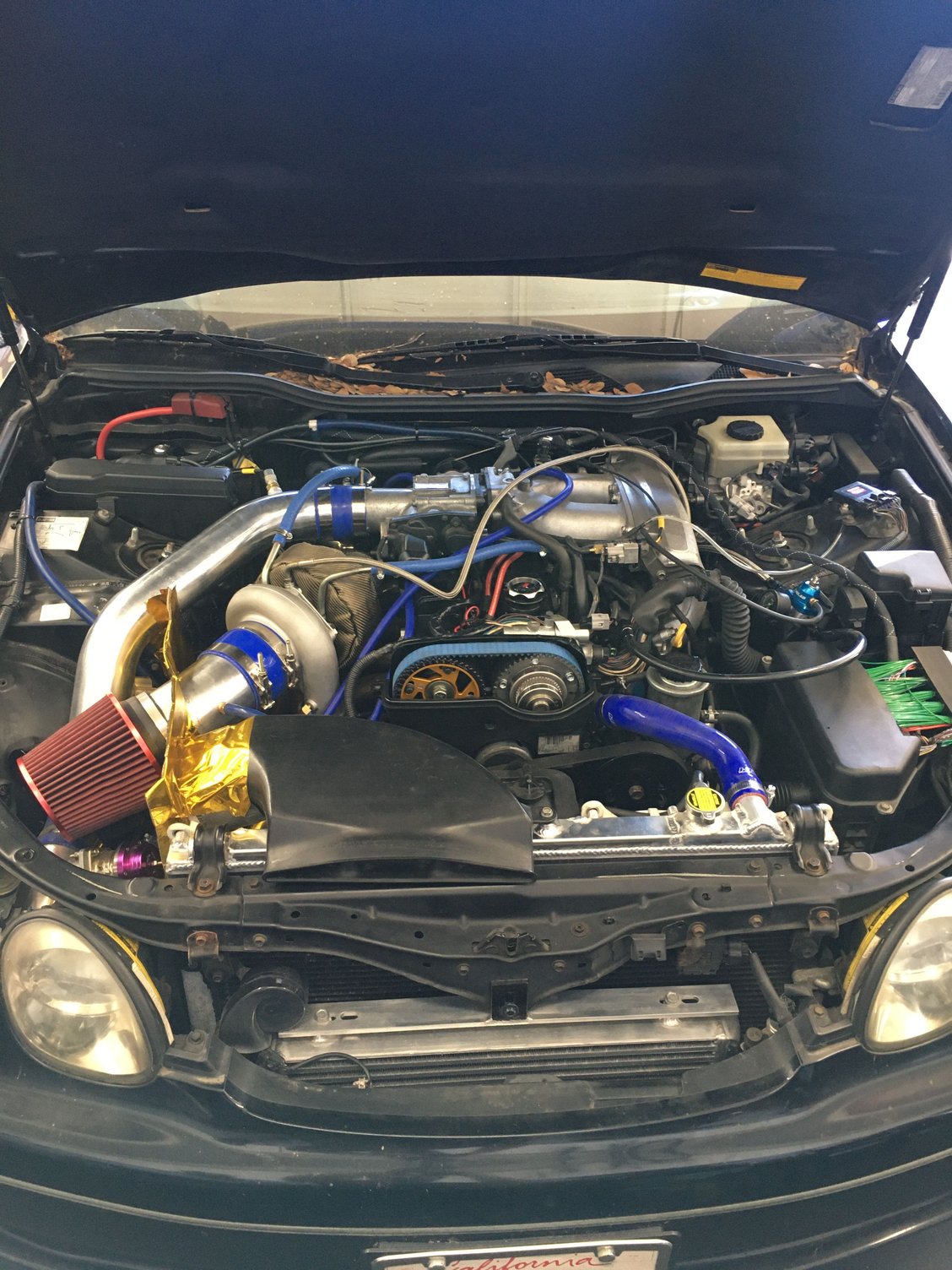

Got some turbo action going on now

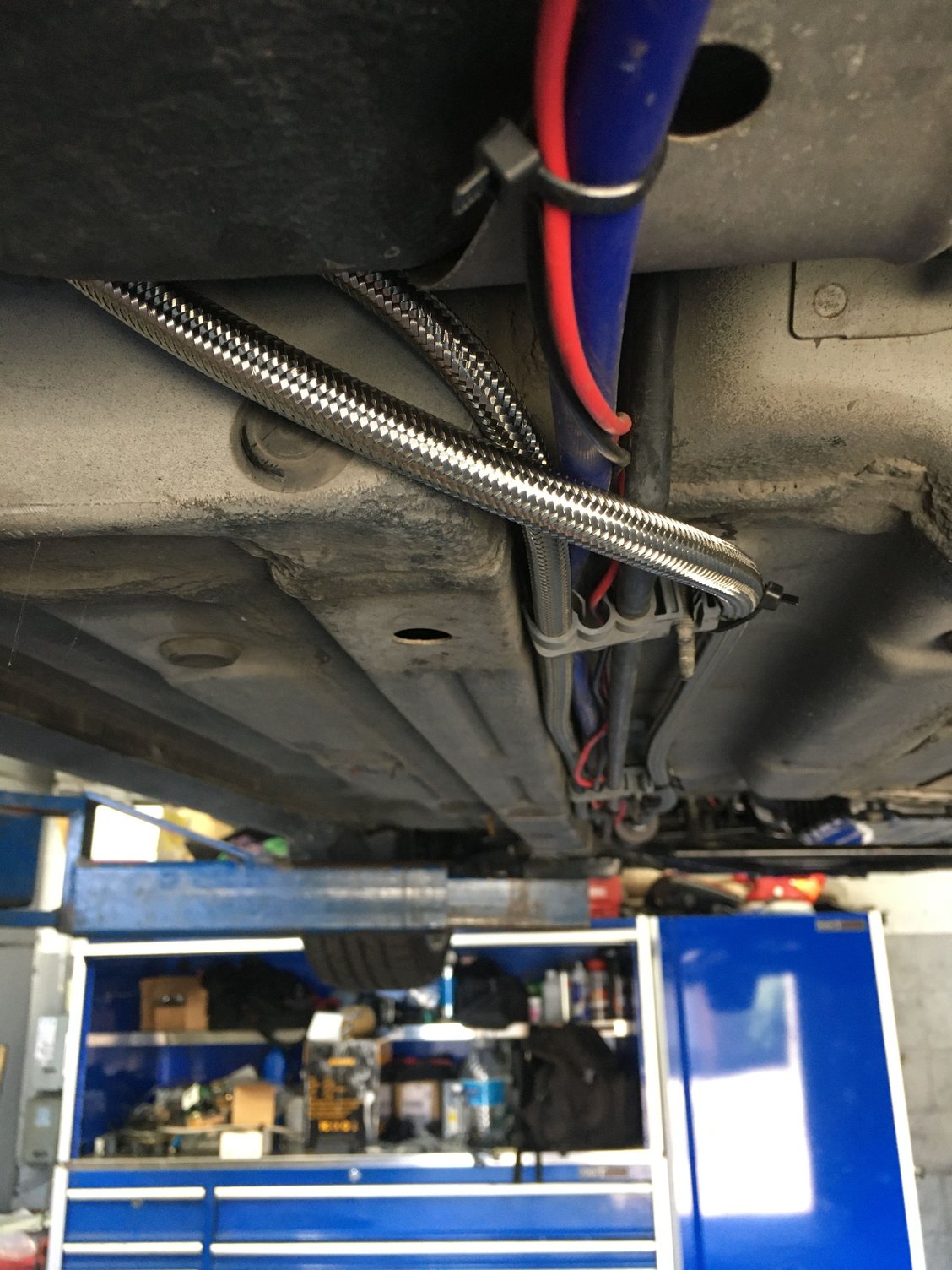

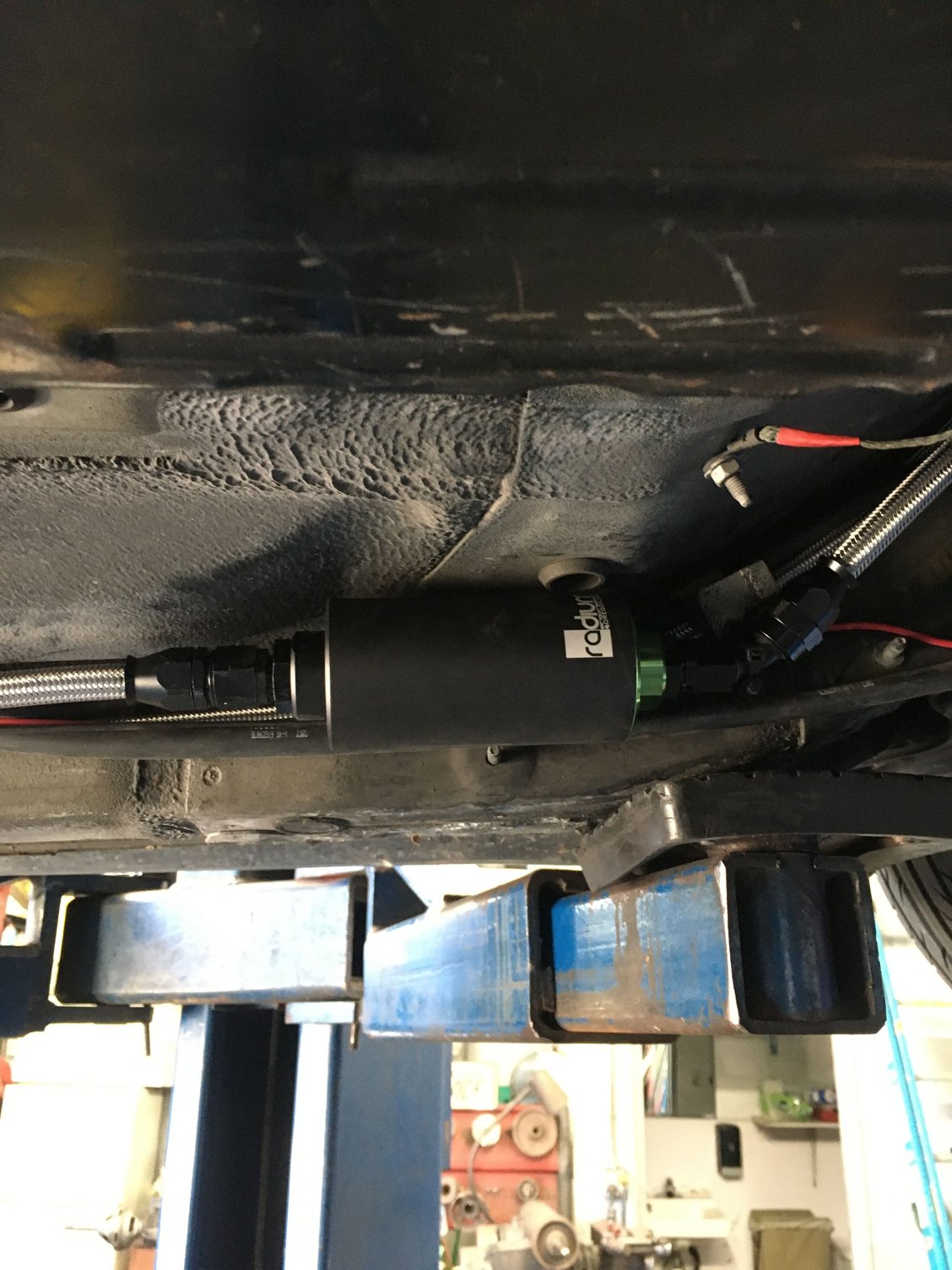

It’s finally back together and running. One of the challenges this time was customizing fuel feed and return lines and the hanger mod. But it all worked out well. I think the 525lph pump with a very restriction free system will supply my power goals fine. Still running the 550cc injectors it’s tuned for to break everything in, then going to my 1200cc’s and installing my MBC to turn up the boost and tune again.
Just a couple snaps of the fuel lines. You can see where I put the regulator in the pic above.

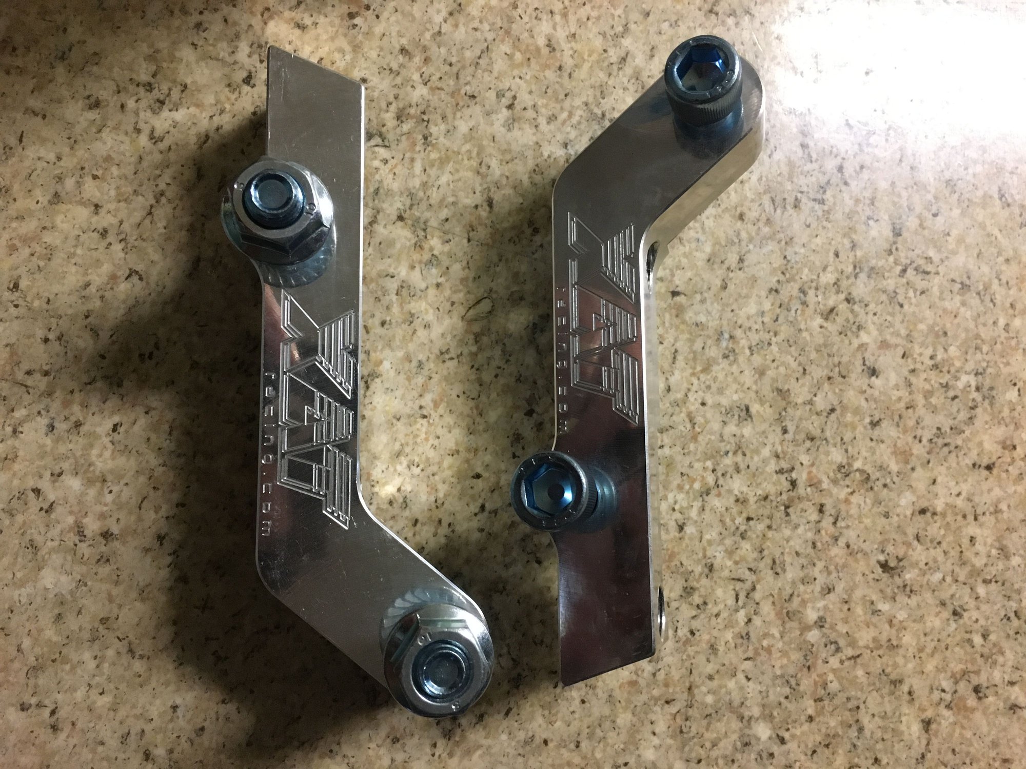

Also just got these XAT brackets in for the LS430 rear brake kit I have. Will be installing too over then next week or two.

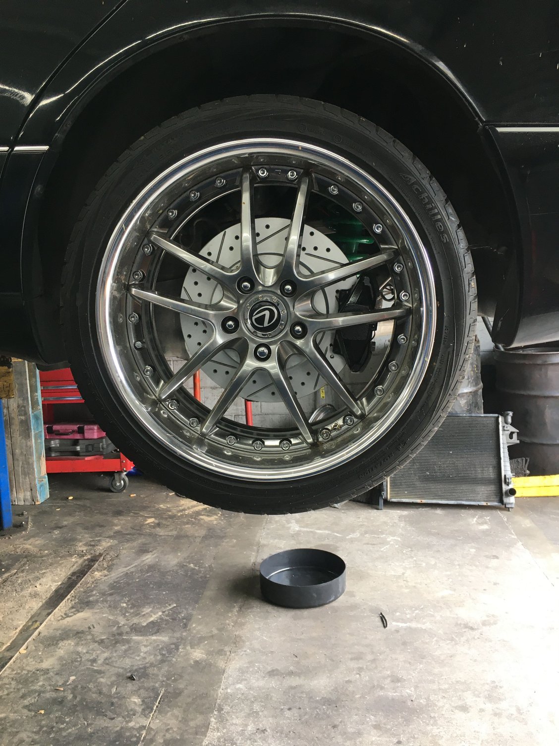

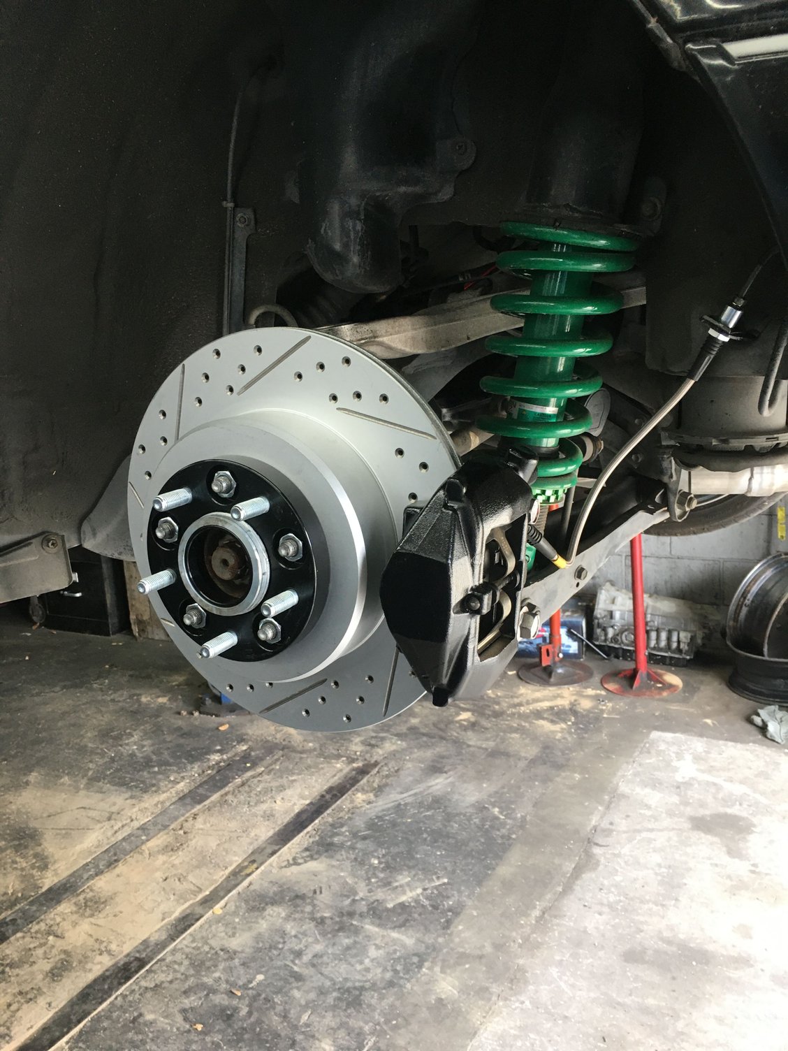

LS430 rear brake kit installed. Goes well with my front upgrade.

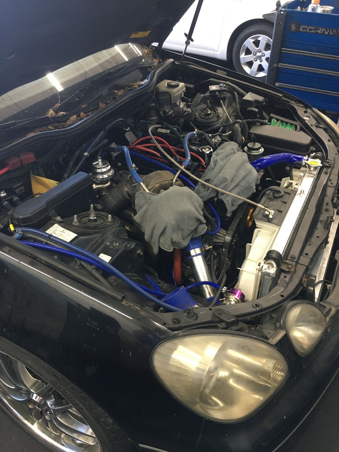

Some delays in progress have happened due to low quality parts. I'v been forced to reconsider moving forward without upgrading and adding some parts. Starting with the wastegate that failed from CXRacing. I don't know how this even happened, the wastegate stayed installed on the manifold and was never tampered with. Just has been stuck open since rebuilding the engine and getting it running. So I have a TiAL MV-R 44mm on the way that will be installed with a 12psi spring for my baseline. I believe this issue has to do with my messed up A/F ratio and why I'm having to run so low of fuel pressure to keep good readings. I am also upgrading the BOV to a TiAL 50mm Q. But I need to get the car running good enough to get a solid engine vacuum reading so I know what spring to order it with. Pretty sure the 10lb one will be what I need. But will have to start with the wastegate and fuel pressure first. The reason I'm upgrading the BOV is because A: The CXRacing one is just as cheap of junk and B: In my research I found that similar size one's are only good to an estimated 400ish hp. So I like the idea of welding on a 50mm flange for the TiAL BOV. Once I get a solid engine vacuum reading I will select the appropriate lb. spring.
I am also looking into an electronic boost control solenoid rather than my basic MBC. I had planned to just set boost with it on dyno day and leave it. But I realize that I have an AEM Infinity ECU that is literally designed to run one and make things work better all around. AEM sells their own for just $100. Will likely just get that one. I don't exactly know how they work yet, but hope it's worth it. I need to have all these things planned and done before going in for tuning so it's right the first time.
I was also considering AEM's methanol injection kit. I don't know if they are worth while kits though for $500. But like I said, if it makes more and safer power and is totally usable with my Infinity ECU, should it be a no brainier to do?
Open to any recommendations or insights to these things for having the car on point before I take it in for dyno tuning. Anything else I should consider?
