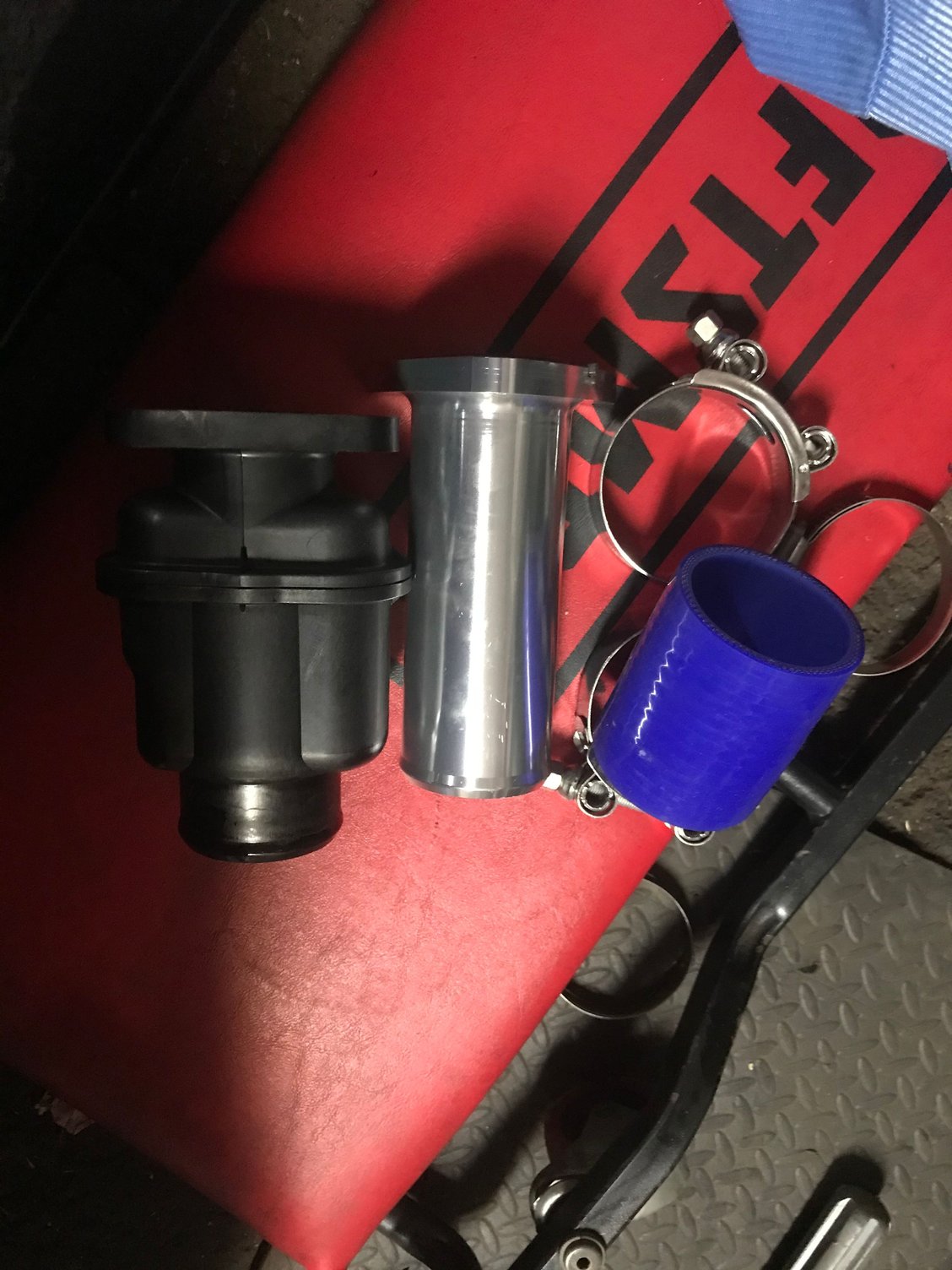

Ok guys so yesterday i installed the Charge pipe Blow off valve spacer and turbo muffler delete from TTI. Fairly easy to install the quality of the parts are really good. Engine sounds better and the blow off noise its amazing its loud! you can hear the turbo spooling.
But i think the best thing about it its how much faster the turbo spools that its noticeable like right a way i was driving stepped on it and the spool was quick so much that i gas it again just to check it out.
Here a few pictures of the installation process and a video that btw makes no justice! i'm gonna do a proper video from the outside with different revs so you guys car listen to it.
stock
stock turbo muffler and charge pipe
VALVE
how it looks with the spacer on
how it looks from the top
from the top left side
charge pipe installed
like i said clip makes no justice posting one proper soon
everything together
Any DIY to install the diverter spacer?
Looking at the space available, how the hell did you tighten everything down? lol That's a tight fit and I have big hands.

BTW I would stay away from the by-pass/diverter valve spacer as it will throw throttle lift/close fueling off significantly which could in-turn cause undue wear to the engine and hurt gas mileage. Our cars are MAF based and should not VTA (vent to atmosphere) unless tuned for it.
