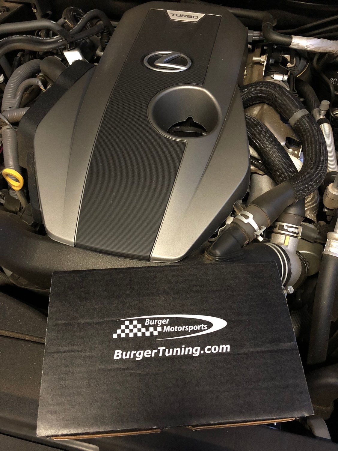

Got my stage one in! Thanks to Sheddy. Let's plug this baby in!

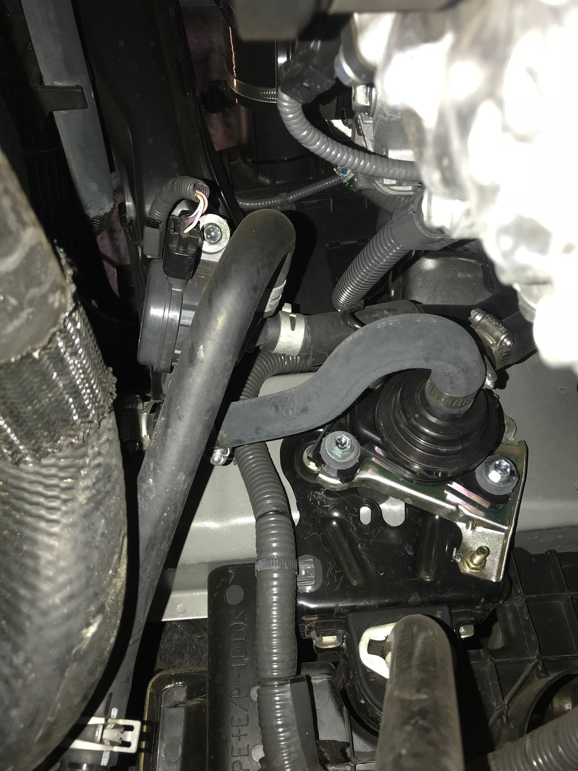

pnoygil can we see pics of the new heat exchanger setup installed? would like to see how you routed the plumbing. i imagine this mod alone would help w/ power without any tune.

this one is 27" across with 0.8" inlet/outlet. i imagine the prius pump (good choice btw) was plumbed up somehow to be in line. would like to see all the fittings and how it was done.

Both stock pump and aftermarket prius pump
Im still using the stock HE i just added it for better cooling, i cant get a good picture with the aftermarket HE without removing the front bumper, connection is pretty easy by following how the coolant flow...
Enjoy bud!
Thanks for the information! I am guessing you have an NX?
