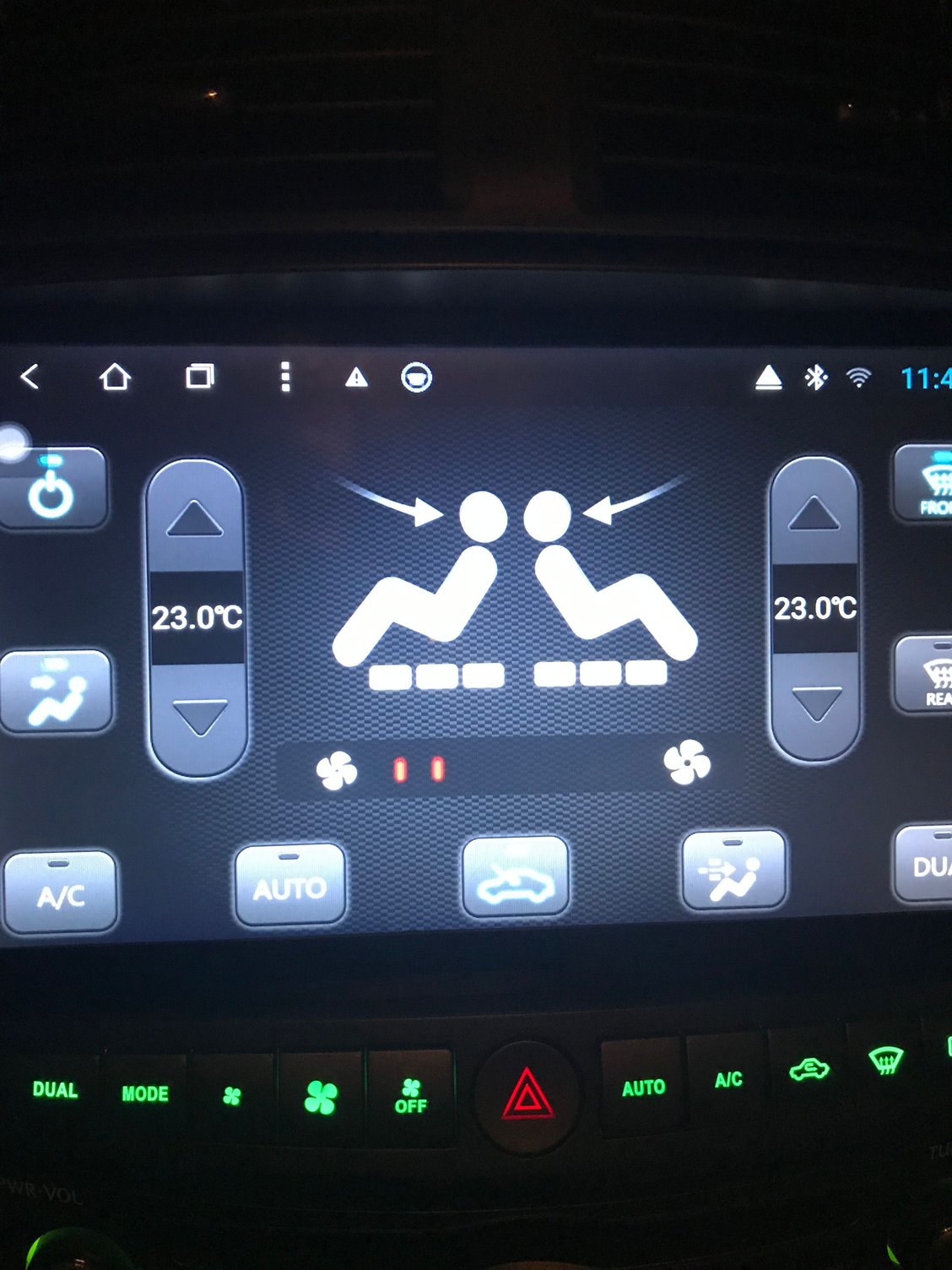

Hi Guys, I Installed this unit back in August, and have some of the same issues as you, the radio frequency, my bluetooth music sounds like crap
However my climate controls do show temperature numbers in addition to the hi/lo, those being at the ends
also, does anyone know what the OBD2 plug does, I lost mine and they'll send me a new one for 27$ and I dont know if its worth it.
That's interesting, can you take a pic of it? A lot of us have that feature missing.
Shows what door is open in the car. That and maybe the reverse camera.

Here it is (I hope) the range is 18-32 degrees C, with no way that I know of to change to F
Wow that is pretty cool. Your car is American right? What version is your CANBUS if you don't mind me asking? I'll happily use Celsius over "Hi vs lo" lol
Its a Canadian car, but made in Japan (which my understanding is that they all are) if that changes anything
I'll check the version when I take it apart again
