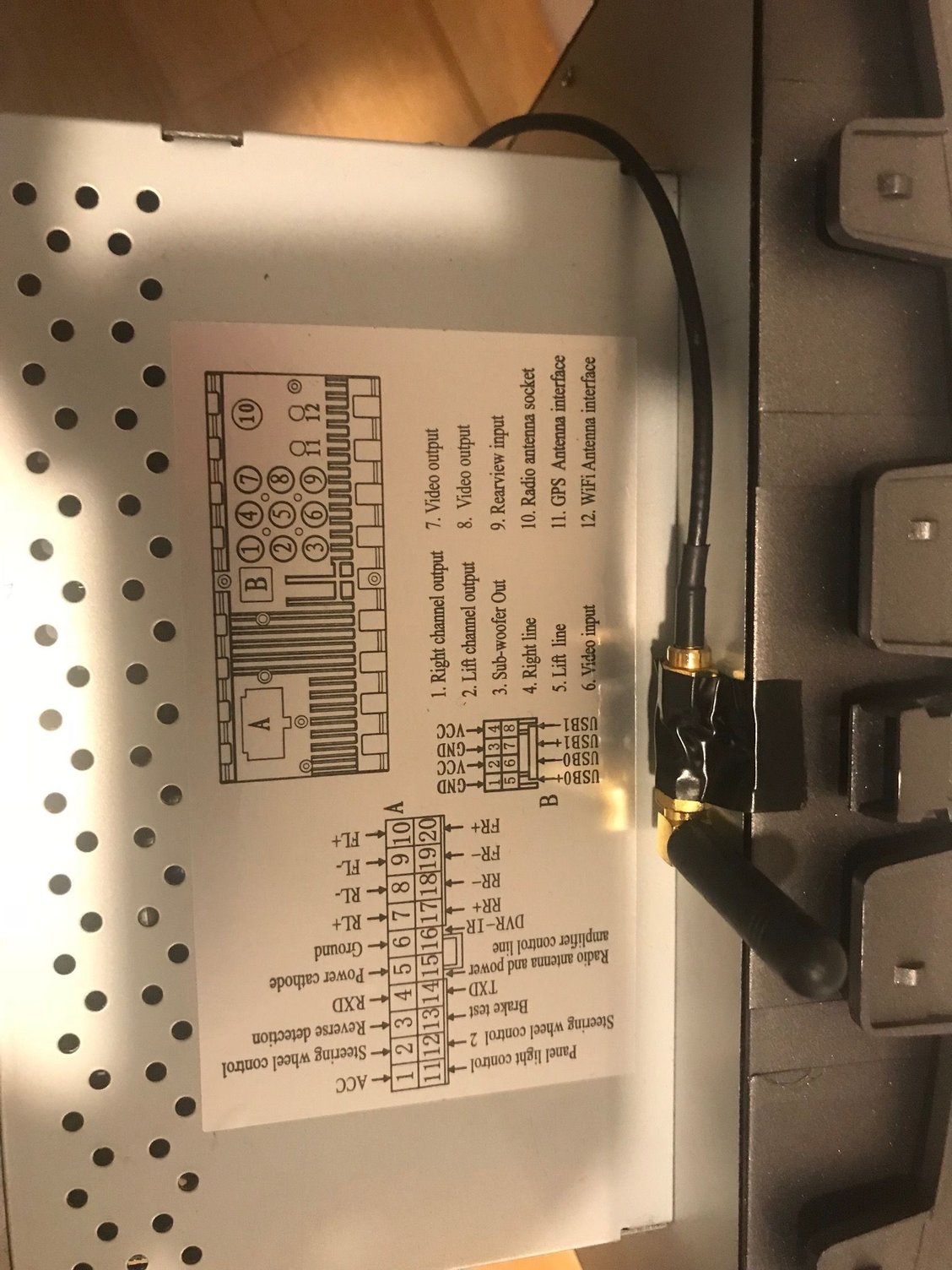

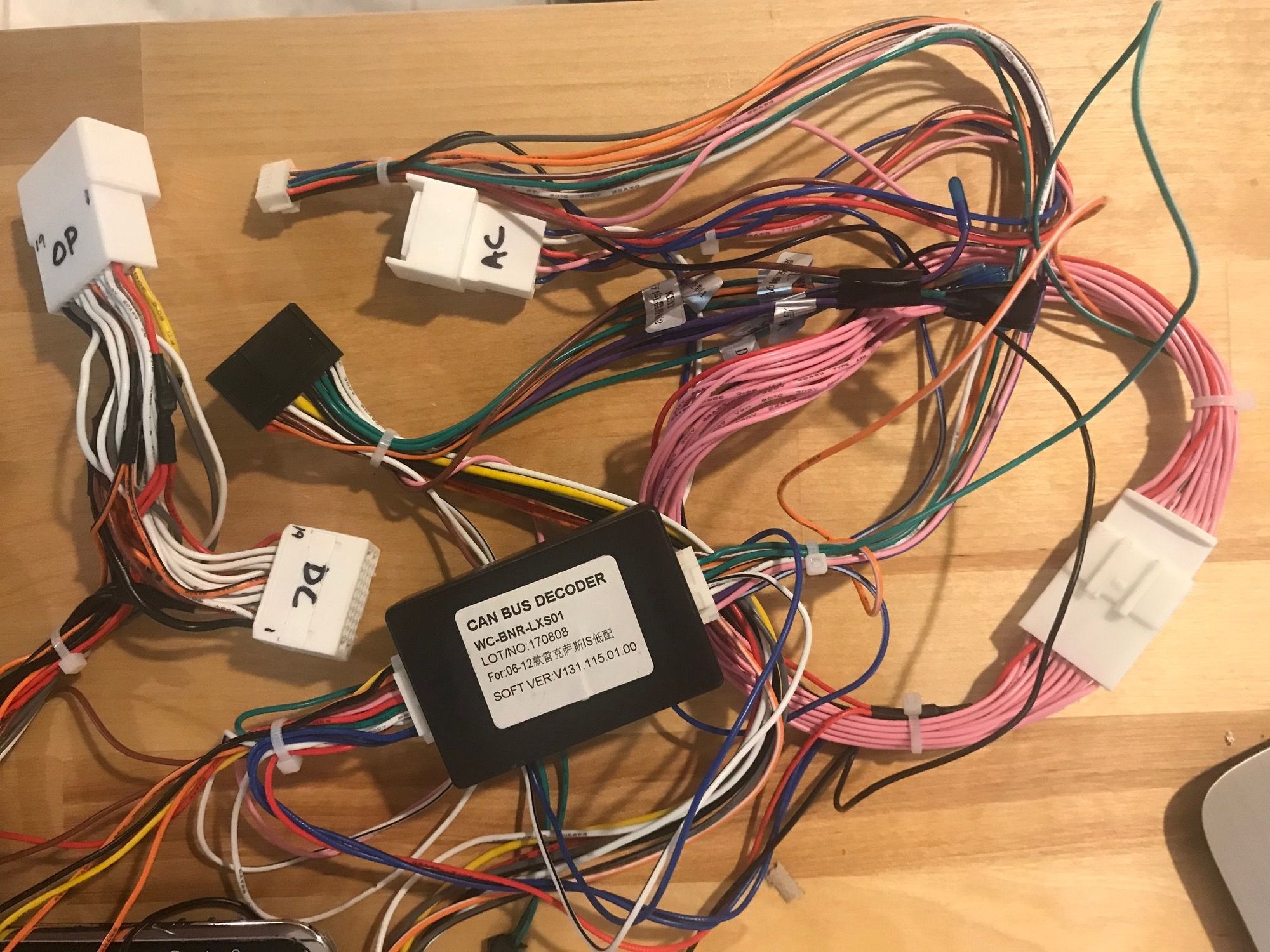

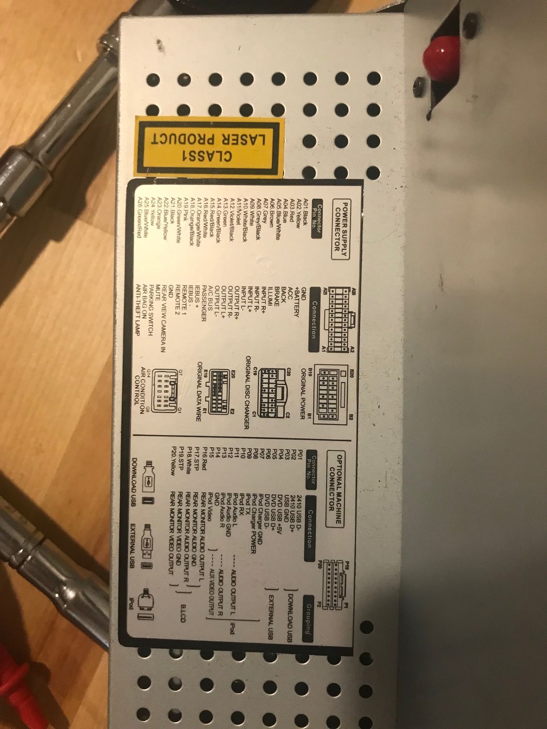

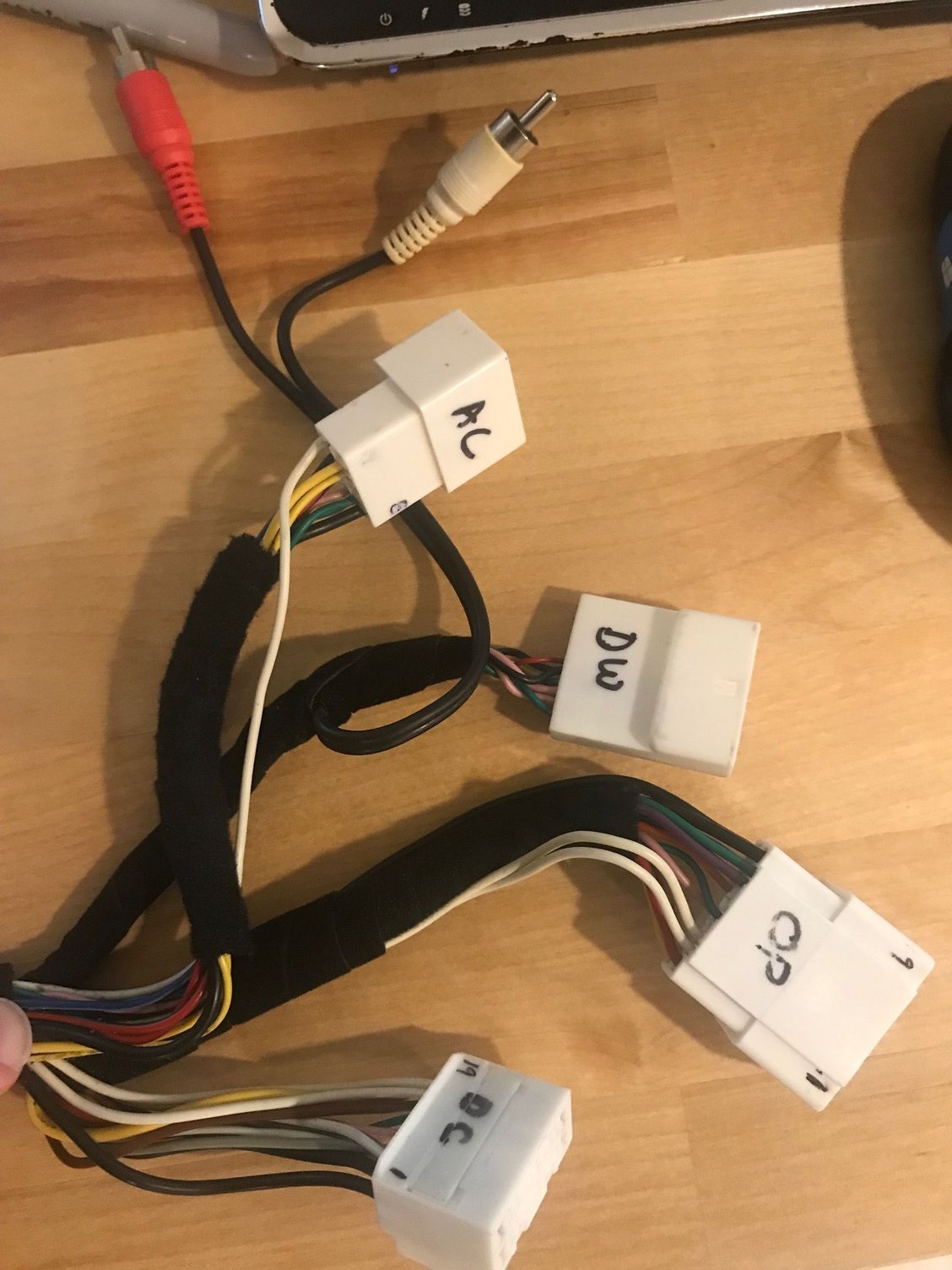

OK so this waiting is talking too long... No response from the vendors but I think we all can solve these main issues.
I went ahead and took my wire harness from my FlyAudio Radio (which was working great) and the wire harness Android unit to and traced each wire and create the attached excel sheet. I attached photos of the Android and FlyAudio Hardware and Diagrams. I have traced all the wires in GREEN that were exact, YELLOW that were not names the same or wrong order, ORANGE for missing or don't understand yet whats going on.
AirBag issue:
The post about putting the resistor in place that was posted earlier is correct. The fly Audio wire harness has this resistor which I found on the AC control PIN #7. This was connected by a white wire to the ACC PIN 3# on the Fly Audio radio. Click here for the Airbag Fix posted in other post. I will try this out when I get time.
Temperature issue:
The other issue about temperature not showing (Only HI or LOW) and other post say its not a CAN Decoder issue. According to the diagram the IECAN (which I believe is Lexus CAN) goes to the CAN Decoder input and is not on the AIr Conditioner Control with the Android wire harness as well as the A/C bus is not connected. Not sure if this could be causing the temp not to show? Anyone have any input?
Radio Frequencies:
This to be a CAN Decoder issues so I am waiting to hear an update for this one.
Flyaudio Diagram
Android Diagram
Flyaudio Wireharness
Android Wireharness
Ok I'm going to take a break. Look forward to hearing what you all think.
Cheers.

I just installed this unit myself and am experiencing the usual problems with the radio, which doesn’t bother me that much, and the HI/LO temperature, which does bother me more than a little. One potentially important detail: my unit has Android 8.1 installed, and I can tell from the screenshots on here that you were all using 7.x versions of Android.
Unlike the others on here I have gotten very good and responsive support from my vendor, Top Navi, who also claims to be the manufacturer (a common statement, I see). I’m not sure if this is true, but they are certainly working very hard to provide good service and build their own reputation. Great communication via WhatsApp, sharing photos and videos, and trying their best to answer most of my questions.
After some testing, based on the advice of one of their engineers (an actual engineer of the unit? I'm not sure) I have ordered a new USA-specific CAN BUS decoder from them. Yes, I know... how convenient it is that a possible solution involves me giving them MORE money, but in the interest of providing great support to me they are covering the cost of fast DHL shipping, which is actually more money than I'm paying them for the CAN BUS decoder. I will definitely give this new decoder a try and report back here in a few days. Their theory is that cars from different regions use slightly different signals and the unit that was included with my original purchase is a "universal" CAN BUS decoder which "should work in all regions" but may not provide all features. My guess is that this *might* help with the radio frequencies but will not help with the temperature readings. They tell me that they do not have access to a USA version of the IS250/350 to test so they are guessing, too, and I think they are actually curious to get my feedback on the result of my own tests once it's installed.
I am particularly interested in digging into the wiring diagram in the previous post to see if there's possibly just a wire out of place somewhere on the harness I have. I have seen a Russian video on YouTube of this same head unit clearly displaying the temperature numbers in what could be a vehicle manufactured for a different region. I like the theory that there is a missing or misrouted wire related to the temperature on our presumably Asian-market harnesses connected to our USA vehicles. This would certainly make sense, and without a USA model of the car available to the developers of the wiring harness, they may have no idea that they're missing something, leaving them with only the suggestion of a new USA-specific CAN BUS decoder. All of this is assuming that my vendor is *actually* the manufacturer, which we all know is a long shot.
