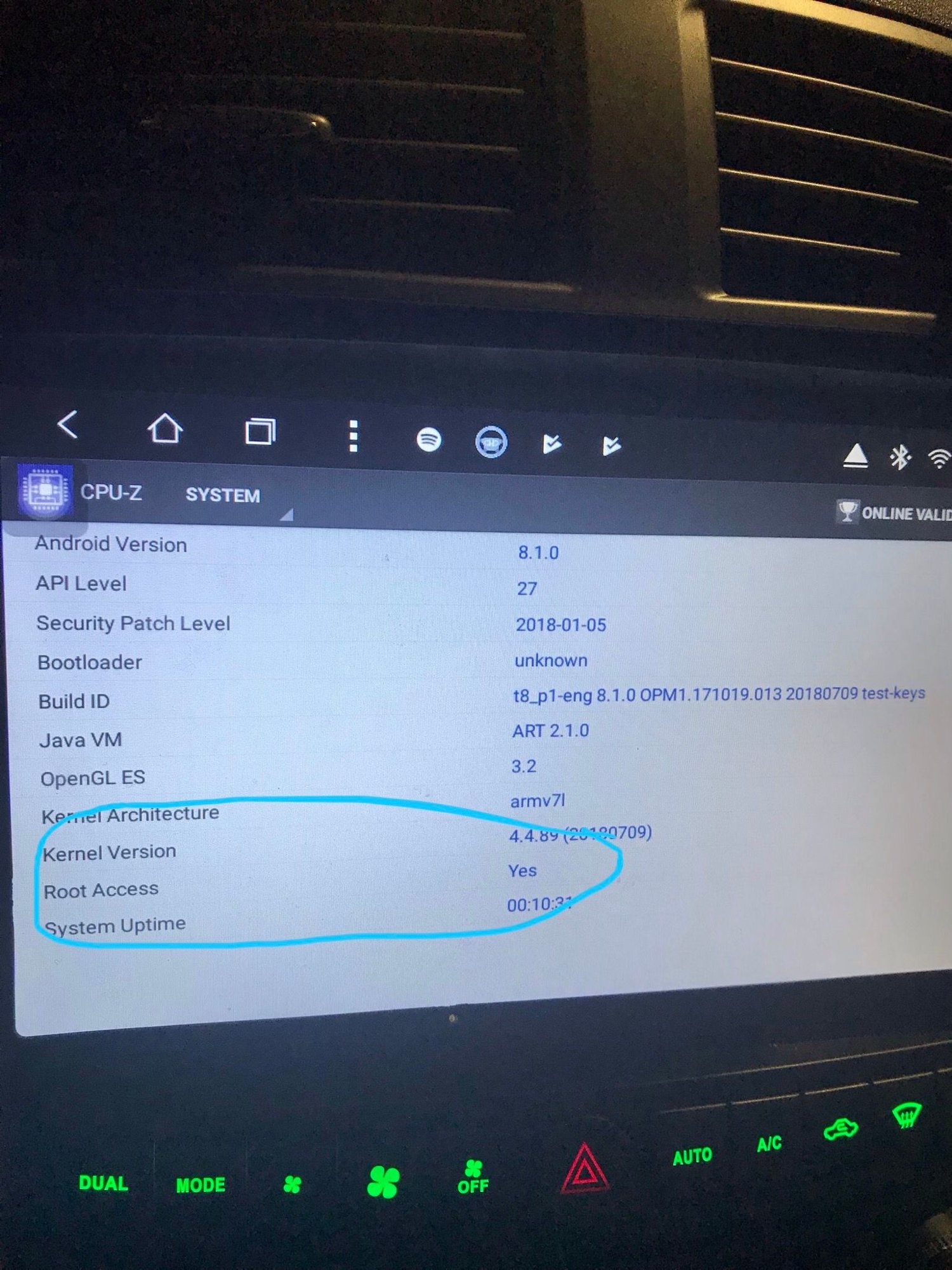

Im not sure if this is a 100% confirmation but cpu-z seems to show that, at least my unit is rooted
I tried root it, but non worked. :-(
Check yours with CPU-Z, it might be already rooted

When I run Tasker or any app that needs rooted access, it still said it needs root. So even though it shows rooted, it is not really rooted.
