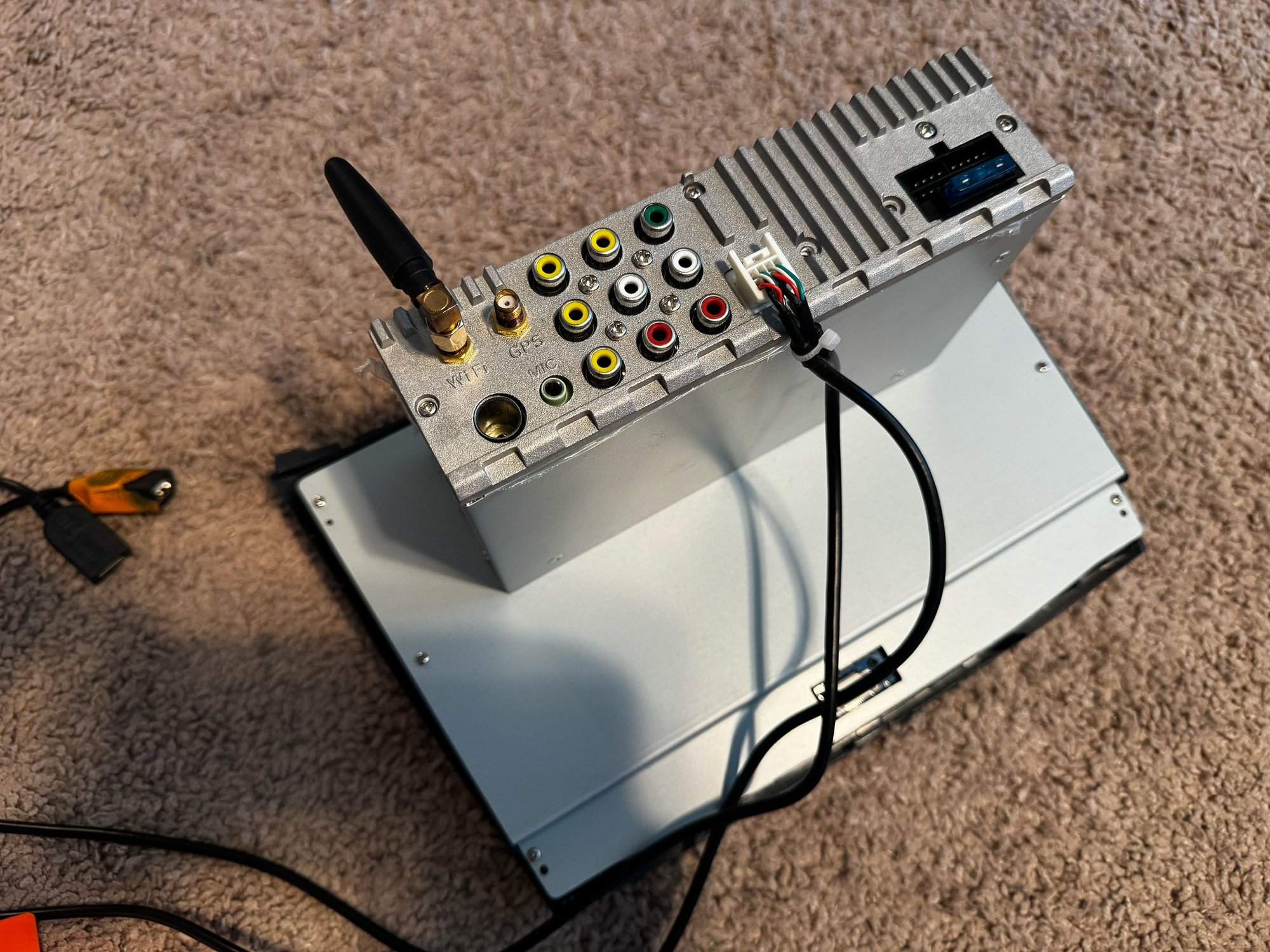

Hey, everyone!
I'm coming back to this old thread where I originally got lots of help to install my first Android Head Unit in my 2011 IS 250.
Well, I have since upgraded to a newer unit and I no longer need my old one. It was still working when I removed it, but I wanted something more powerful and with more reliable built-in wireless CarPlay. This older one requires a USB dongle to support CarPlay, which worked OK but was somewhat unreliable at times.
Well anyway, I'm writing this post to say that I'd like to send this to someone who will use it. All I ask is that you pay for shipping, and it's yours!
If you are in the Austin, TX area you can pick it up for free. For someone living elsewhere, I'll just need your address to estimate shipping costs.
This includes two CANBUS boxes - the original one that some of us had trouble with, and the orange one I bought separately later which made my unit work better here in the USA.
Here are some photos of what you'll receive, which should be everything you need to install it in your 2nd generation IS 250 that did not originally have a navigation screen. Maybe it will also work in a car that came with the factory navigation system, but when I was originally buying this, they definitely wanted to make sure I didn't have the nav system before selling it to me.
Let me know if you want it!
