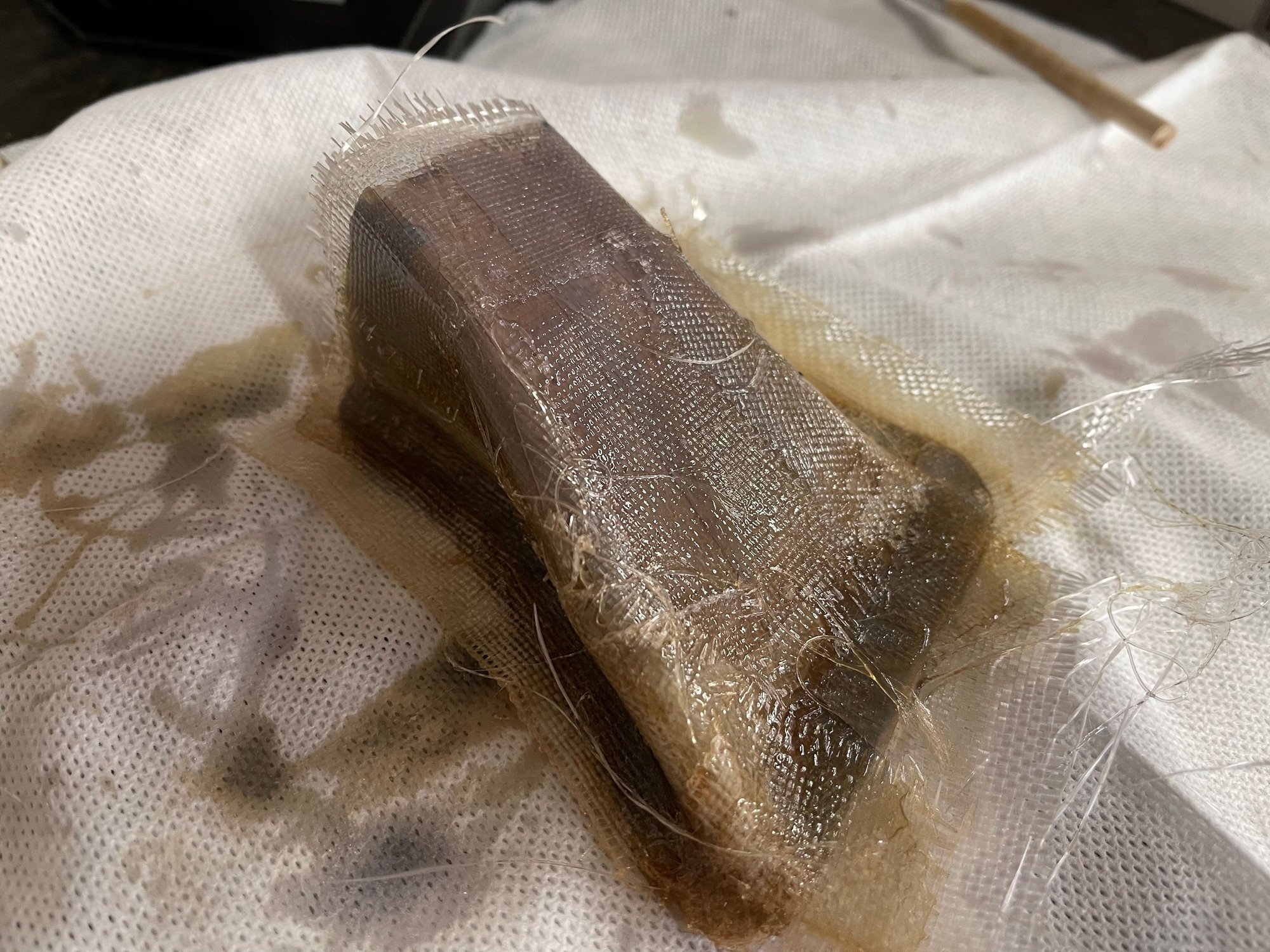

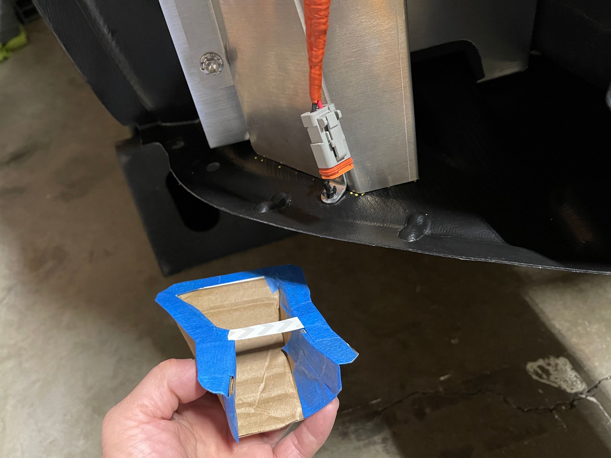

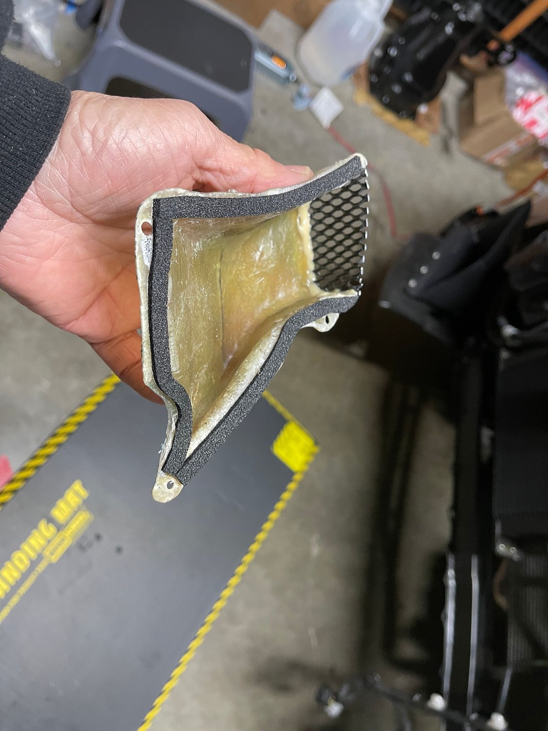

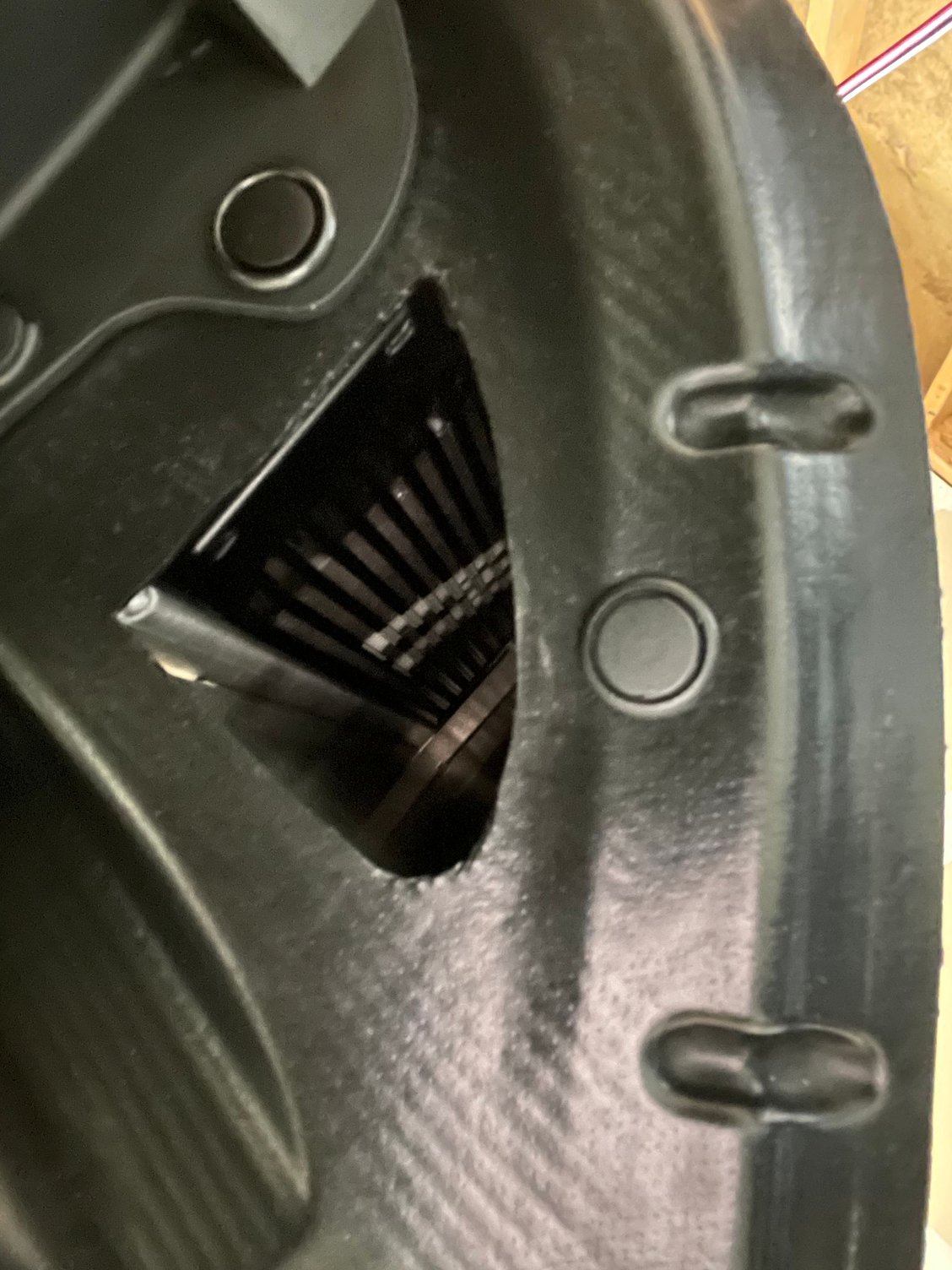

Made an air scoop for the oil cooler. FIGS kit comes with an optional 3D printed one designed for the smaller round opening. But, I made the hole larger so I needed a larger air scoop
Nice.. painting it black or laying CF on it ??

Does it exhaust into the wheel well throught the louvers?
Joe Z
Thanks, most likely just paint it black.
Yes it does!

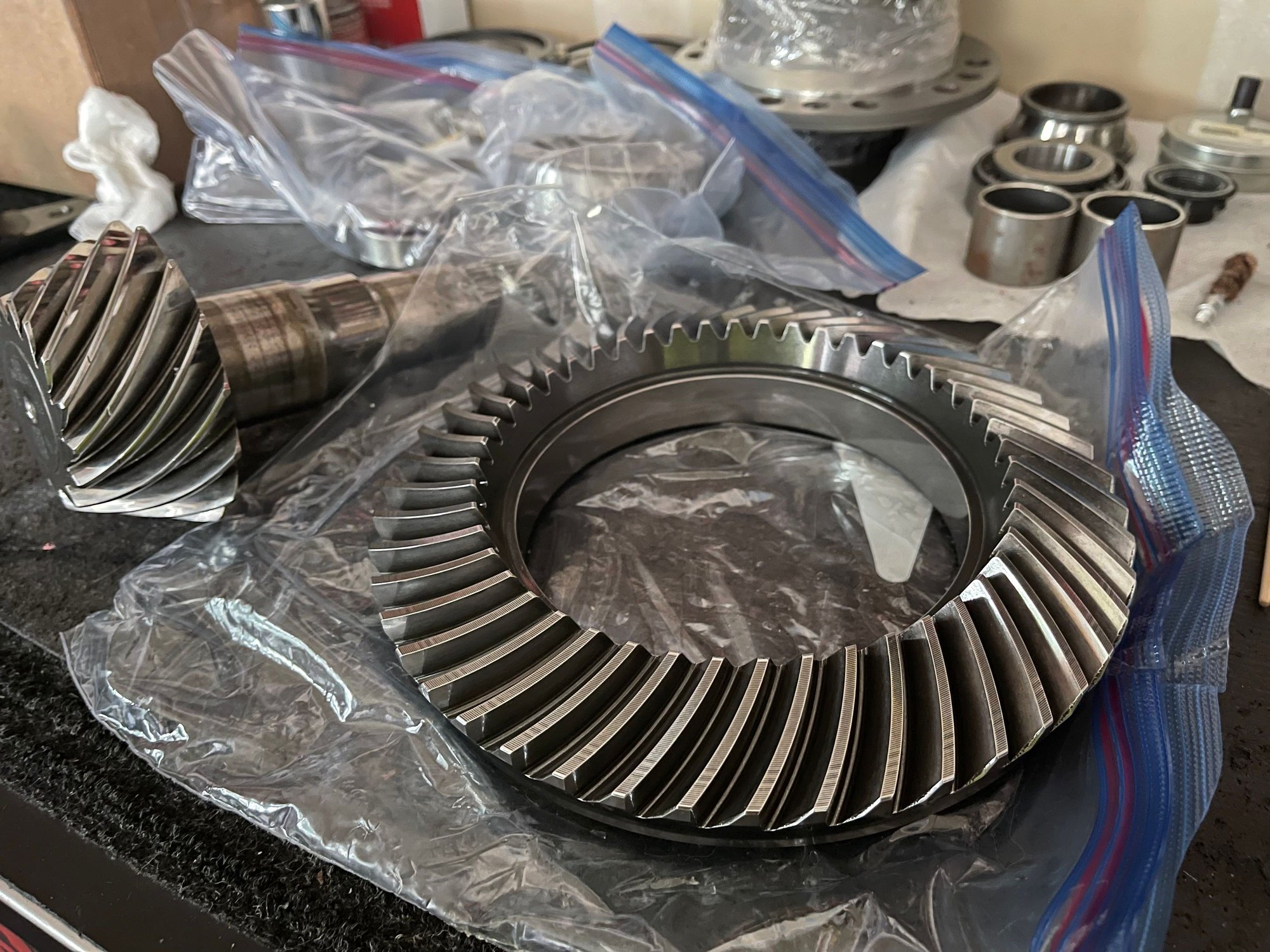

Bearings and gears are back from Cryoheat and micropolishing.

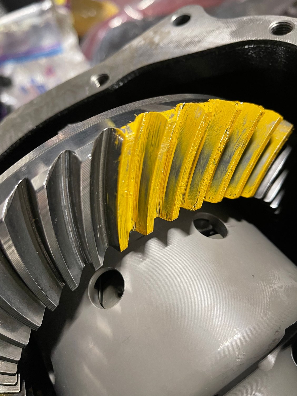

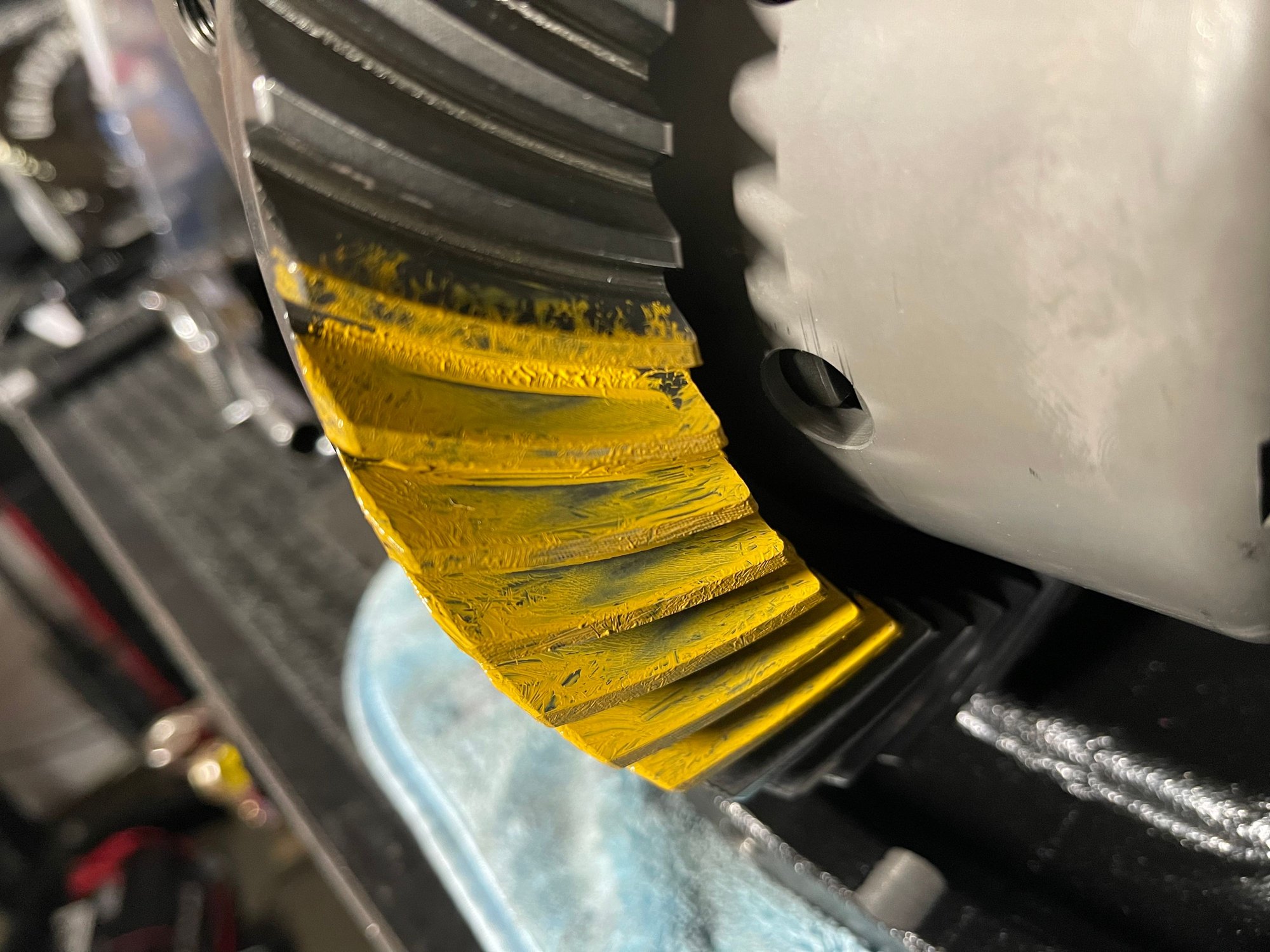

Checking contact pattern and backlash. Backlash is a little too much, factory spec is .08mm-.13mm. I’ll need to order different snap rings.

Yeah, spool needs to go right ever so slightly.
yep! How about pinion depth, leave it?
Mine is very similar. When my dad checked it, he called it racer perfect. Slight bias toward the inside so you end up in the middle under hard acceleration. He's been building dirt track cars since I was a kid and has set up plenty of differentials over the years.
Yeah, that’s what I thought, contact will
move under load. Thanks!

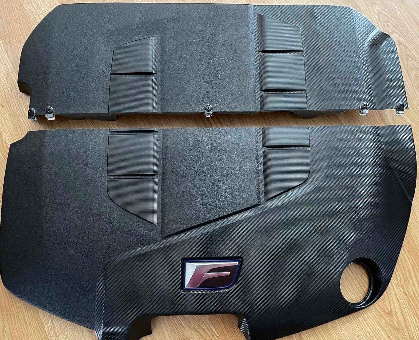

Made my engine cover 2-piece for ease of removal, without removing the shock tower brace.
