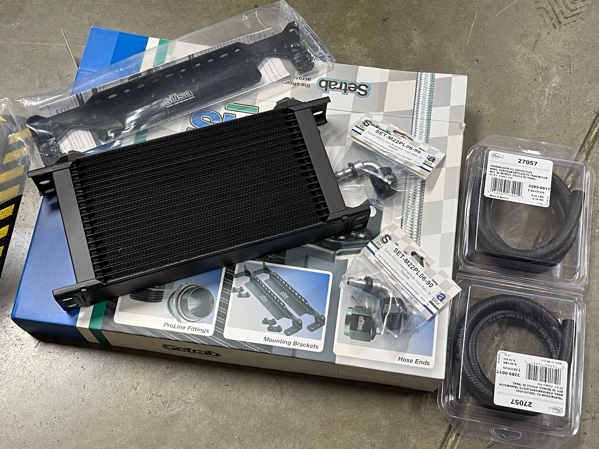

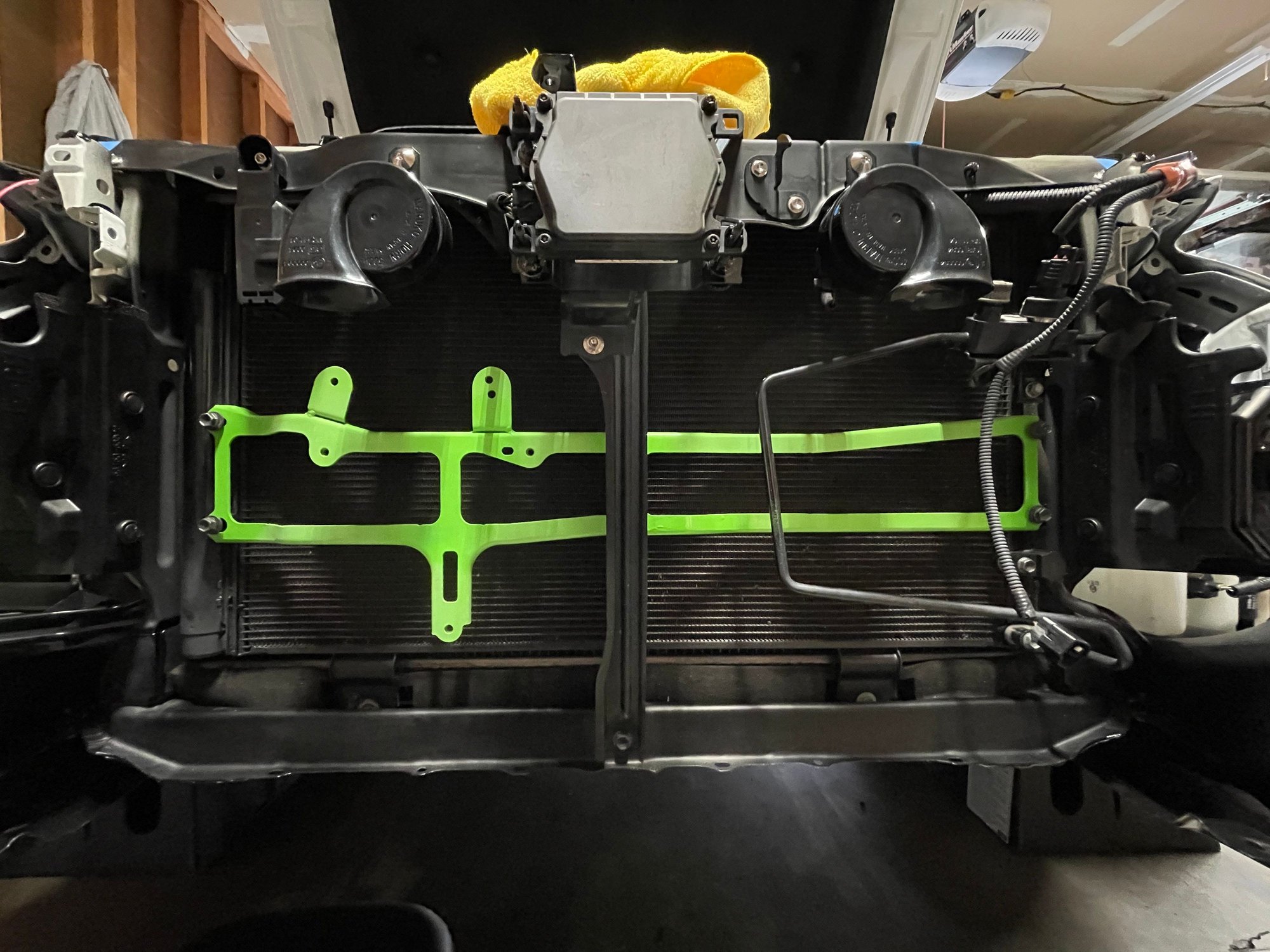

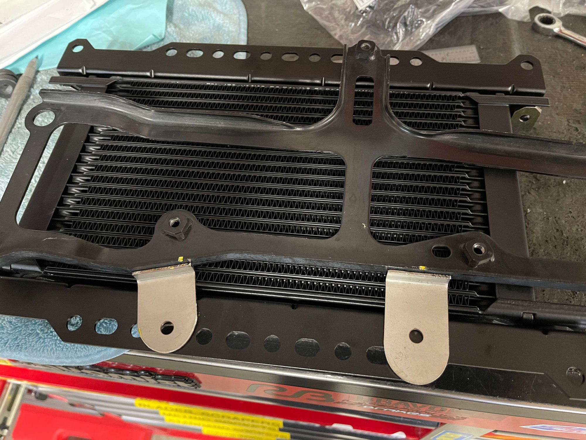

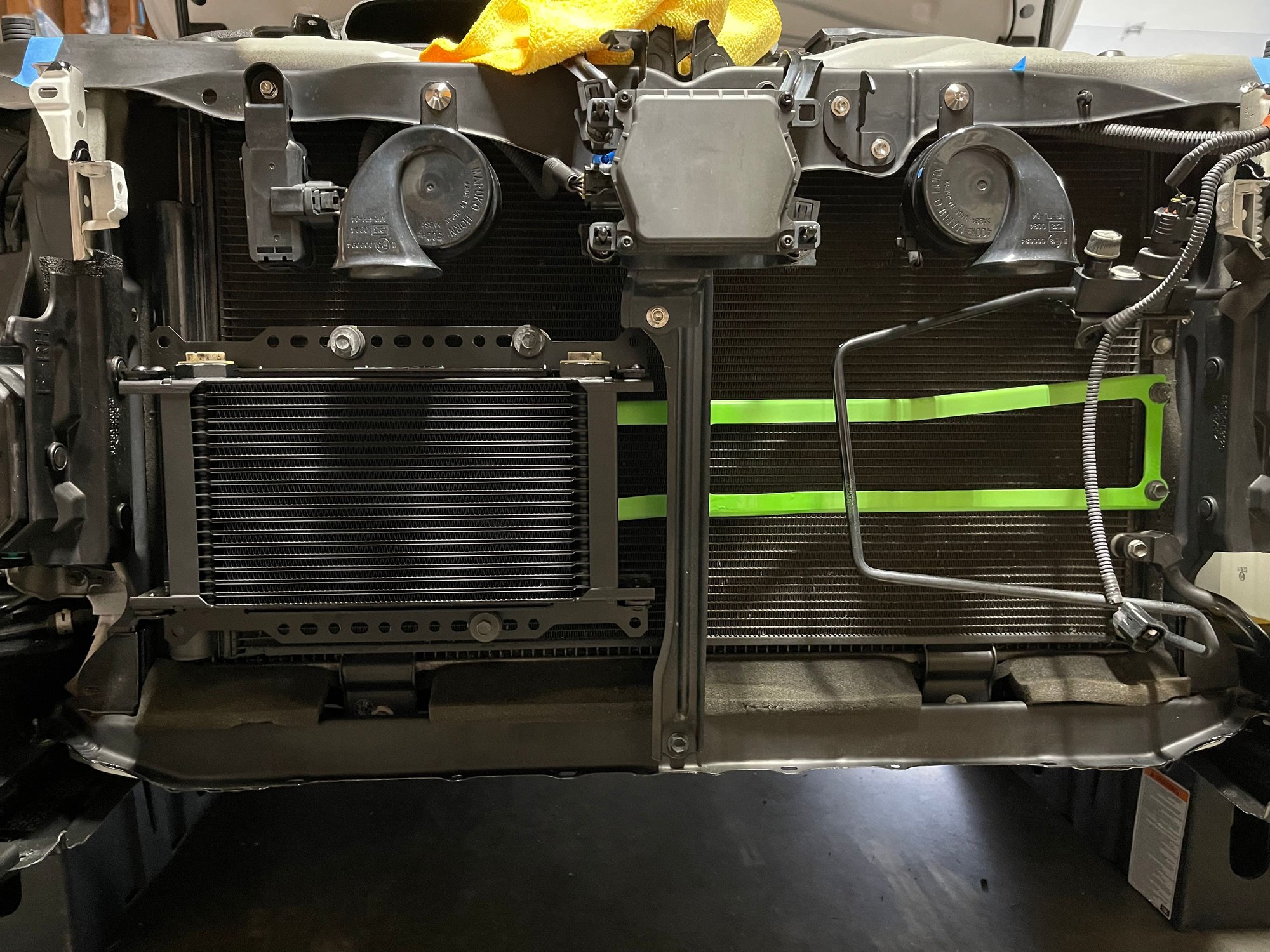

Got a Setrab 19 row cooler for the tranny oil since I’ll be installing a KOYO radiator. Modified the factory bracket and the Setrab brackets so I could mount the cooler the same way the factory cooler was.

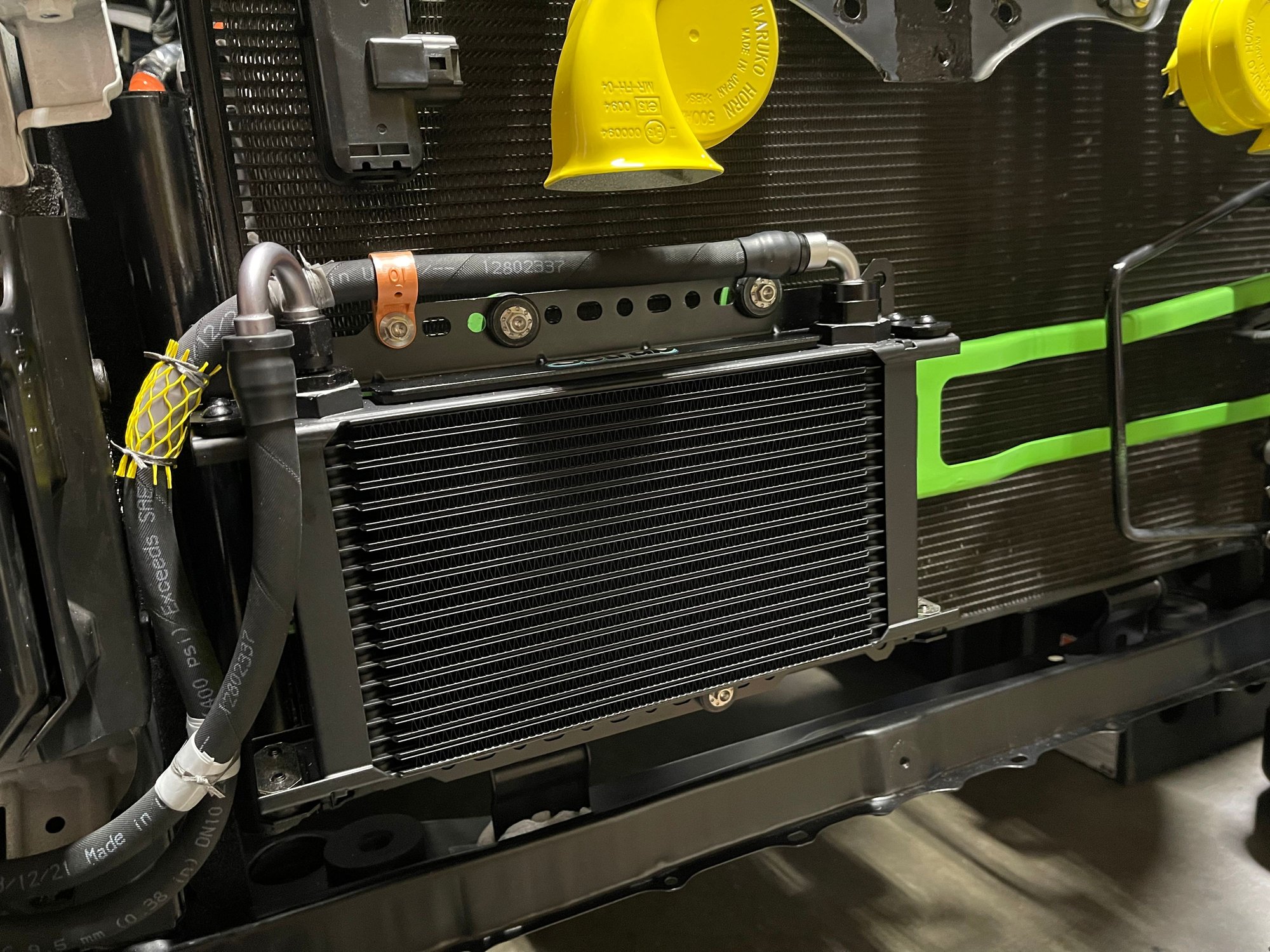

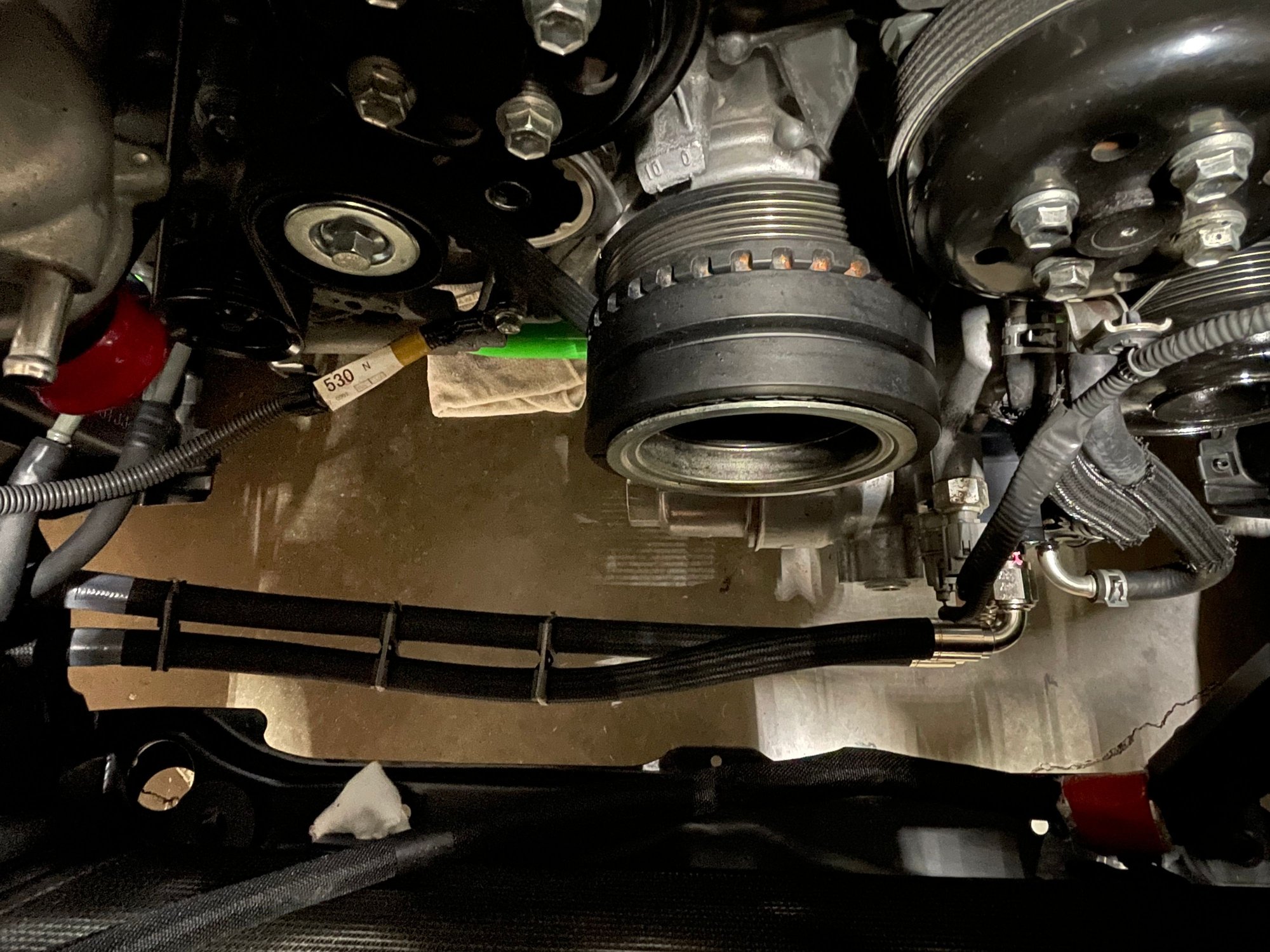

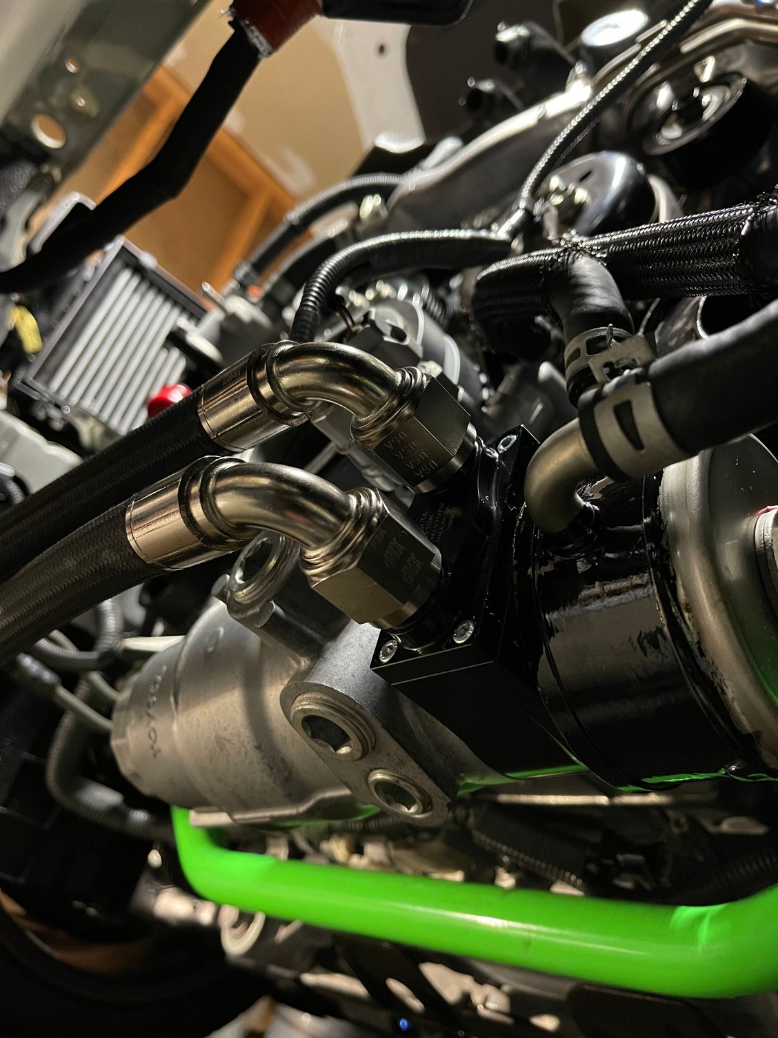

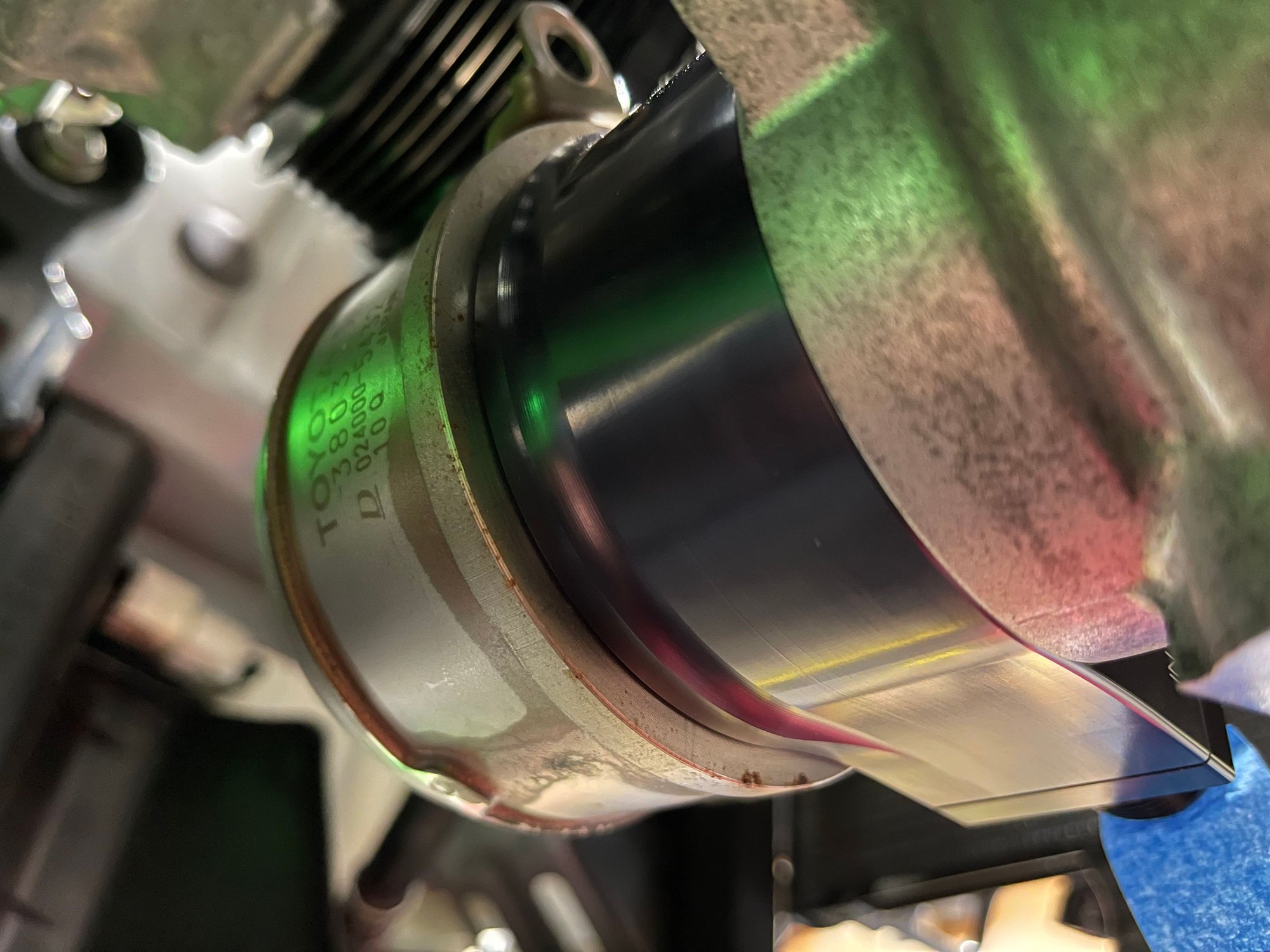

Figs engine oil cooler kit install.

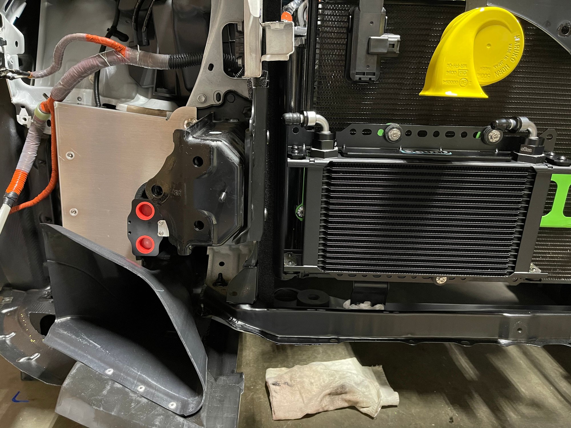

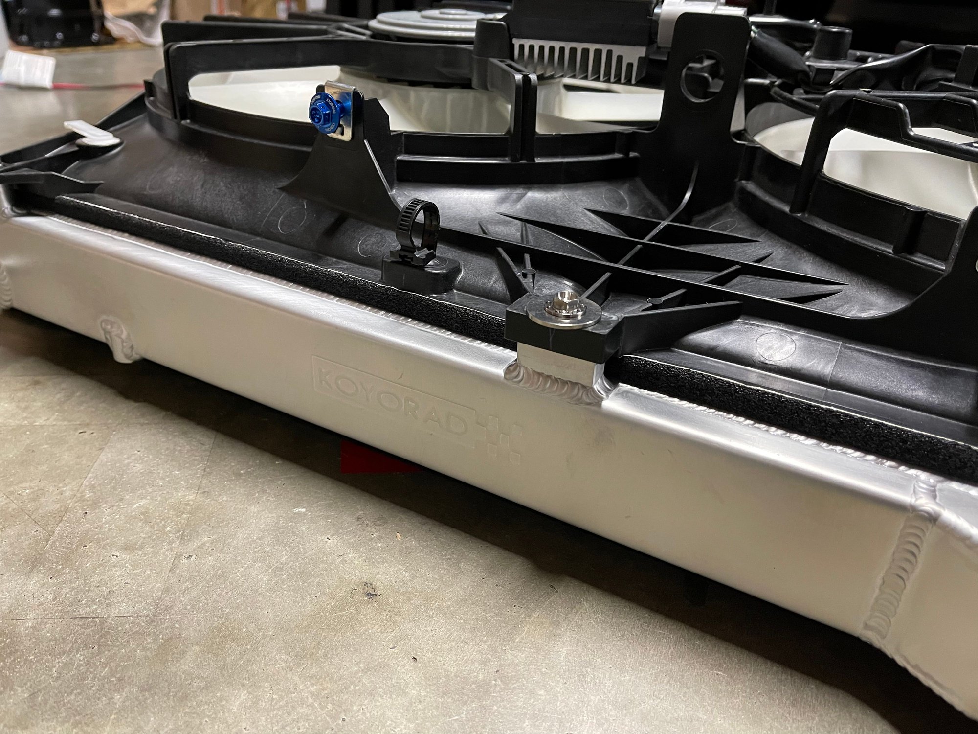

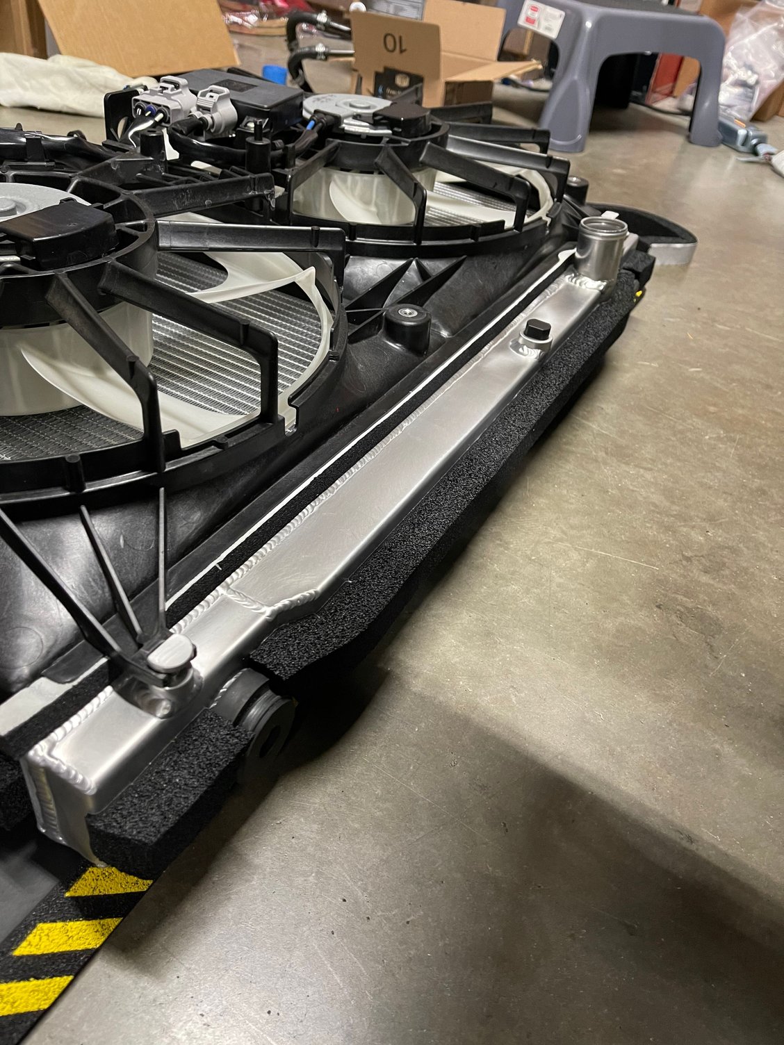

Making sure the radiator is sealed all the way around.

Setup looks awesome !!! Did you drop it in yet..??
My OEM foam is starting to fall apart a 2nd time.. The one you’re using looks way more durable.!!

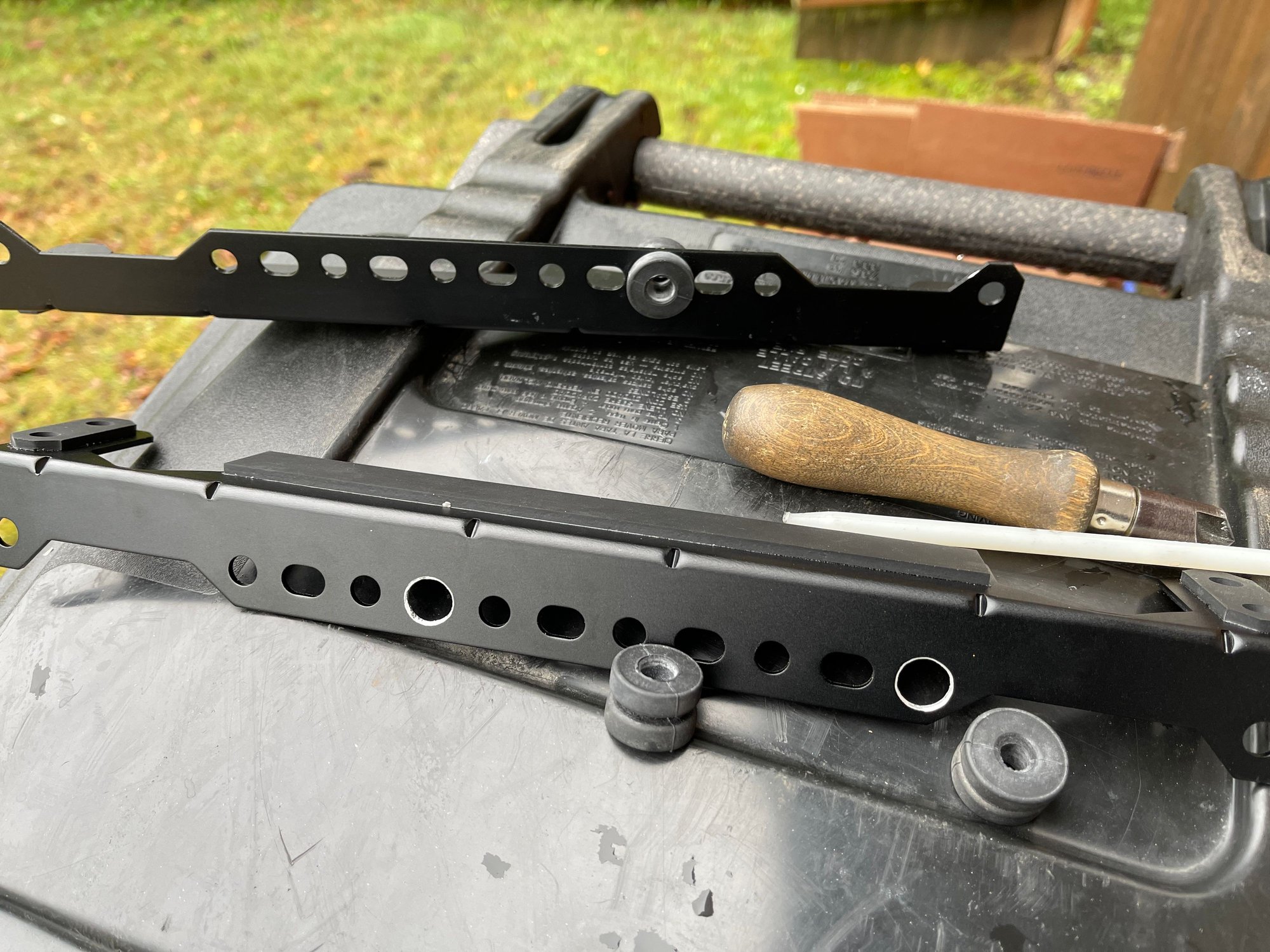

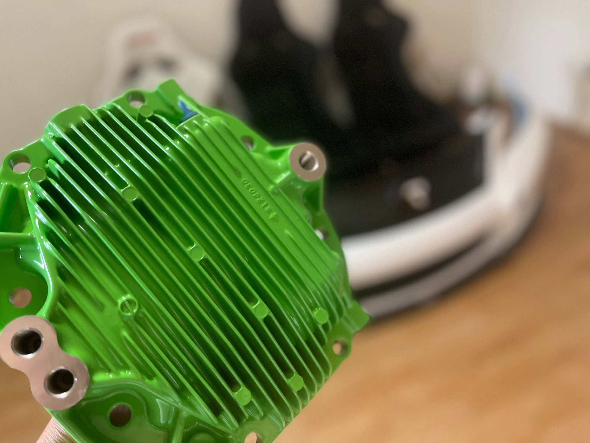

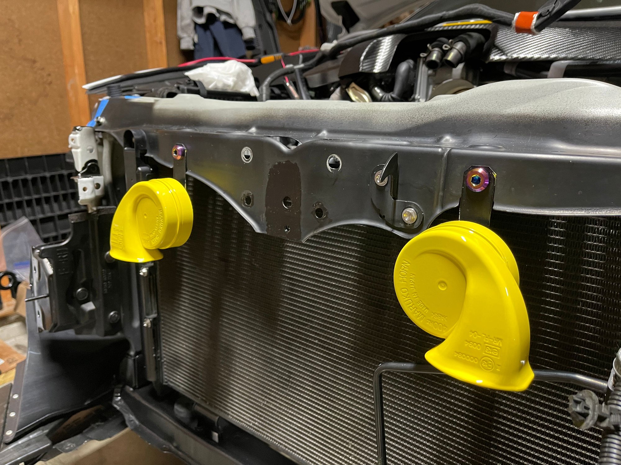

painted some parts while waiting for other parts to show up!

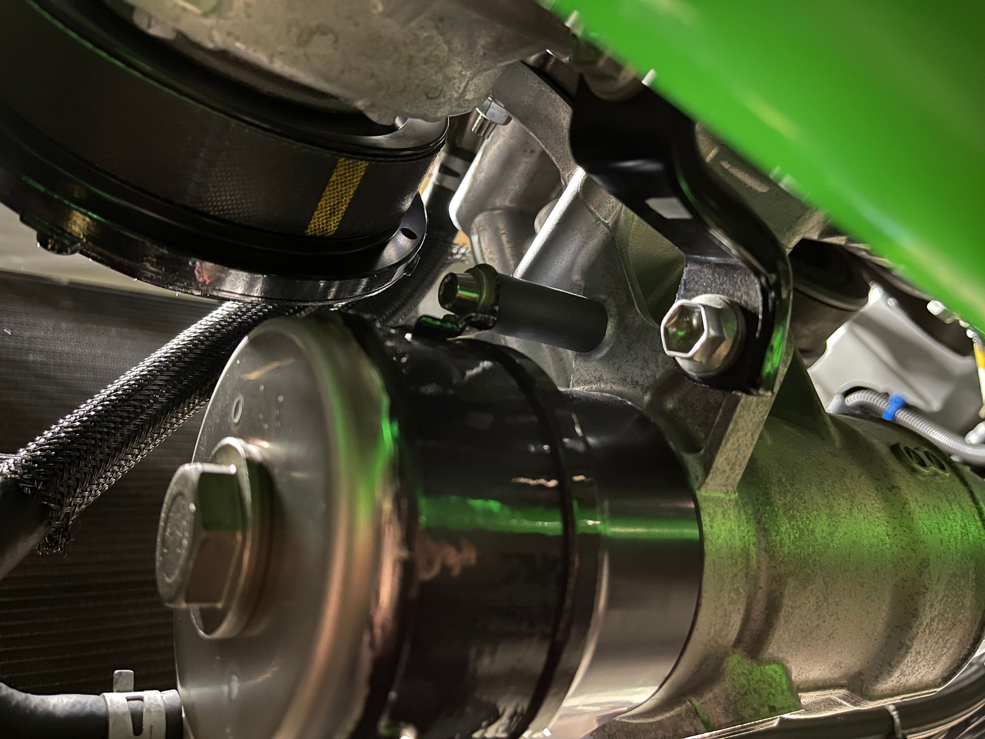

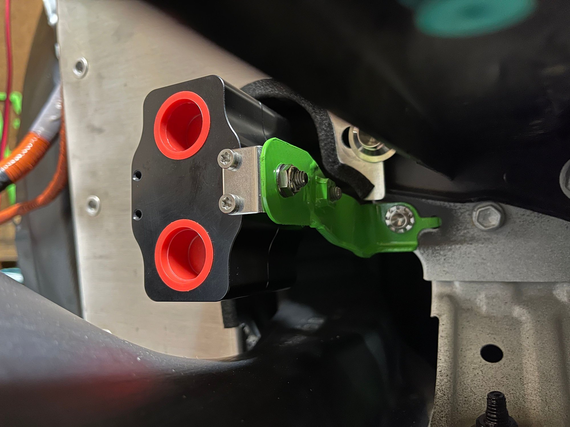

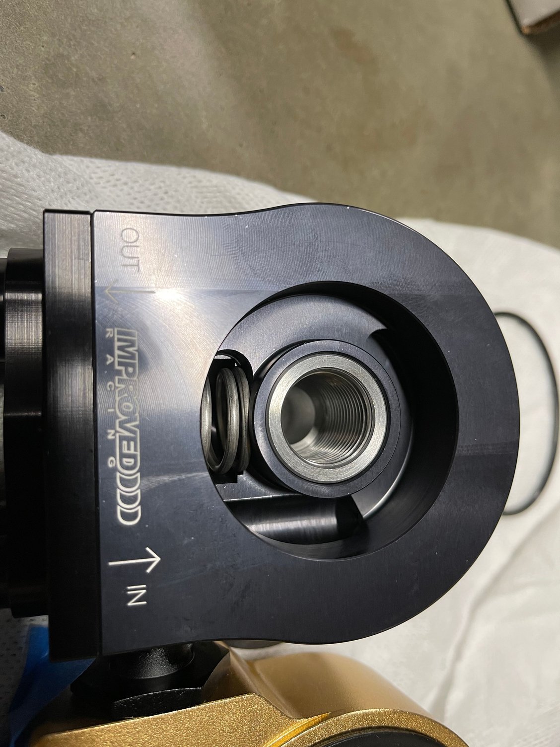

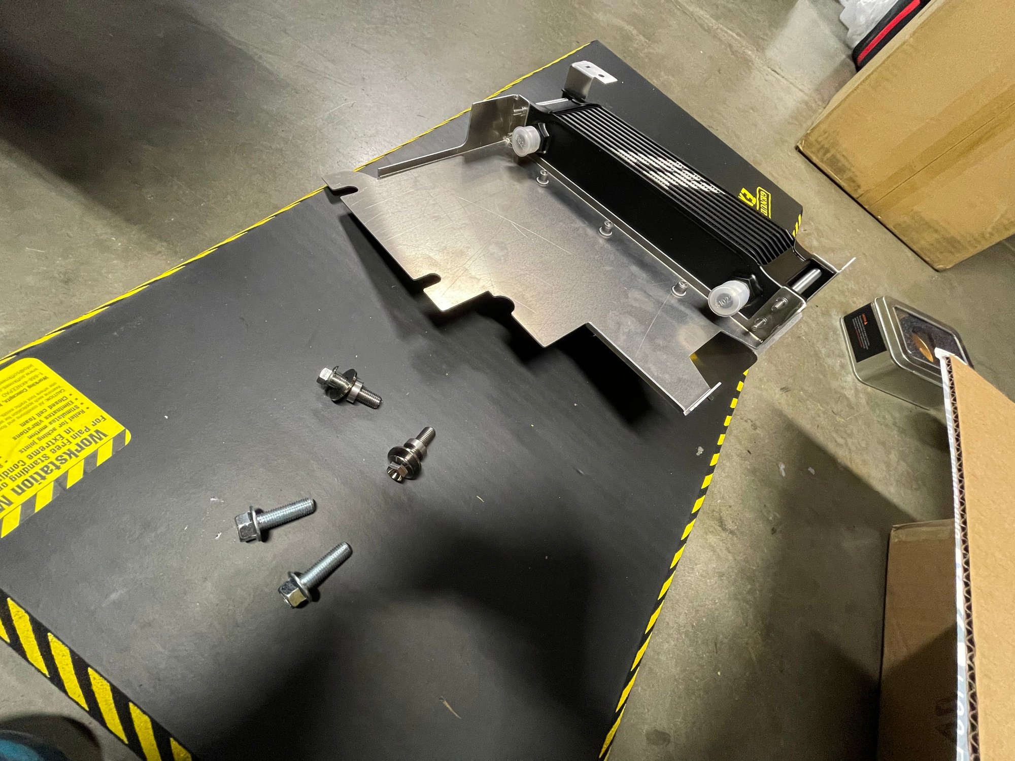

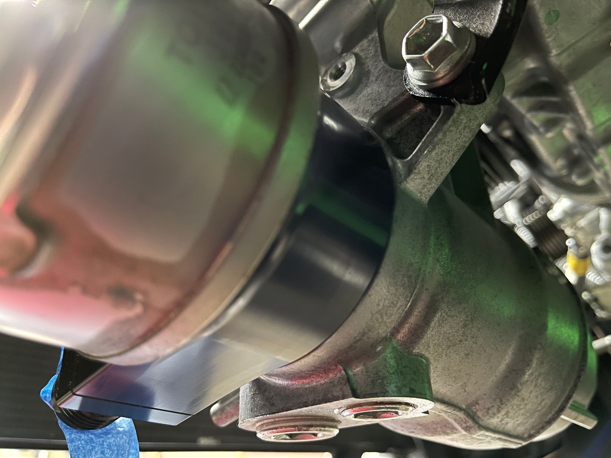

Improved Racing oil thermostats installed! Extended one of the factory brackets to mount the tranny oil thermostat.

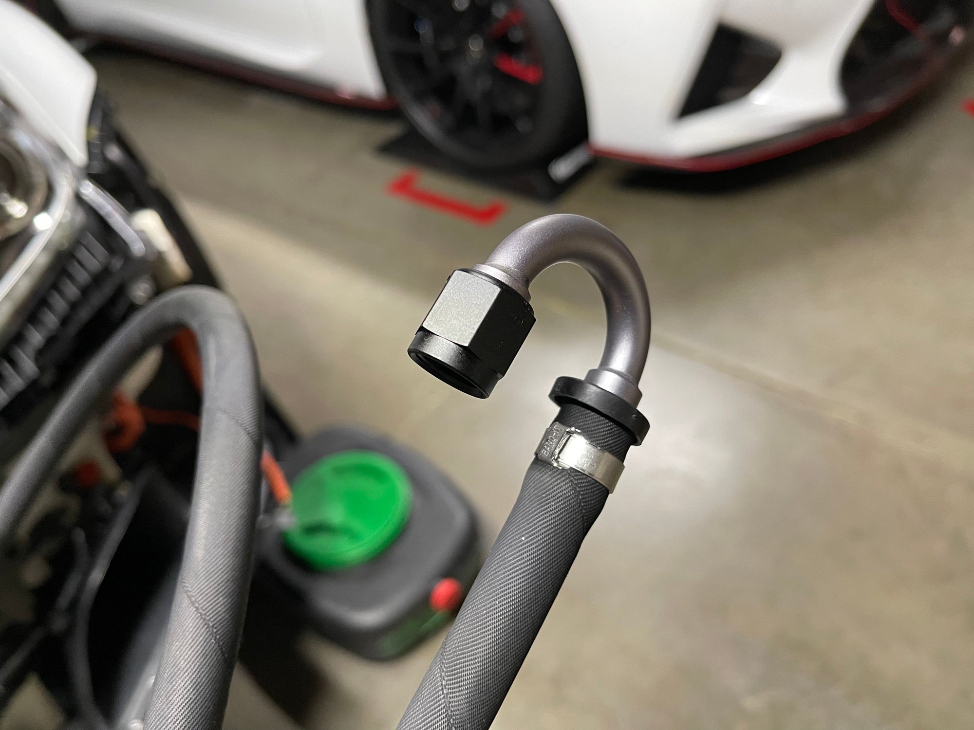

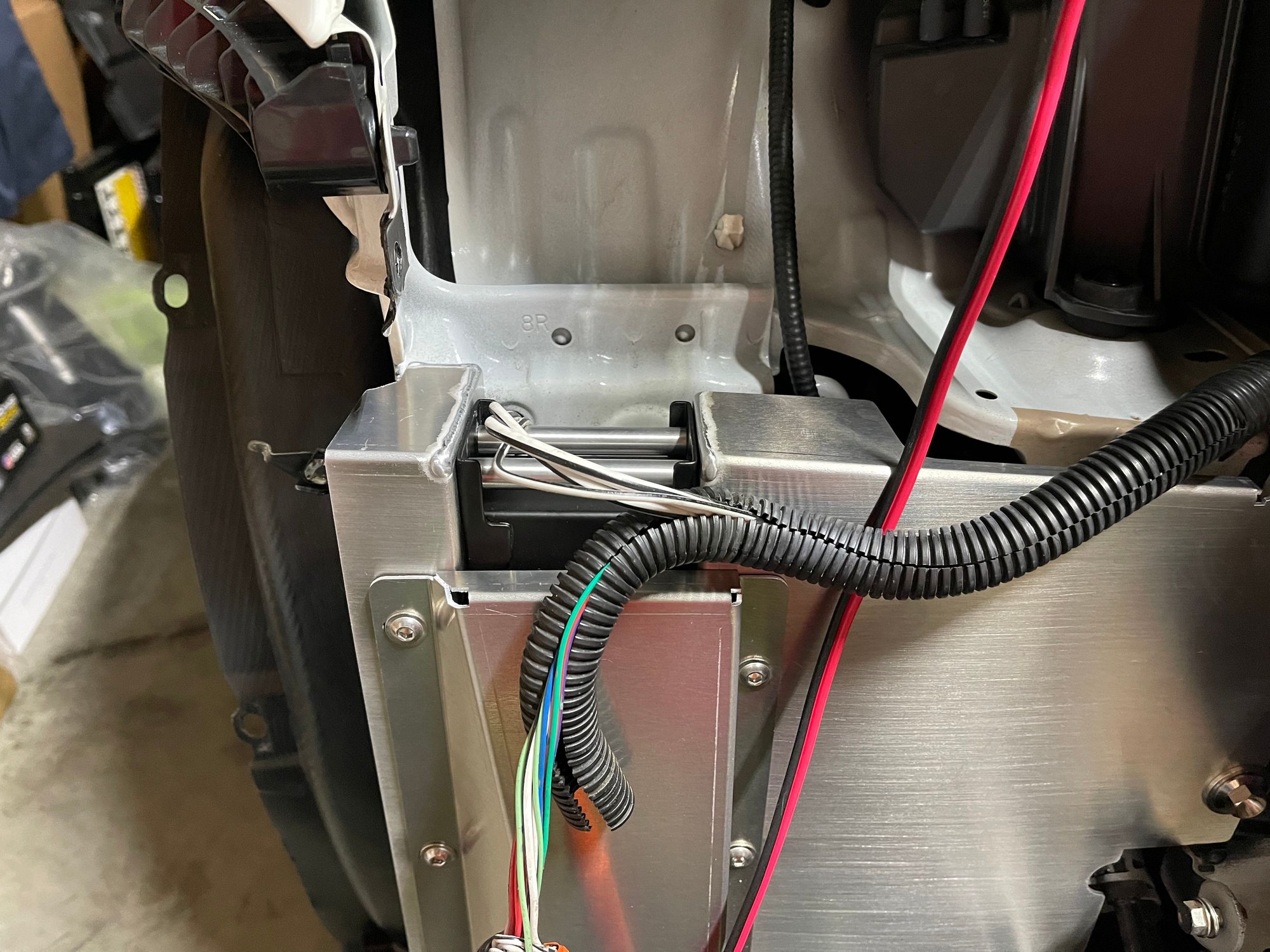

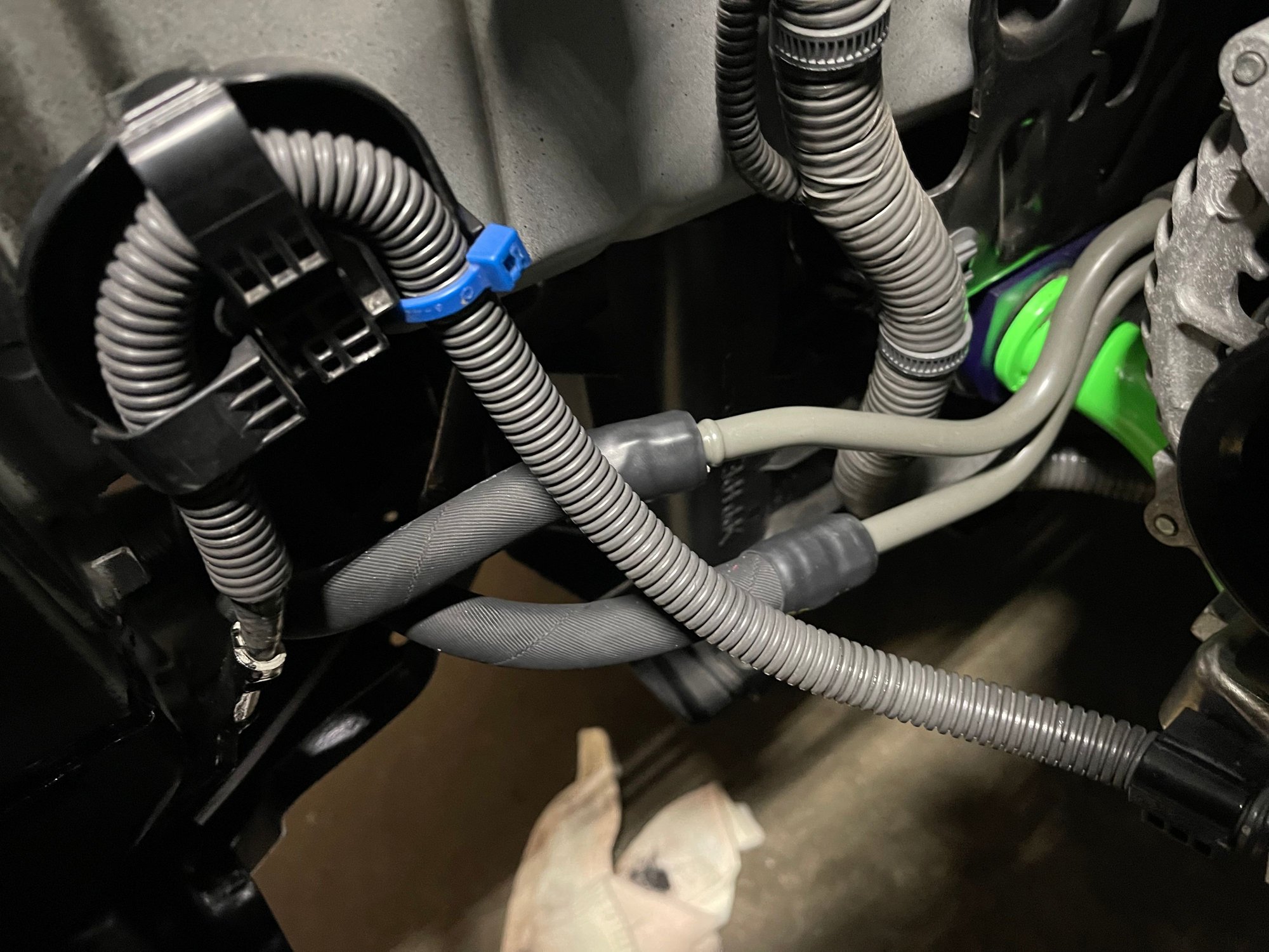

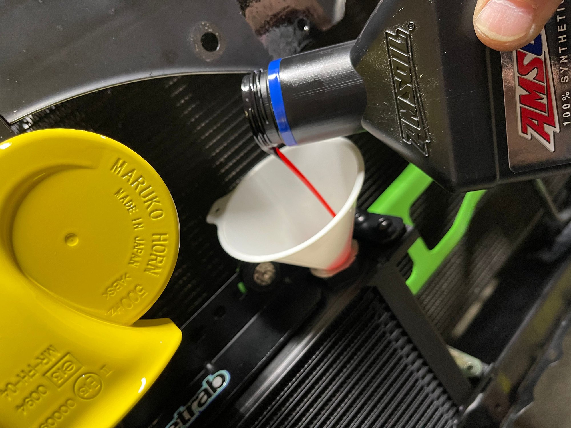

Some progress pics! Fittings and connectors finally showed up.
