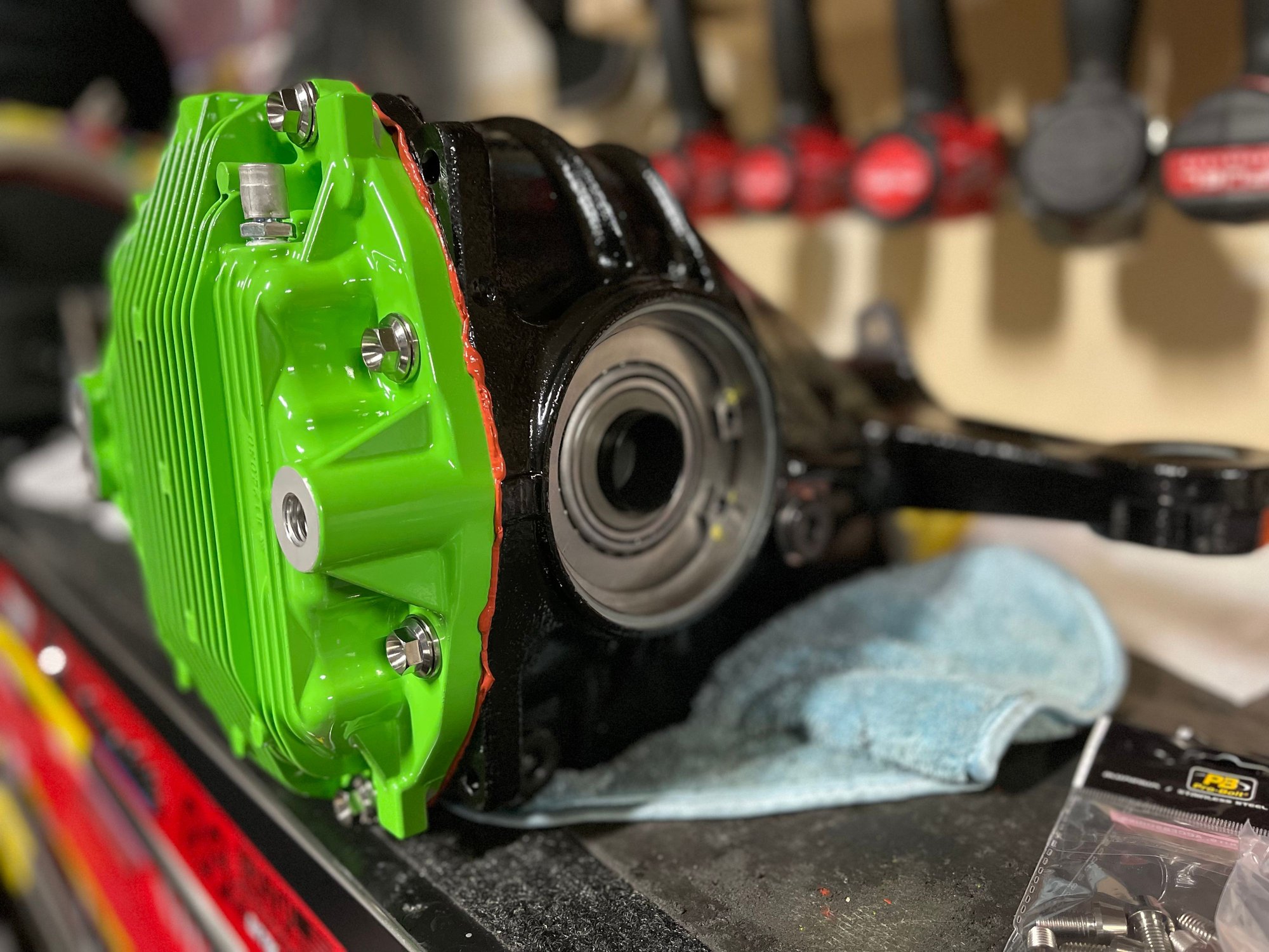

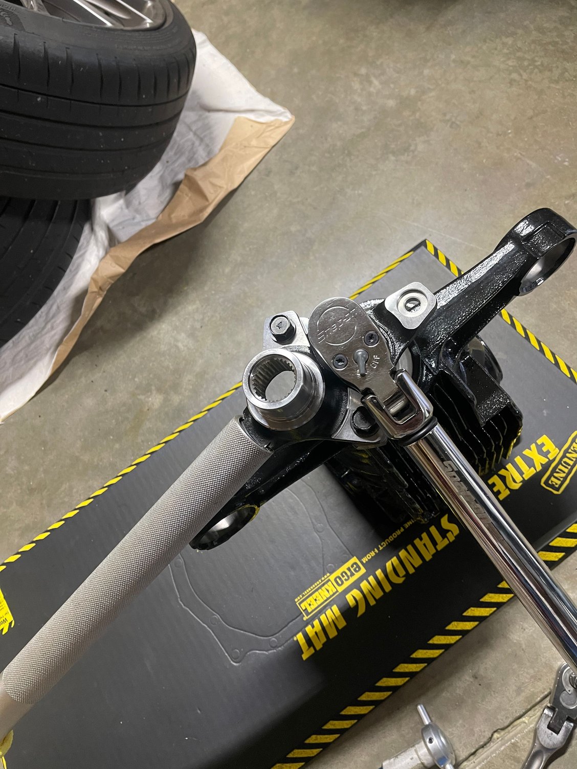

Torquing the pinion nut and setting preload. Made an SST out of an old companion flange. It took well over 300 ft/lbs. to get the new sleeve to crush. Got the preload set right at 13in-lbs.

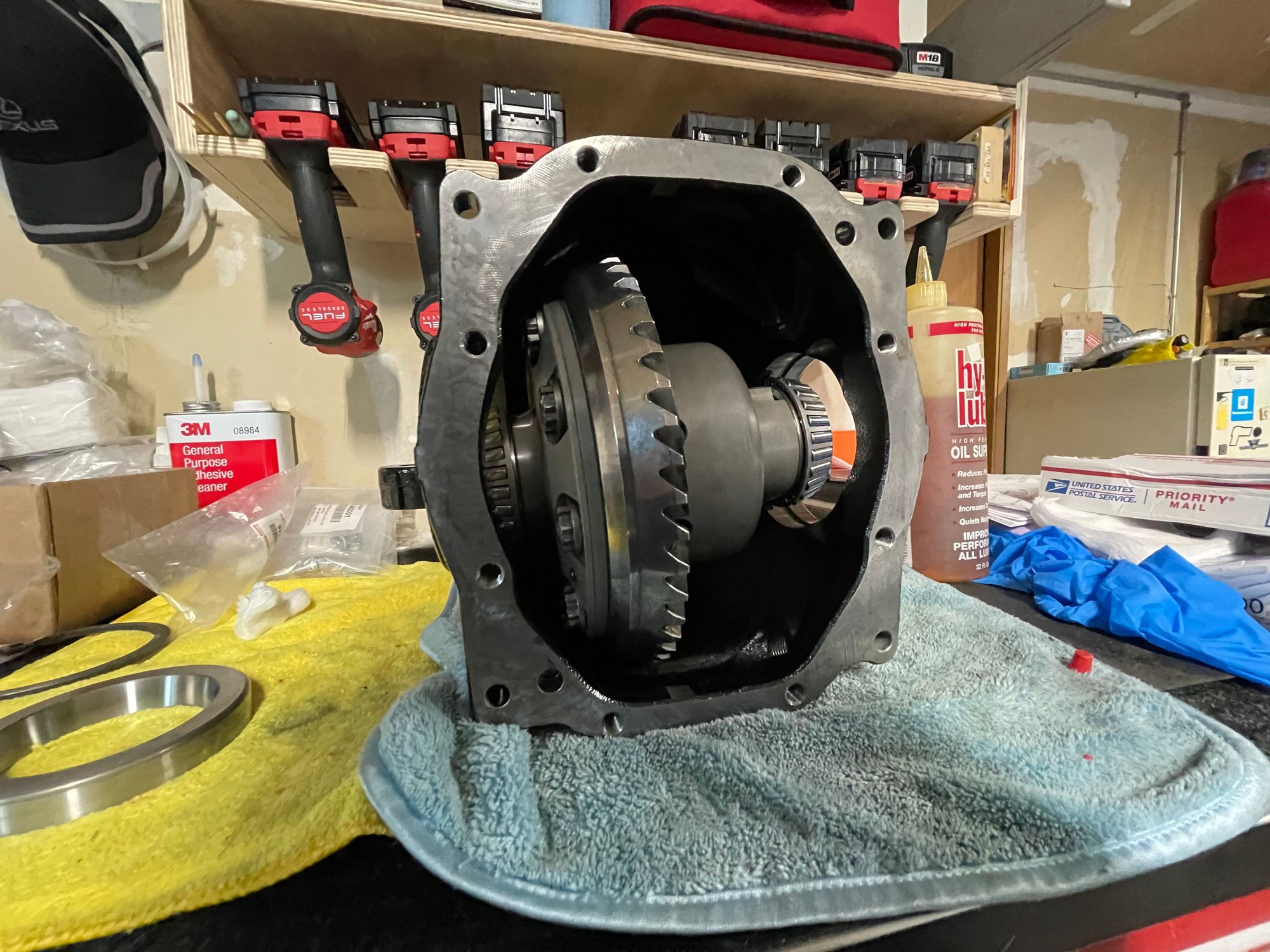

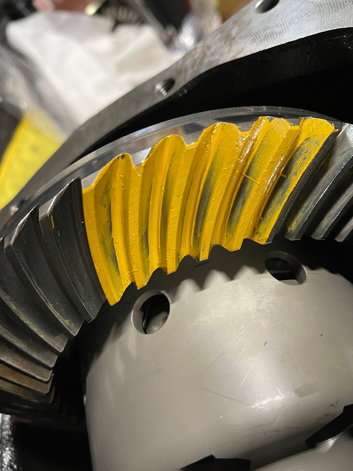

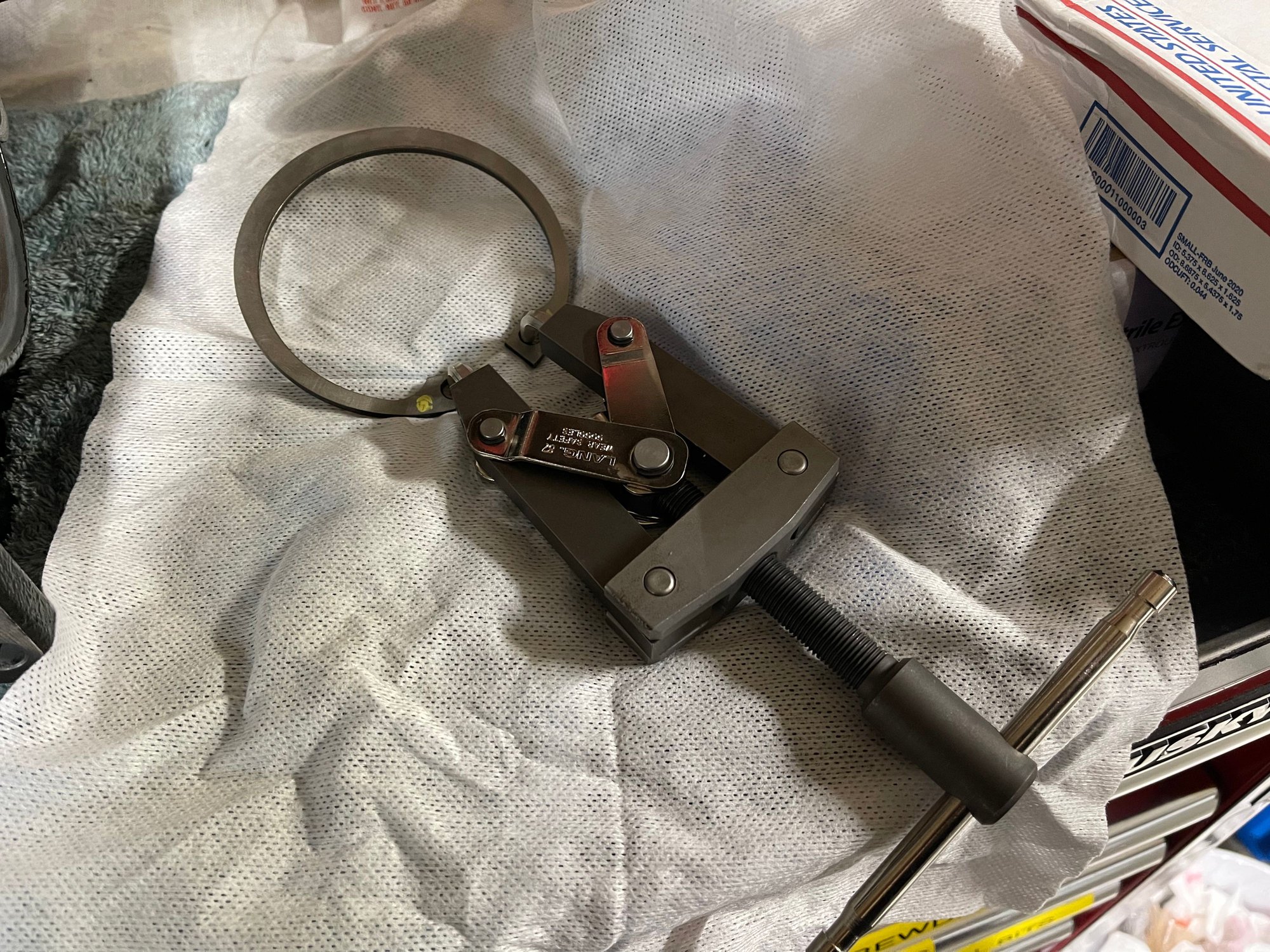

Went with .08mm thicker snap ring on the ring gear side and .08mm thinner on the other side. Got the backlash to just over .07mm (spec is .08-.13) so I’d call that good. Total preload is also at the middle of the spec range at just over 20in.-lb. (spec is 17-30in.-lb.) and tooth engagement pattern looks good!

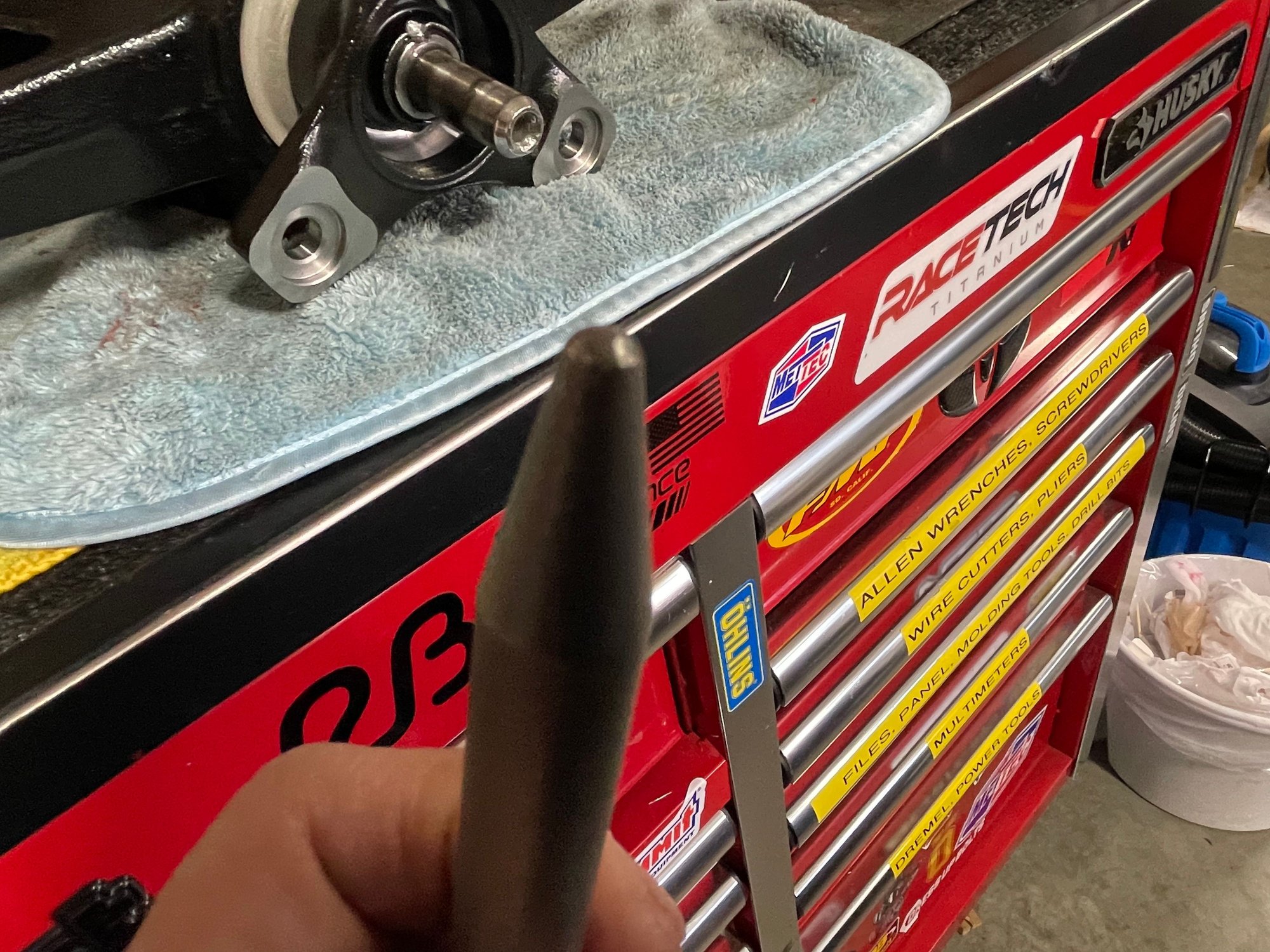

I rounded off one of my air hammer bits so I could do a proper stake on the pinion nut.

Old Jan 15, 2022 | 11:59 AM

I'd be happy with that tooth pattern. Looking really good!
Thank you! I'm very satisfied with it too!

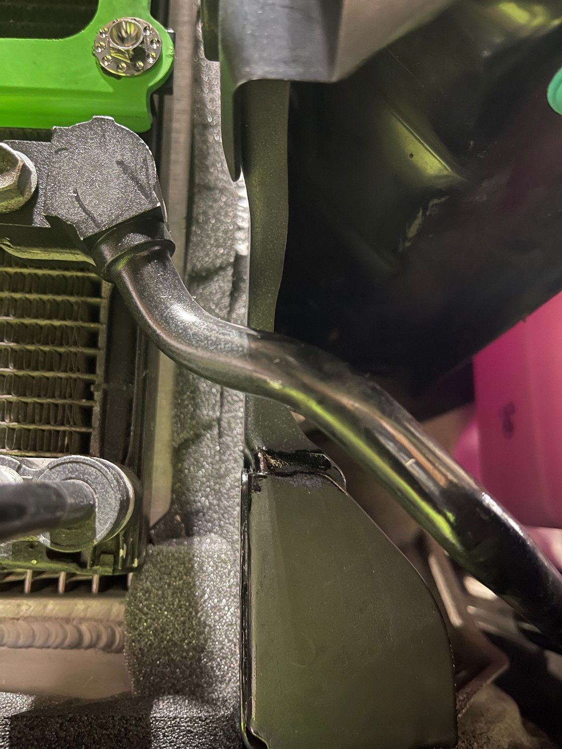

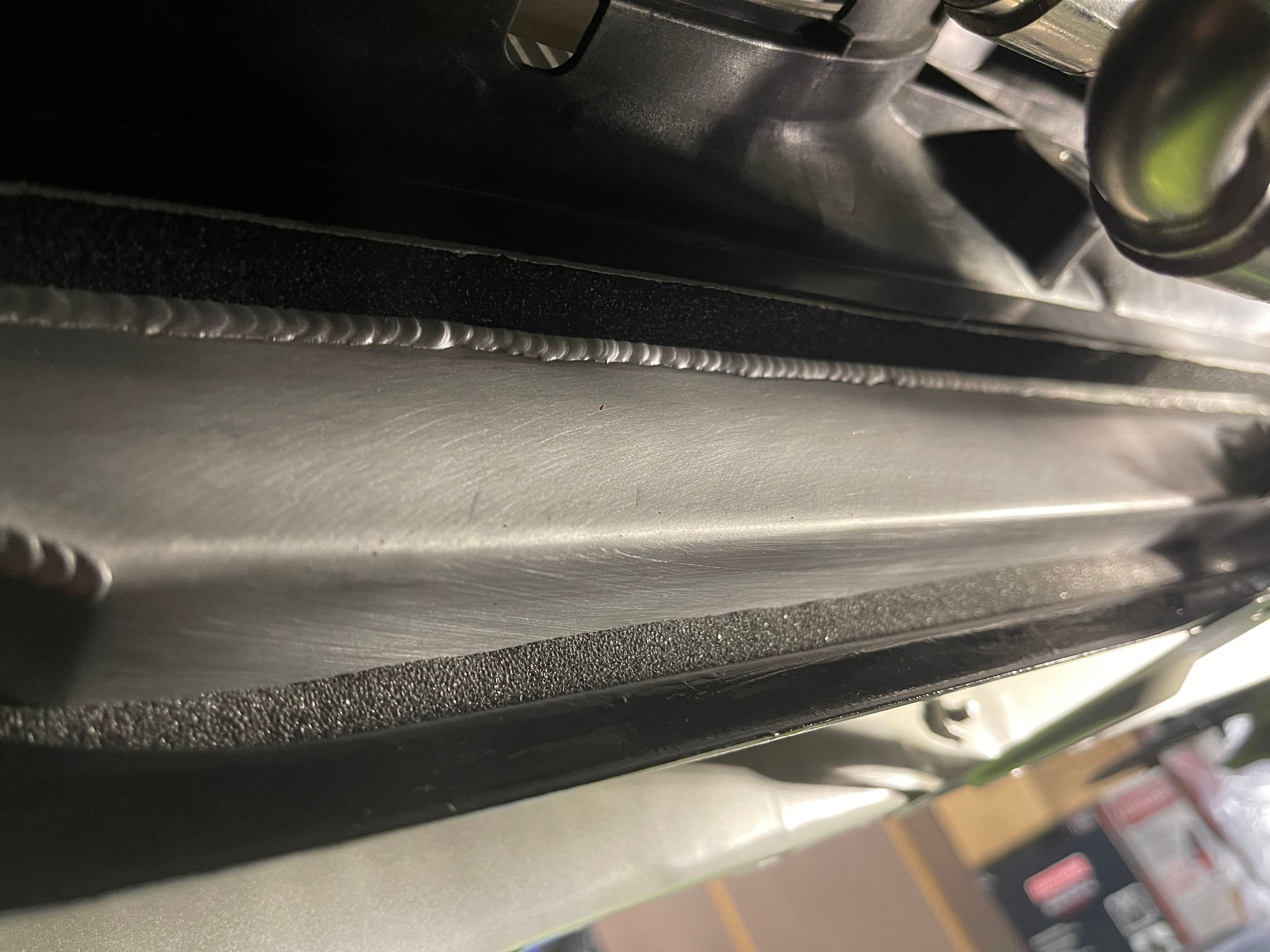

Foam seal around the radiator. Decided not to use the foam I ordered through Amazon after hearing some people’s experience with it; it doesn't last more than a year before it starts deteriorating. I ordered some silicone foam from McMaster Carr in late October and recently got a status update; still 9-12 weeks out. Luckily, I found a roll of adhesive backed foam in our scrap bin at work and decided to test it for heat resistance. Nothing happened to it until well over 400F, and even then, it had very little effect on it. So, that’s what I used! I applied it around the core support to provide a good seal around the radiator.
