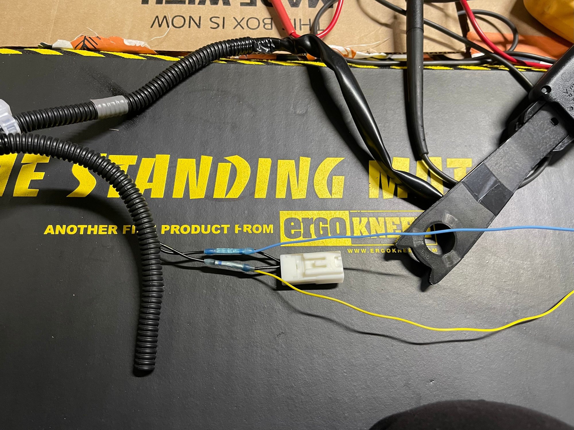

I have a ’14 and want to upgrade my fog lights, on the Diode Dynamics SS3 Max yellow fog lights
Which model did you go with, Stage Series 3" SAE/DOT Type B?
Was it a straightforward install or did you have to modify the housing and plugs?
Thank you for sharing your build, again truly amazing
hi, Thank you! And sorry, haven’t checked my build thread in a bit. I went with these, purchased through Figs Eng’g.
https://shopfigs.com/v5/DD6687-ss3fo...?search=SS3%20
plug and play, but I chose to splice the new harness adapter to my factory wiring. HTH!

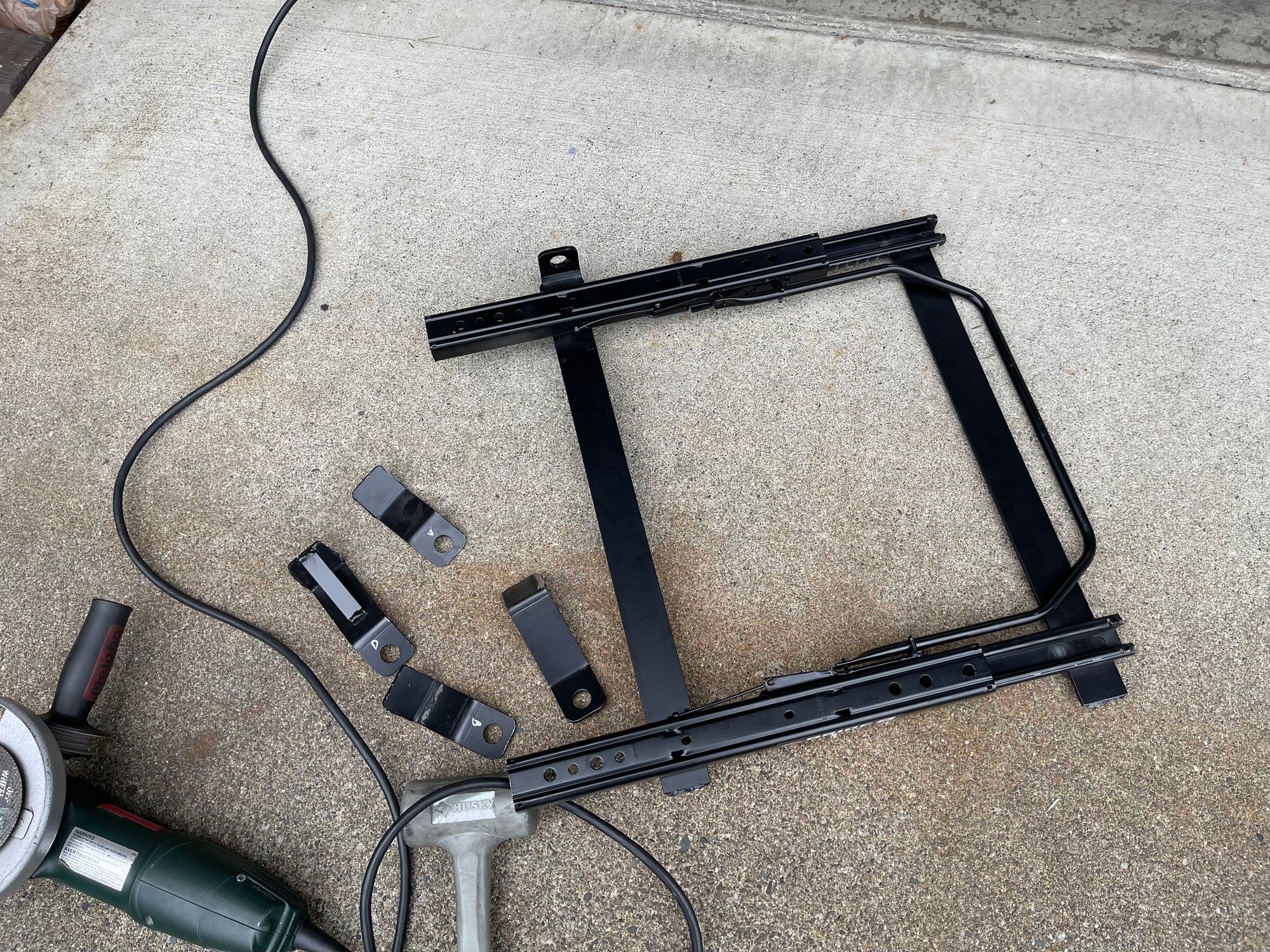

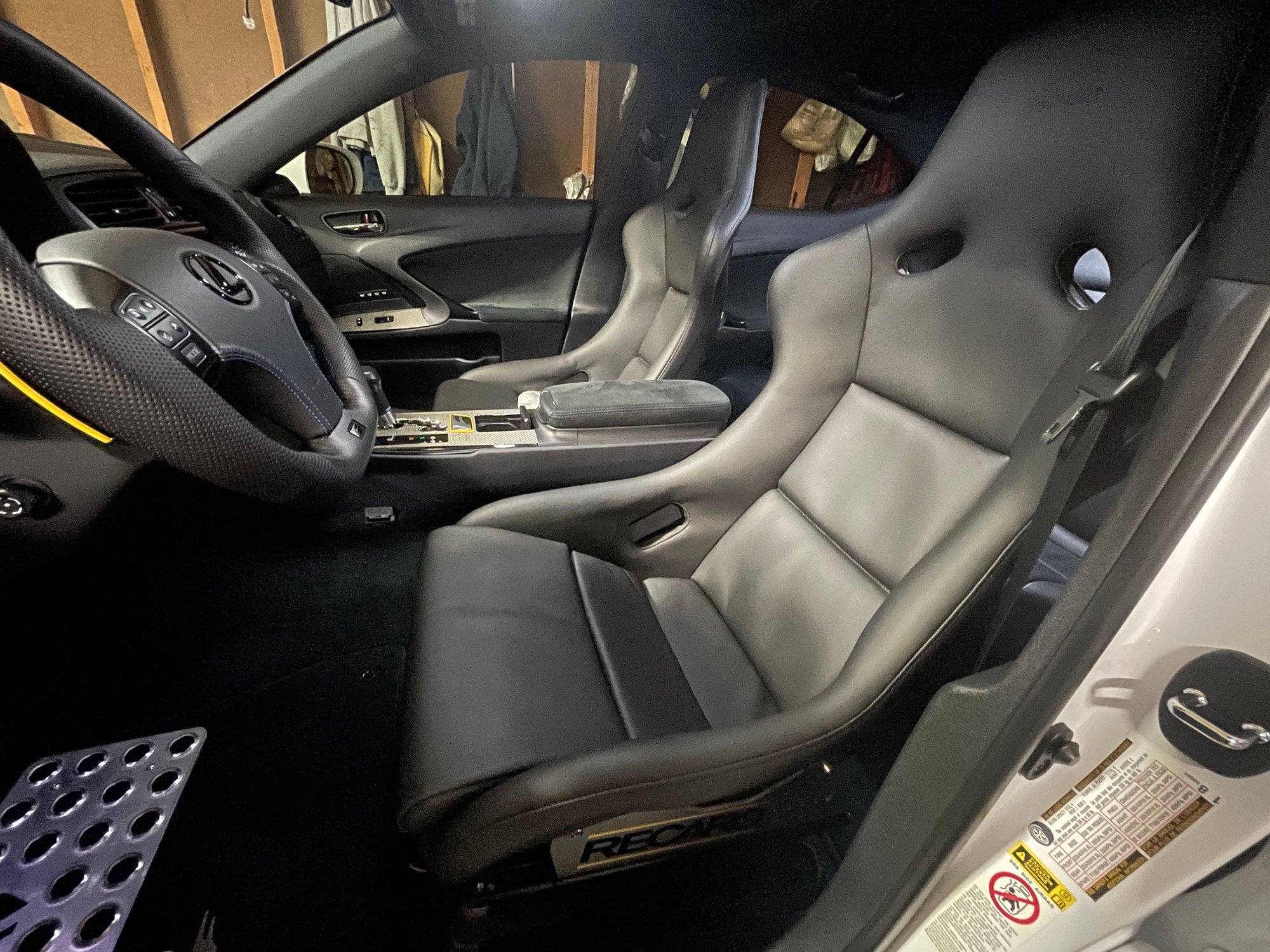

Finally got around to install the pole positions! A little bit of wiring and everything works on both sides. Had to modify an RC F Bride rail so the passenger seat clears the b pillar

Looks good. Your bride mount will weigh less than mine. Did the Figs mounts fall through?

Thanks! Yes, I like how minimal the Bride base is. FIGS aren't done yet

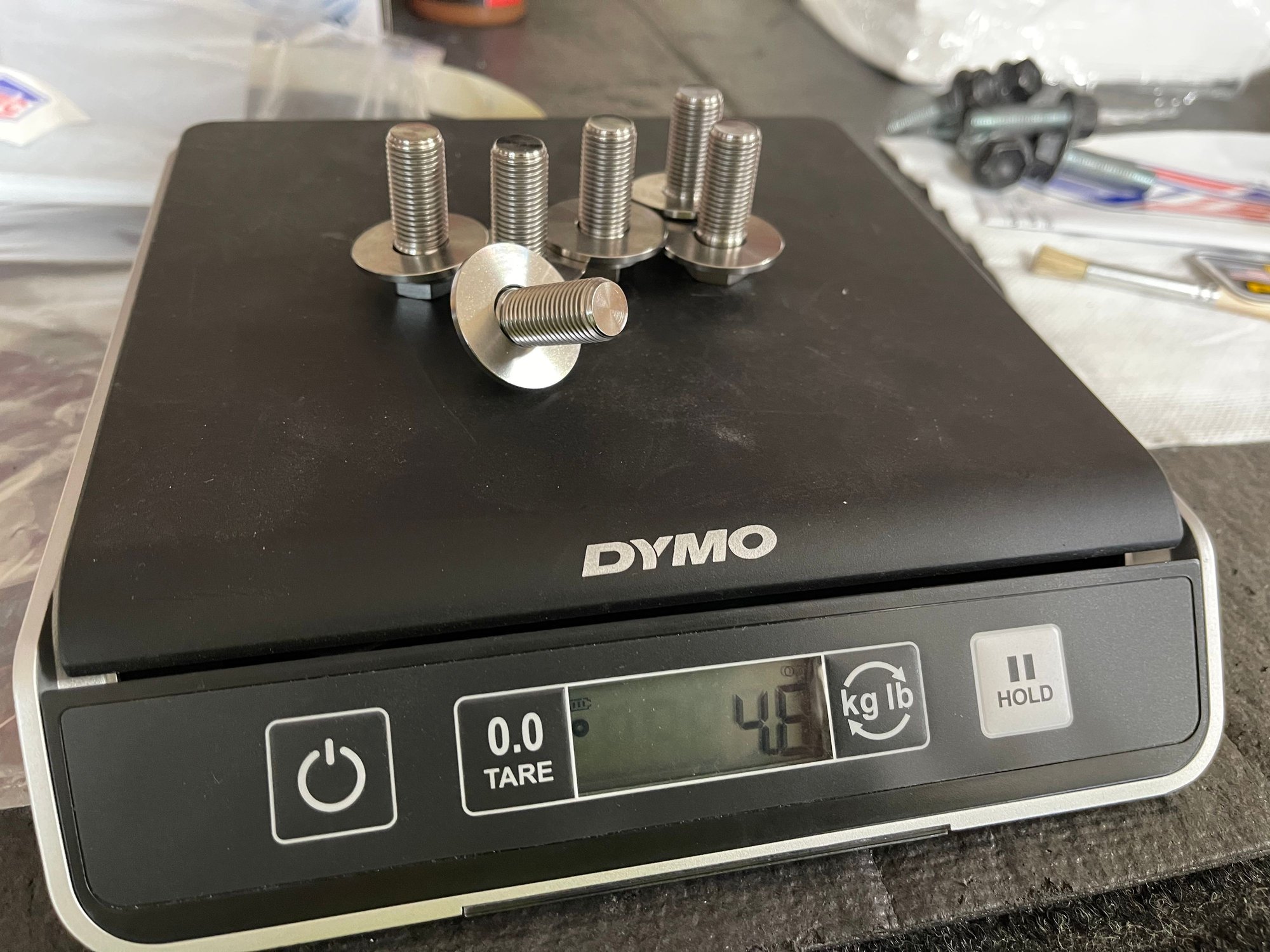

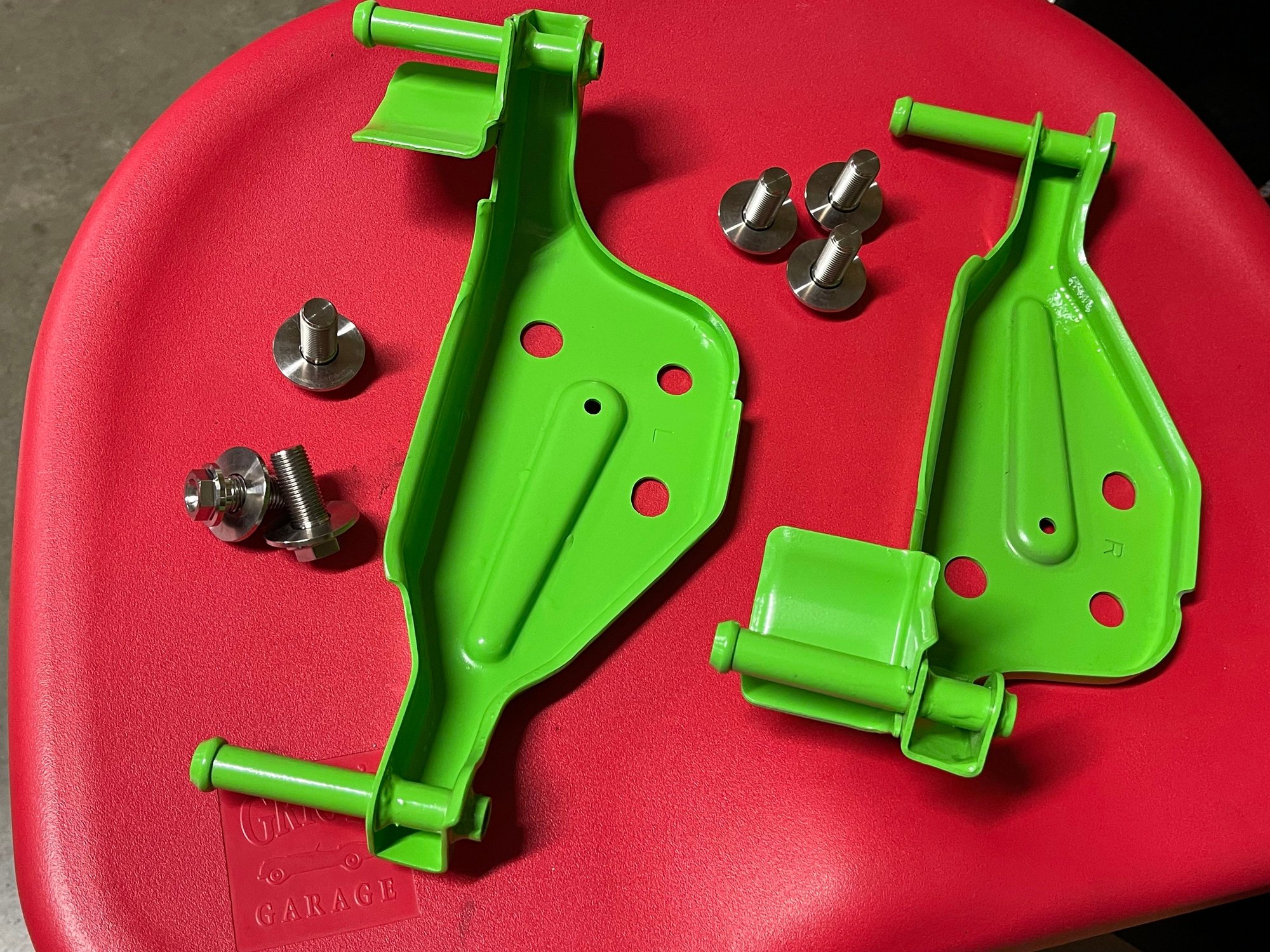

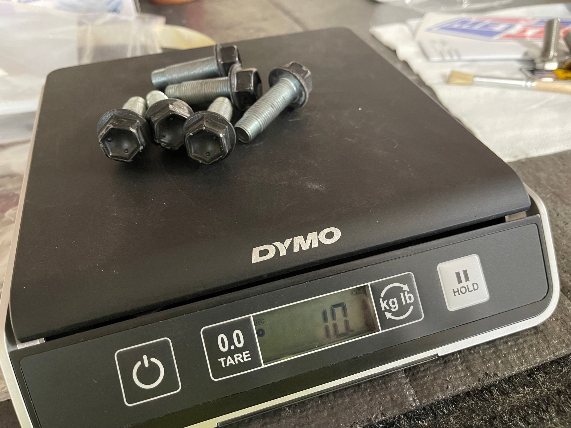

Painted the rear exhaust brackets, and replaced the bolts with titanium, as usual.

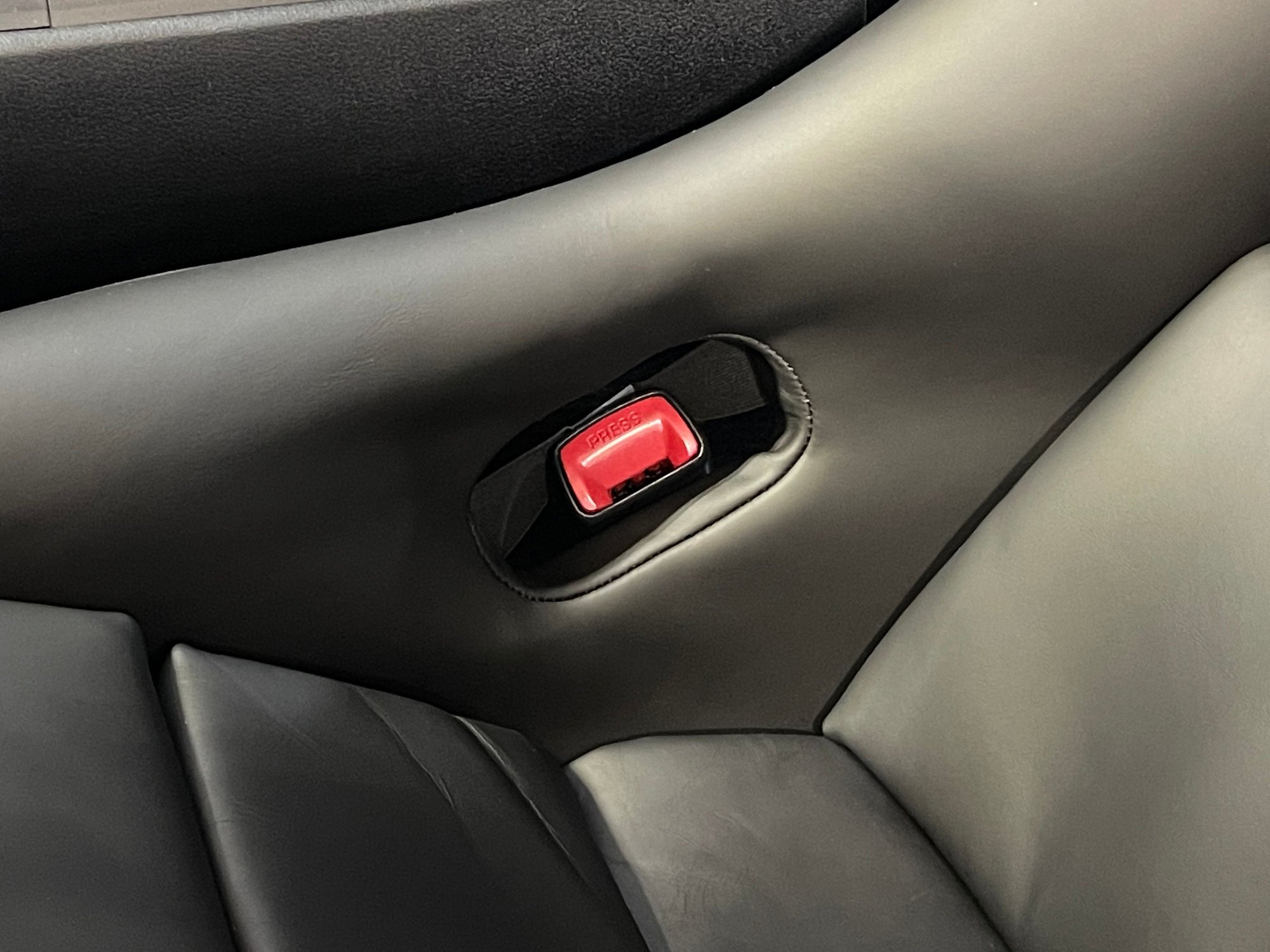

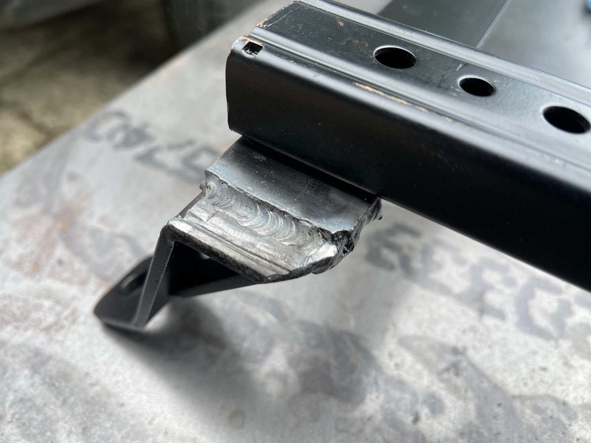

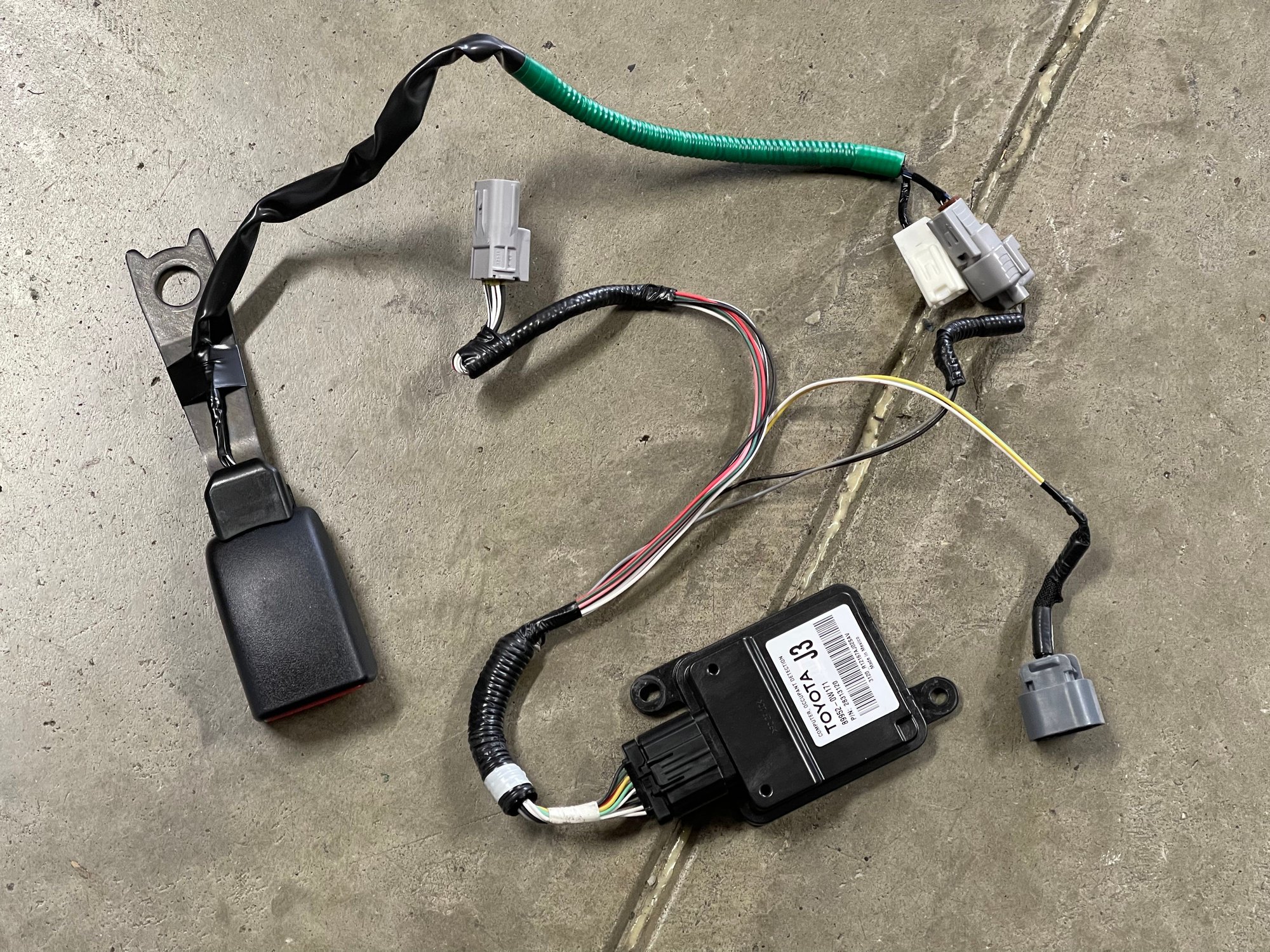

Moved the belt latch from the seat base to the side mount, so it moves with the seat. Also reshaped the metal for easier latching and unlatching of the belt.

That is clever. It’s massively annoying when its bolted to the planted mount. The Recaro ISF specific rails have it mounted to the slider
so that it moves with the seat as well.

Thanks! I thought about welding a tab on the slider but I figured this was a quicker way. Did you get your Recaro sliders?

I see. Same with the Bride, it’s a little more level than the Sparco or Planted so your weight doesn’t automatically slide you back when you pull that lever up. I think the FIGS have wider base material on the front and rear but he’s using slightly thinnerl material. So, they could end up the same.
