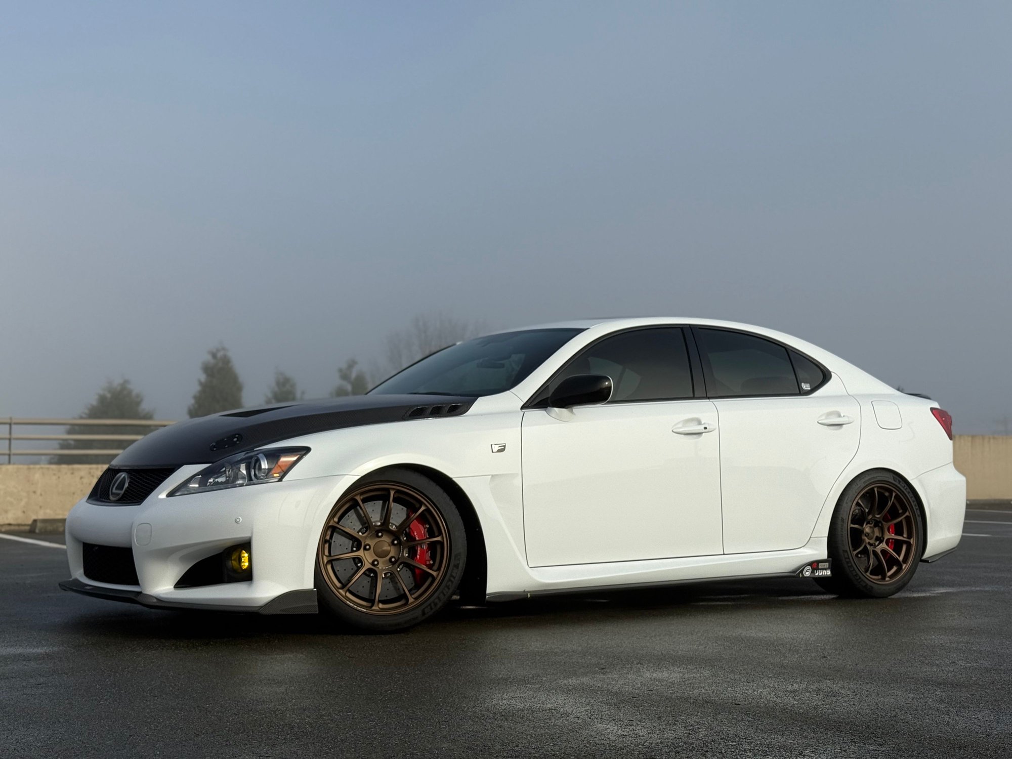

added a little more yellow to go with the calipers.
May I ask what the process was to paint the outline of the F emblem yellow and what material you used? This looks amazing!
Thanks! I didn't paint them, I used vinyl pin stripe. some heat using a heat gun (or maybe hair dryer?), and you can make the vinyl wrap around and stick on the sharp corners. HTH

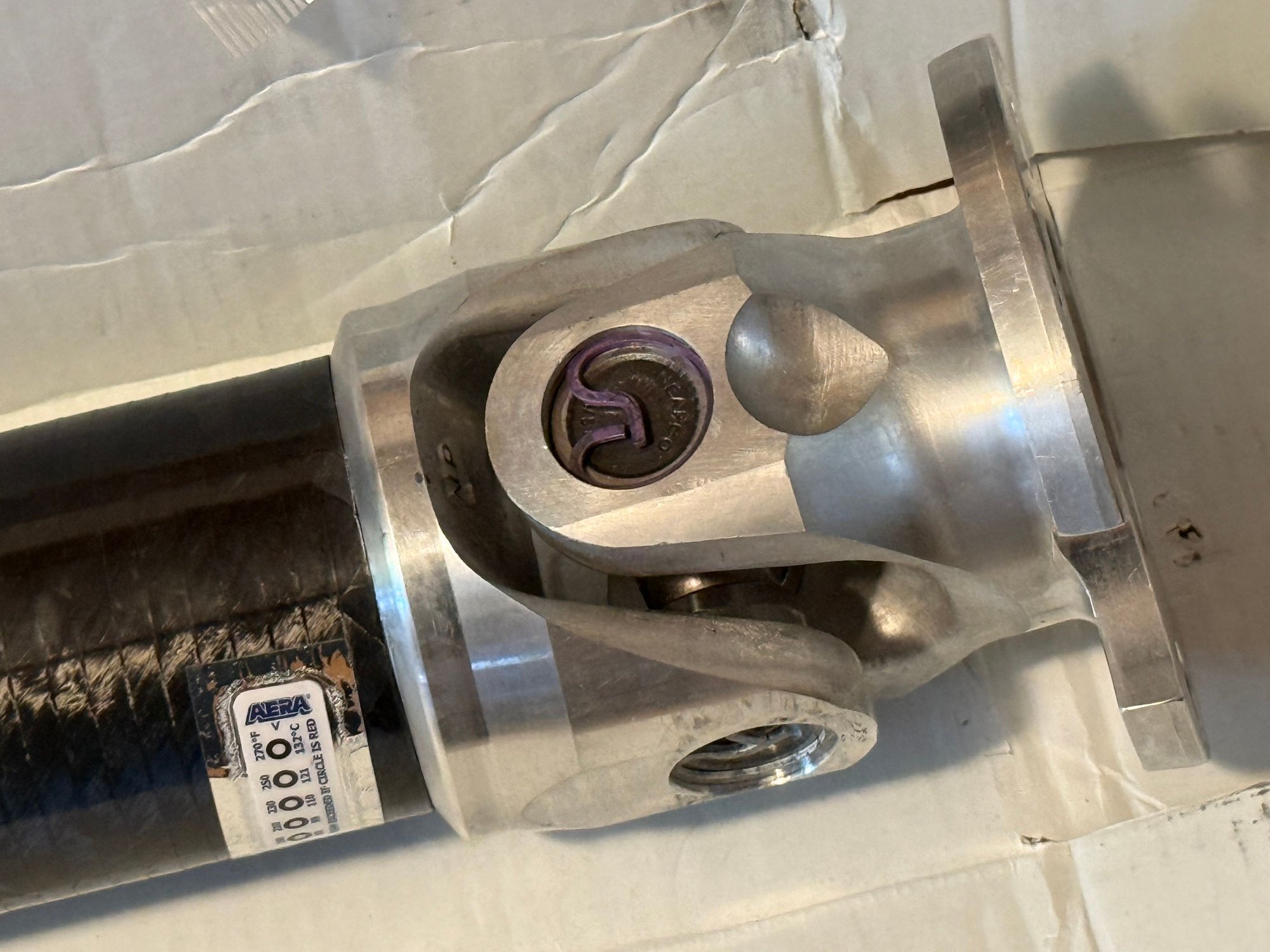

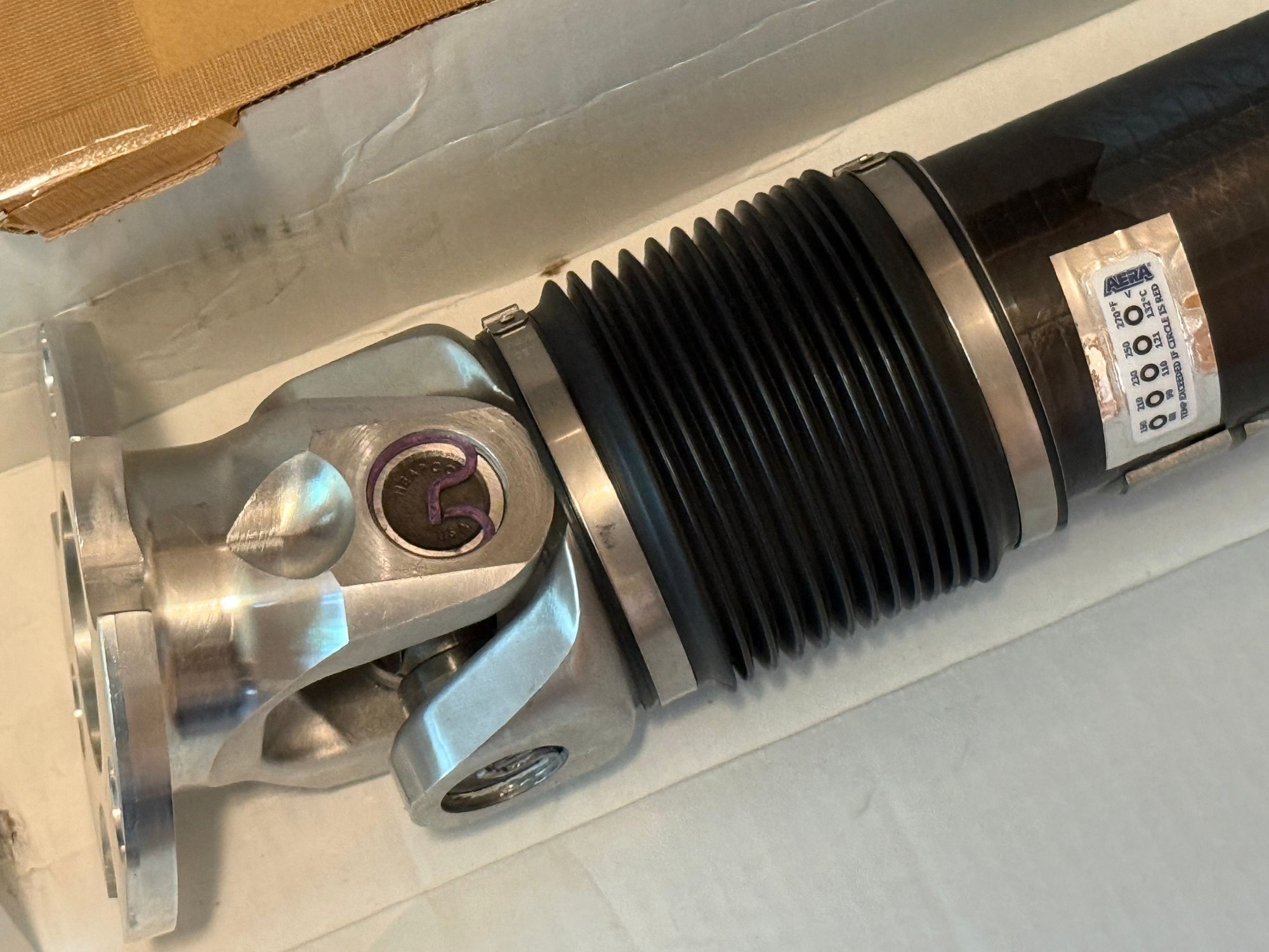

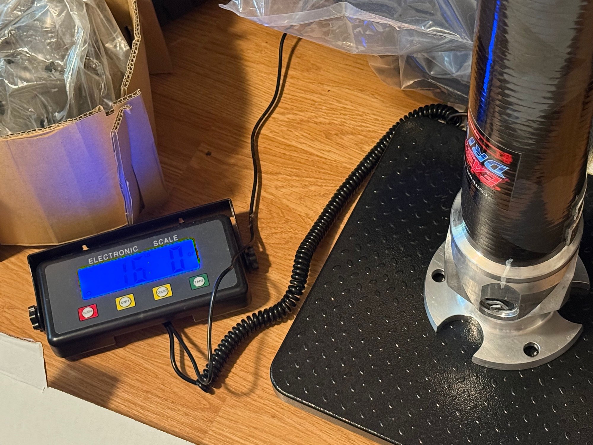

Custom one piece carbon fiber driveshaft. I wanted one that retains the rubber couplers!
Cool, that is the thinking behind your decision.
