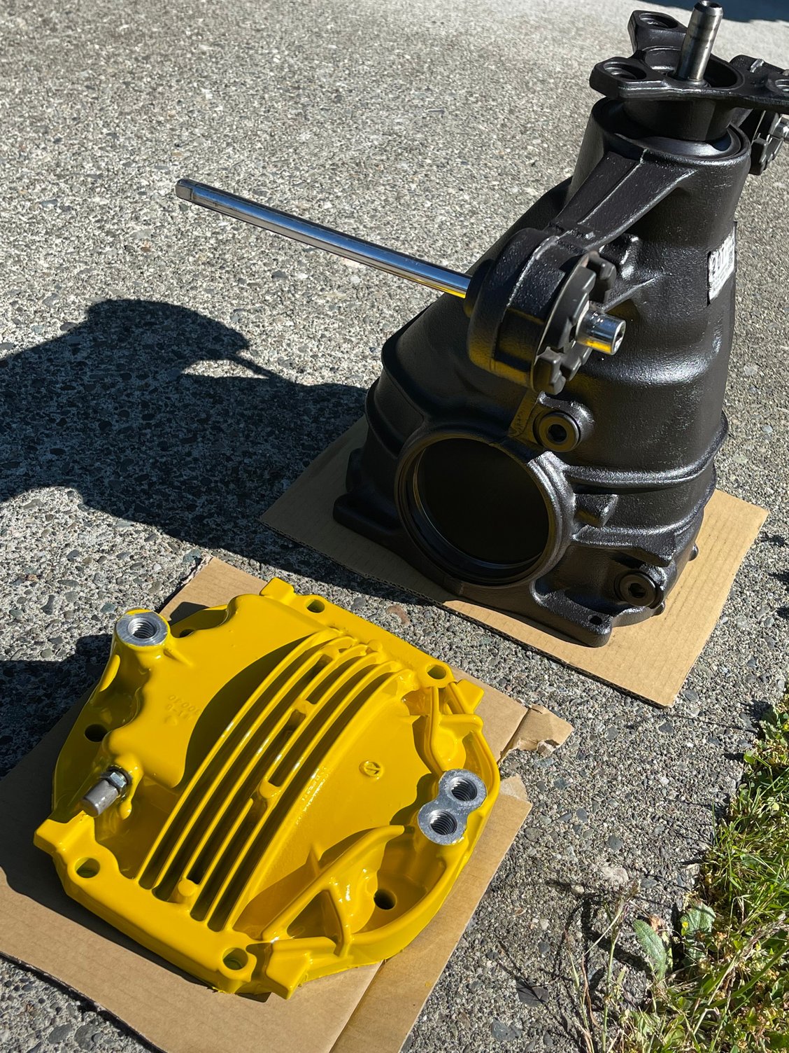

What's the plan for this diff housing?
Cryoheat treated ring and pinion 3.13 gearset and OS Giken build.

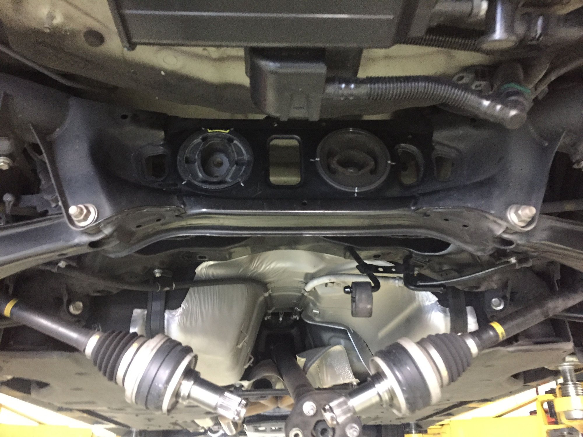

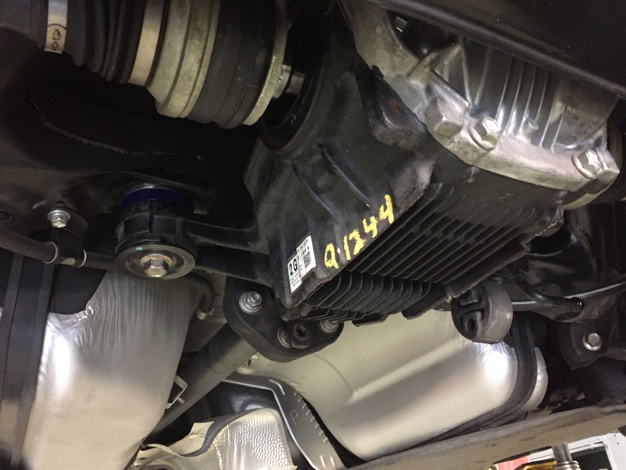

Are you considering using the RC F diff cover that uses a vertical bolt pattern on the left subframe bushing ?

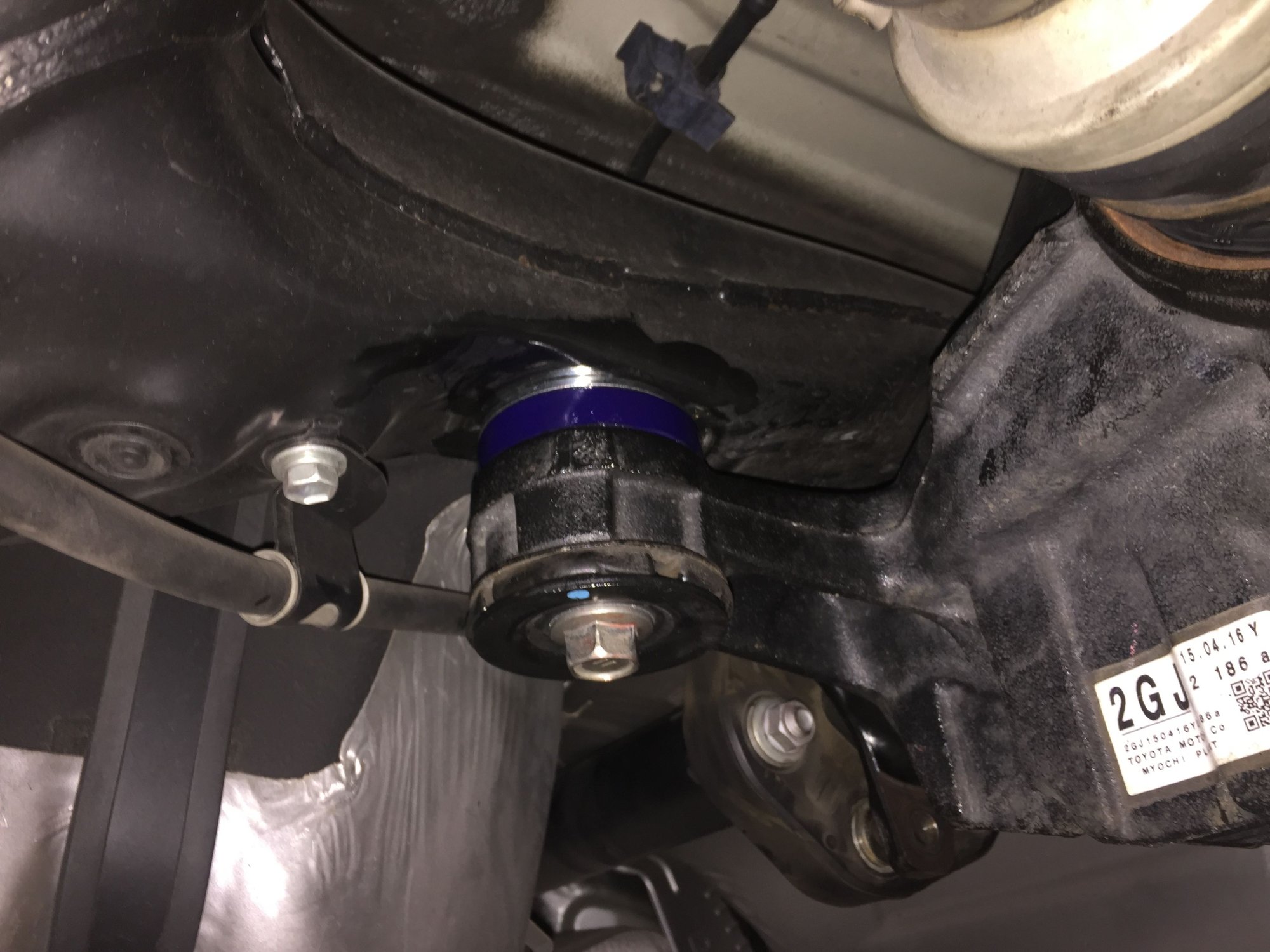

Here is my RC F diff with RC F subframe diff bushings..
Small upgrade to the topside pinion ear bushing and insert kit only from SuperPro.
Joe Z

My 2014 already came with the same diff cover that are now on the RCF's and remember, this is the second diff I'm building and the first one already has all FIGS/Superpro bushings. This donor diff is off of a 2015 is350 RWD and also has the vertical bolt orientation on the cover, so this should be a quick swap when it's done, the only things I'd have to transfer from the current diff are the FIGS/Superpro pinion ear bushings. Yours didn't require removing the old bushings? I didn't know that they made inserts designed for the factory bushings.

Wait maybe I misread your post.. The OEM 2014 IS F differential cover / mount on the LH side for sure is horizontal..
You have a 2014 & 2015 Lexus IS donor differential that you did your swaps on..??
You already updated to the high hp super pro poly diff mount, so all you’ll be doing is clocking the LH mount itself to vertical position, if you use the newer diff cover - got it
^^ 2008 - 2014 Lexus IS F / OEM setup
^^ 2015+ RC F / OEM set up
Your swaps will be easy then..
What I decided to do on my RC F diff was keep the OEM pinion bushings, they were still in great shape. And just installed the super pro supplemental insert kit. SPF2769K
To my knowledge the supplemental insert kit works with both the oem & super pro full replacement pinion ear bushings.. I pretty sure Figs created the set for his site..
But à la carte, I never found the specific part numbers for the replacement pinion bushings..
All I ever dug out was the Supra ones - (not confirmed fitment spf4888k)
See my Post #42 and Post #52 in the “Spotting the LSD DIFFerences for IS F” thread for the research and part numbers.

yeah my bad, 2014 does have the horizontal orientation of the 2-bolt bushing. It’s the donor 2015 is350 that has the vertical ones.
2014
2015 IS350

Okay so now you need a 3rd cover…
Which design and color you going with ??
We seem to think there was a design change for a good reason on the newer vertical lay out..
Joe Z

I’m gonna go with the later design and I’m thinking of a new color good thing I can easily just turn the bushing.
