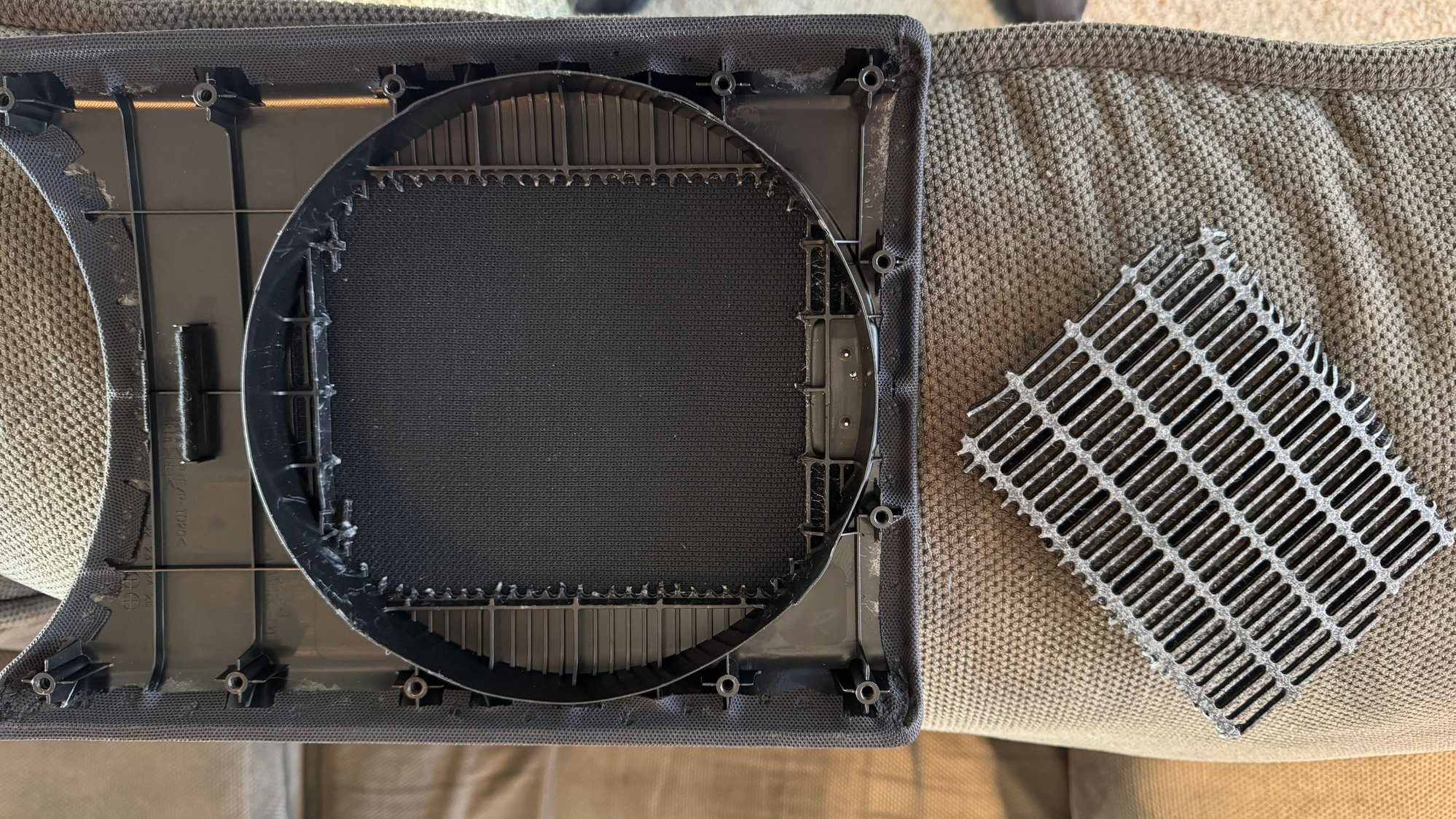

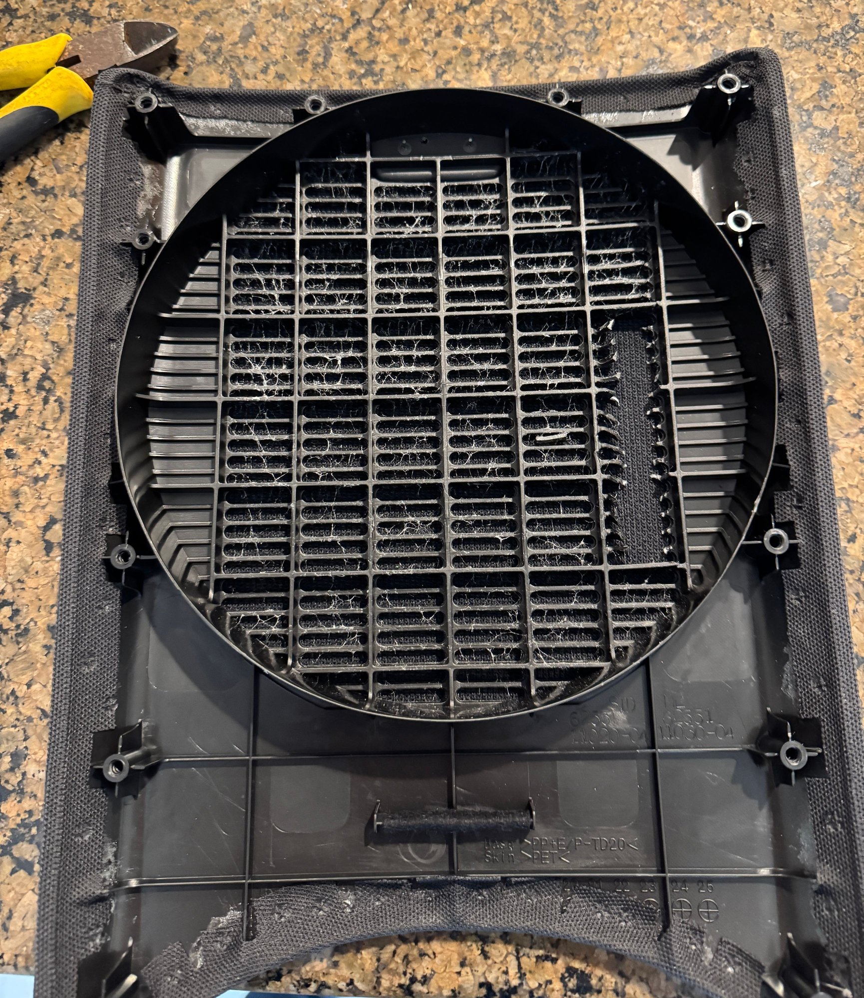

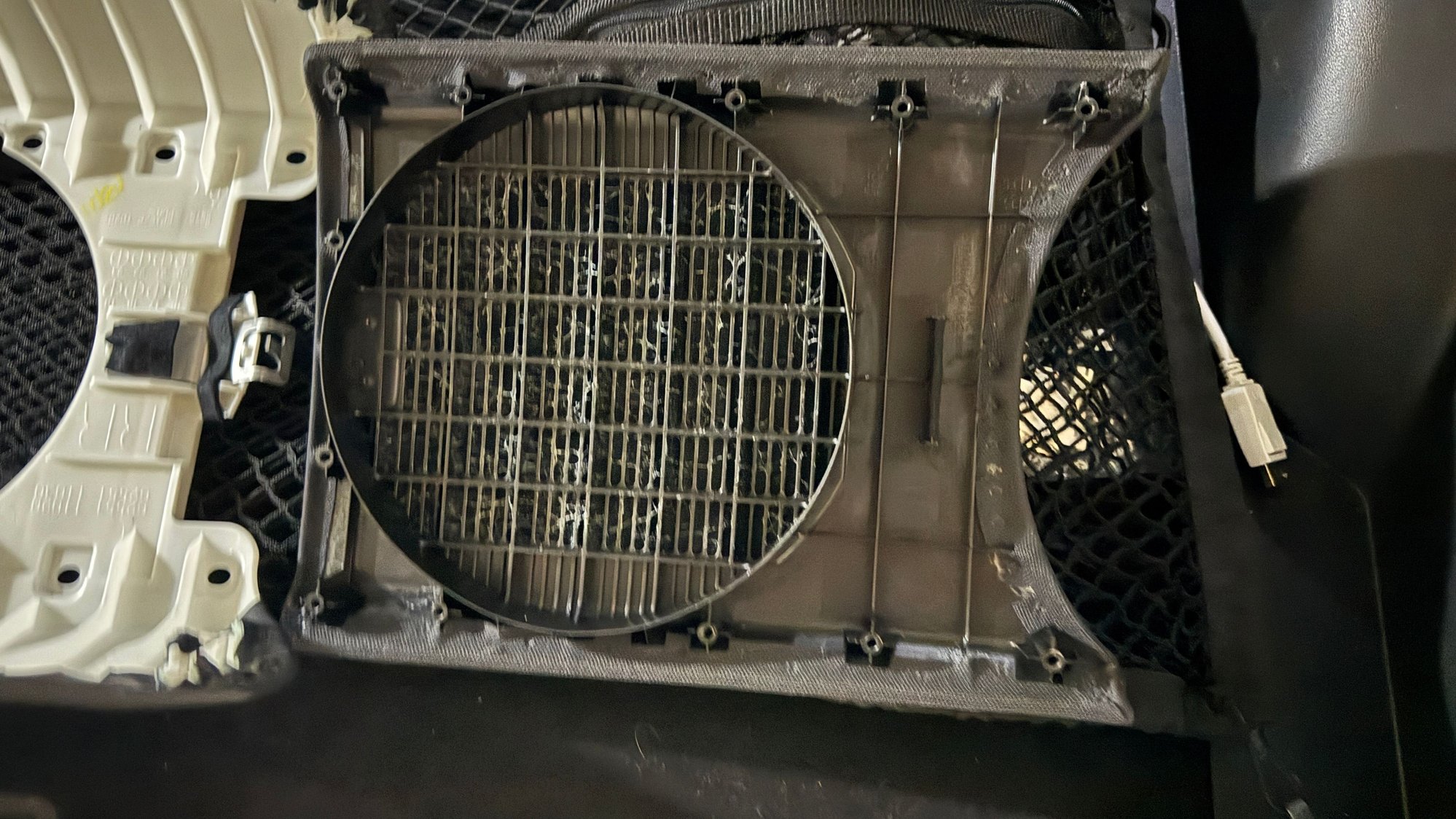

after pulling the coupe cover loose, you can remove it by taking out the bolt (10mm wrench i think) that holds the strap in place:
next you can remove the 12 screws holding the cloth covered part in place. you don't have to do this, but it's easier to work with the sub cloth covered plastic piece separately, imo.
here's the piece pulled away separately.
i used some cheap wire clippers to CAREFULLY snip the plastic bars and needle nose pliers to pull 'em out, using timado404's pics for guidance
here's the start of it.
eventually i got there... took about an hour trying not to rush, desparately trying to not poke the cutters and pliers through the thin cloth which is 'stuck' to the plastic bars. once i'd cut 3 sides, i was able to get fingers under the bar grid to gently pull it away from the cloth.
putting it back together was cake.
haven't listened to it yet.
