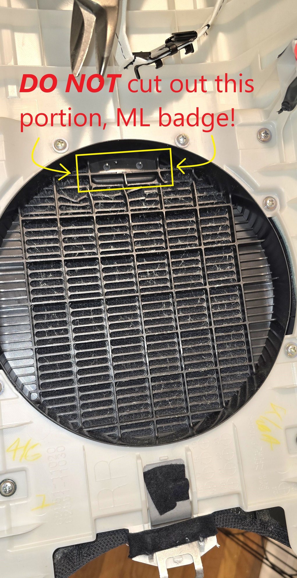

I'm baffled by all the negative experiences. The ML in my LC is hitting so hard, (of course I usually listen to it around 50-55 volume), it's starting to rattle the cover screen on the rear sub. I need to take that thing out and check it...

Audio systems develope rattles over time, especially at louder volumes. Not a negative to me, usually a quick fix. My bafflement is referring to the guys that simply don't care for the sound profile of the ML.
Same here. After I made some tweaks, my system sounds really good. I'm having the same issue with my subwoofer cover screen rattling when I really crank up songs with heavy bass. A month ago, I removed the entire bass cover section and cut out a piece of circular felt to match the size of the subwoofer and placed it between the protective screen and the subwoofer. Still getting the rattling to a certain degree. Someone in here said something about how the issue is the fabric on the protective cover somehow vibrates against the plastic mesh protective screen itself. The lexus dealer sent it to an upholstery shop that glued the fabric to the plastic and it solved the issue.
Not sure where the posts are but those of us in the beginning snipped off the entire hard plastic grill and the rattles are gone. Take grill off subwoofer....carefully cut all of the hard plastic off....put back on and now the subwoofer will only bump against the OEM fabric. No rattles now!

Old Feb 15, 2025 | 01:15 PM
  #495
Enzo954's Avatar
Enzo954
Joined: Jun 2022
Posts: 563
Likes: 439
From: USA
Originally Posted by Timado404
This 100% worked for you? Do you have a final pic of the piece after you cut all of the plastic out?
