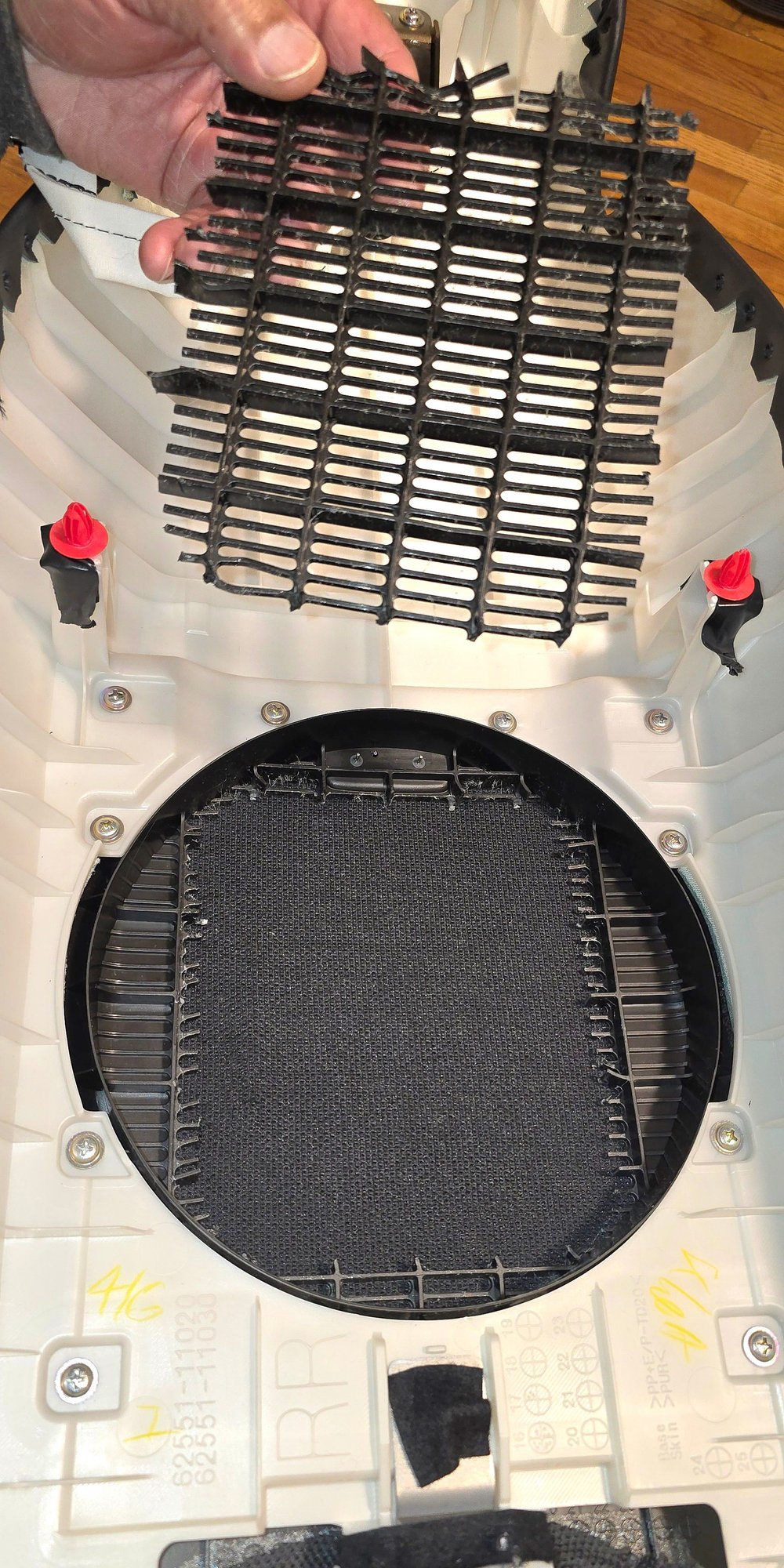

This 100% worked for you? Do you have a final pic of the piece after you cut all of the plastic out?
I was doing it as we were posting this...lol. Here you go.
You can spend time trimming up all the little pieces, if you want, I didn't feel the need as there is no more rattling noise. One pic I have a light behind the cutout, obviously less obstruction with the plastic removed.

I'll say this...SOOOOO much cleaner sound without any rattle or distraction!
I realize now just how much "interference" I was getting, before this mod.

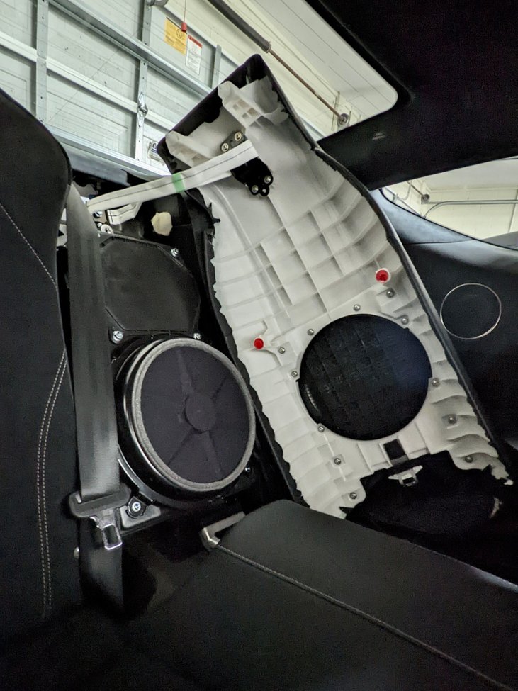

ah thx. it was 2 yrs ago i took off the cover on my coupe.
this was the pic i posted in post #336.
for anyone else, if you want to remove this, you can pull the seatbelts away up top a bit, sink your fingers in either side of the cover and pull it back and up and out.
