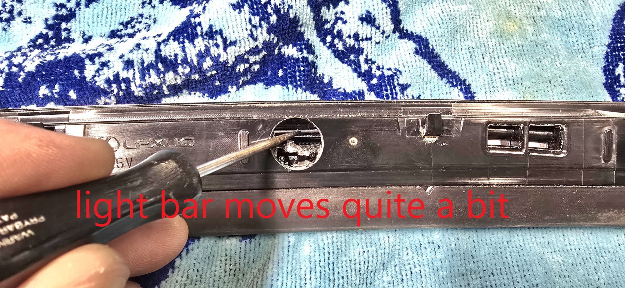

It might also be the upper (3rd) brake light that's rattling. I have that now. Here's a good vid if you want to remove/check it.

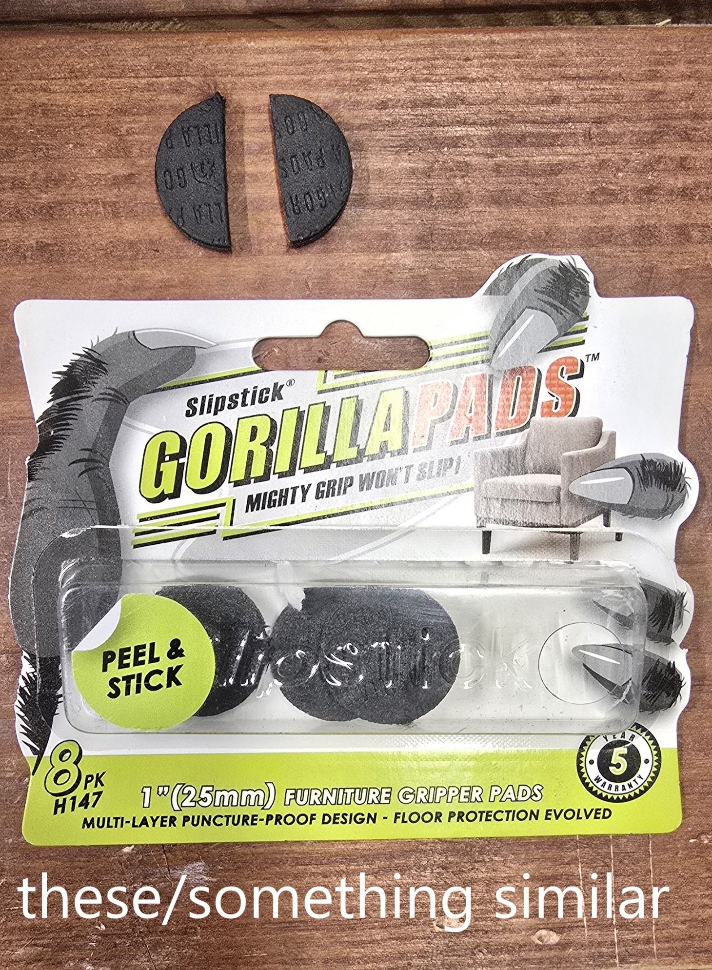

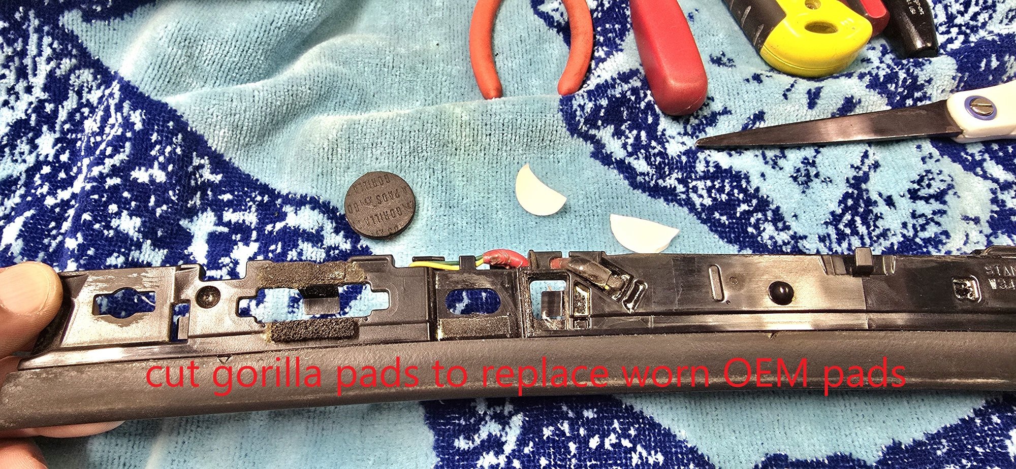

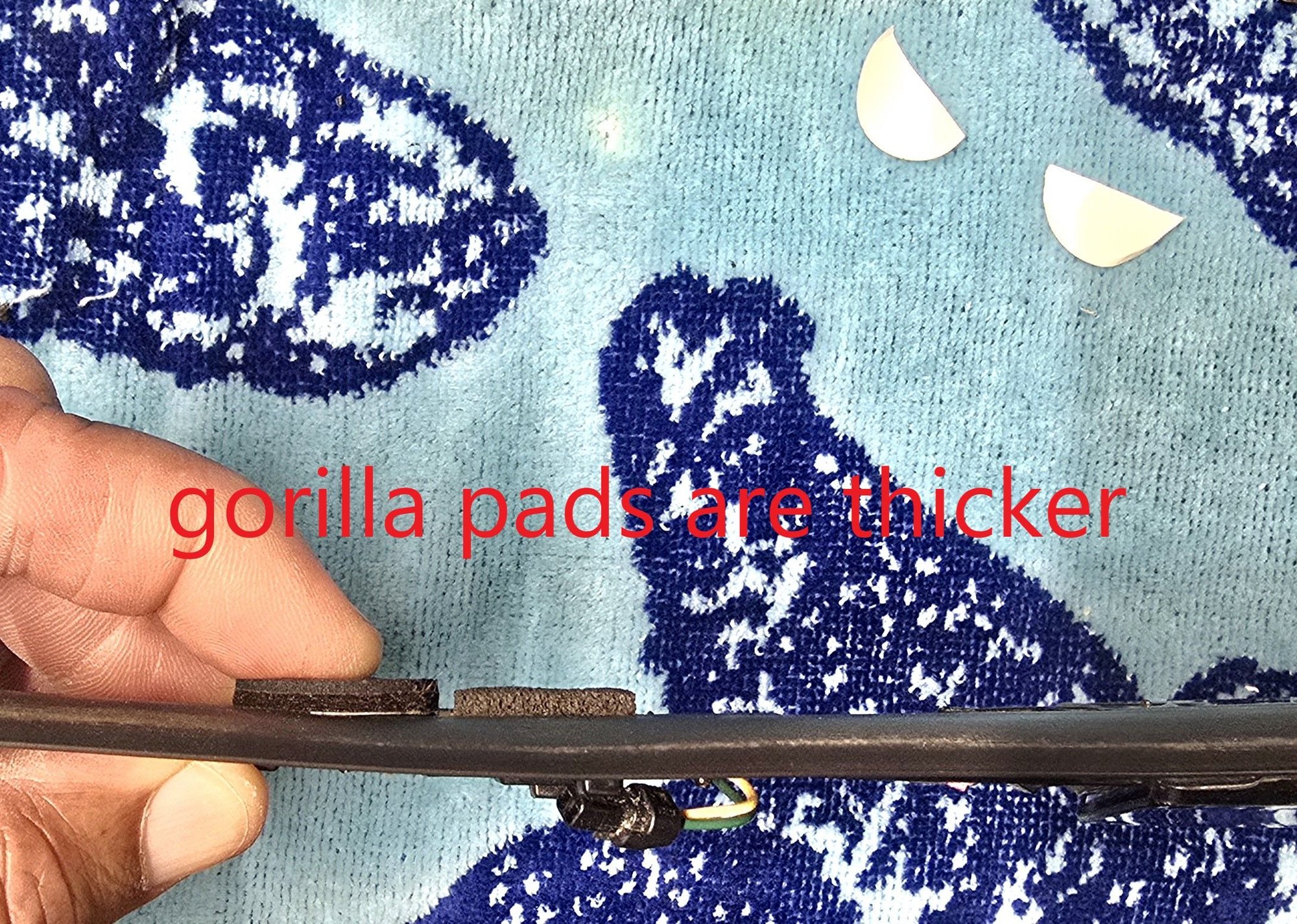

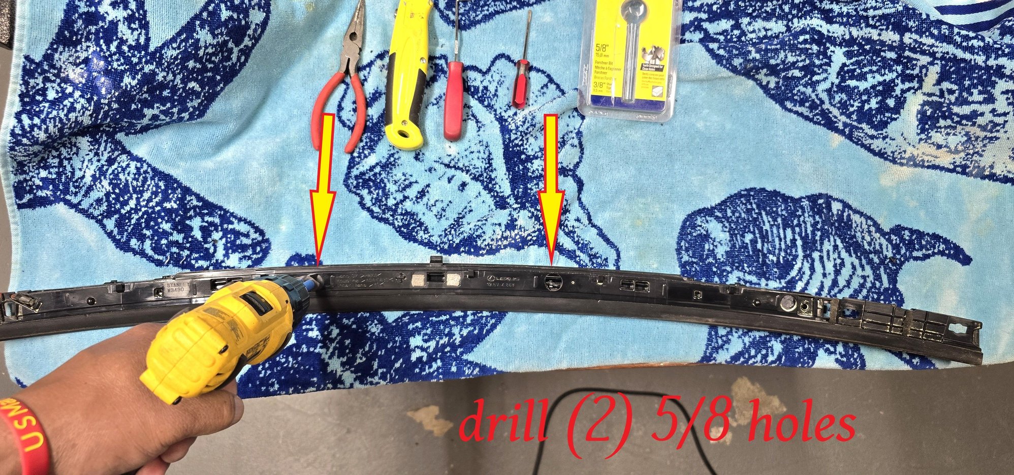

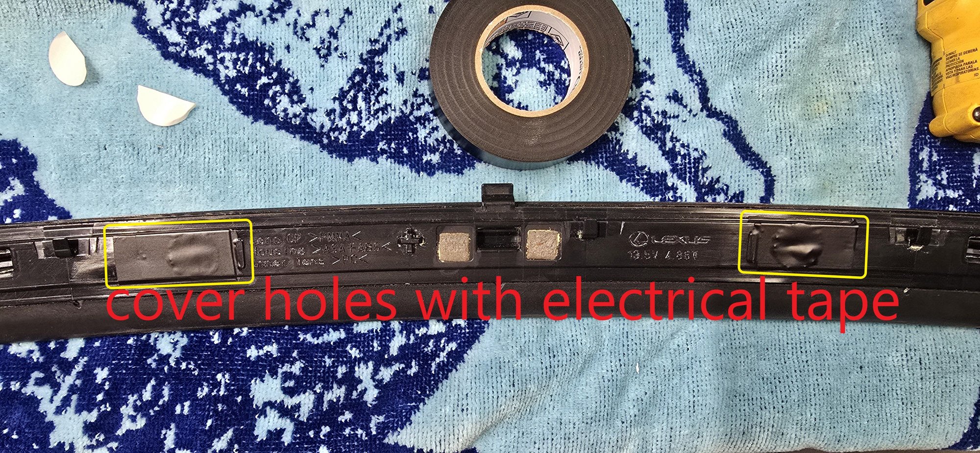

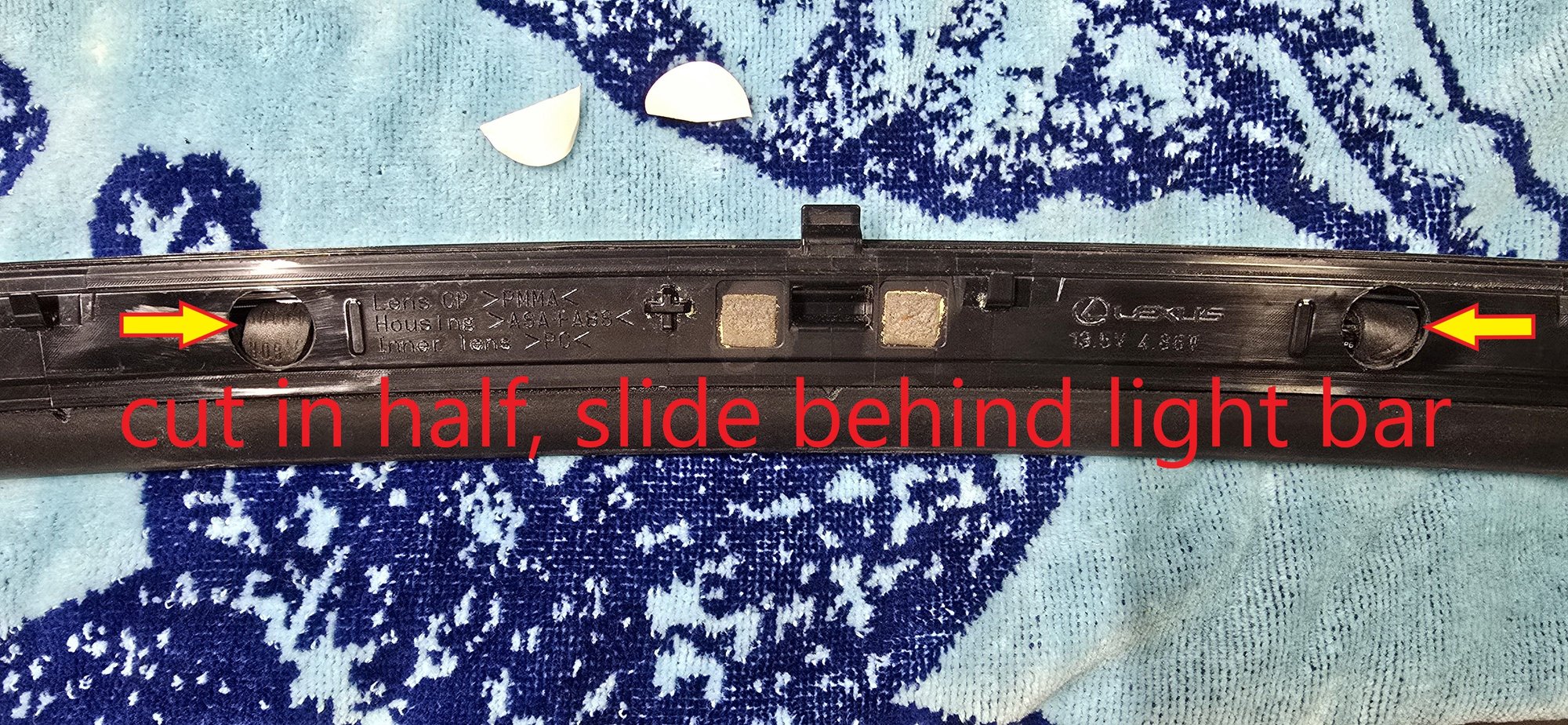

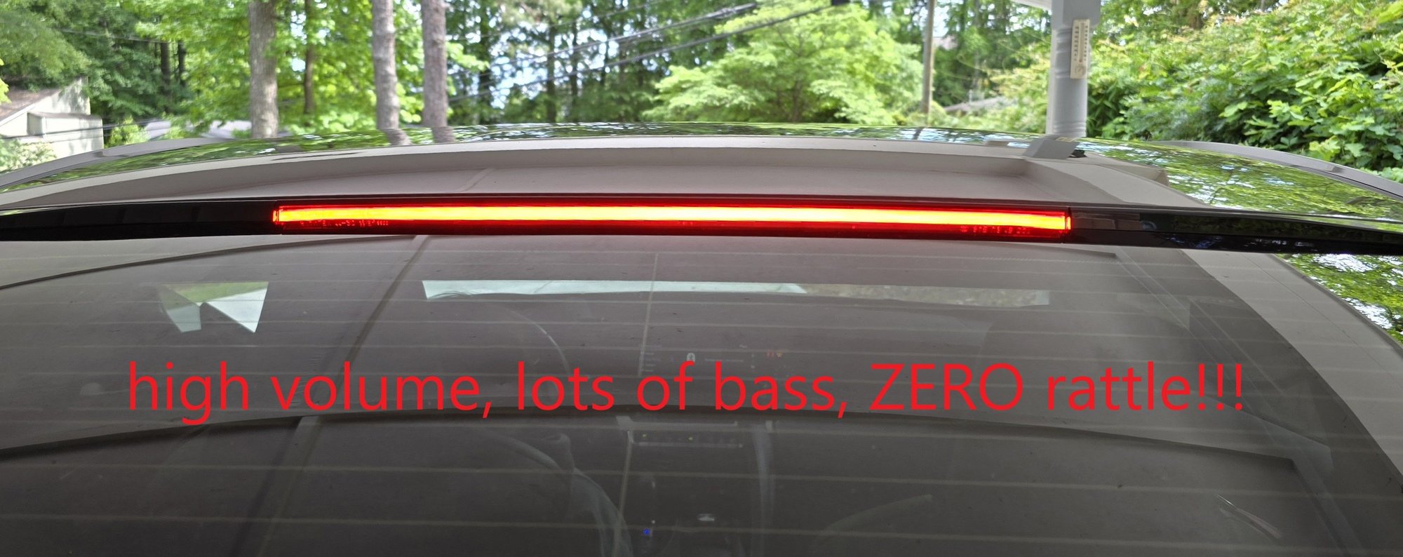

Thought of buying a new brake light to get rid of the rattle...but, I do love a good Sunday project. Almost as much as I like saving myself some coins.
Once removed, if you tap on the brake light assy., you can hear all kinds of rattling. The light bar inside is just not properly secured. The unit is sealed but I decided I needed to get inside so I got a little story.
Wanna here it...here it go!
https://lexus.oempartsonline.com/oem...amp-8157011010
High Mount Lamp Assembly
