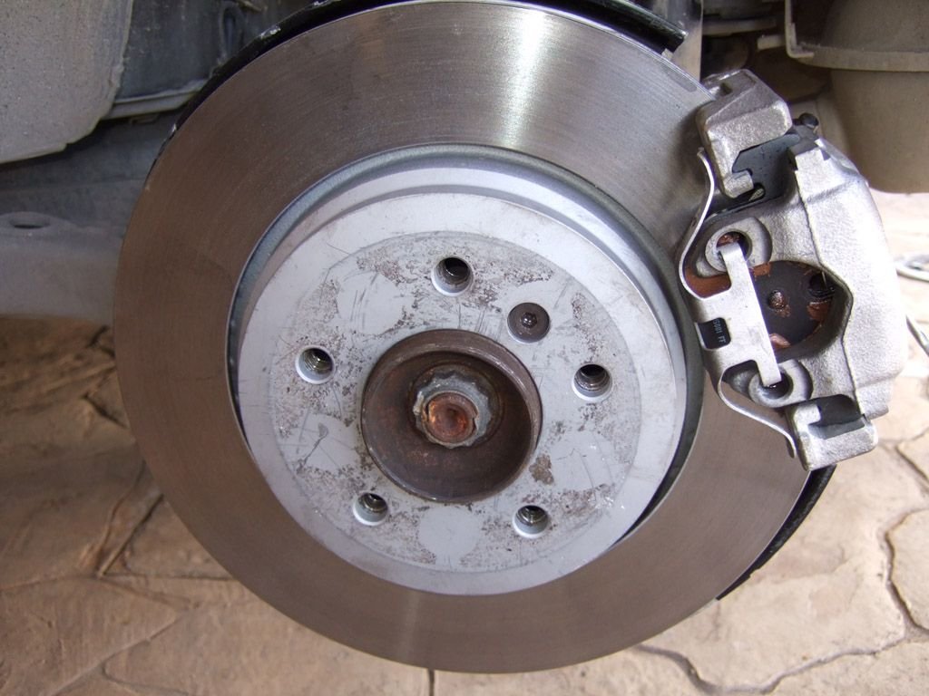

Old Feb 5, 2019 | 03:35 PM
E46CT's Avatar
E46CT
Joined: Mar 2016
Posts: 9,526
Likes: 2,585
^good to know. My friend and I were commenting how dumb the 2IS rear retaining spring design was as weve done brake jobs on so many different cars. On BMW's it's literally one flat piece of metal you install using your fingers. a toddler can do it. And in all of Toyota's brilliance there was this weird overly complicated spring. But i imagine i'd not want to encounter this pin you are talking about either.
toddler-friendly retaining clip on BMW rear
to Lexus's credit the 2IS/3IS front (F Sport) brakes are the easiest brakes i've ever worked on. literally only need a screwdriver and your fingers to do a pad swap.
