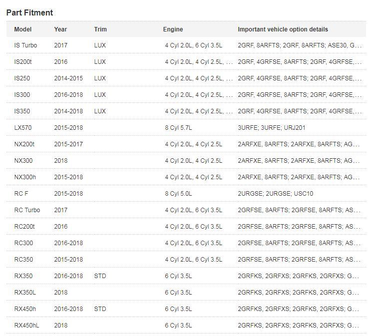

I've had 5 replaced on my 2015 NX200t all under warranty. Now I have another out but I'm Out of warranty.
I'm posting this here because it appears this lock is common amongst these models;
