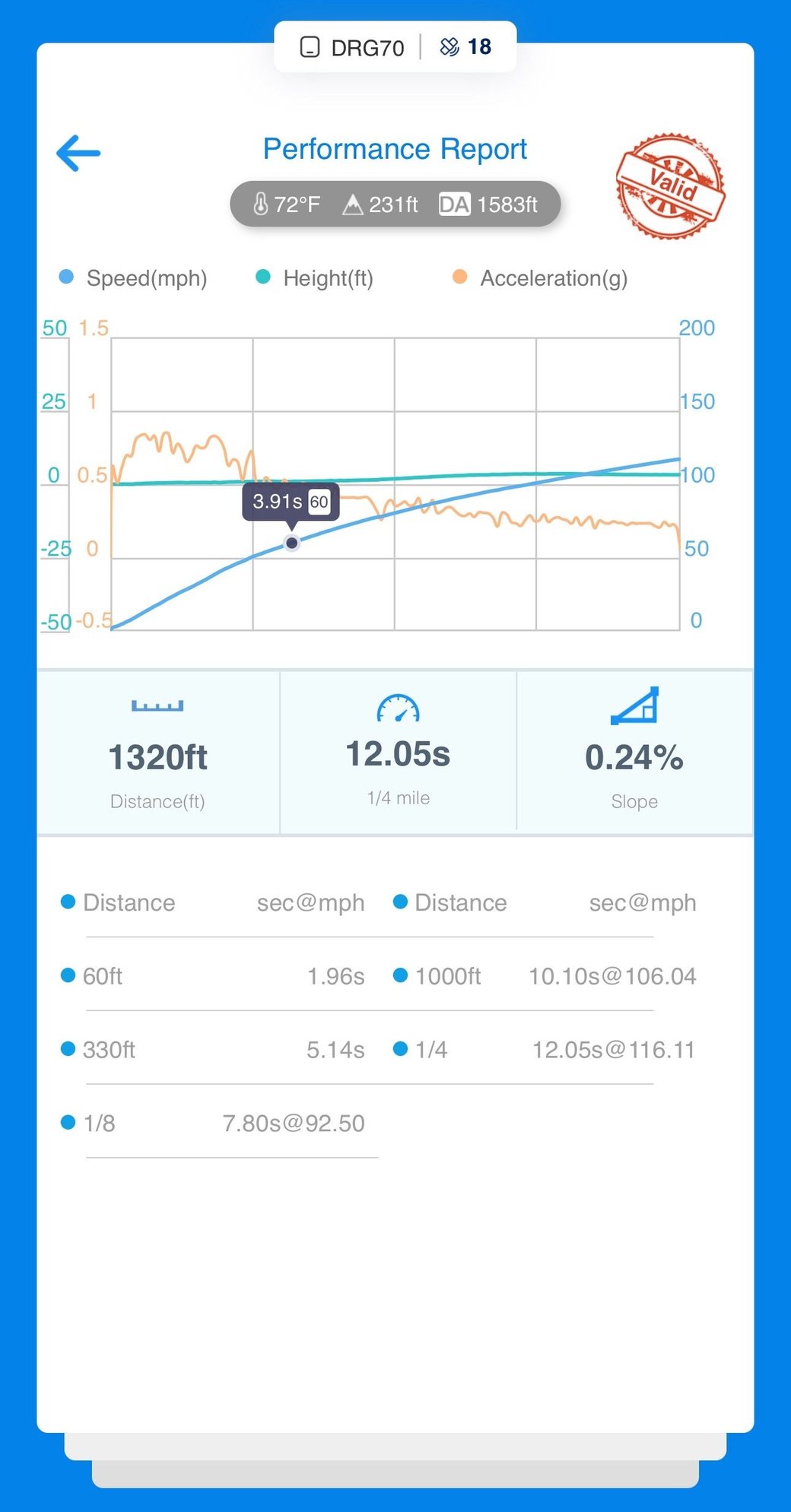

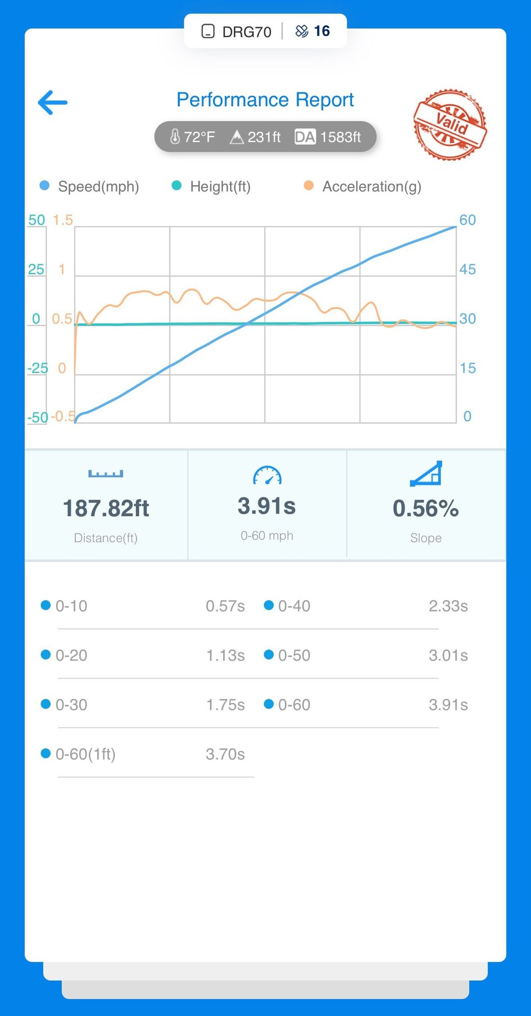

DP for the B58. Dragy came in as well to get a baseline before installing the DP
0-60 in stock Supra stock tires with 39psi in tires. Not too bad. I only did 2 runs. Too much traffic and risk. Tire temp was 76 degrees and it’s around 75 degrees outside at the time
This the 1/4 mile time. It spun a little off the line so I lift a little before getting back in it. I can’t figure out how to use launch control without it smoking the tires.
Baseline completed before I install the DP. I think if lowered tire pressure and got a better launch can easily get into the 11s stock. @FrankReynoldsCPA

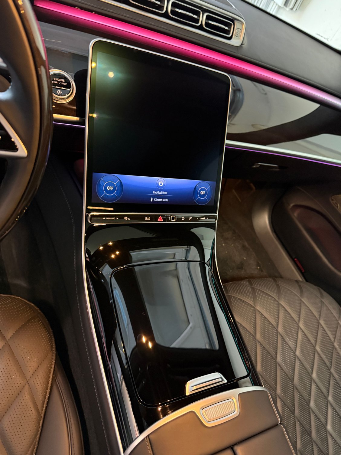

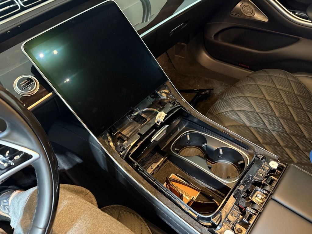

Saturday project. I had a rattle in my center screen area, instead of leaving it at the dealer for 2 weeks and them not fixing it, I disassembled the console and removed the screen and fixed it myself. 4 pieces of felt, no more rattle.
All done:
The biggest issue was disconnecting the wiring plugs, each of them connects and disconnects in a unique way. One for the panel behind the control pad for the dynamic and hazard flashers etc, one on each side of the base of the console trim for the ambient lighting that runs up the edge, and two behind the screen.
Pretty easy to disassemble, this video showed me how. I also disassembled the console in my LS460s to repair rattles, big difference is screws, No screws in how the interior of the LS is assembled, all clips that just pull apart. The Mercedes had 8 screws to remove that panel and then the actual screen is nestled into that trim like its a cradle and is attached with 4 screws. Did not need to remove the screen from the cradle. The screws make the console MUCH more solid feeling than the Lexus all clips approach.
