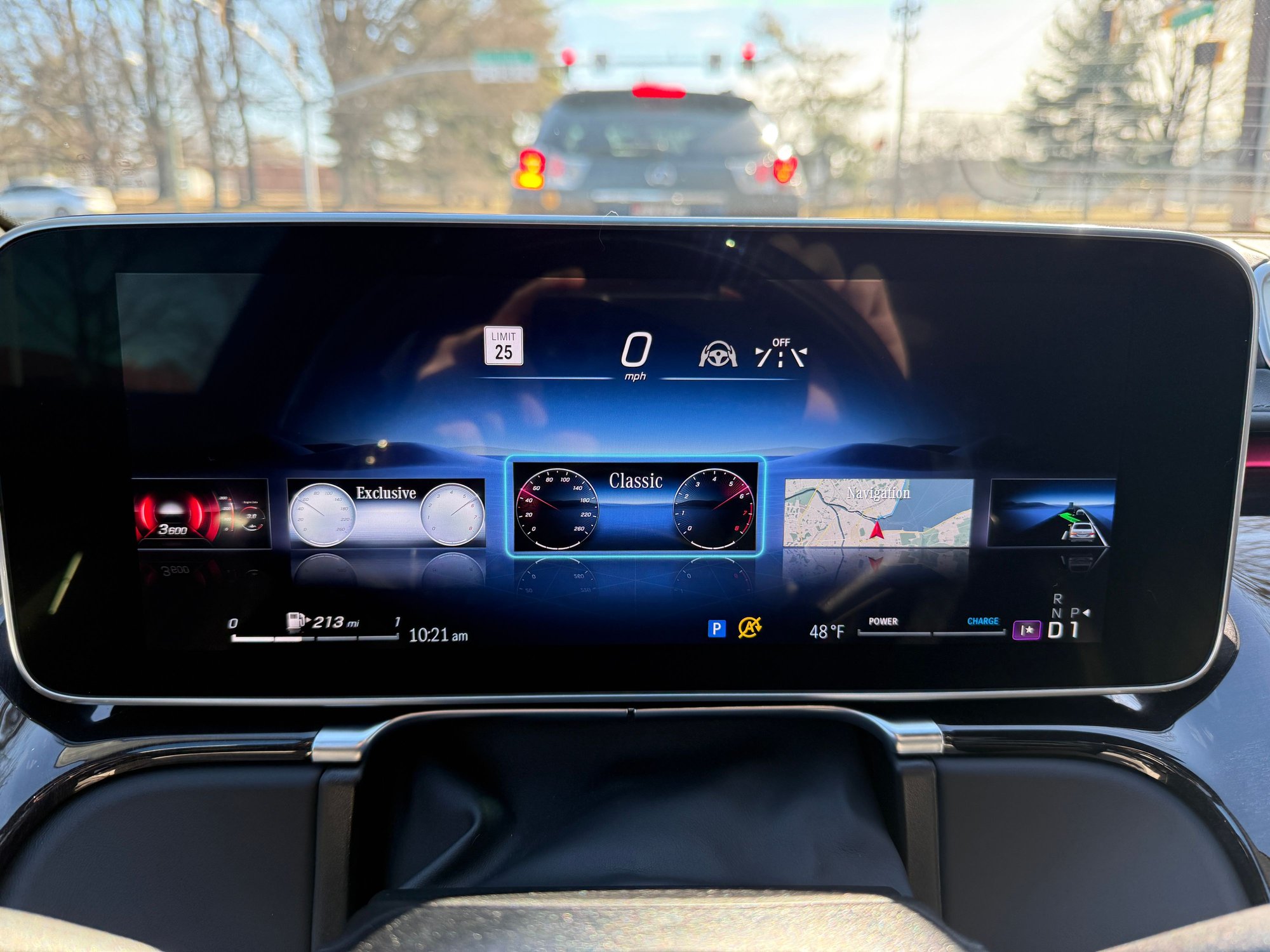

Originally Posted by geko29
That absolutely HAD to be the result of whining. No more walking dumb customers through undoing their mistakes, just "keep pressing the arrow until you like how it looks".
Very possible.
Here are all the options:
This is the screen that shows the engine temp:
Oh and the creaking seat is 100% solved. Even in the parking garage with the audio and HVAC off I can't hear any creaking.

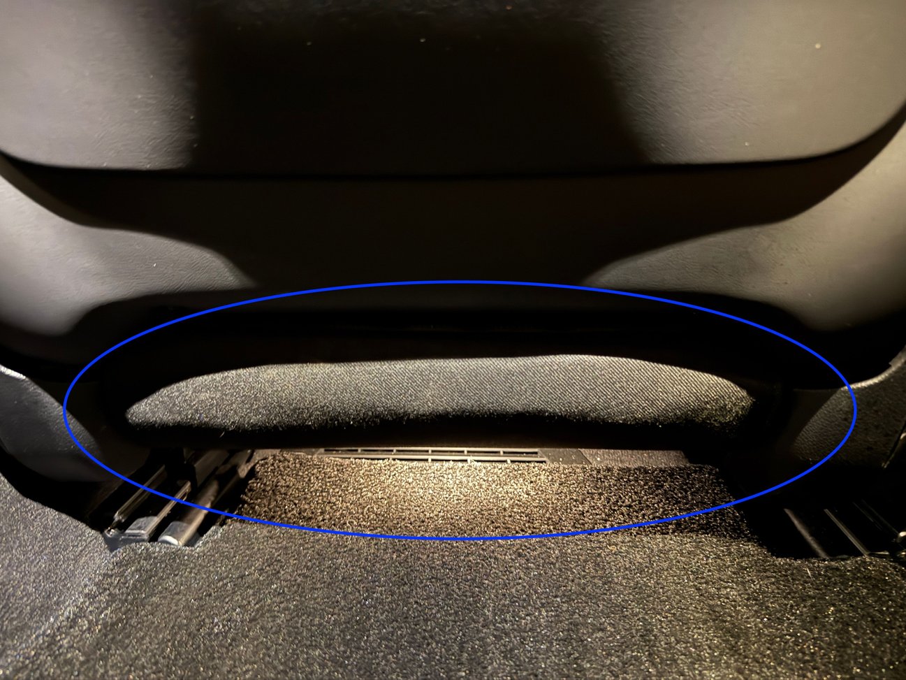

To those of you interested here is what the creaking was and how I solved it:
Behind the seat there is a piece of fabric that finishes the look of the lower seat:
This fabric causes tension on the creaky plastic trim coming around the back of the seat base in these areas:
So, I shoved the fabric back into the seat and pushed it on the sides beyond that plastic trim so now its in front of it and no longer interacts with it:
Amazing the dealer never found this, and that nobody else on MBWorld has had a dealer find this.
Such an easy fix.
