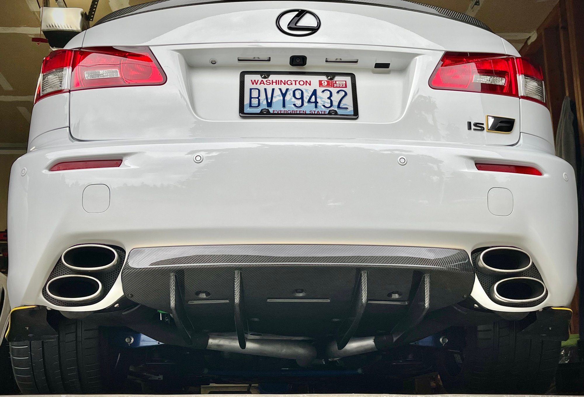

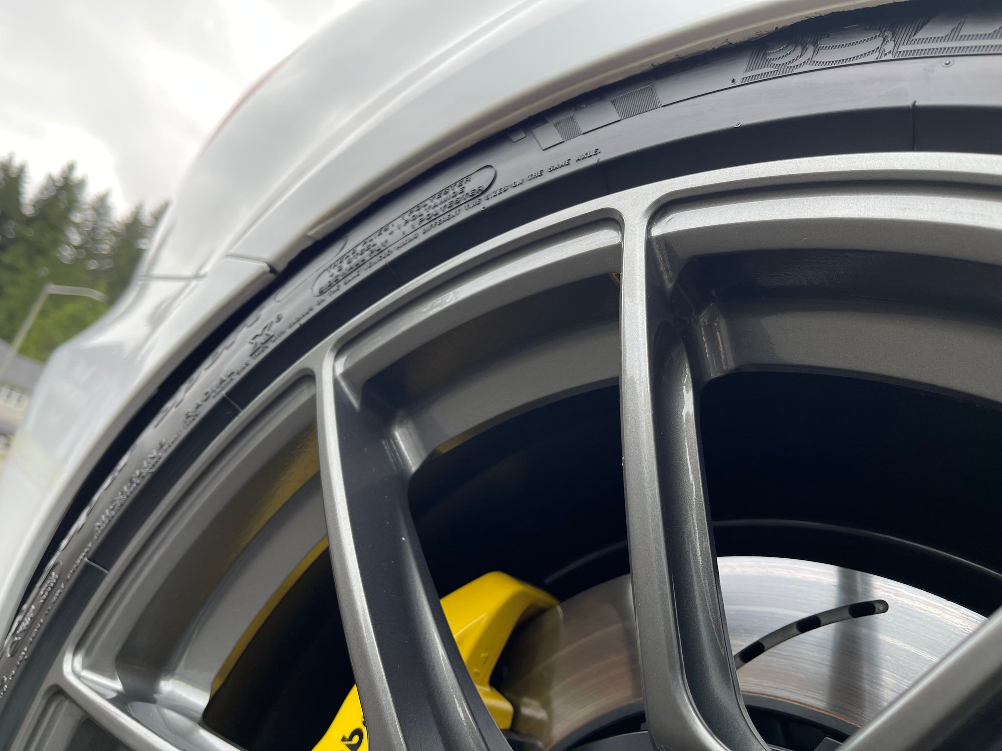

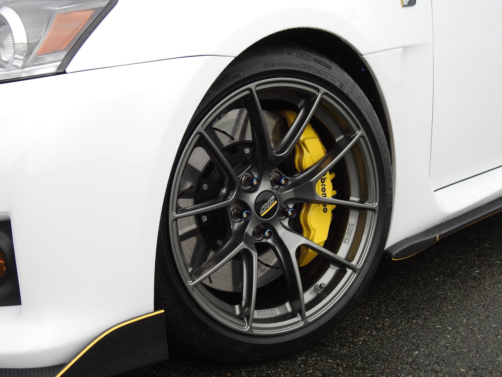

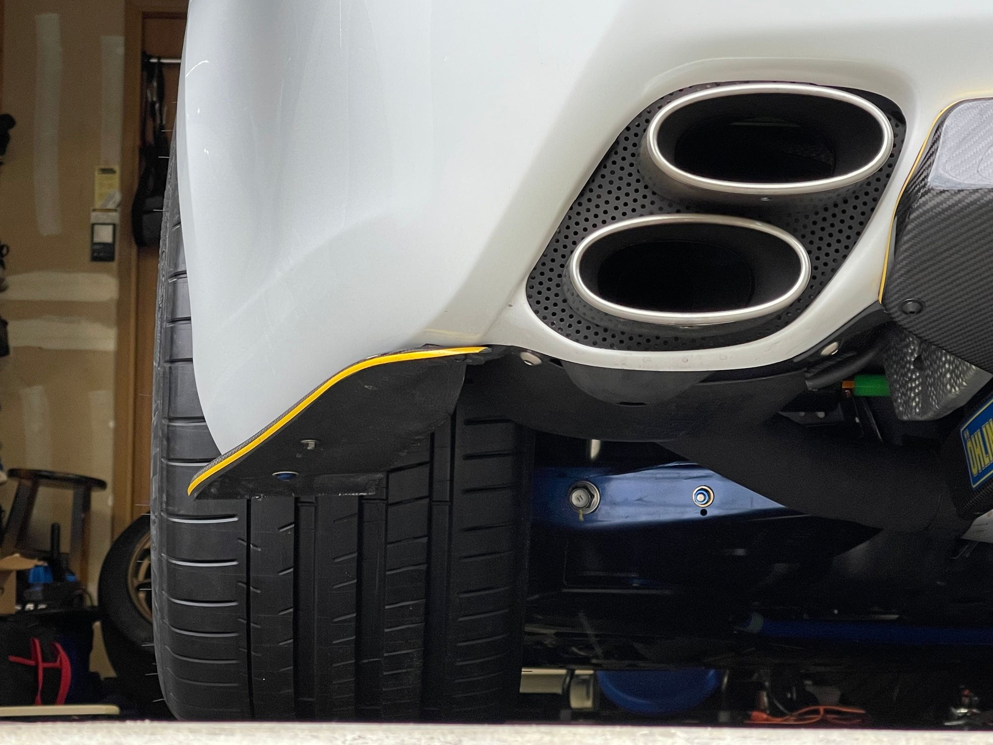

Rear inner clearance.

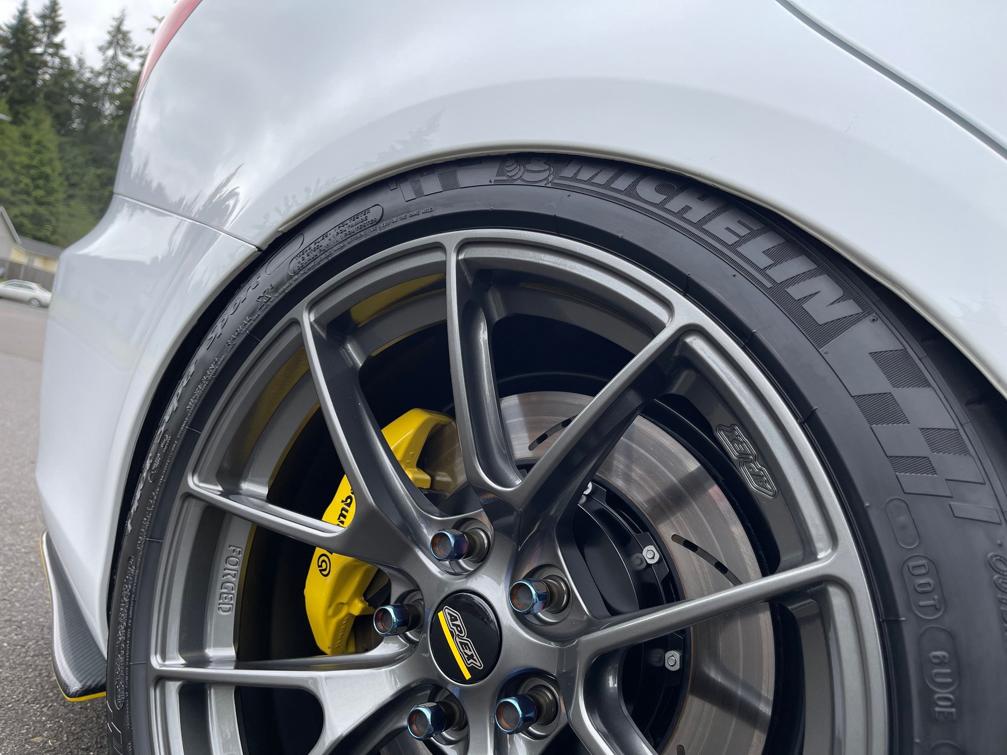

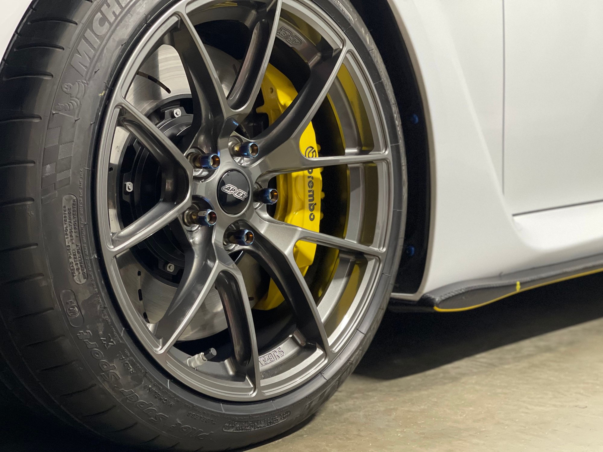

Front poke.
Plenty of clearance even with RC F caliper and 380mm rotor.

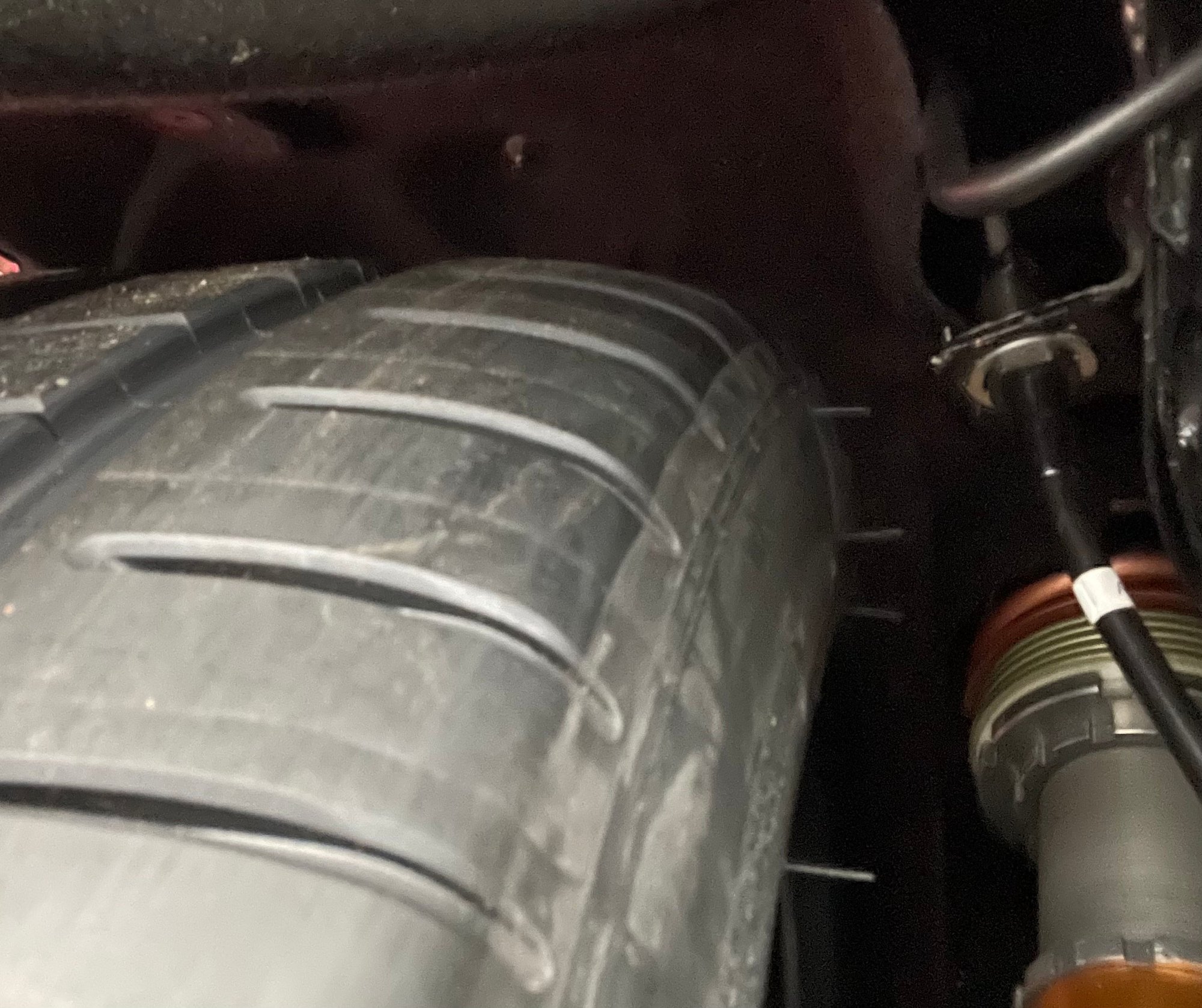

Went for a drive today. No rubbing!
Rear tire to fender lip clearance. Only upper layer lip is rolled.

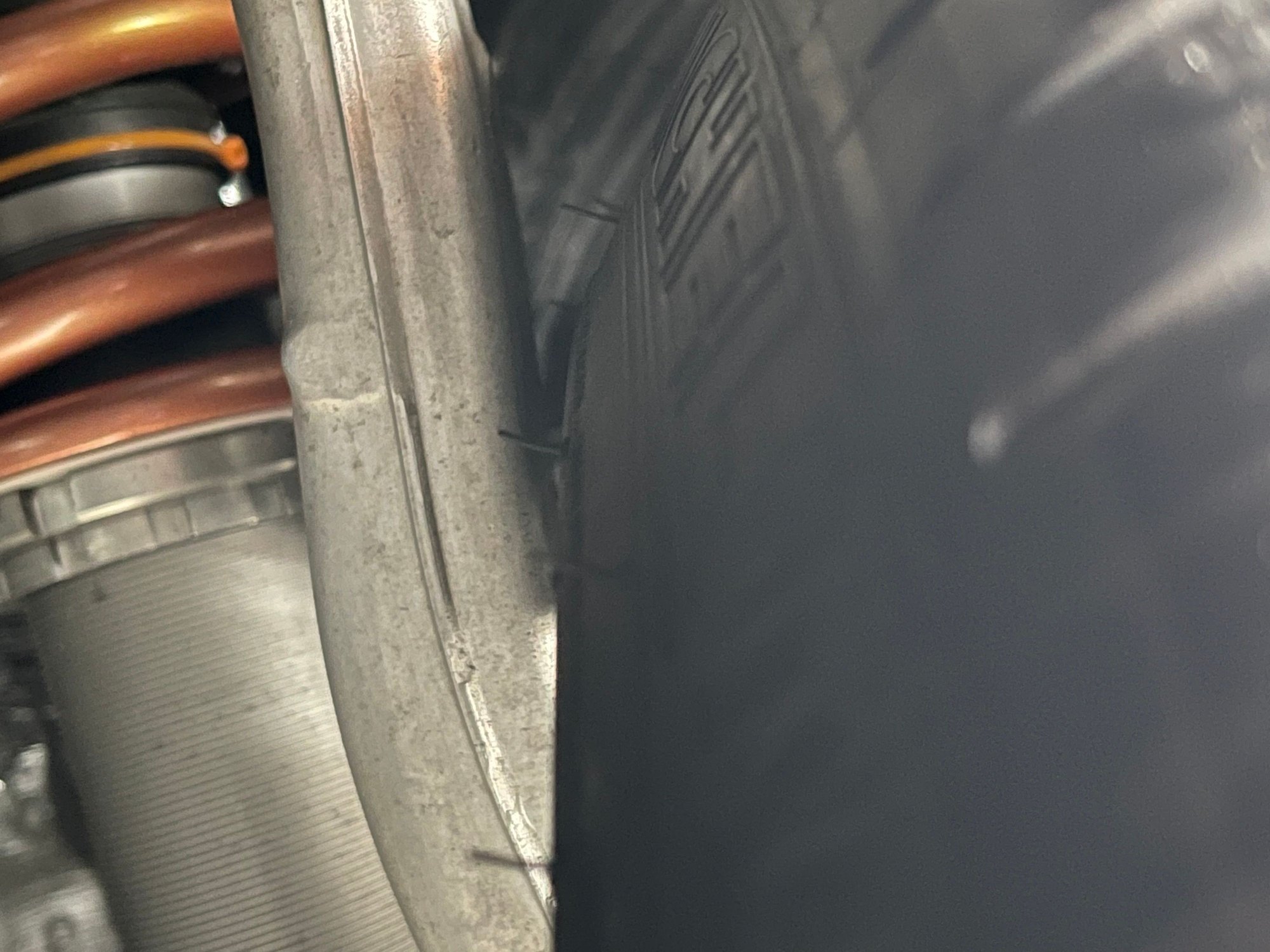

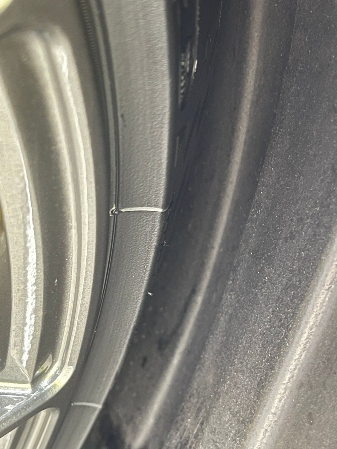

Front inner tire to upright clearance.

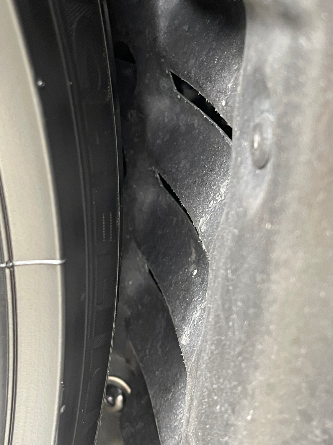

Lock to lock front tire to fender liner clearance.

Nothing short of amazing for not rubbing. I must have an offset in my rear subframe to the right because I've been lightly rubbing with 275/35/19s on the 2014 wheels only on the right side. I wish there was a simple way to align the subframes on these cars. I'd be all over it.

Same. My 285s would very, very rarely rub on drivers side only with 45 offset. It only happened maybe 2 or 3 times in 3 years. I clearance tested both sides and visually could see the drivers side rear tire was closer than the passenger side rear to the lip.

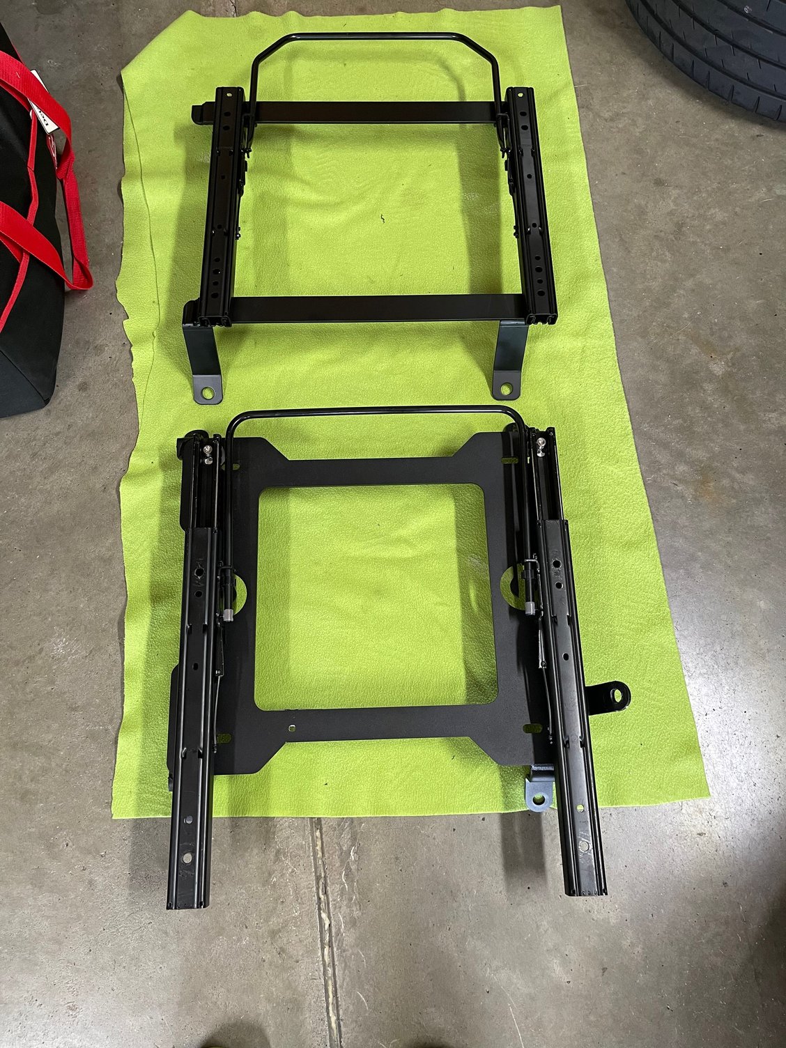

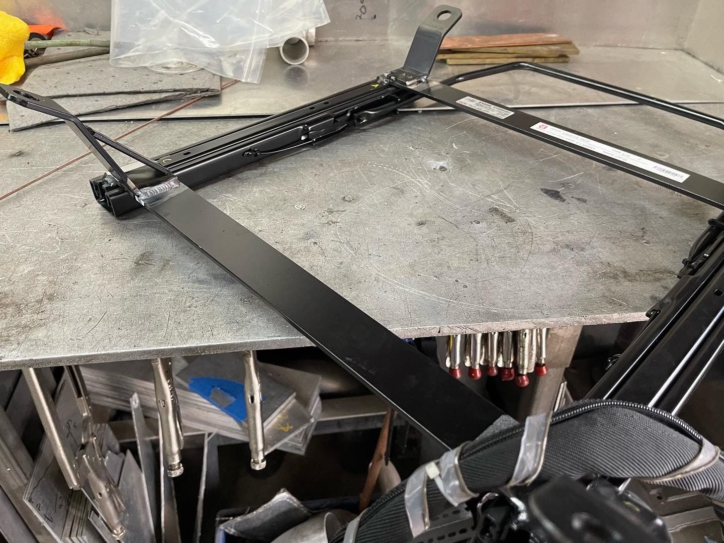

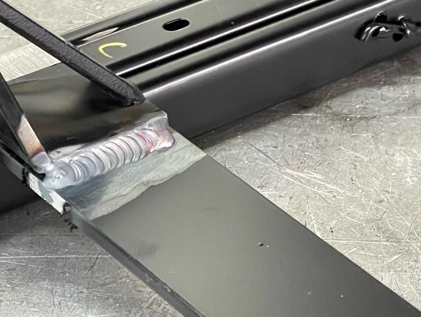

Driver's side Bride seat base/rail showed up! This is meant for an RC F so I had to make some adjustments to properly line up the seat with steering wheel. This weighs 5 lbs. less than the Sparco base/Recaro rail combo.

5 pounds??? Yeah my bases and sliders are probably closer to 15 lol. They are heavy.

Yeah, huge difference. The rail lever is also just a hollow tube, instead of a solid round bar on the recaro rail.
