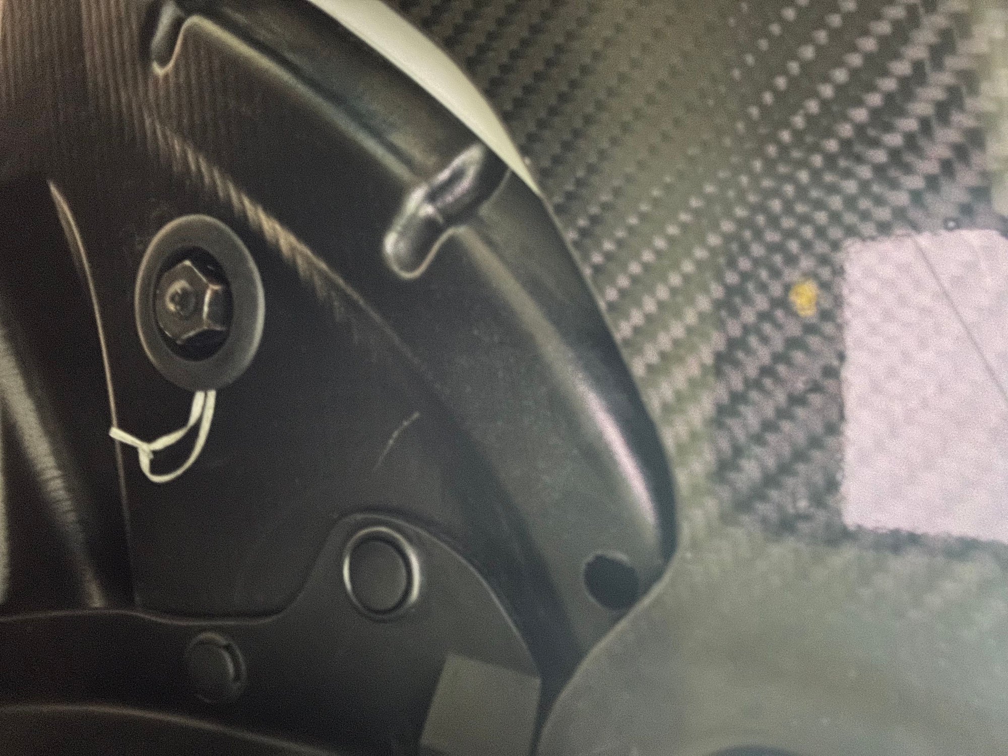

Where did you get the banjo bolts for the calipers? The safety wire holes remind me of prepping bikes for road racing way back in the day, but we had to wire everything including the caliper mount bolts. I wouldn't call drilling Ti bolts for safety wire a fun adventure at all.
Any thoughts on brake pad availability for the GS/RC calipers? Is it better than the IS F calipers?
Titanium banjo bolts are from Racetech Titanium. I've always used RB pads and I believe they are equally available for all F models, and most recently, for the Track/Fuji Edition RC F.

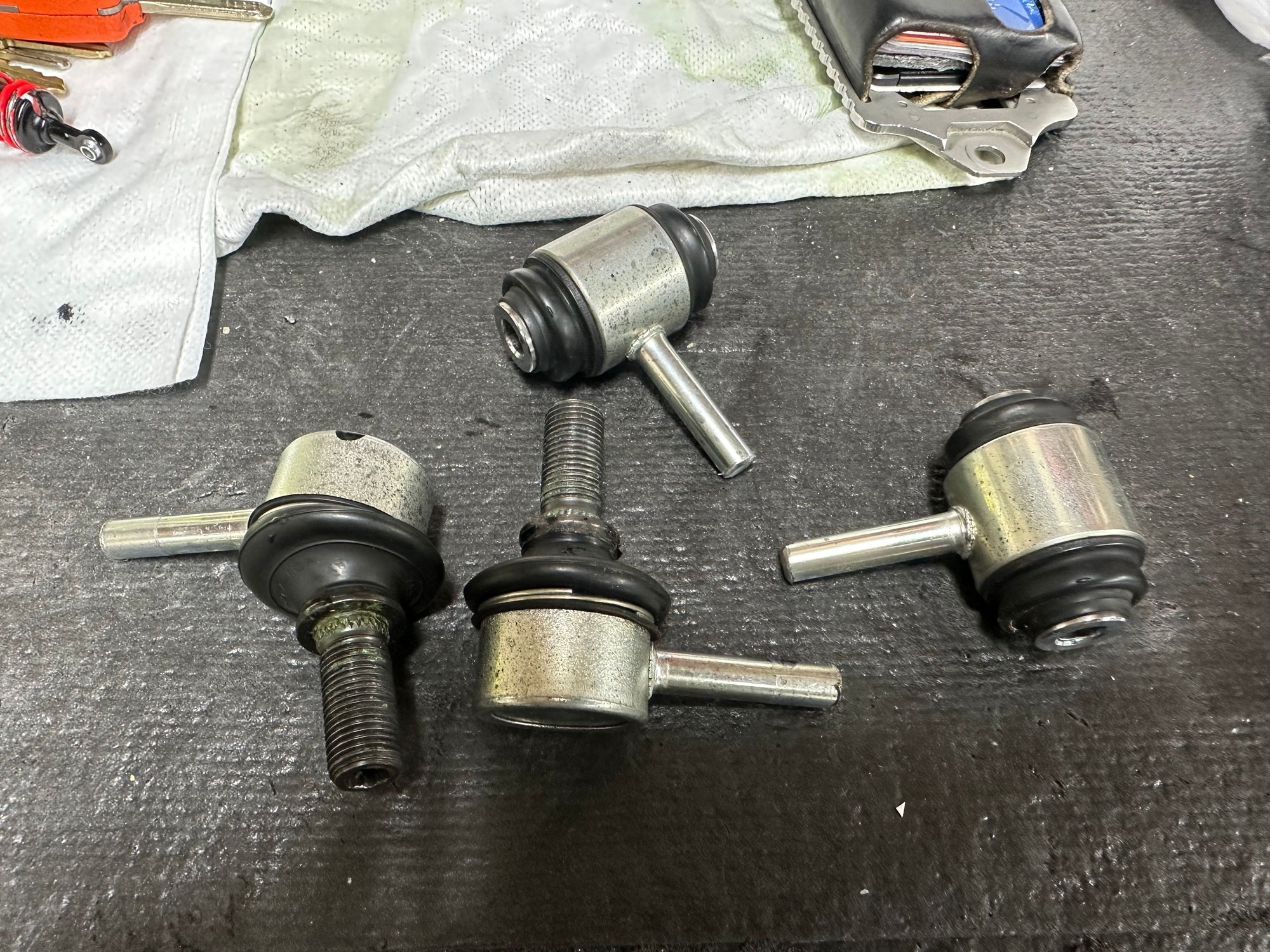

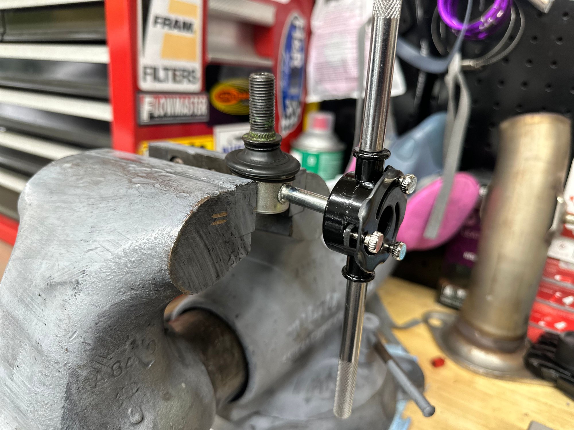

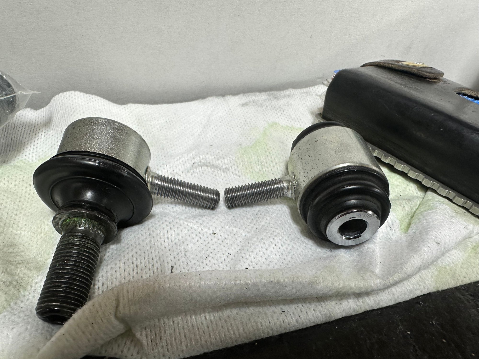

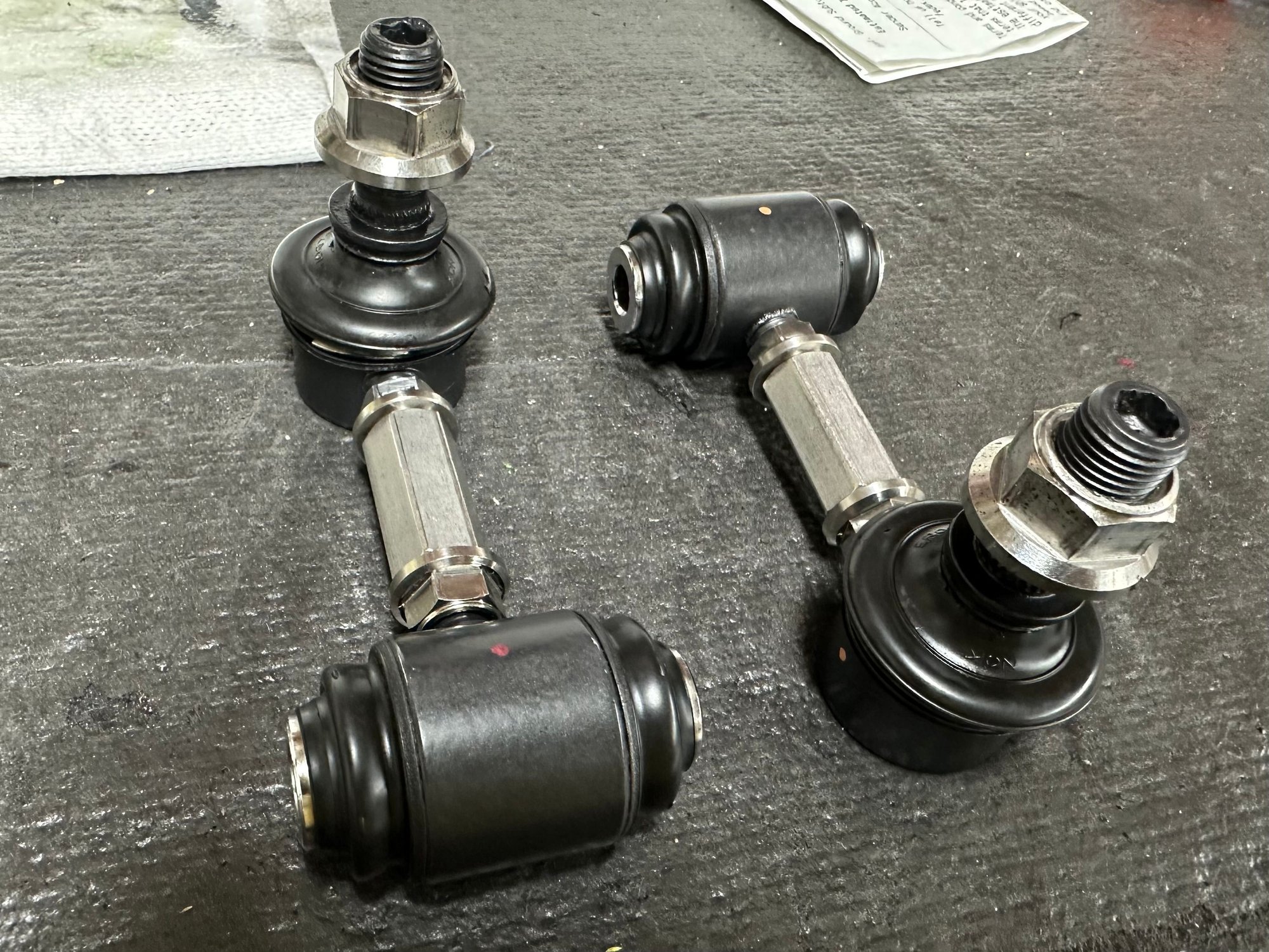

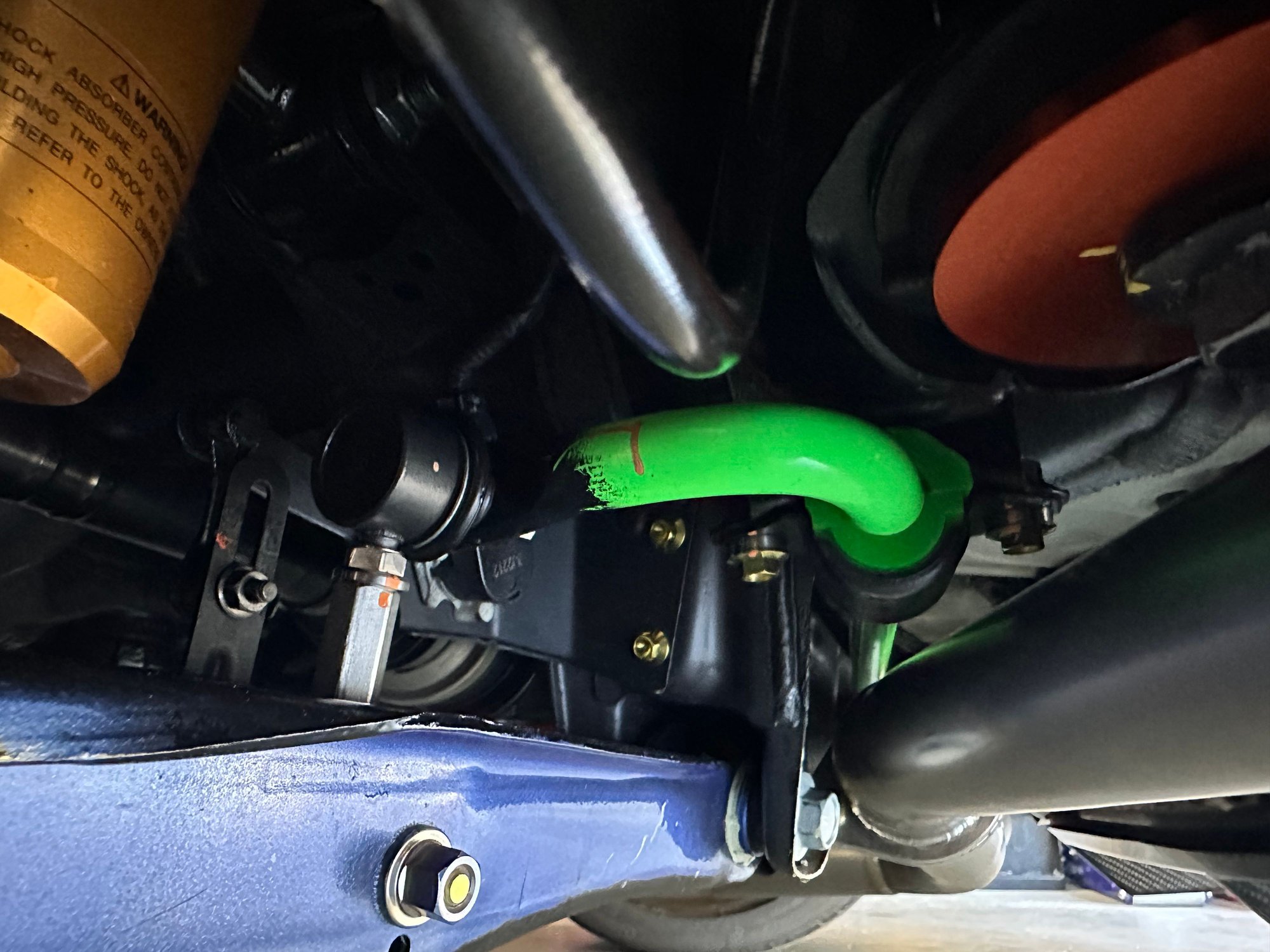

Modified factory rear endlinks. One of my not too old Cusco endlinks started making noise recently so I decided to make use of the factory end links that I’m
glad I saved! Cut, threaded, shortened and now adjustable! Cost me a few bucks for the stainless couplers through Amazon.
Cut in halves.
Cut some threads.
Shortened to desired minimum length.
Assembled with couplers and locknuts.

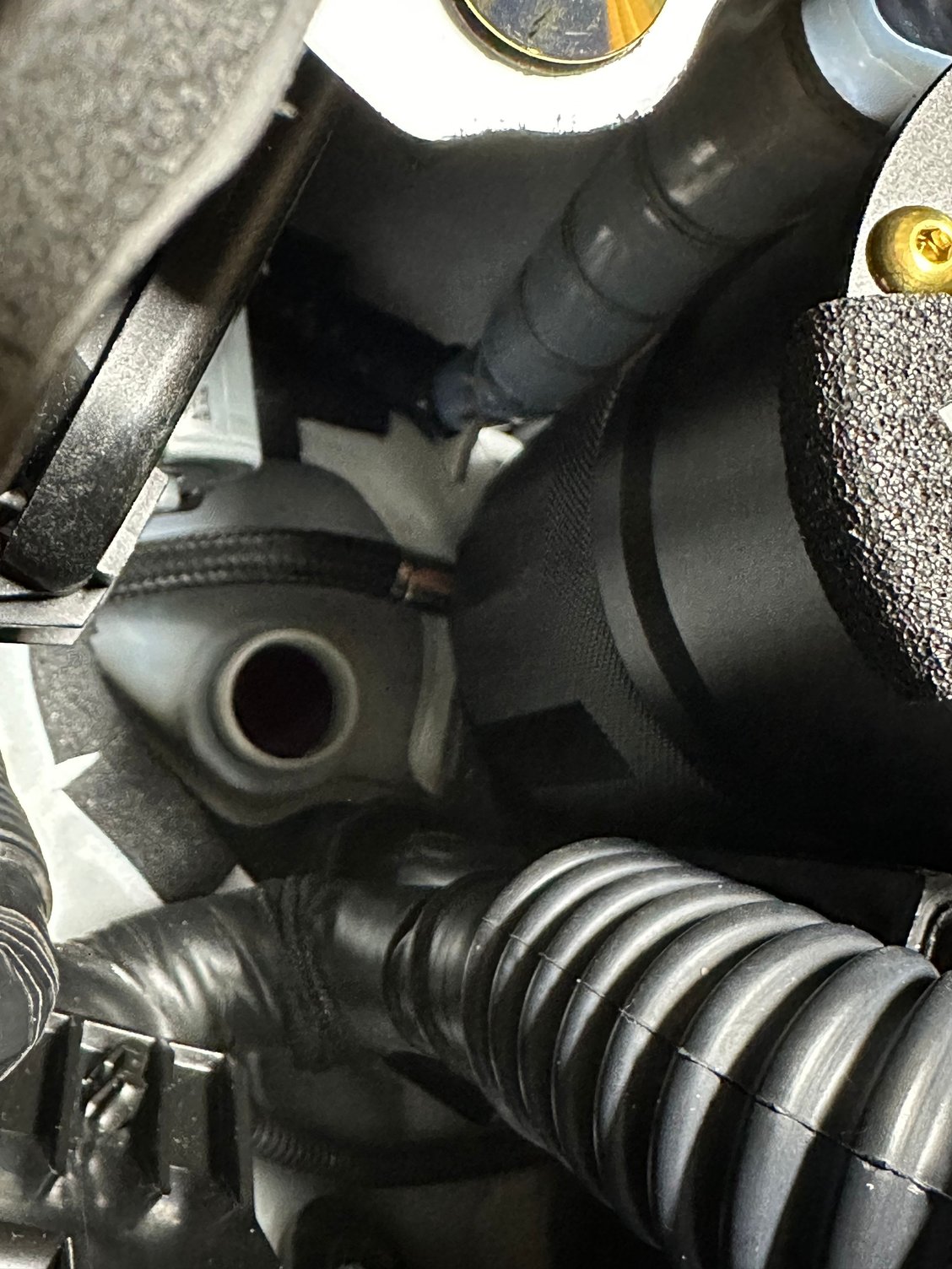

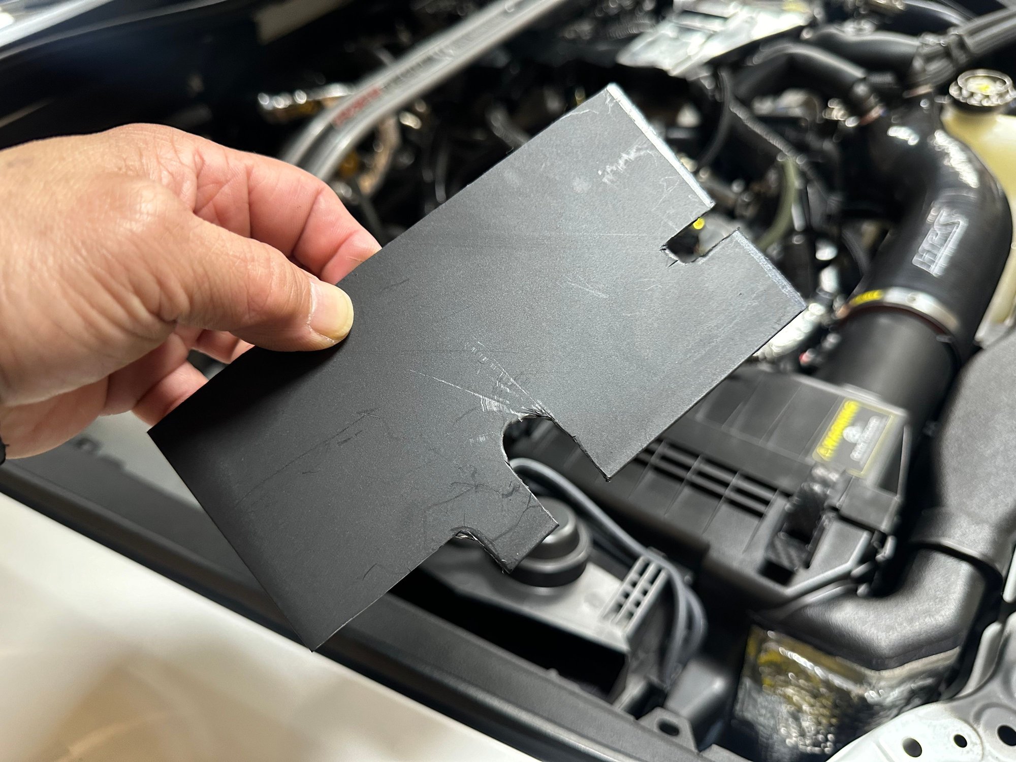

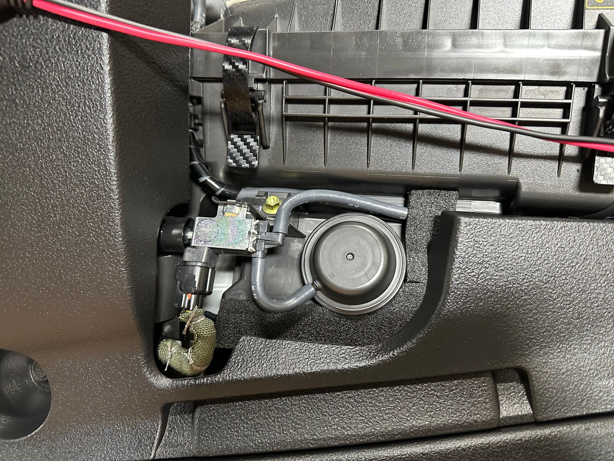

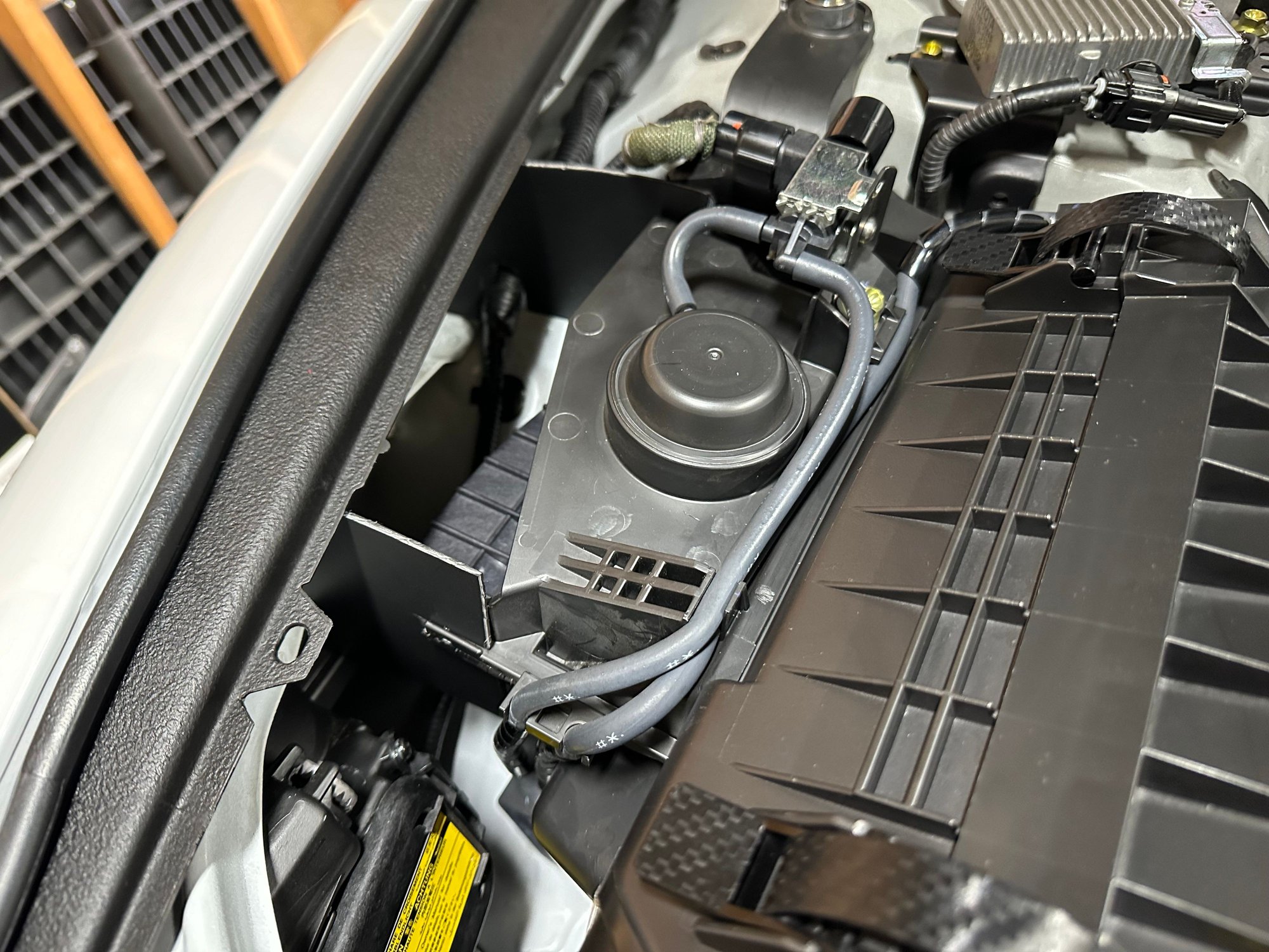

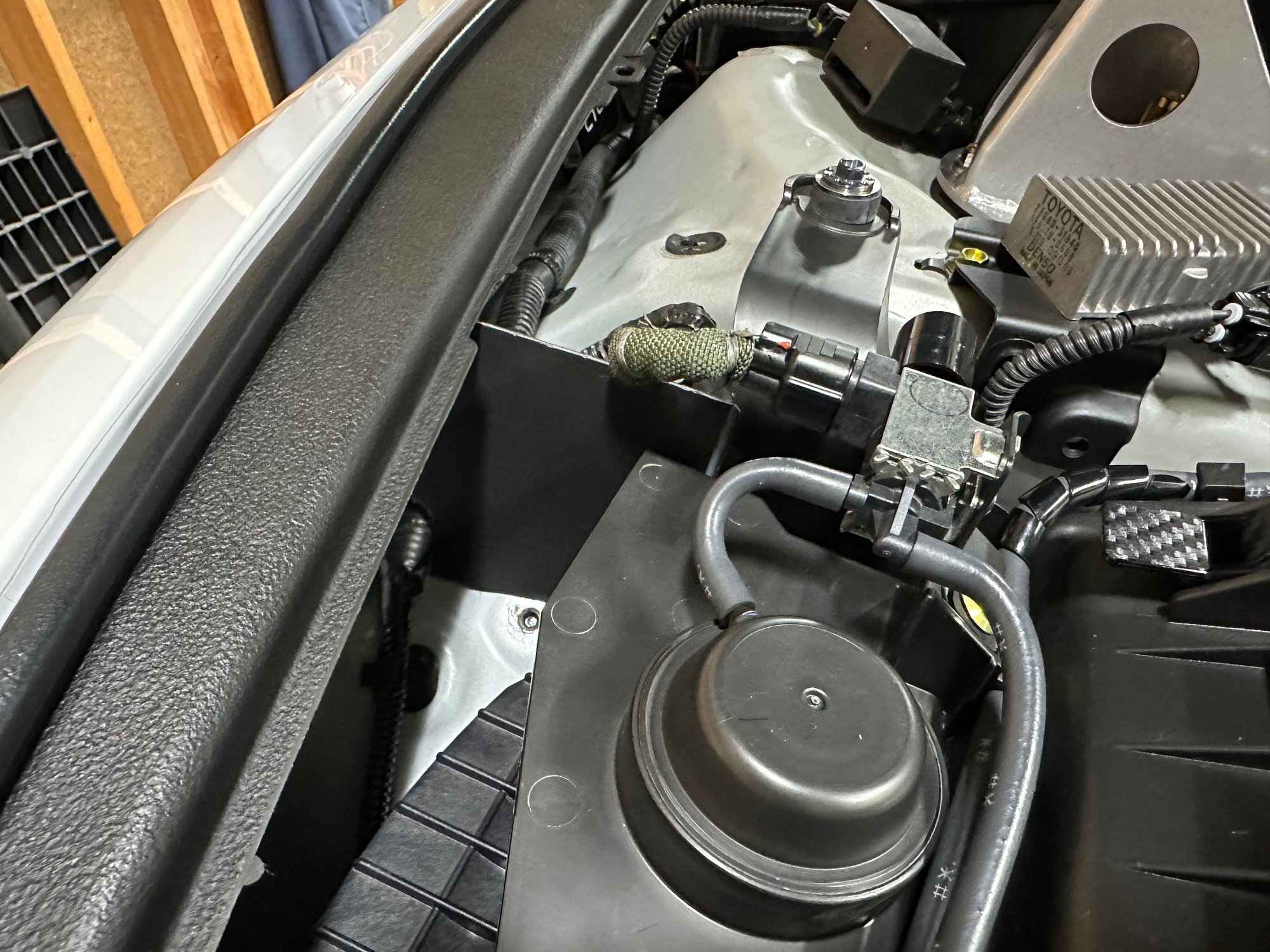

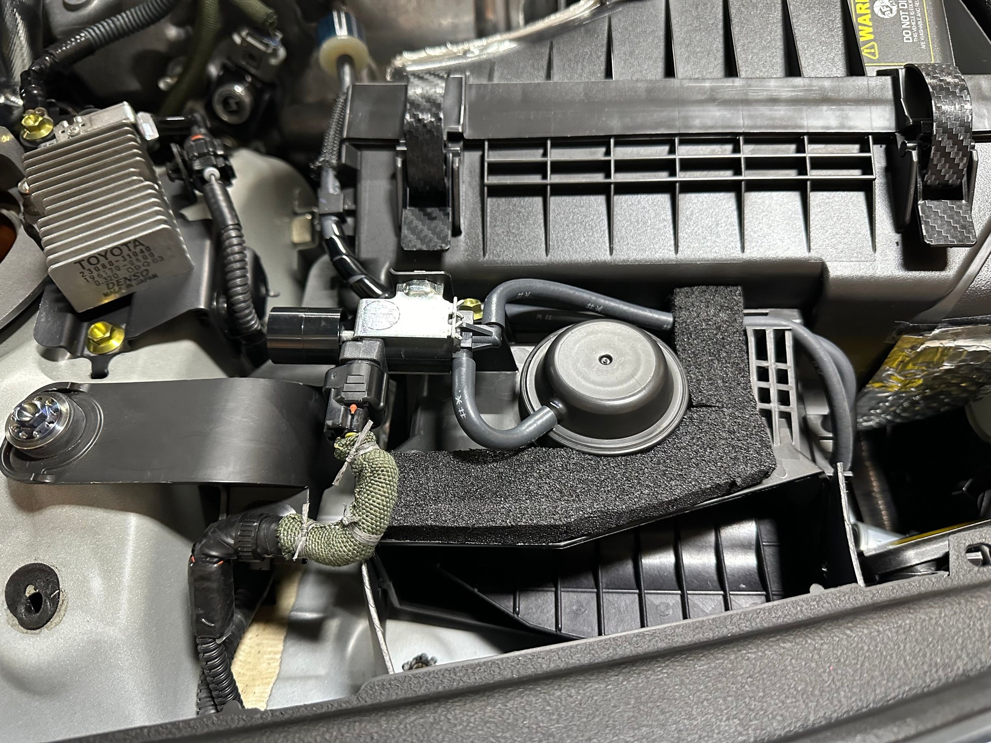

Intake flap hot air block off pieces made and installed. I just used some universal mudflap material.
Made a little bit better catch can bracket, and installed a proper drain system as well.

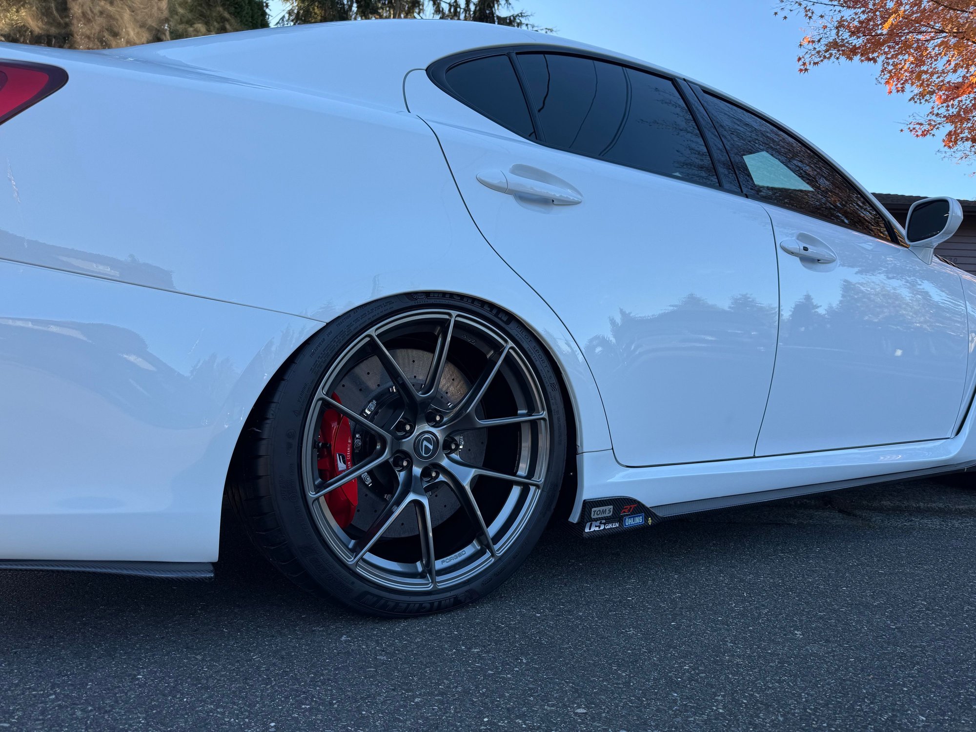

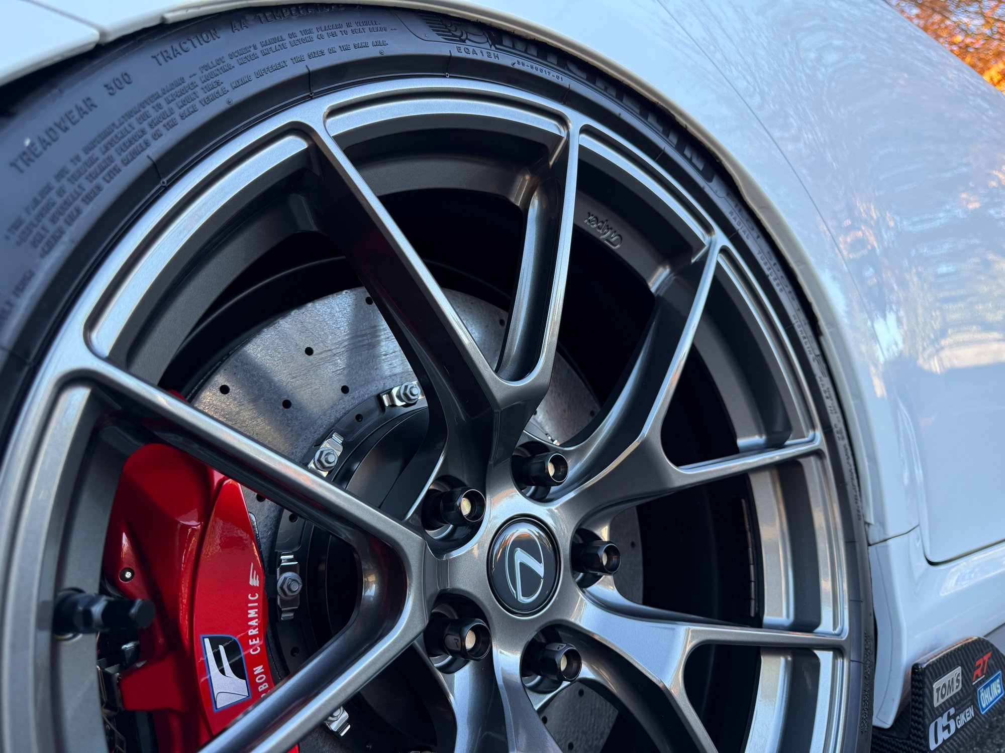

Got these apex VS-5RS wheels in 19x11, 19x10, fitted with some 295/30 and 275/30 PS4S.

Build is excellent. Think I'm going to go in on doing my hubs and such come spring. Might pick up Figs brakes as well while I'm at it.
What was your turning radius like when you were on 275s all around? How close to hard over could you go?
Old Nov 23, 2024 | 11:40 AM
  #615
JT2MA71's Avatar
JT2MA71
iTrader: (7)
Joined: Dec 2006
Posts: 2,643
Likes: 1,996
Thanks! I could go full lock without rubbing.
