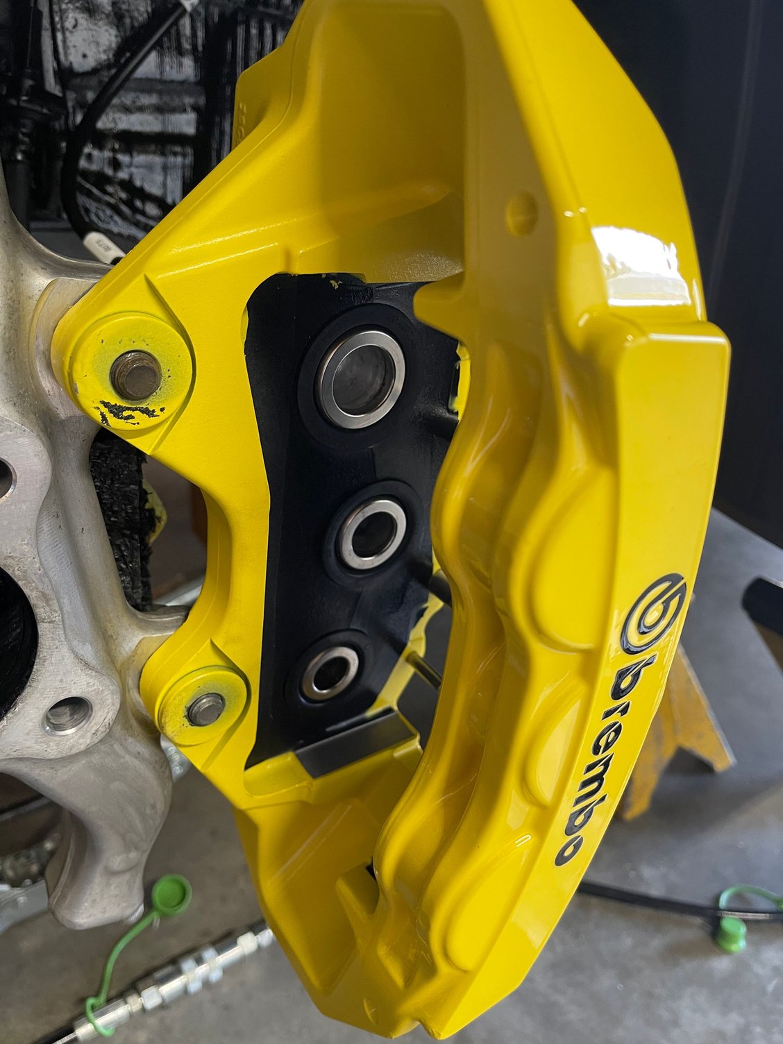

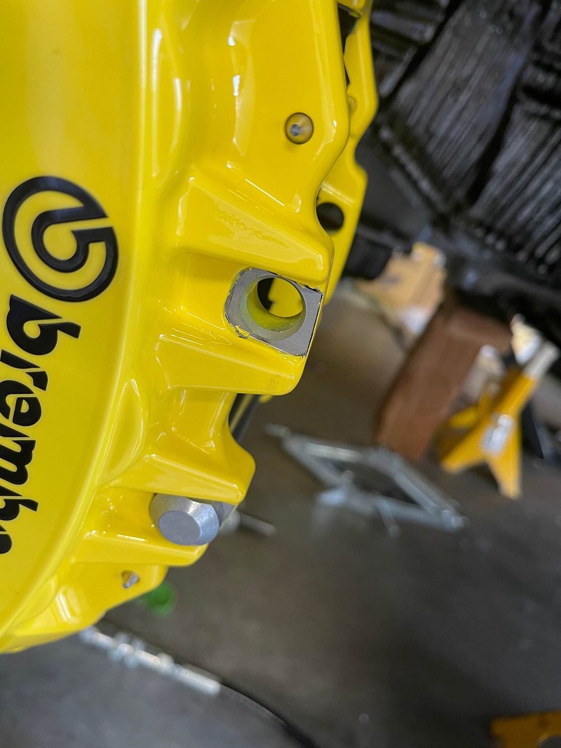

Hey man. Just in case, sand off any surfaces where bolts make contact on your calipers. I had my calipers powdercoated and the surface where the brake line mates to the caliper was painted over. I track the car and I suppose the heat softened up that paint and my brake line loosened enough to disable my braking function. Luckily, I was just parking at the time. Great color choice!

I taped all sealing and mating surfaces before painting Thanks!

The pictures show paint on the captive nuts. Did you remove this? I wouldn't run the calipers shown in your photos without removing the paint on the mount surfaces.
Which mount surfaces have paint? I had bolts screwed into the threads, so no paint in the threads either. I appreciate all the comments though.

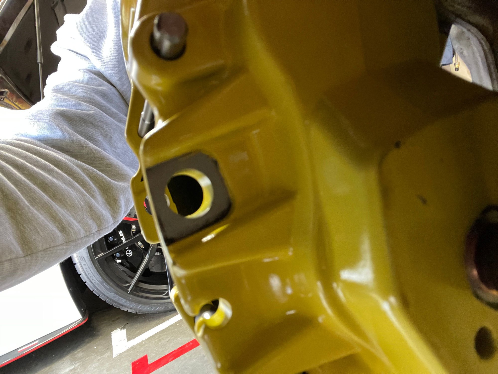

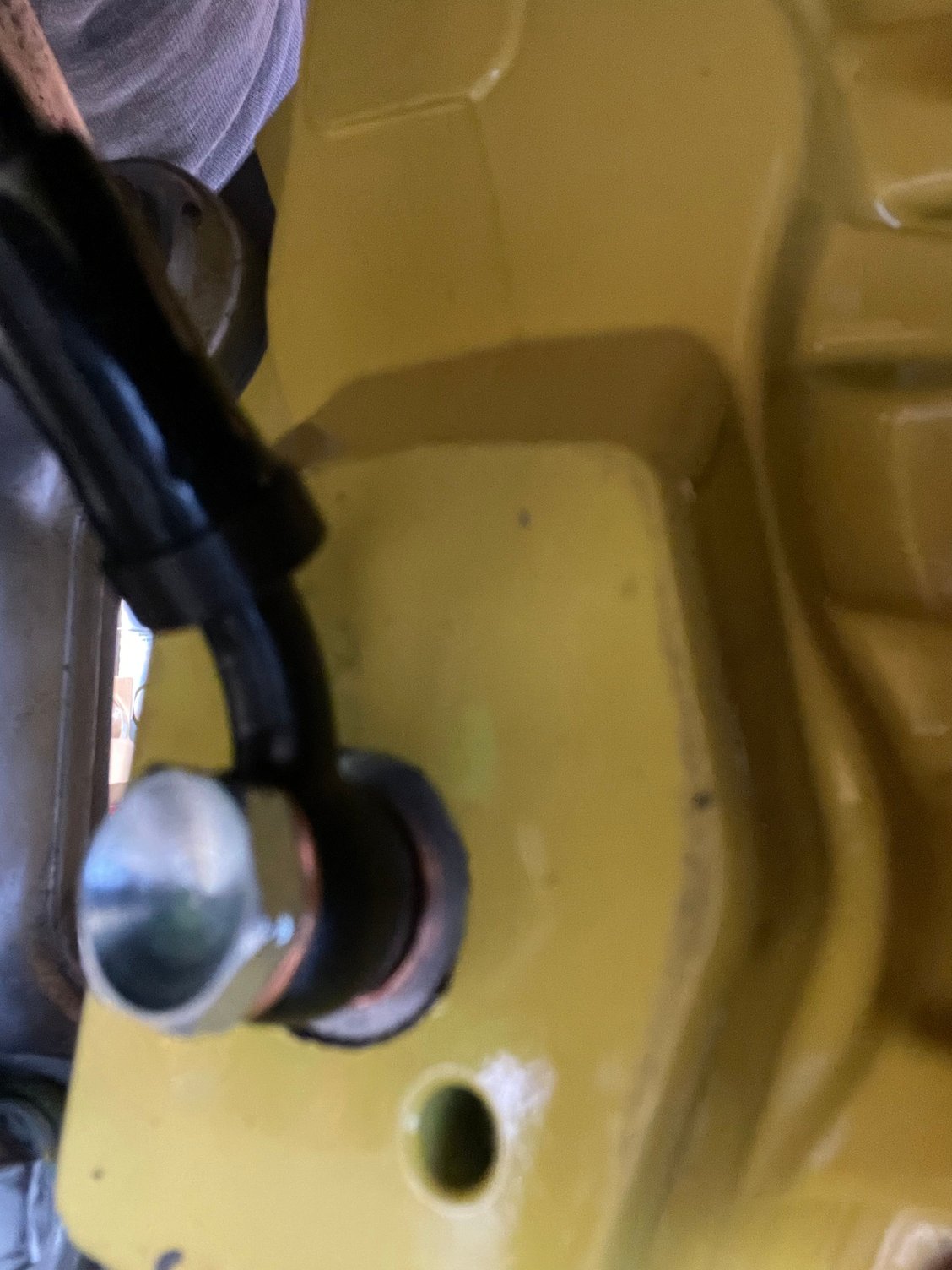

And the rear calipers.

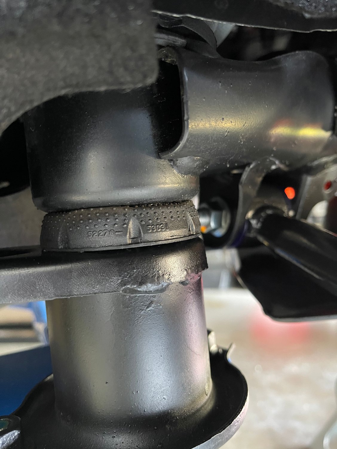

Installed this Super Now rear subframe bushing collars kit.
Rear mount before:
Rear mount after:
Front mount:
Old Mar 18, 2021 | 08:11 PM

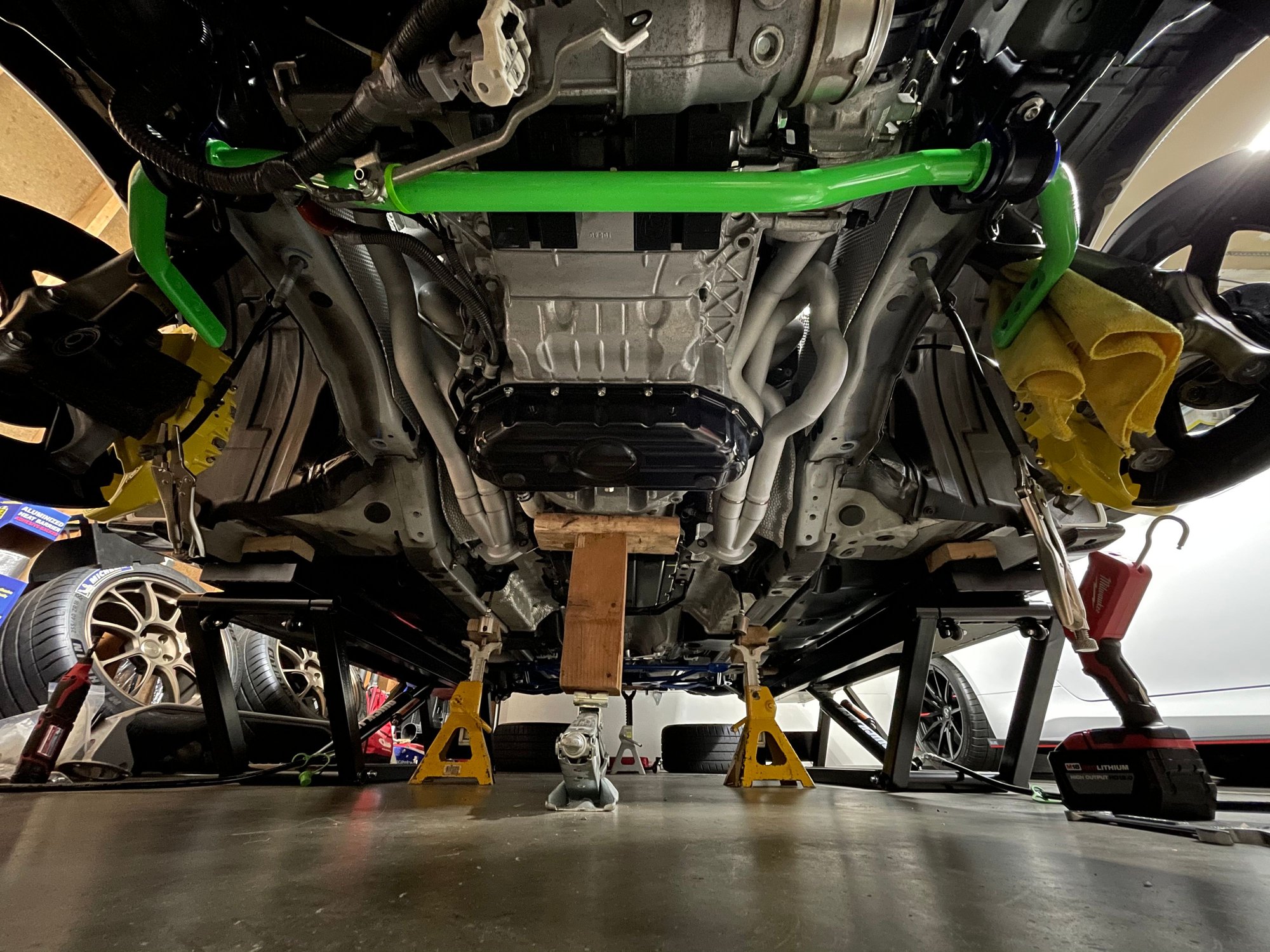

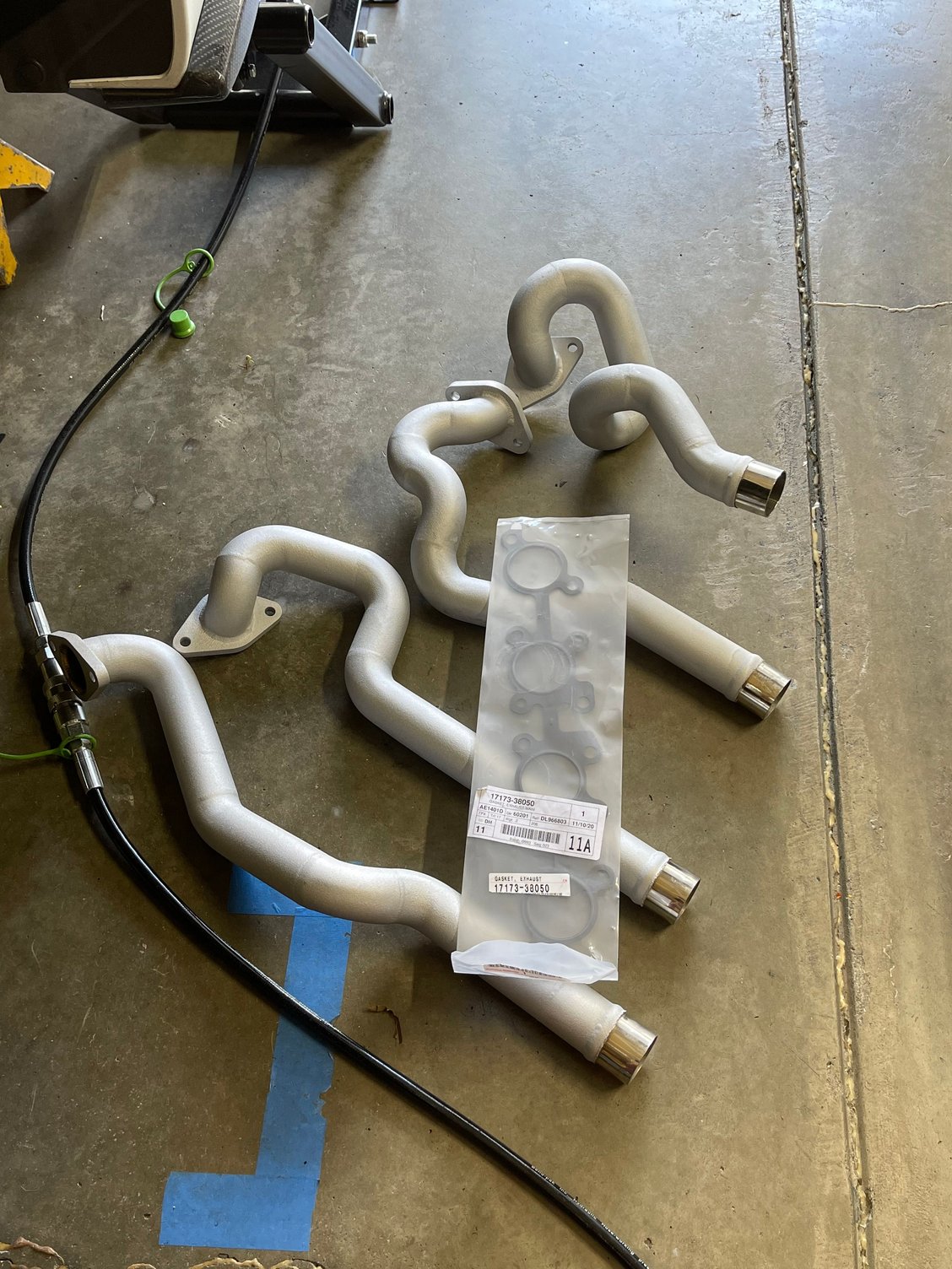

Got the headers back from Swaintech!
Old Mar 20, 2021 | 08:06 AM
  #209
Jwconeil's Avatar
Jwconeil
Moderator
Joined: Apr 2017
Posts: 3,069
Likes: 978
From: Indiana
I don’t know how I missed that those are all separate pieces. How was the install?
Old Mar 20, 2021 | 12:36 PM
  #210
JT2MA71's Avatar
JT2MA71
iTrader: (7)
Joined: Dec 2006
Posts: 2,673
Likes: 2,032
Install is just time consuming. And runners have to go in certain order. Install one runner and then put the collector on to make sure it lines up with the support bracket that’s bolted on the transmission. Torque that runner and remove the collector, then do the same with the next runner.
