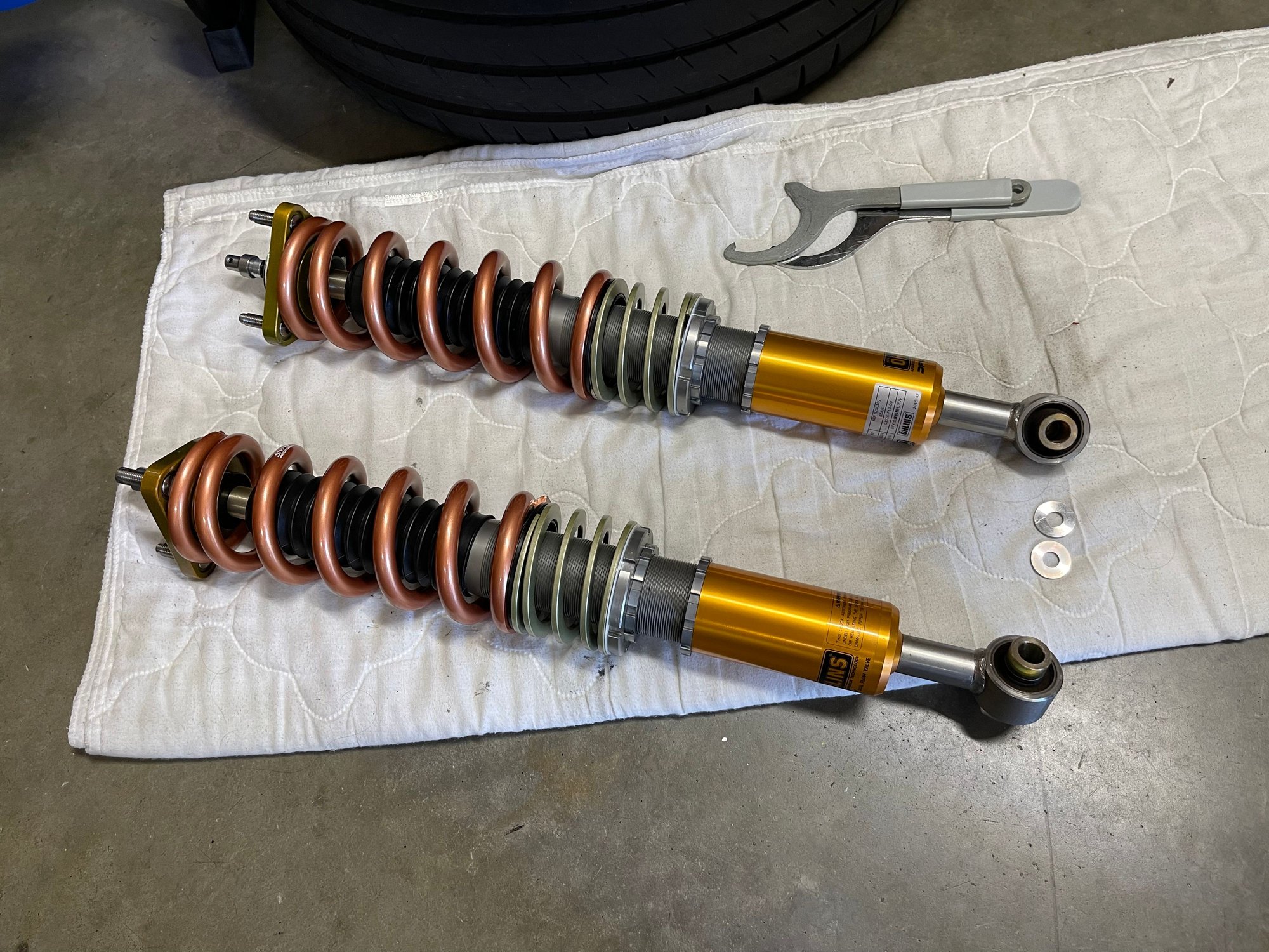

Got some proper rear upper hats from FIGS, replaced the trunk vents while I was at it, and painted the ML amp brackets

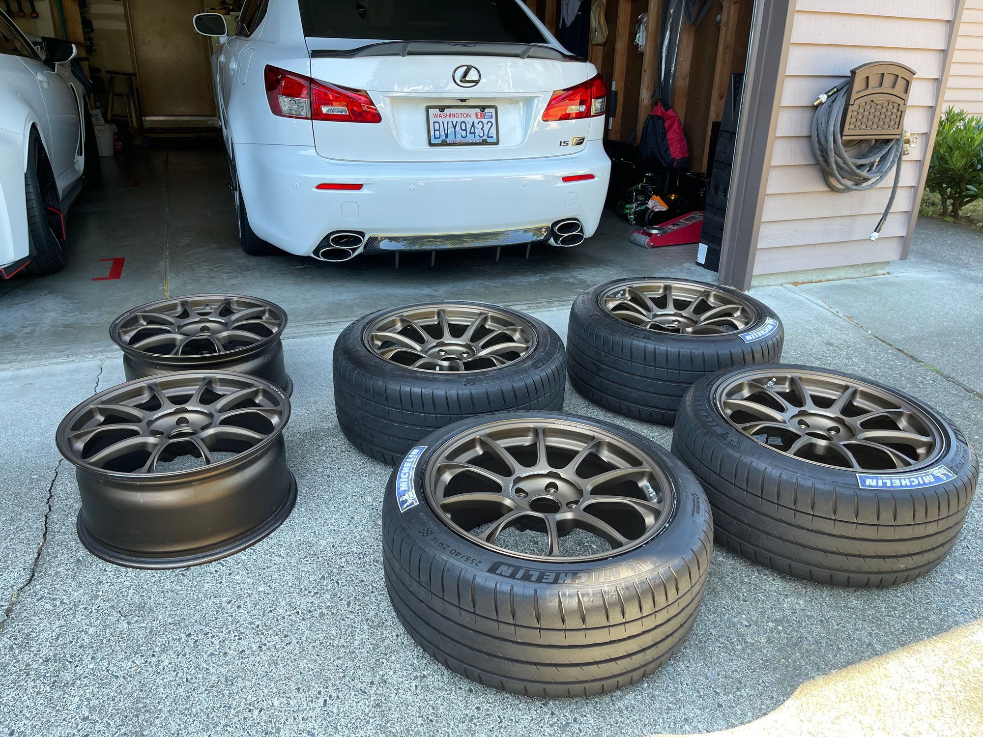

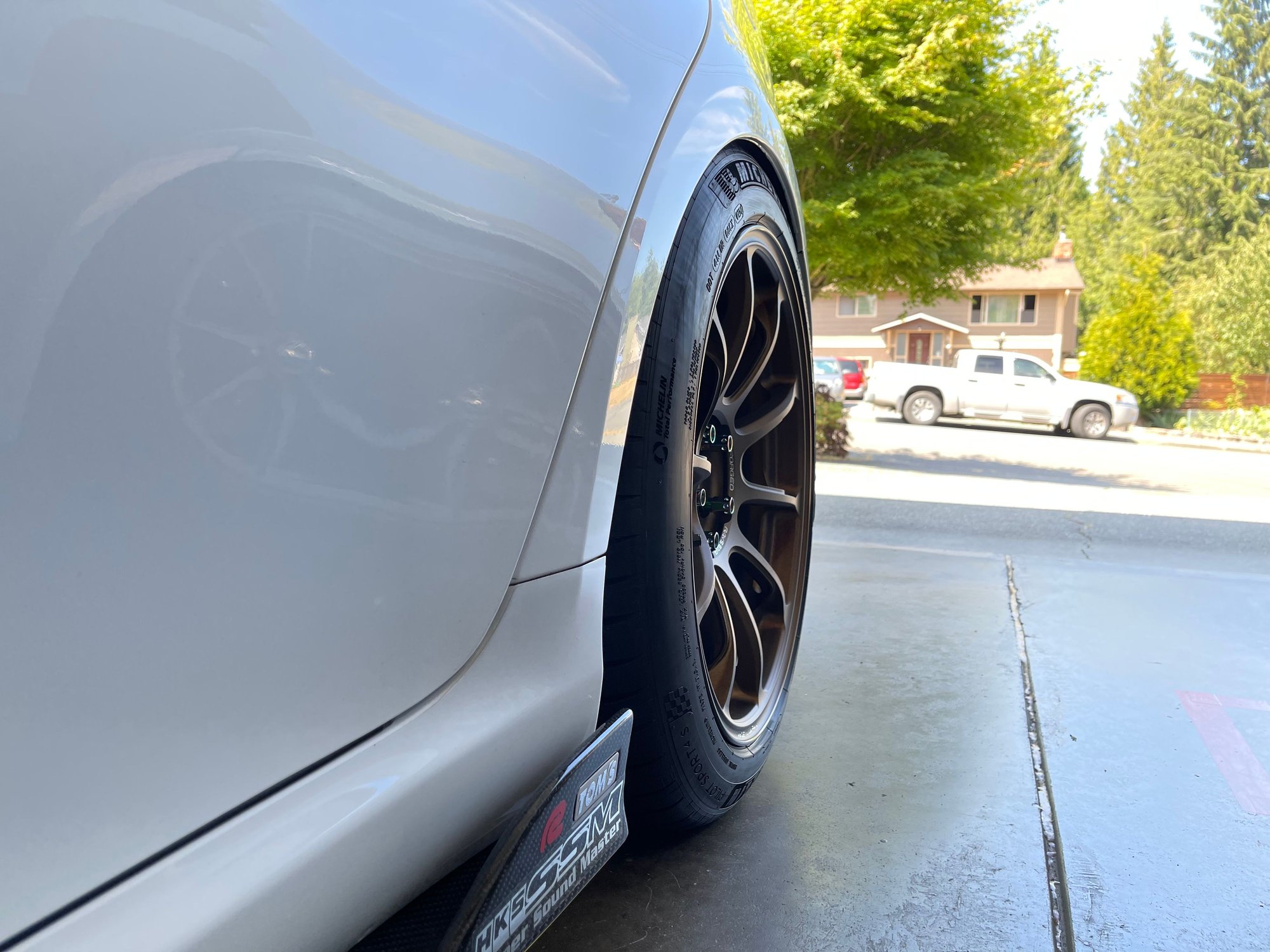

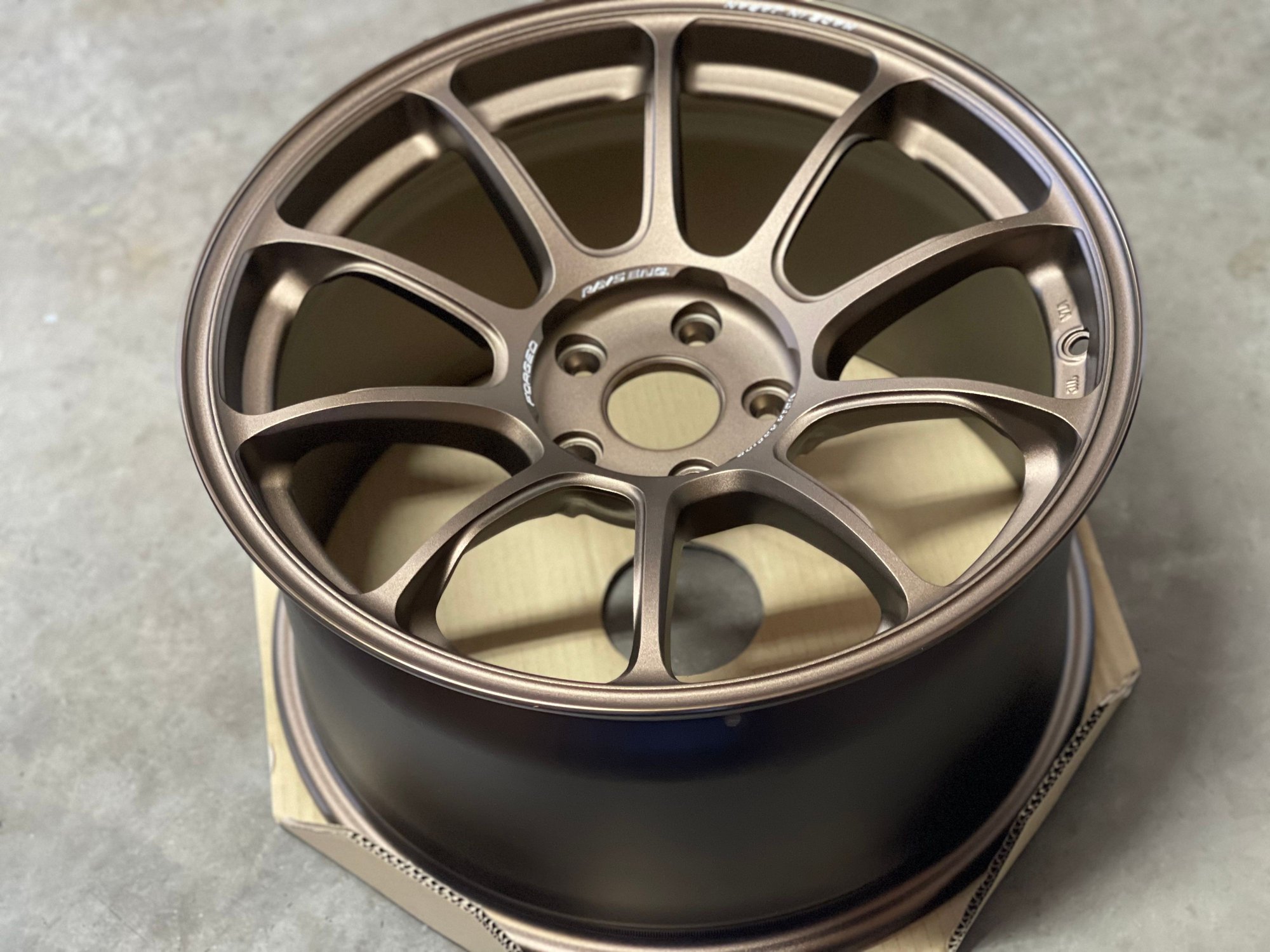

Got the new rear wheels after a 9 mo. wait ,
18x10 +39. So the 9.5 +45 are now in the front.

Did you roll your rears?
