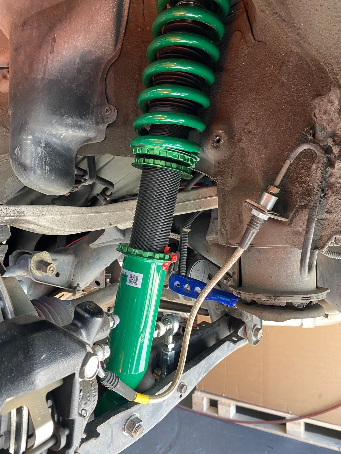

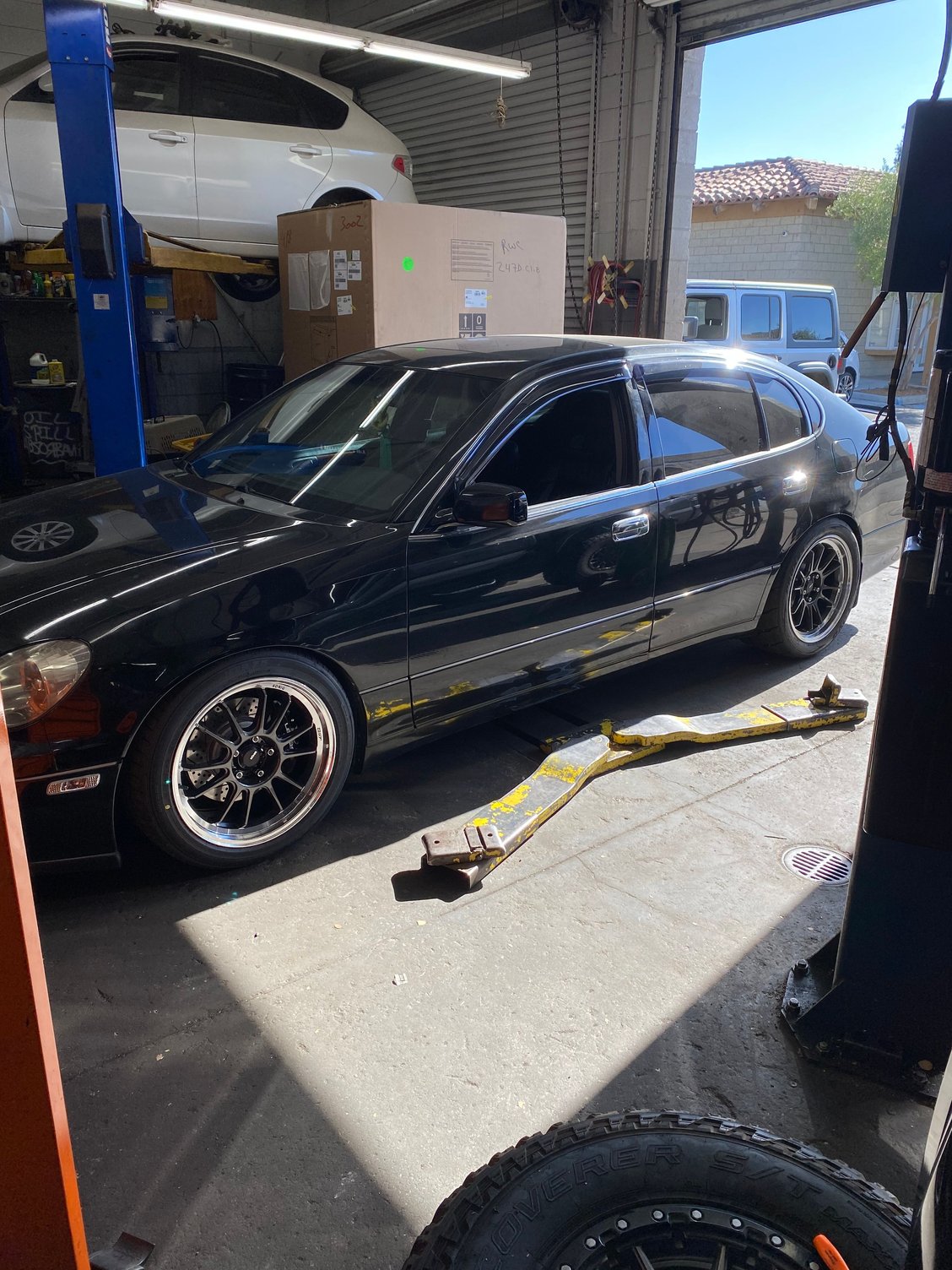

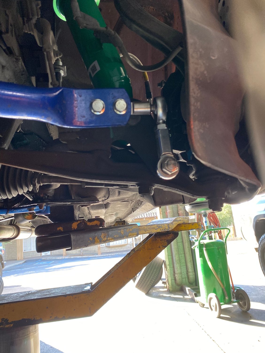

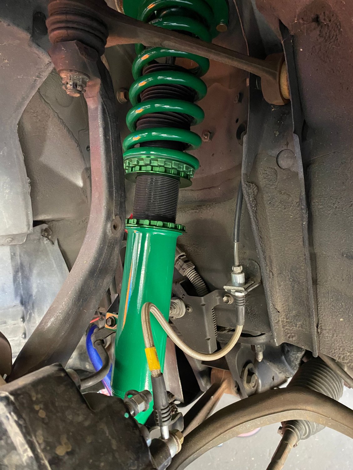

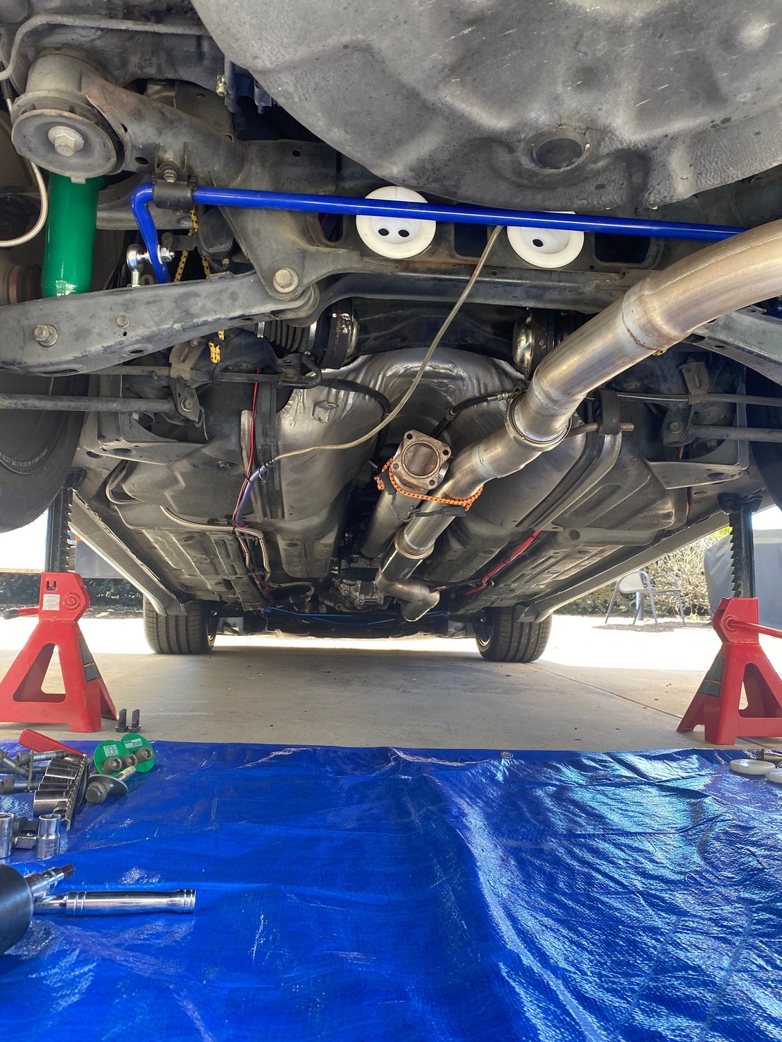

Did my suspension upgrade today. Installed the flex z coilovers and adjustable end links. Adjusted ride height, and aligned. Didn’t take long to find out how stiff I needed dampening to fix my issues. Night and day difference. Basically removed all body role, front lift, and rear squat. No more nose dive under hard braking. Car feels so much more planted and responsive and much safer. I had even forgot that my rear swaybar had three settings and I was in the middle. Moved it to the stiffest setting while doing the links. All in all, it has a very tight street suspension now. I was even able to go lower and close my wheel gap. With the dampers stiff enough, they aren’t coming into contact anymore.

That looks really good and I know it feels more planted to the road!

Thanks, pics never do it justice, especially with my old phone. The tuck is nice front and rear after driving and settling. After a couple drives I feel really confident in the suspension. The car just feels ready to race now! I also forgot to mention that I also swapped to a set of aluminum lug nuts going back together. Not a crazy upgrade I know, but it was the final step to maximising the rotational weight reduction of the wheels/drivetrain. The couple pounds they shave is like spending $1,000 more for a set of wheels that much lighter. Also, they are open ended which is required for most racing venue inspections. Not saying I will be doing that, but that are ready in case.

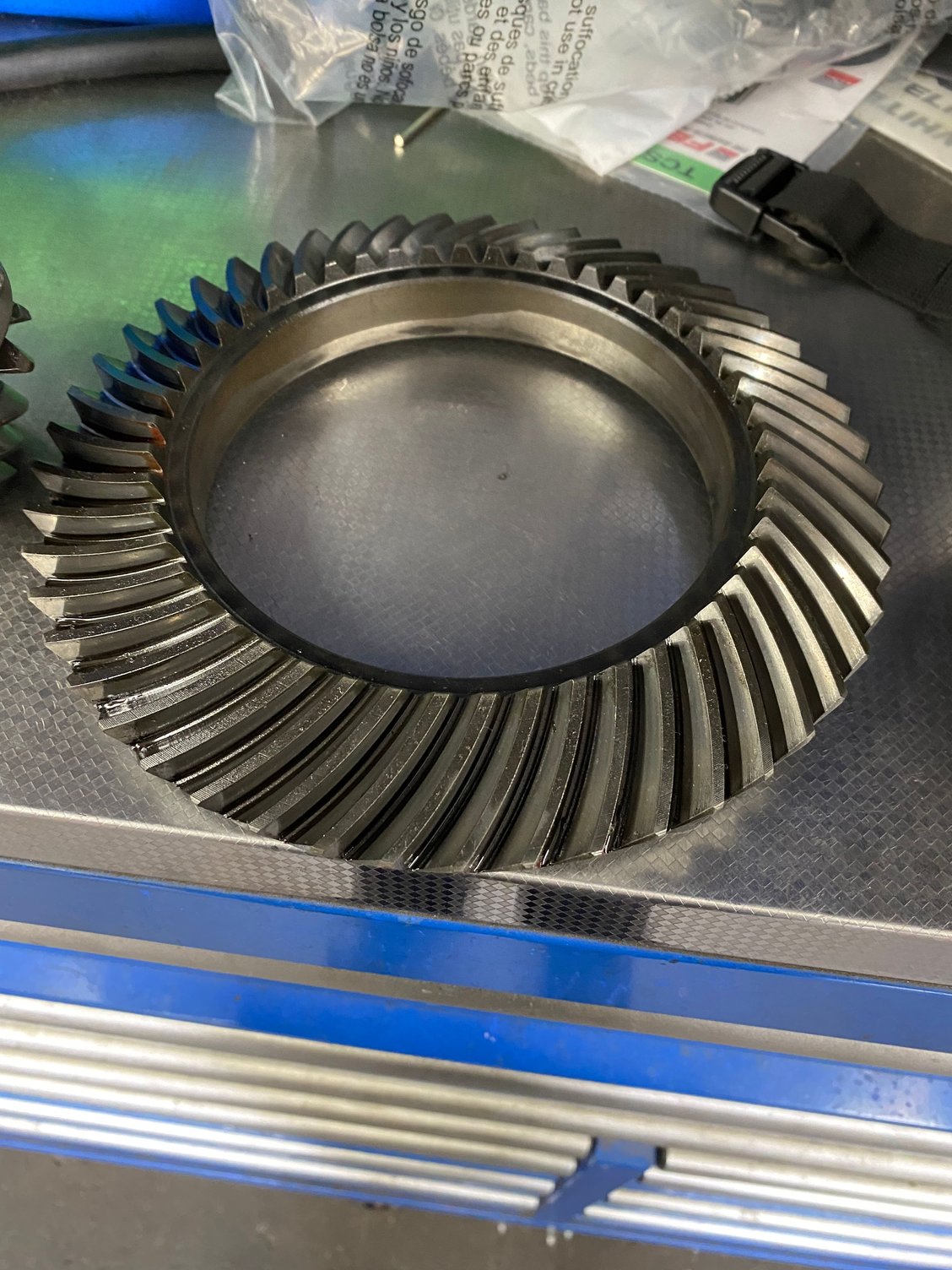

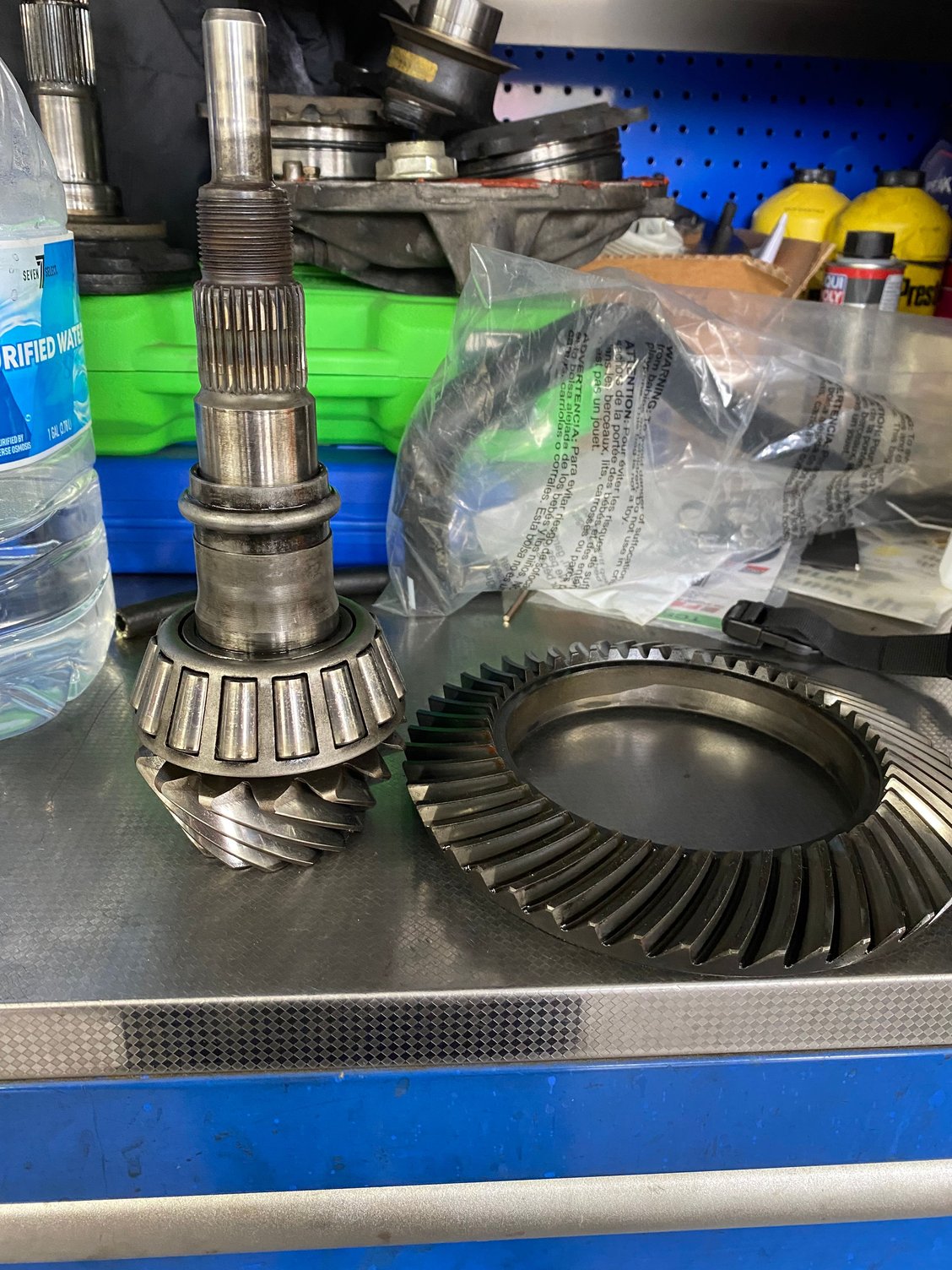

Getting ready to pull my diff and install the 3.26 ring/pinion into it. Disassembled the GS400 diff and swiped the gear set. Once I receive the seals and crush washer I ordered I’ll do the swap.

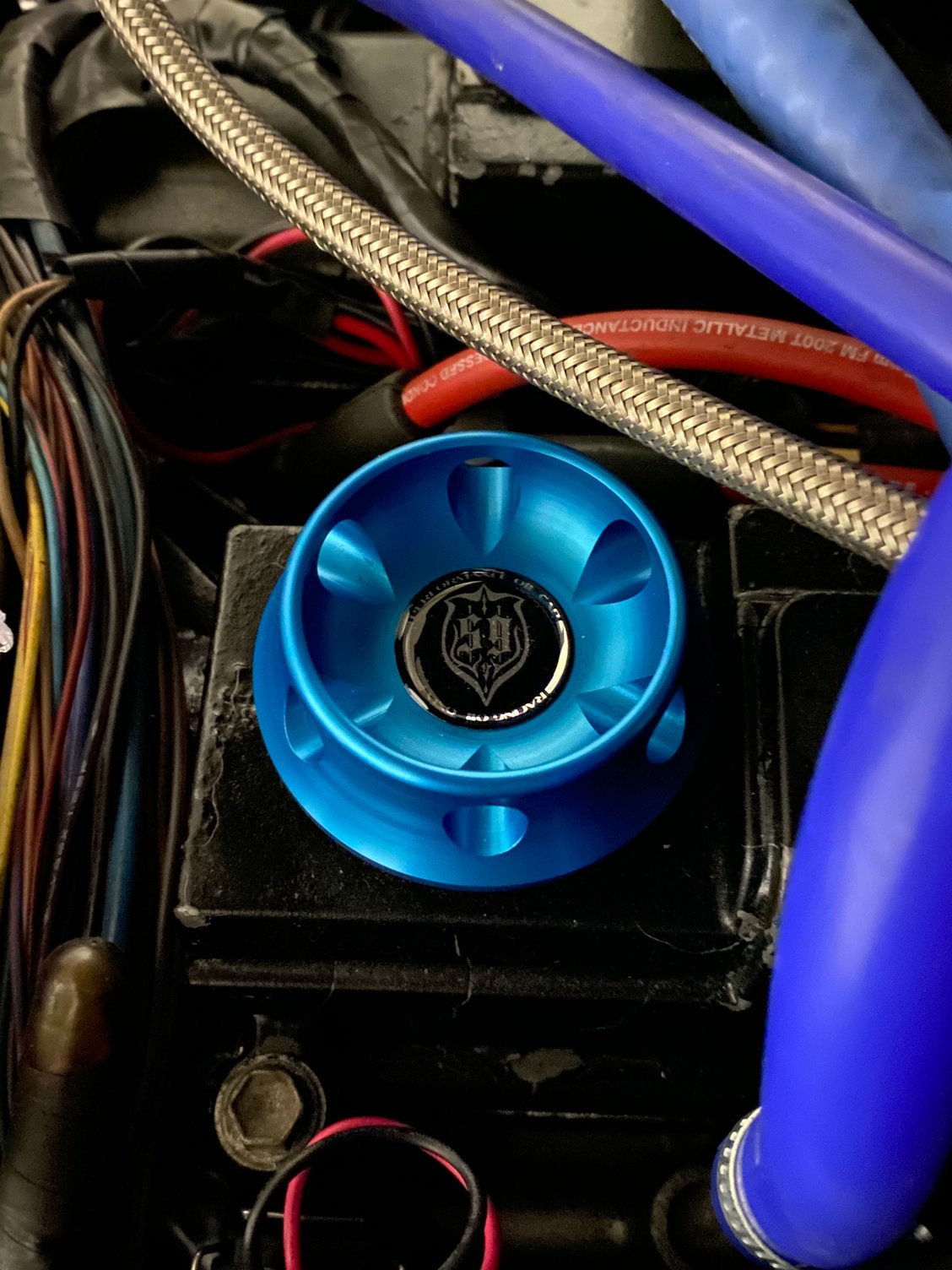

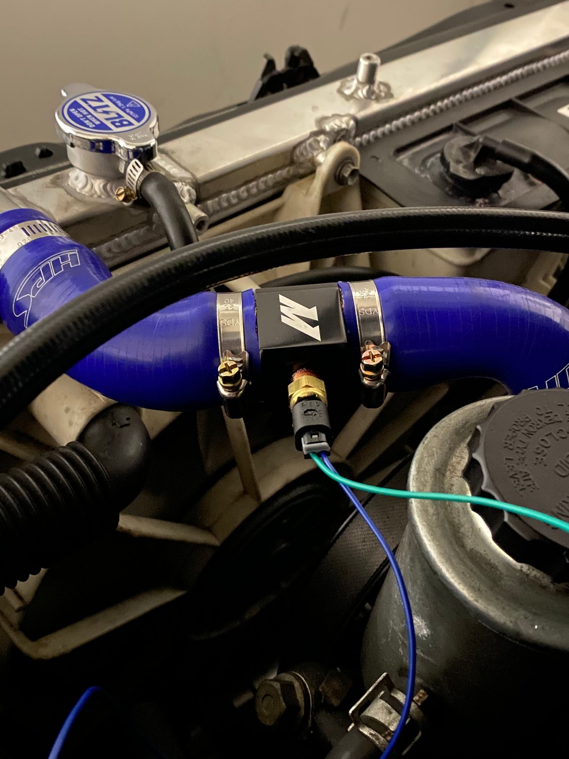

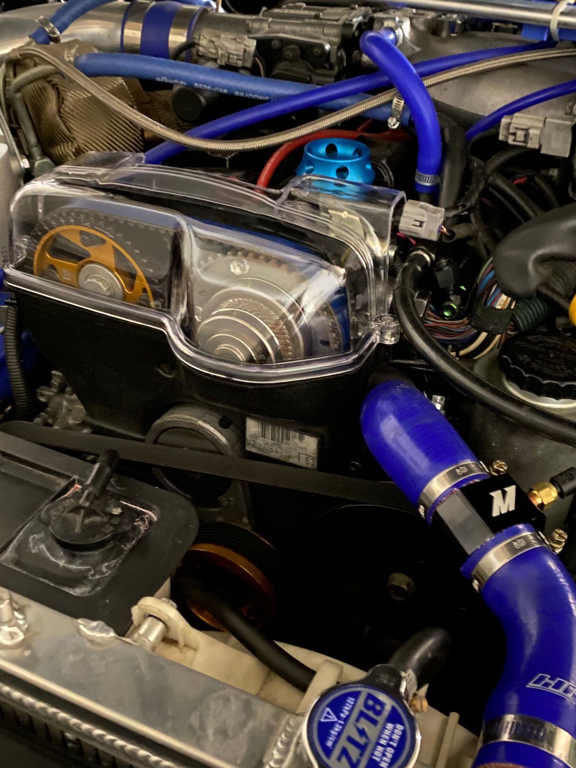

In an effort to have better cold starts, I installed a dedicated ECT sensor for the AEM ECU using a Mishimoto adapter in the upper rad hose. Still working on the programming/scaling. And the oil cap is because I couldn’t help myself . Another premium Serialnine part.
Will be pulling the diff next for the gear swap.

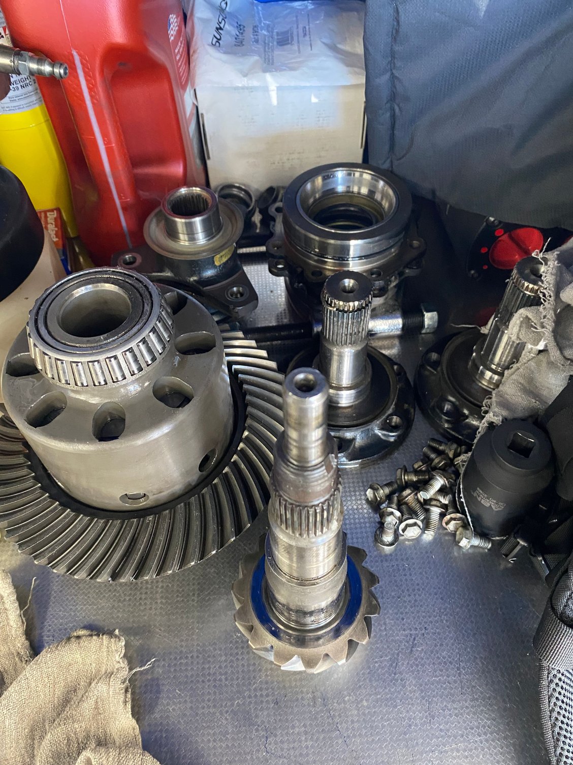

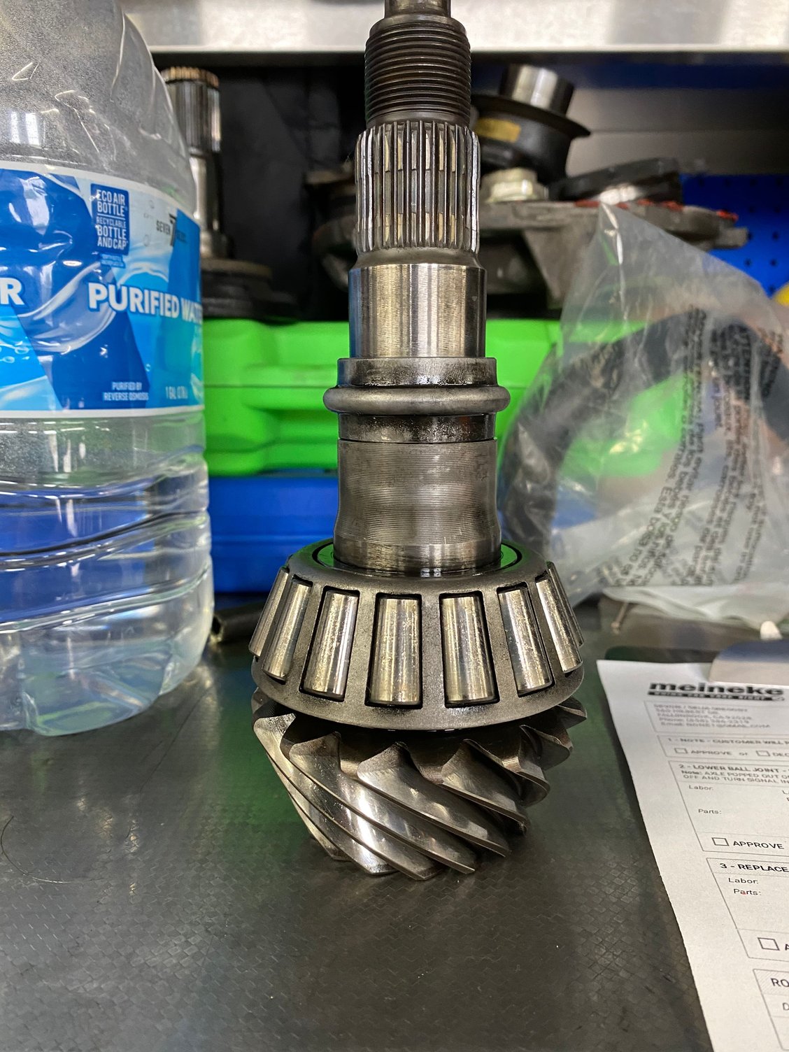

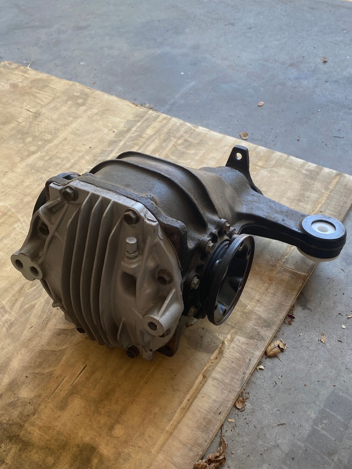

Today I pulled the diff to swap the gears. Looking forward to the 3.26’s. Will make the JK41A gears way more usable.

Waiting on one bearing from Toyota I wasn’t able to save, but all parts are cleaned, seals replaced, and new fluid ready for install. Ring gear torqued w/ loctite to the OS Giken LSD. Just have to press the rear bearing onto the pinion and put it back together.

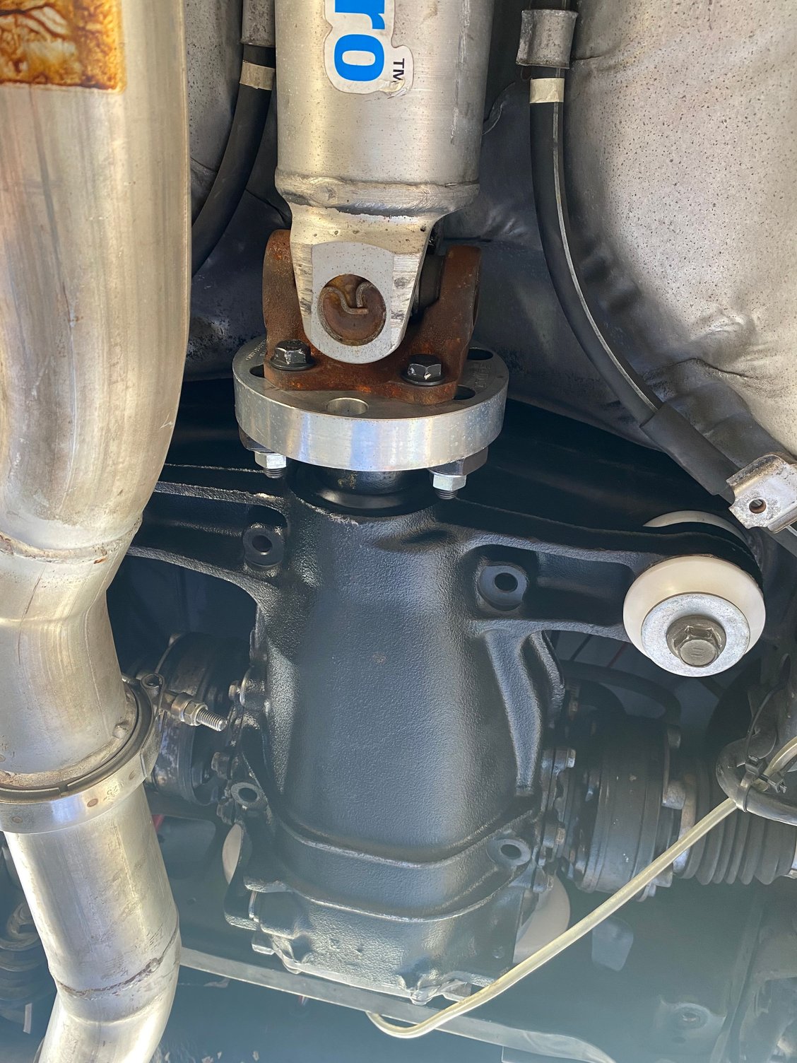

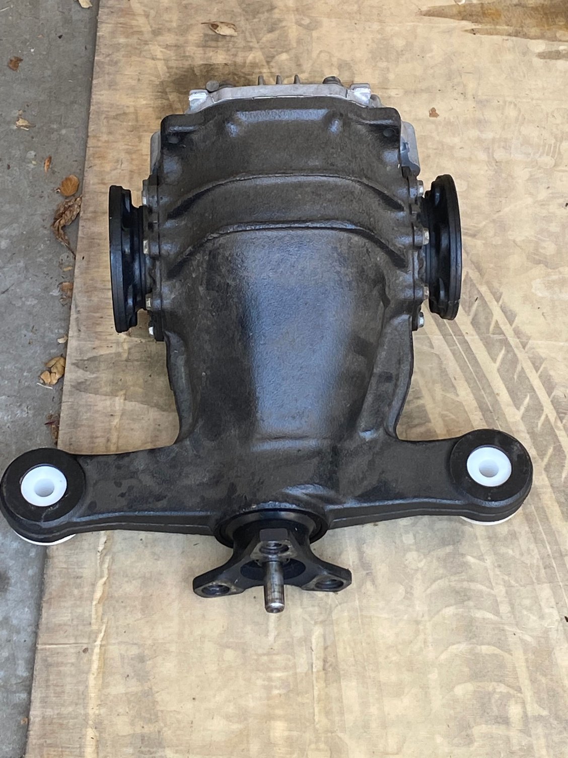

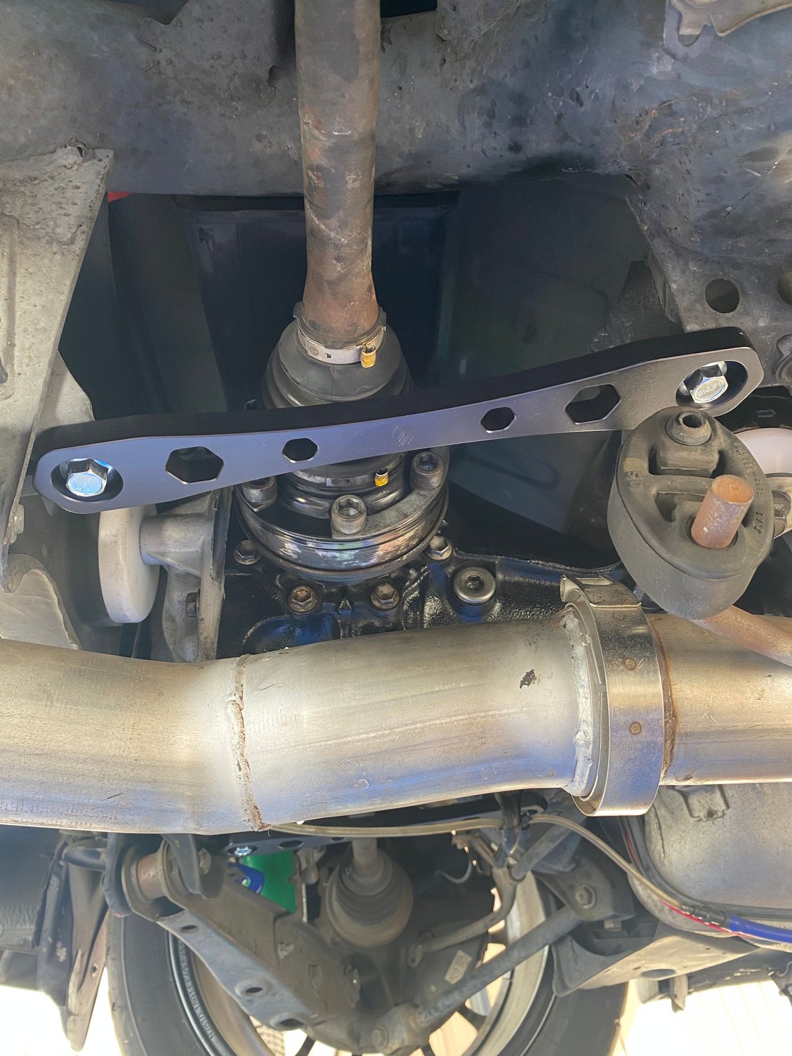

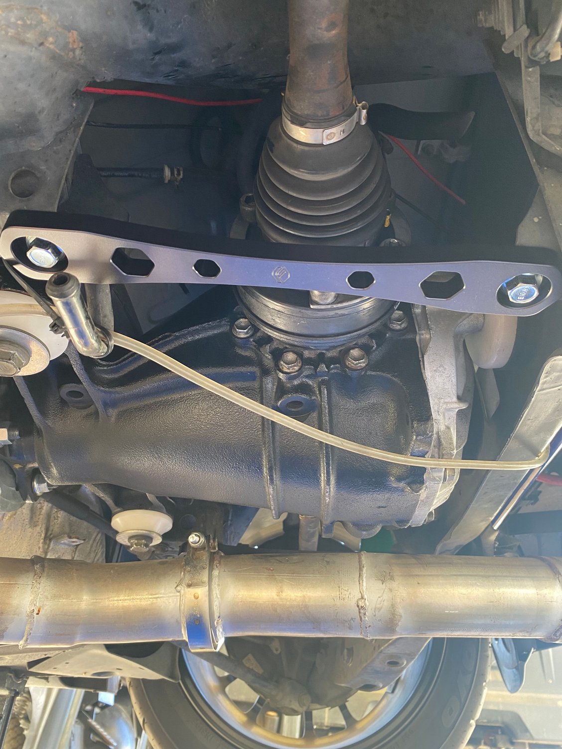

Got the diff back together with the 3.26 gears. Test drove and man what a difference! Power band is much more usable and I can actually cruise at a good rpm making for way better fuel efficiency. Also installed some Figs lower subframe braces in place of the flimsy oem ones. Still loving the Serialnine solid diff bushings and of course the OS Giken LSD.

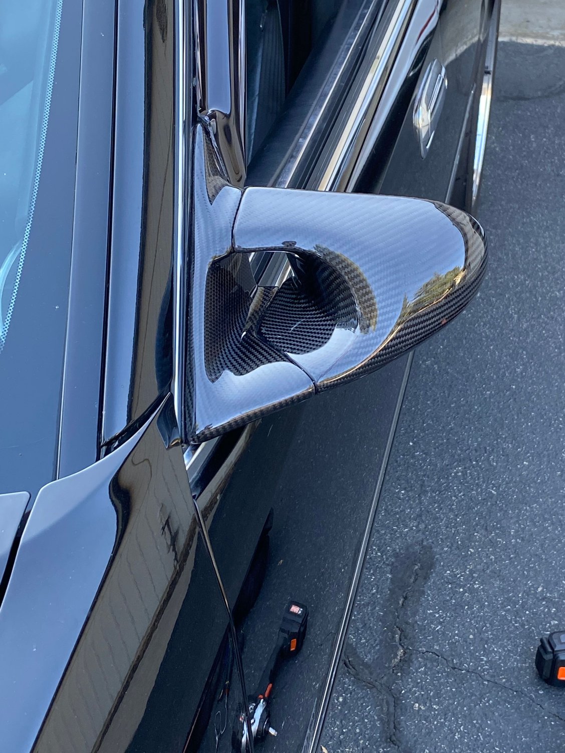

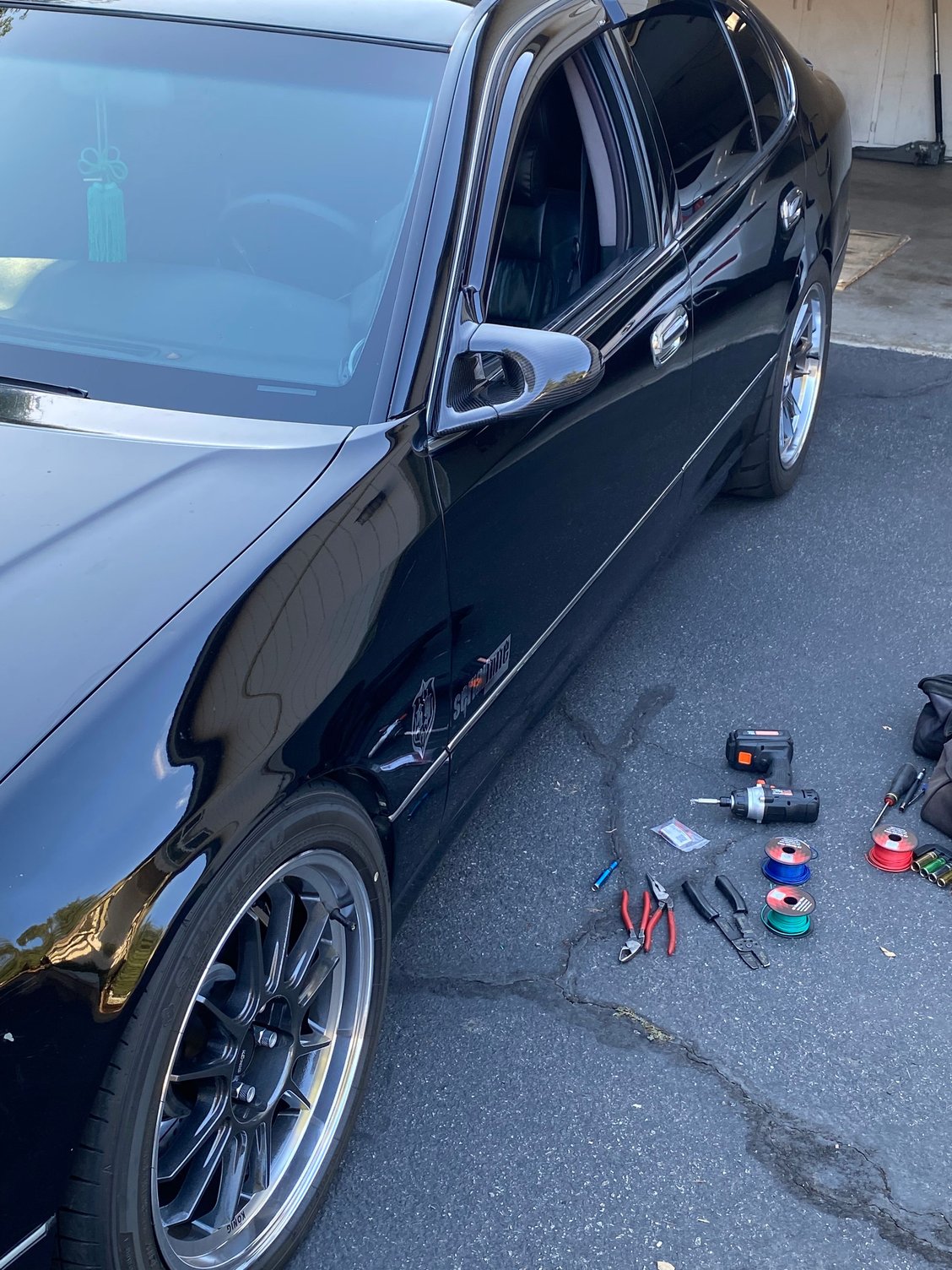

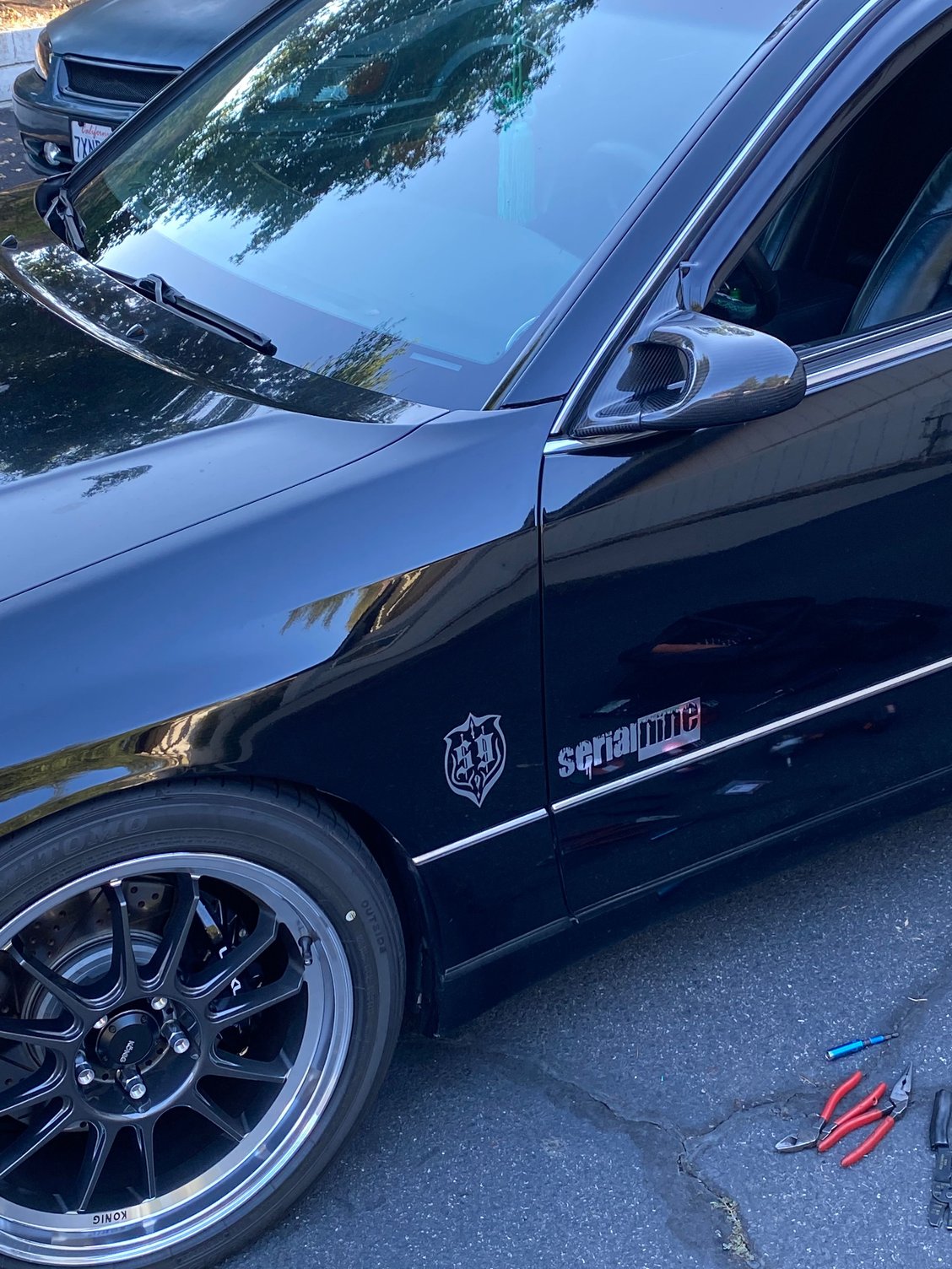

Working on the carbon fiber mirrors install. Just finished the driver’s side. All wired up and working/looking great.

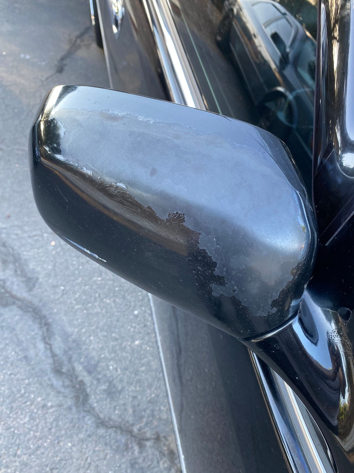

Here’s how nasty my oem ones are.

They look sweat!!! How is the visibility? Been thinking about these for a while but I hear the visibility is ****. Can you send me the link? Thanks
