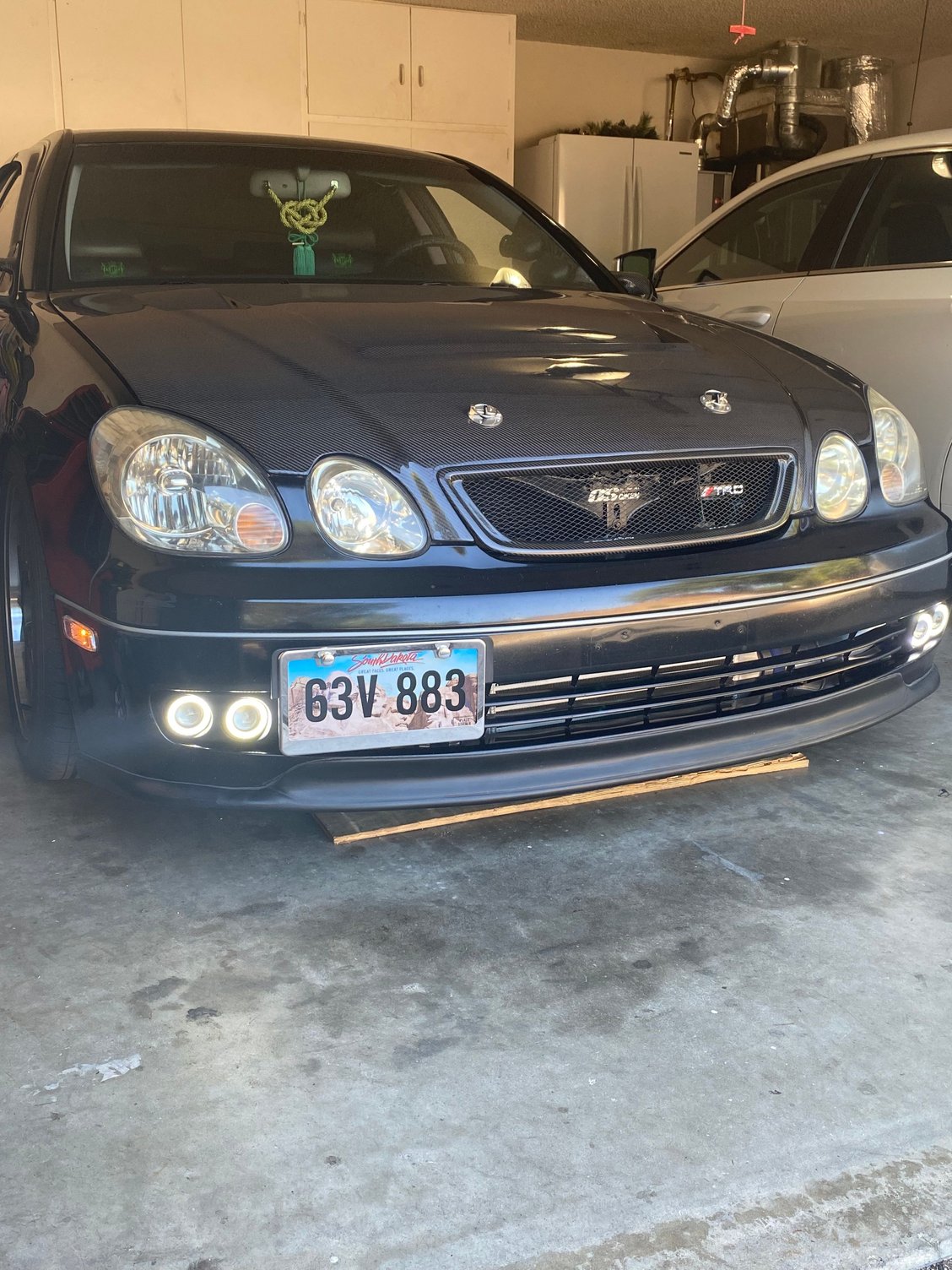

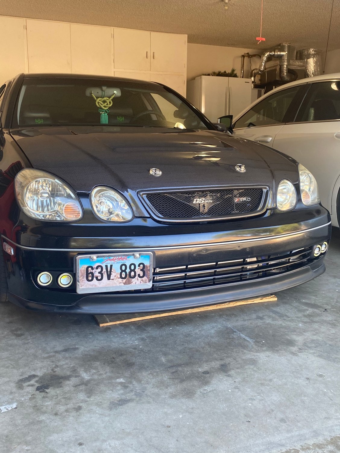

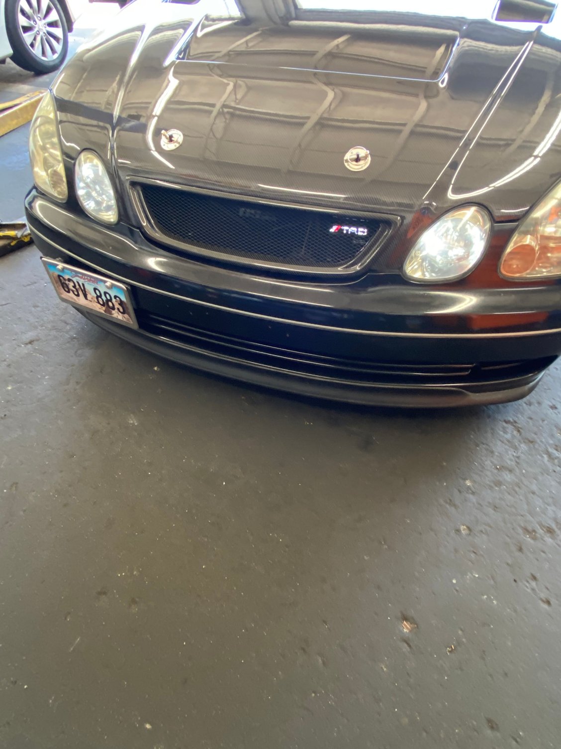

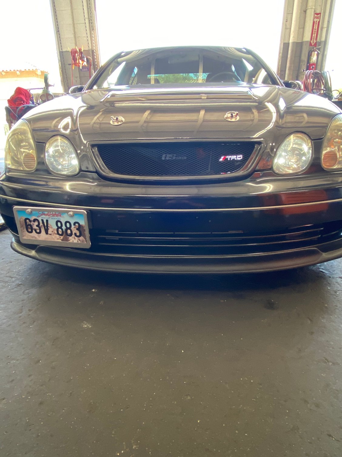

Installed a lighted TRD emblem that’s shows nicely behind the grille. Wired it to come on with the running lights.

Finally received and installed my new fog lights. These are very slim and fit great without hitting the intercooler pipes. No more open holes! Like the TRD light, I jumped from the running lights that go into the bright side housing.

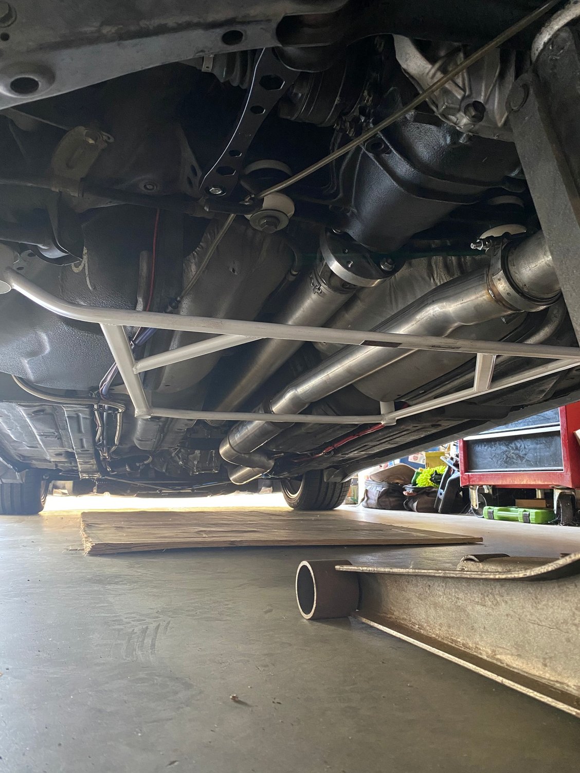

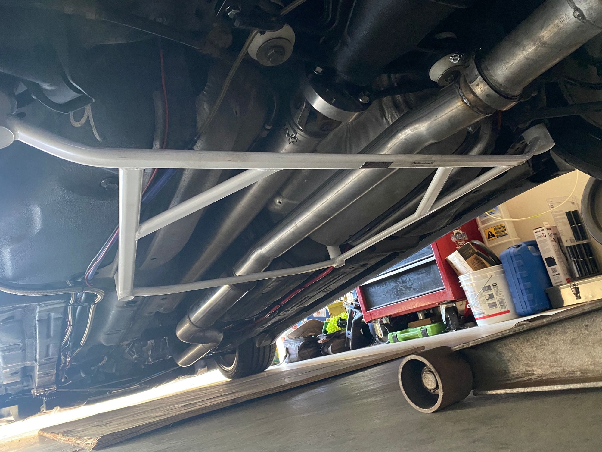

Finally got around to installing this 4 point rear under brace. Had to have the exhaust cut, re-angled and welded because it was too low and interfered with being able to bolt it on. Seems to help in the ways I was hoping for at hi speeds and hard pulls. Been noticing the flex in the chassis after substantially increased power. Trying to make it feel more planted.
I also Black Friday’d some new goodies. I’ll be custom fitting then over the winter. Will update with pics as that progresses.

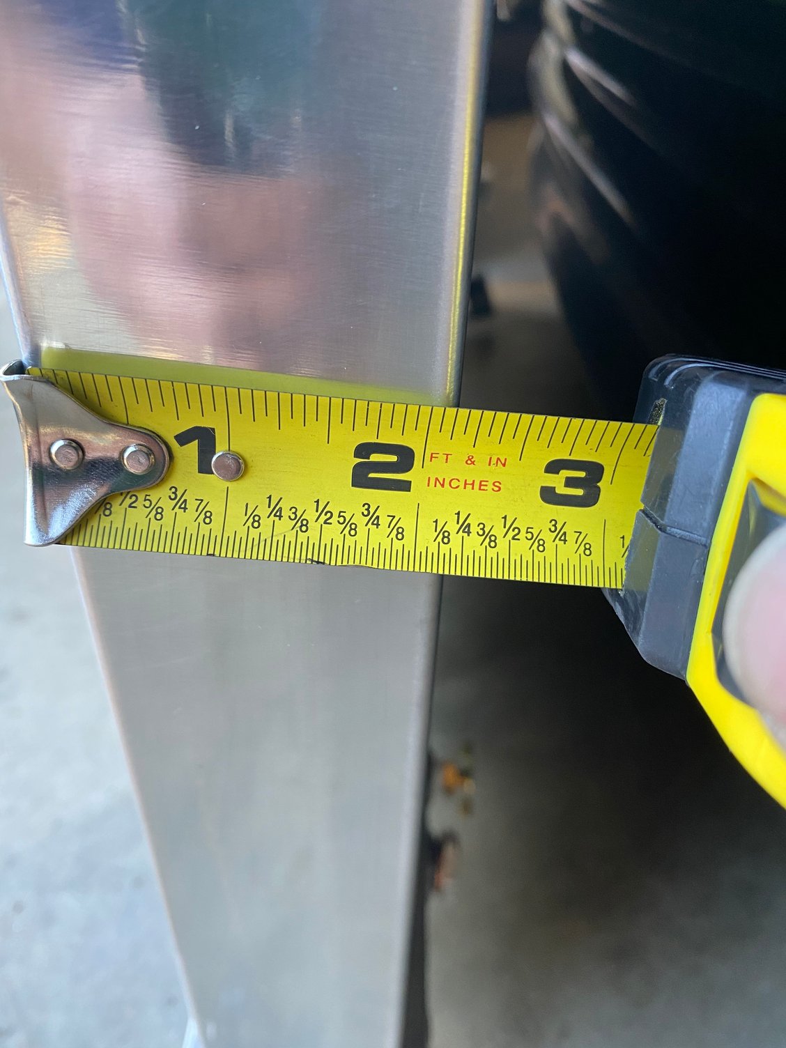

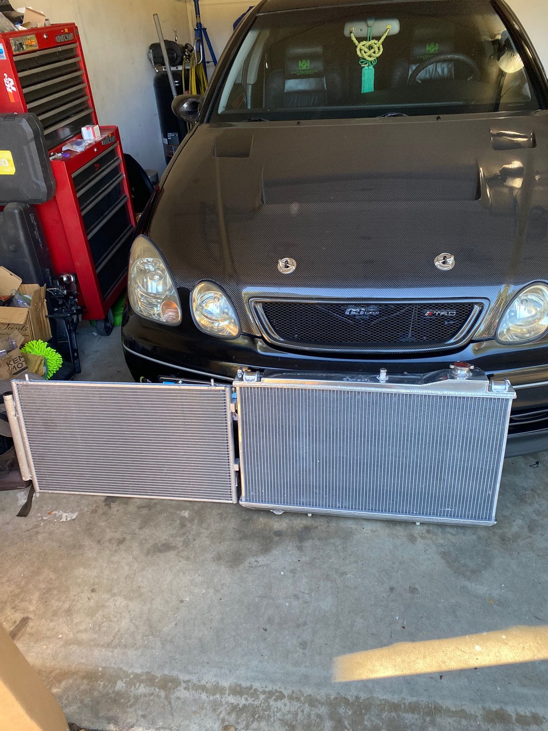

I'm upgrading my radiator and intercooler mainly. Also replacing my A/C condenser while I'm in there because I suspect it has a slow leak. It has been marred up because of having an auto trans cooler attached to it in the past, the FMIC installation, and the radiator in and out a lot over the years. Been slowly losing the charge since making the modifications. The radiator is a PHR 2-1/8" thick specifically for the GS300/400 and does not have an integrated cooler because I'm manual swapped. My current aluminum radiator is an eBay unit and only 1" thick. The new FMIC is a Treadstone TR1245 (4" thick) that supports 1000hp. MY current one is from CX-Racing and is only meant to support 600hp, although I'm squeezing more out. I believe it is my choke point on my mission to 800whp. These all give me a reason to pull the front clip and custom fit everything carefully. I'm also swapping to a 170 degree thermostat while the coolant is drained, still running the OEM 180.
There are some other non-performance things going on too. Left rear door started to not open without a fight, so need to pull the panel and figure that out, the horn contacts aren't good in my aftermarket steering wheel hub. Need to re do that. Little annoyances here and there. Car needs raised maybe 1/8" on the coilovers to stop the last bit of rubbing, then re-align. Plenty to keep me busy this winter.
