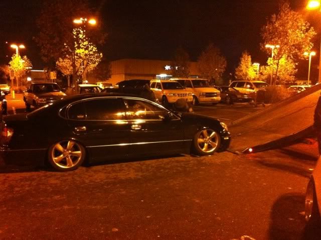

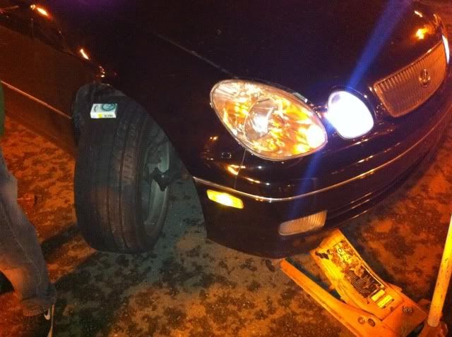

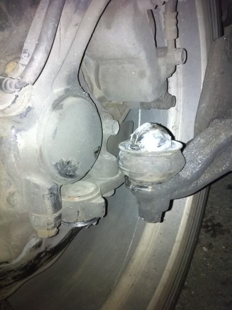

Trying to pull into a parking space and this happens :[
Next day changed WHOLE front and rear end bushings/end links/ball joints

My 2000 Lexus GS 300 did the exact same thing at 152,000 miles. We were going 80 miles per hour and it actually hoped up in the air. We could have rolled. We had just fixed the left one and started hears noises from the right side. We even called our mechanic and told him to order the part so he could fix it when we got home. We were 3 hours away in Albuquerque at the time. We were left standed in the middle of nowhere. It cost $150.00 just to tow us to the nearest town. It ruined our custom wheel and looked like your pic except our tire wore down from round to straight. It could have been much much worse. I was asleep with no seatbeat on. If you fix one side make sure you fix the other side at the same time. It WILL go out too!!! Once you start hearing those funky noises up front. Take it in right away.
