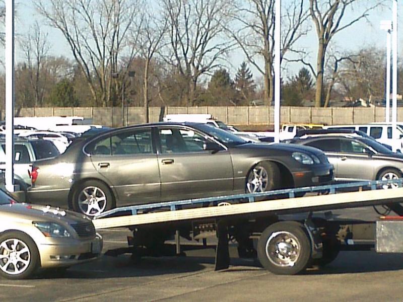

Here is one that was getting dropped off at one of our dealers.
Holy crap that could of been a lot worse! I have some definite movement and clunking sounds coming from my front end, and this thread has scared the crap out of me. I was stockpiling all the parts to rebuild my entire suspension all at once, but these posts make me not want to even drive my car at all.
