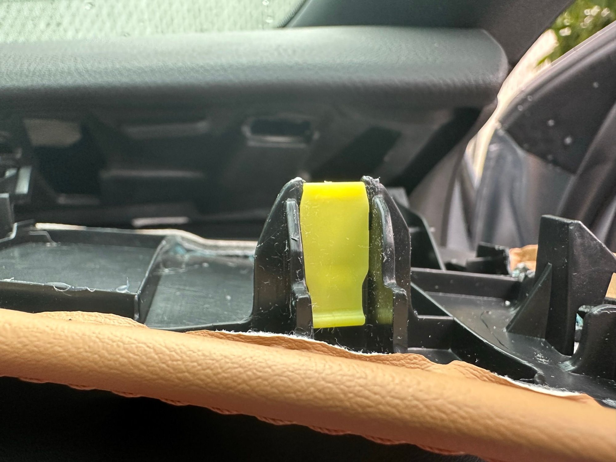

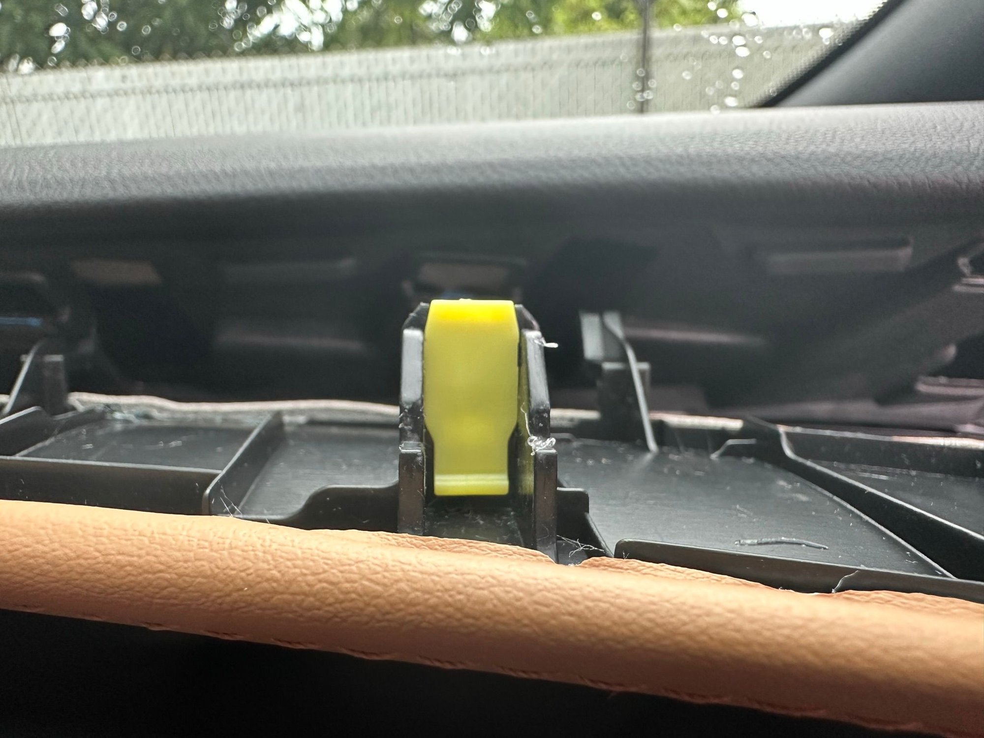

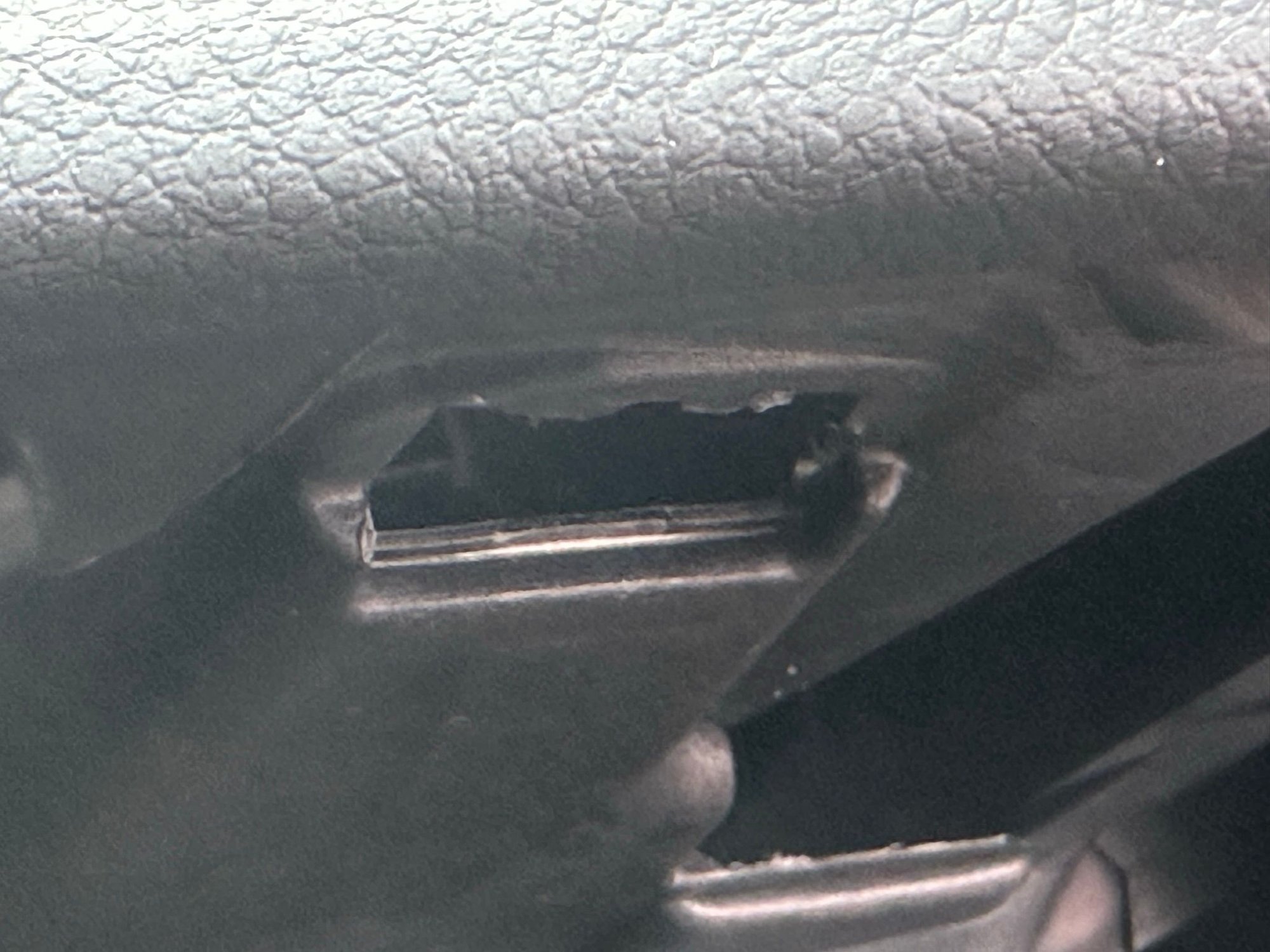

clip receptacle
good clip on the far right that actually clips
defective clip that does not have the side flares
The side flares are actual parts that create the friction necessary to hold up the piece. That's why the double sided tape on the top of the trim piece doesn't work long term. It's the middle of the piece that is sagging outward
