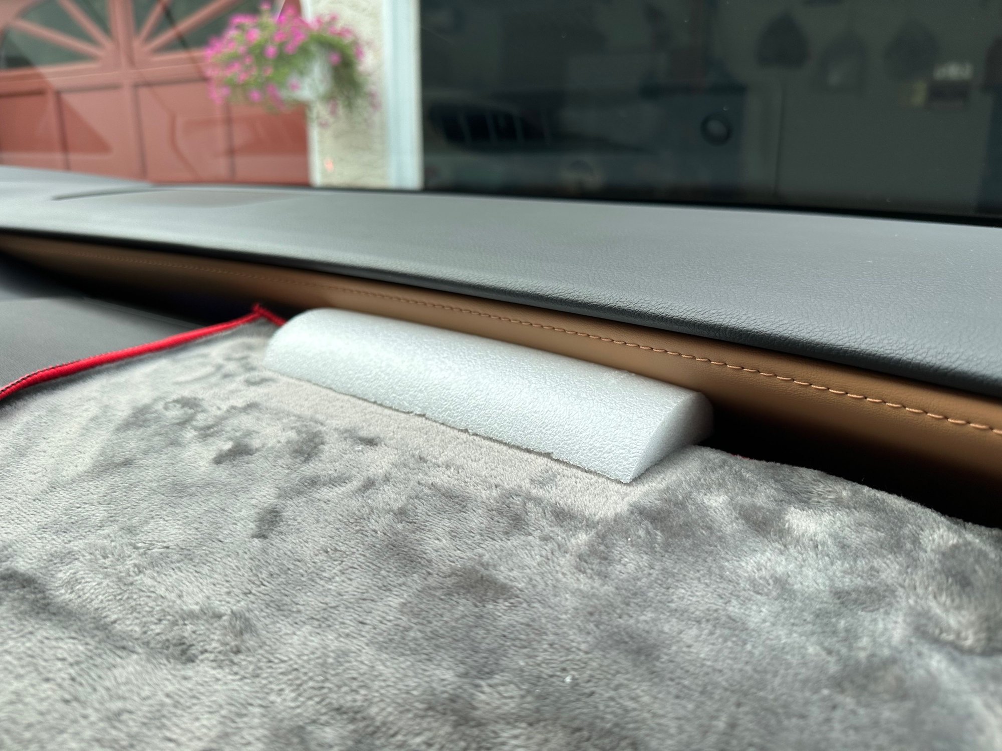

Mine looks identical to your excellent photos. I agree with everything you stated. 24 hours ago, I tried Gorilla Glue Clear Grip (similar to E600 and Goop) applied liberally to the front back and sides of the 3 middle clips, plus the inside of the relative receptacles, then pushed the leather trim tight against the upper "garnish" and held it in place with a piece of wedged styrofoam (protecting the dash - as shown in photo) for 2 hours. Today there is zero gap (even had a small gap right after trying double sided tape) after the car in 90 degree sun all day. If this doesn't hold then I'm done, as this glue is pretty tough.

Seems the glue is acting as the missing flares while also bonding to the receptical.

Update: More than 48 hours and glue still holding tight. At this point, will only update if it fails.
