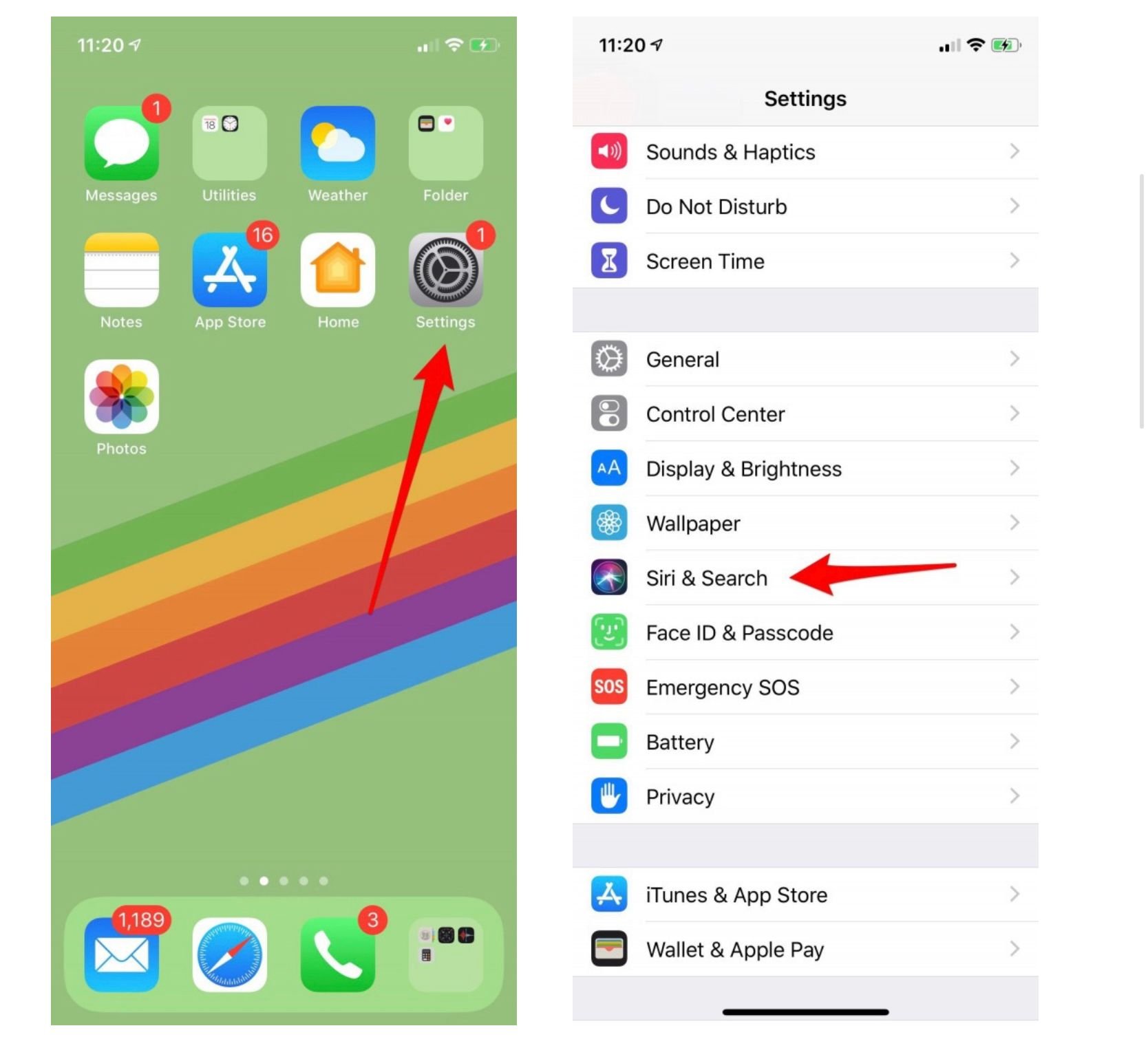

Try delete your phone from the infotainment system, and then pair it again with the car.
Thank you. This partially worked. Receiving and making calls is no longer fubar. Apps will still not open via Siri. I did ensure that the Do Not Disturb is turned off.

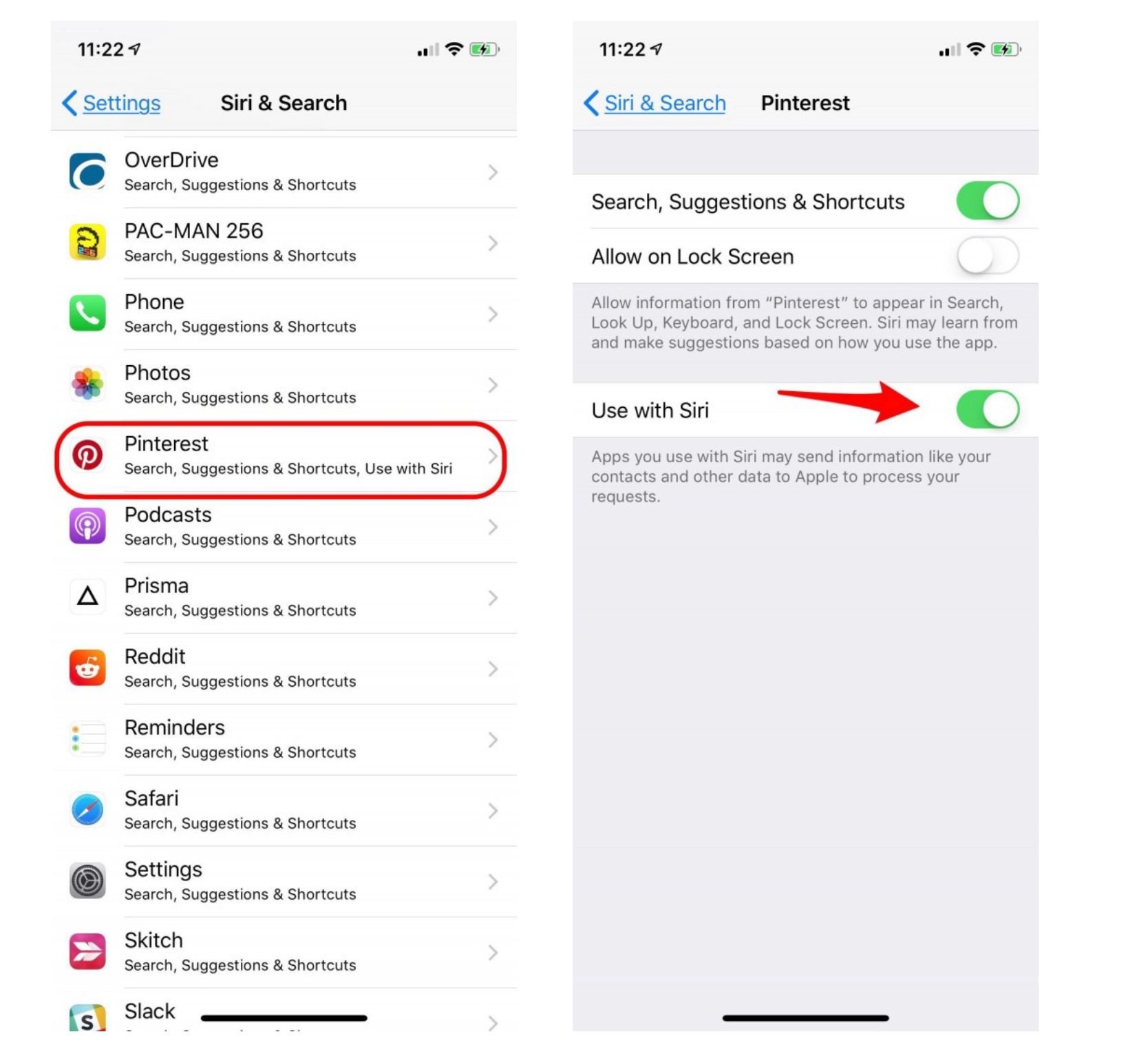

can you make phone calls with siri? If yes, check if the app you trying to use has siri enabled.

^^^ Thanks, yes able to make calls with Siri. Also, it is enabled on the Apps. It works in our '13 LX570 but, not in my '15 RC F (opening apps).
