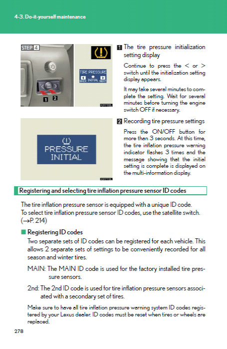

From what I've seen the ISx50. They come factory set up for main, and winter tire setups.
The same ID codes are registered on both setups. Problem is after you get a failure, and replaced with a new one. It wipes all the codes. So you're stuck with them programed only on the "Main" option.
Please refer to this post, and look at the link added there. It instructs on how to set up a dual set of TPMS. Your manual that came with the car should indicate this aswell. I suspect your TPMS is set on "2nd" while the sensors are programed to be on "MaIn"
https://www.clublexus.com/forums/is-...l#post11625420
Visual video how to access the settings.

Well, it seems with a curious mix of luck to judgement I have this sorted without a visit to a dealership.
The TPMS system hold data for two sets of tires, presumably summer and winter. The ECU setting was on '2nd' rather than main. I changed this and the warning lamp extinguished.
A visit back to Costco confirmed that they had programmed the two new sensors to the ECU so it seems all is well.
Shame that the Costco chap missed this minor point after all his hard work of fitting the sensors.
lexo98 - the sensors are EZ SENSE T2200 model. These operate at 433 Mhz. I have not encountered that actual wheel positions are indicated.
