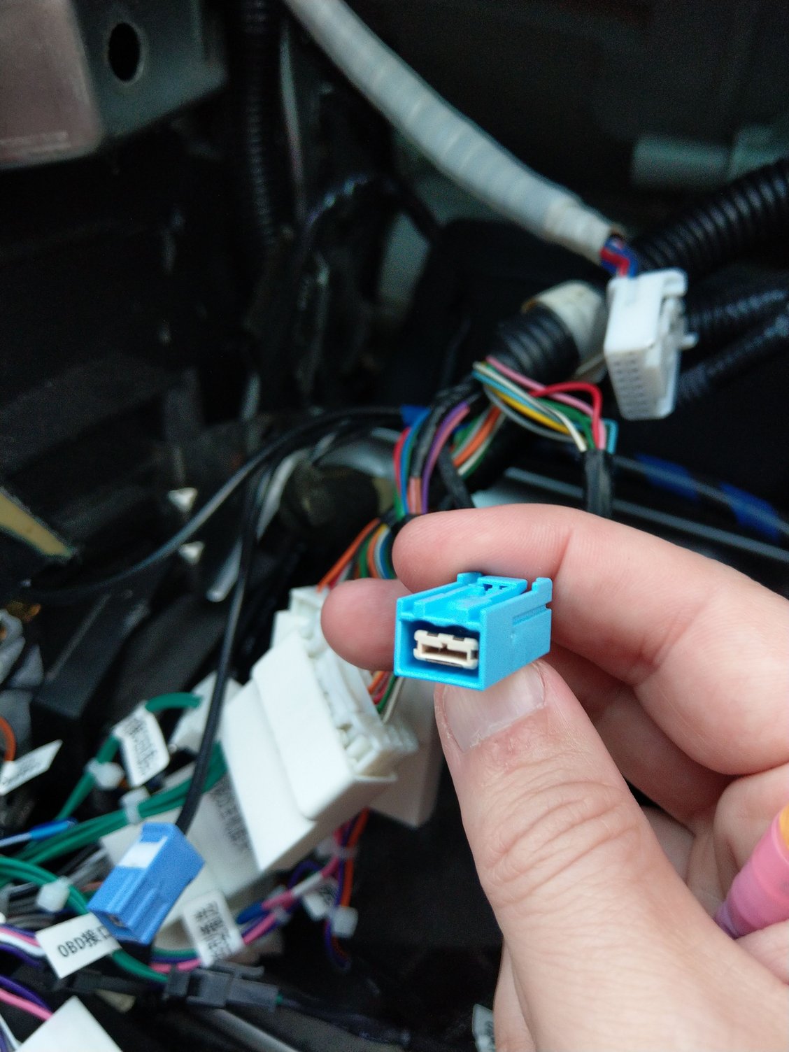

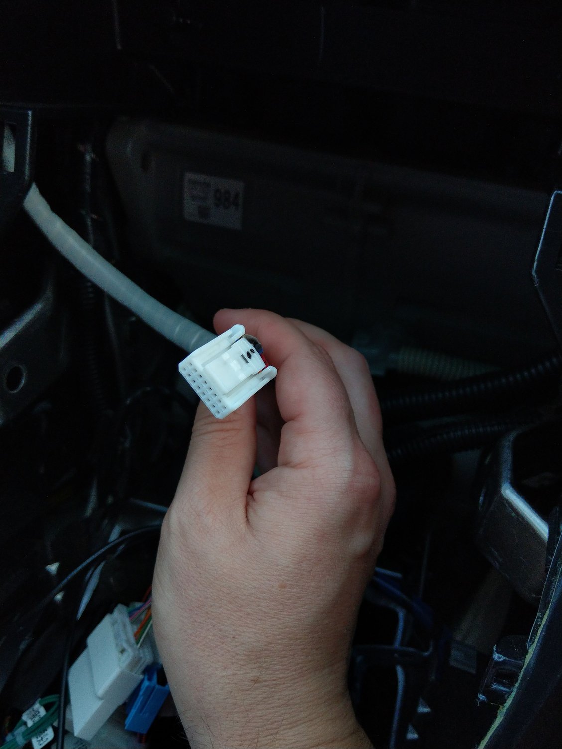

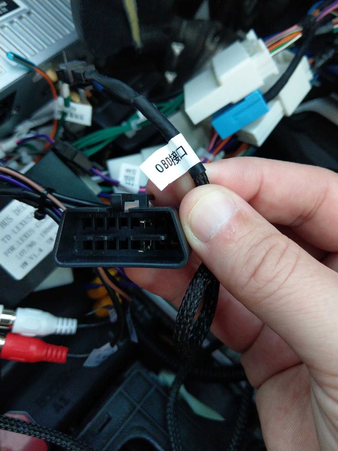

I don't see a lot of car data in the interface, such as MPG, speed, etc. Did I need to plugin the OBD connector (first image)?
The other connectors I have leftover were a white one from the top of the dash (second image) and two blue ones from the main harness. Does anyone know what these are for and if they should be connected?
I've no reverse camera. I was expecting that to be plug and play but looks like I might have to splice it like in that other post on here.
