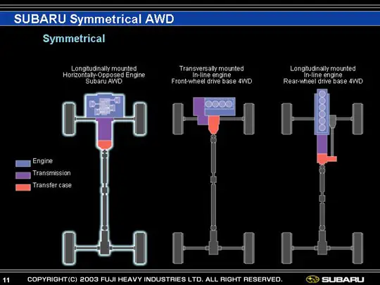

Sorry, but that limb would crack. I had an Outback for almost six years.....and my brother, before his Kias, had an Impreza for nine years. Totally different AWD set-up from the car-based Toyota system with transverse-engines. The Subie system (although there are several different versions of the Symmetrical Subaru system) is based on a flat-boxer-engine and a rear-facing output shaft, not a transverse engine with the transmission off to one side.
This diagram (which I have also previously posted in other threads) graphically shows the different systems pretty well.

Did you read what Striker said? Like I said you have no idea the size of the AWD components. He does.
Even from your diagram, the Subaru system is much larger than the transverse FWD system.

Yes, I did read what Striker said....but that does not change the fact that the Subie Symmetrical AWD system is arguably the most successful car-based AWD ever done. And that is because it is simple mechanically and works well.
Either way, the topic of our discussion (Camry V6 and AWD) would not be possible with a layout like Subaru's, because the Subaru layout designed for boxer-engines with a rear-facing output shaft. Toyota, however, DID use the Subaru engine and layout for the RWD 86 sports-coupe....minus the two front drive-shafts, of course.

Bro you need to go under a subie, the axle shafts are BEHIND a diff housing BEHIND the bellhousing, the engine is NOWHERE near the front axles like that in your diagram. That's how AUDI does it not Subie, Subie has the engine PAST the front of the tires entirely and even in your own picture look how much smaller the FWD based system is! It's practically only the size of the engine ONLY for the Subie lol!

Way larger......it's longer than the system in my A8s by far. Even the smaller WRX system is still very long, the newer CVT systems are HUGE and very unusually tall due to the stacked shaft setup. Are they easy to work on and simple? Yeah! However they are not space efficient vs a FWD PTO style system nor can they withstand the power output levers of RWD based systems like the 800+ LB/FT that Audi ZF8 can for example.
https://www.ebay.com/itm/334934546406 (note the driveshaft passing THROUGH the bellhousing and the TQ converter still being sat behind it and the combined casting for diff/trans/T-case to save on size/weight and increase rigidity while still being fundamentally a RWD trans based configuration)
https://www.ebay.com/itm/265768640452 This is best case for Subie, manual WRX setup that is the smallest
https://www.ebay.com/itm/125905378007 Very tall and fat.....
https://www.stanleysubaru.com/blog/2...ansmission.htm
Another fact to consider is that the diff being on the passenger side vs symmetrical is a GOOD thing since it helps cross balance when you sit on the left side to drive the car and provides an area for lines/harnesses to be run on the other side as well as easier time working on the diff in the event of an error/failure. If I loose a diff in my Touareg or Audi I can replace the diff/replace the gears/bearing in car but you loose a diff in a Subie you just bought a transmission. All that said I will still pick them over a FWD based system since everything still points the correct way and so much easier to work on.

That wasn't what I was getting at, though. Yes, the Subie flat-boxer engines are ahead of the front axle, which may affect overhang some (which, IMO, is a non-issue) but it is a simple, effective, no-nonsense system that has worked well for many years. That's why Subaru keeps the basic layout, although they have made some changes over the years, such as the substitution of electronic torque-distribution for the old mechanical rear limited-slip differential.
