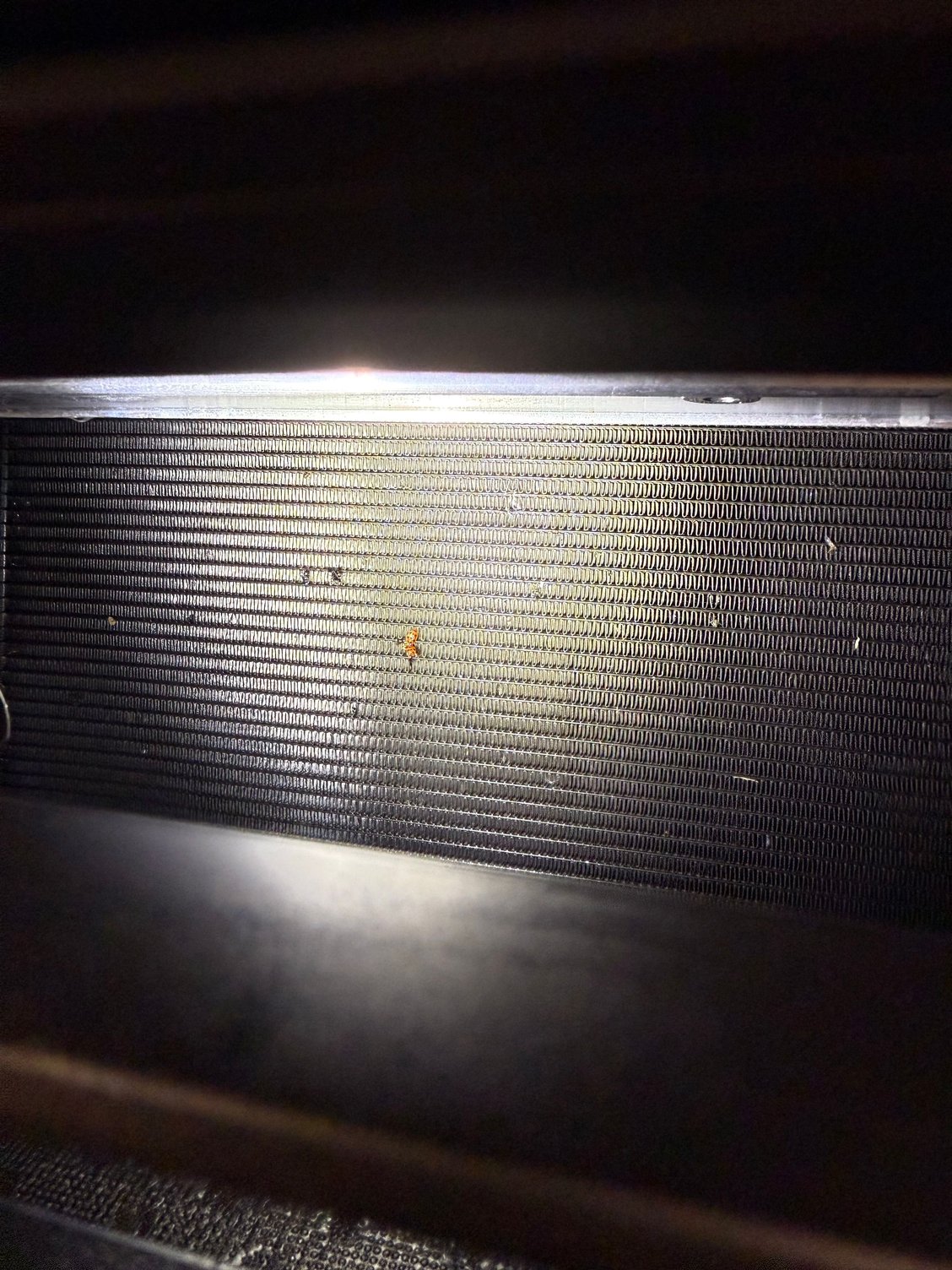

the same thing happened to me. my lexus tx350 luxury had 900 miles on it when I noticed the ac was not cold. living in the south we rely on air conditioning. took it to lexus, they called to say exactly what I read and learned about on this forum. (before taking it in I googled the issue-road debris caused the condenser to leak. (see attached) my dealership said they have two more in the shop with same issue. they asked me if I would agree to being a guinea pig and allow them to add a screen behind the grill. lexus said it would be $2500 to repair my car and I nicely let them know this sounds like a products liability case and i’d be happy to be the first named plaintiff. sadly I think it will happen again.
