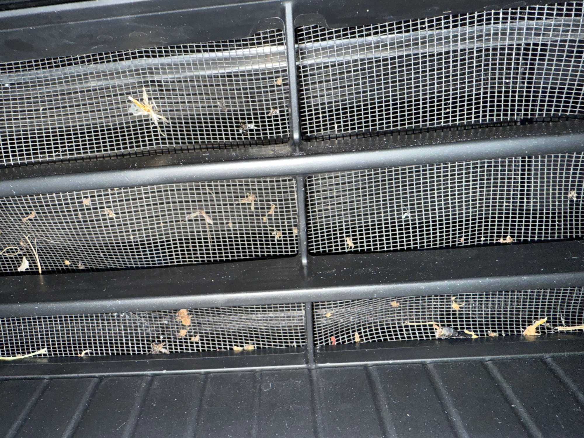

Question AC condenser fail
I have a new 2025 TX350 AWD/Luxury purchased 2.5 weeks ago. The AC fail was caused by a rock/road debris puncturing the condenser. Dealer is telling me the repair cost is $2,100. and not under warranty because it was hit by a rock and considered an "outside influence". From reading this thread it's obviously a design flaw that Lexus needs to address.

Wonder if this would work better since screen is rigid, M-D building product 24x48” expandable Aluminum sheet in black: Home Depot
internet # 205058570, model # 57398 UPC #: 043374573985 $50

Question Install procedure?
Originally Posted by Blindbaby
After reading some condenser issues with alleged road debris and such, looking at the current design, it appears the condenser is a prime target for garbage off the road - straight shot in. A quick trip to Home Depot for some replacement screen and black zip ties. Looking at the selections of screen I opted for the "pet resistant" as it is a heavier weave but a coarser mesh theoretically allowing more air through. Cut a piece 36"X8" to allow for 1" double fold on top and bottom, used my soldering iron to pierce holes for the zip ties and put it in place. The screen is essentially invisible behind the grill work. Tests are ongoing but initial results are very positive. $18 for the screen (36"X84"), $11 for the zip ties (100 count - replenish my stock), 4 mosquito bites, 15 minutes install time. Heck of a lot cheaper than $2k and battling with Lexus Corporate. That's my 8% of two bits on the subject, your results may vary.
Can/could you explain the procedure you performed to install the screen protector, please. I notice all the fastener points of plastic top cover under hood, I’m considering using metal screen material. TYIA

Default Diy from lowes
Hey all, seems like too many people are getting condenser leaks from the wide open grill at the bottom, went searching at Lowe's and I think I found a decent solution... The mesh is a bit more fine then I think the job needed but there should be some decent air flow still since the sides are wide open.
Atlas gutter guard stainless 3' by 5". All I had to do is drill some holes in the gutter guard frame and zip tie it to the grill. You have to take off the under cover and slide out the foam bumper cushion to slide it into place.
