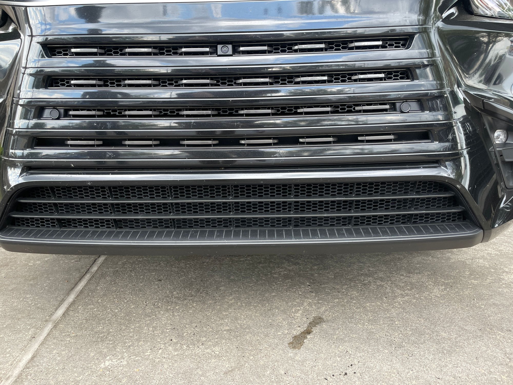

After having lost AC with a 6 month old car, I cannot speak more highly of our dealership in Lexington, KY. The dealership not only replaced the condenser, but also installed a grill we bought off Amazon that was recommended in an earlier post. Really satisfied with how they worked with us, even giving us another TX350 as a loaner.
What a service! Thank you Lexus of Lexington.
far exceed our expectations. Hope other dealerships will follow suit with exceptional service. Here is the final look.

Nice clean look. Waiting to see if bottom grill mount face can be removed w/o removing entire front grill bumper assembly. Local dealer said maybe not.
Room on top shroud to install behind top grill.
Bottom grill opening looks like a huge shovel to scoop up bouncing rocks into the condenser area…….

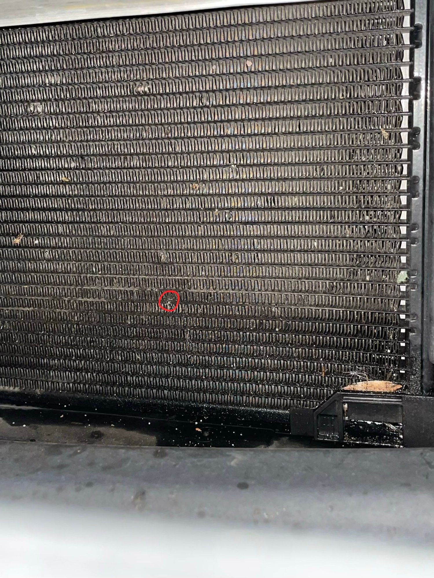

We must be the “luckiest”…this is the second time this has happened to our 2024 TX. I mean, what are the chances that a rock flies up, through the front grill and hits the condenser?
First time it happened they literally showed us the rock stuck in the condenser grill. We put in a claim with auto insurance (comprehensive covered it) but it still cost us the $500 deductible. At least we weren’t out of pocket the additional $1500.
This morning we brought the car in because the AC stopped working while we were away this past weekend - it’s a good thing the weather has been cool! The repair shop just sent us a photo of a “pinhole” in the condenser. Two times with a similar issue is no longer a coincidence. Seeing multiple other people with the same issue smacks of a design flaw.
We will also file a complaint with NHTSA.
Pinhole circles in red.
Pinhole circled in red.
