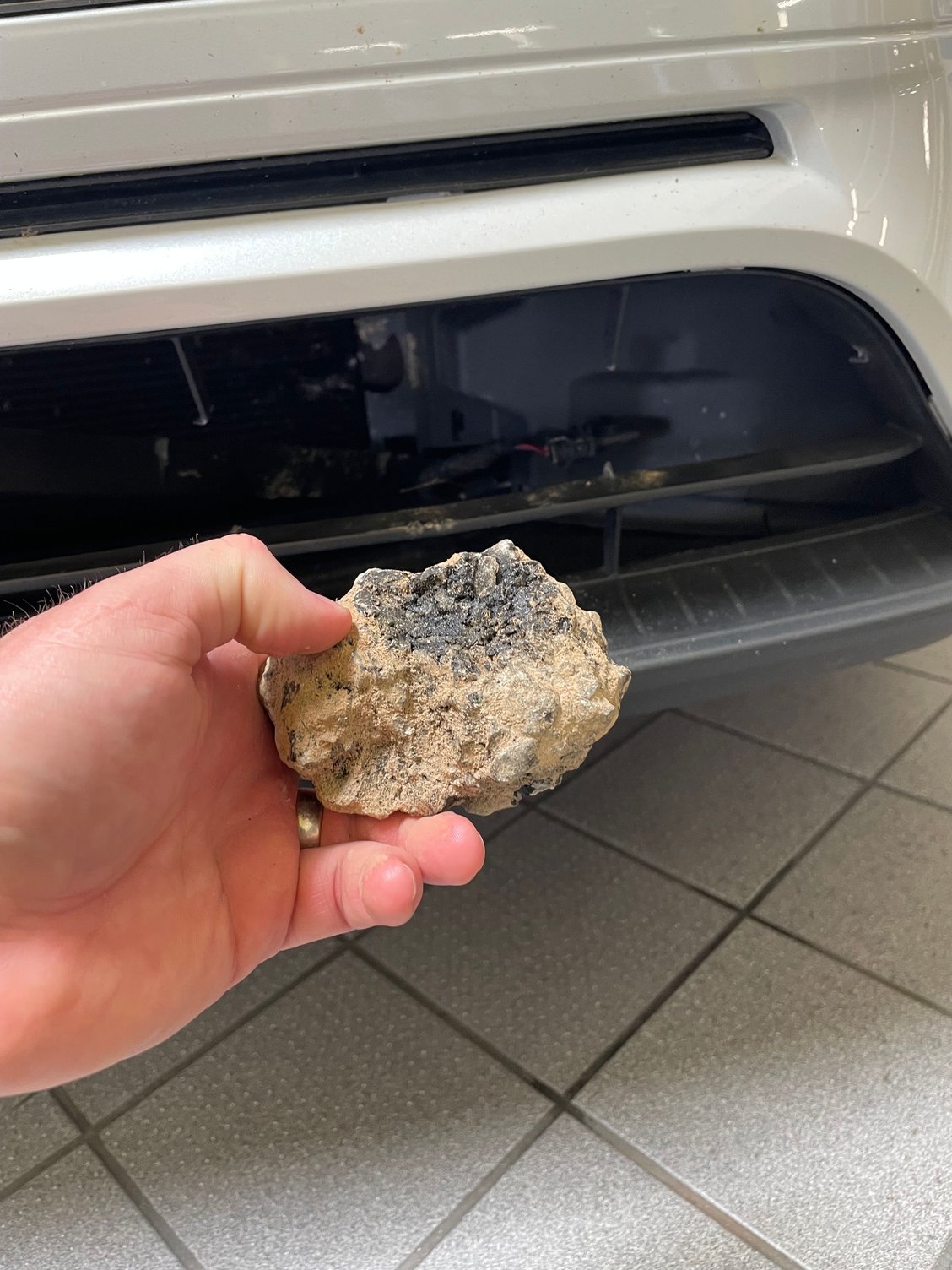

Took the TX in and they found a rock that busted through the plastic fascia and destroyed the condenser. I called Lexus and asked for a goodwill repair and they denied it. Clear design flaw

"A rock went through the grill and damaged the A/C compressor." Our dealership originally quoted $3300 to fix/replace it. I showed them this thread and they agreed to fix it for $2000.
Something is going on with this. Either a major design flaw or a racket. We live down a long gravel driveway...if this happens again, this TX is going bye-bye.
