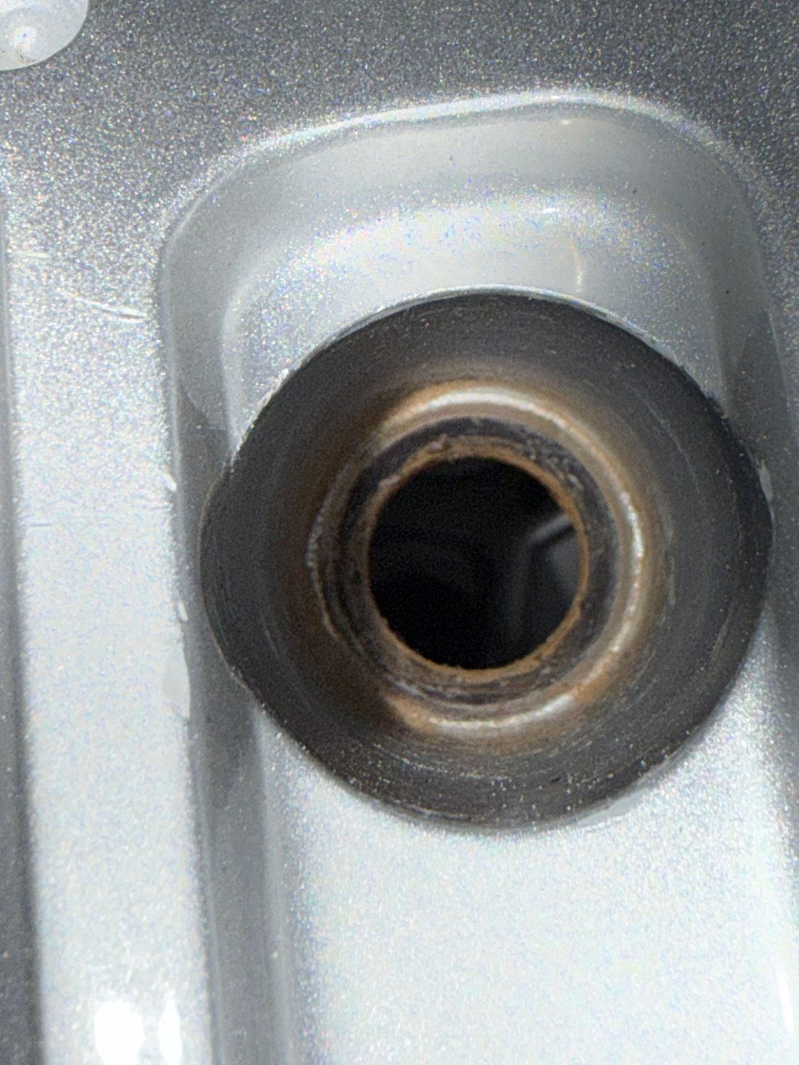

here’s the shot of my winter tires.
Old Nov 27, 2024 | 09:11 AM
  #234
SKGX's Avatar
SKGX
Joined: Aug 2021
Posts: 189
Likes: 118
Can't see that well into the Lug Bores, but they do look like they are driledl cone seat.
Old Nov 27, 2024 | 12:36 PM
  #235
GeneralKlinger's Avatar
GeneralKlinger
Joined: Apr 2024
Posts: 73
Likes: 34
does this help?
Old Nov 27, 2024 | 05:03 PM
  #236
SKGX's Avatar
SKGX
Joined: Aug 2021
Posts: 189
Likes: 118
Looks like cone seat. It's hard to tell still.
You could email Vision and ask to confirm
