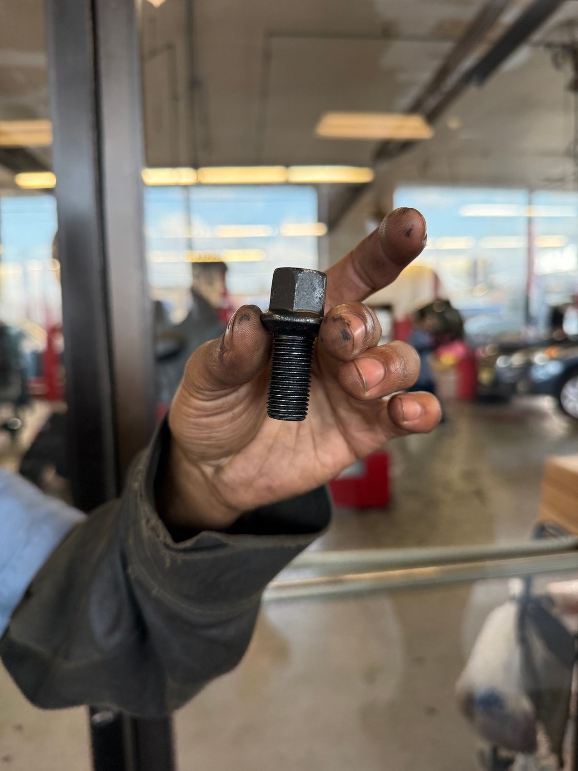

Question for you Winter Tire experts. Took my wife's RX 450h+ to Mavis Tire today to swap her factory 21's with our Blizzak's mounted on 18's that are confirmed fit, but ran into an issue with the bolts not working. The aftermarket wheels came with bolts but those don't fit on the Lexus. I assume because these were last on our Toyota Highlander.
Has anyone actually had success with the bolt conversions that were previously mentioned on here? I'd really rather not drop $2K on a new set of tires/rims vs getting the correct bolts that go with these rims (Vision)

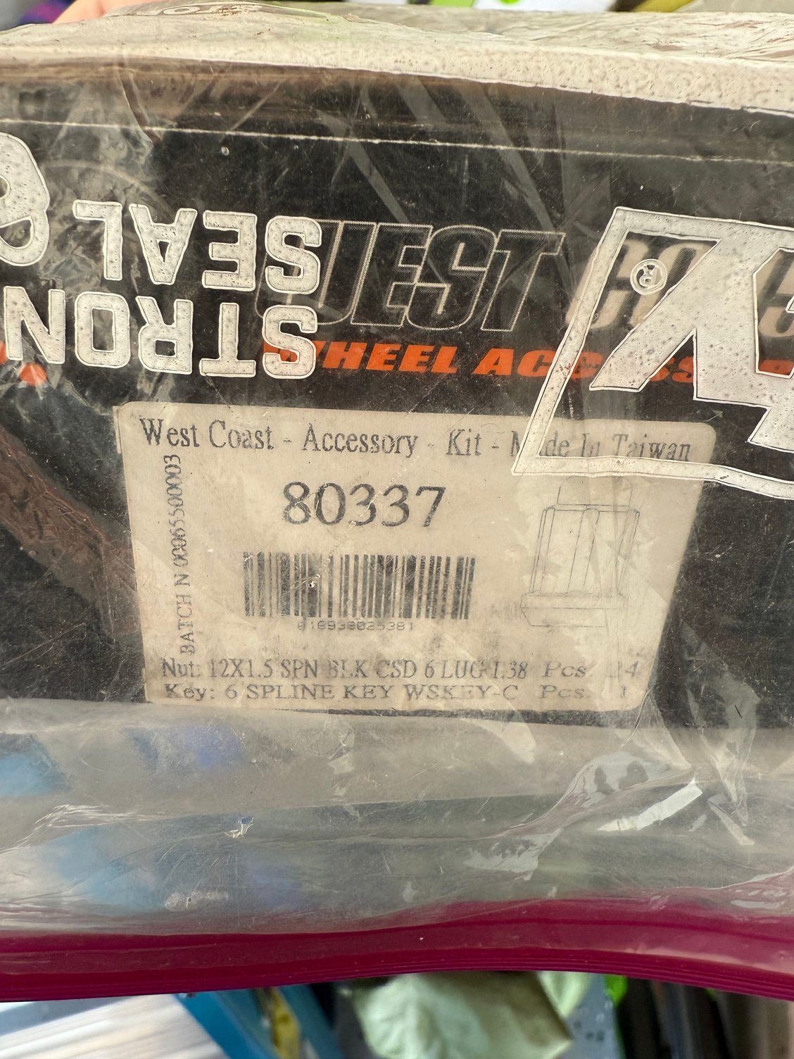

I’ll be the first to admit I couldn’t really understand what they were talking about. The wheels went right on the existing Lexus stems. However, my wheels came with the kit below
those are what don’t fit on the Lexus stems. They told me I’d need something closer to this
so the box says 12x1.5 and I understand Lexus uses 14x1.5, so that’s why I was trying to look up a 14 to 12 conversion.
I have been unable to reach the Discount Tire store I bought from out of state. No idea why they aren’t answering. In the meantime, I figured I’d ask on here.
I also know the factory Lexus nuts won’t fit with the wheels. The holes are too narrow I guess.
ideally, I’d like to just keep reusing this set of wheels and tires, but if finding the correct parts to make it work is not gonna happen, I’ll buy new ones I guess.

Highlander has wheel nuts with flat seating surface.
New RX has wheel bolts of different diameter and a cone shaped seating surface.
As far as I know there are no 14mm diameter wheel bolts with flat seating surface from a reputable company that I would trust my family's life with.
There are some no name off shore bolts, but I personally would not risk people's lives for few dollars.
