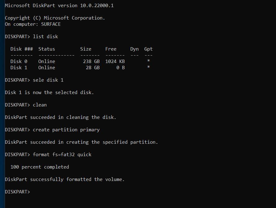

Try the below first using one of the USB stick you have;
Perform FAT32 quick format using diskpart
Step 1. Open your computer, and on the desktop, press the "Windows + R" at the same time to open Run box. And type “diskpart” on the box, and press Enter.
Step 2. When the Diskpart window opened, type the following commands, and press Enter after inputting each one:
list disk (n is the disk that contain the target drive)
clean
create partition primary
format fs=fat32 quick
Wait for a while, when the format is finished, type “exit” to leave diskpart
Then copy the downloaded file to your USB drive.
The file name that I downloaded is Android10_20210909.17_carsyso_lexus_nx.android10.img
clean

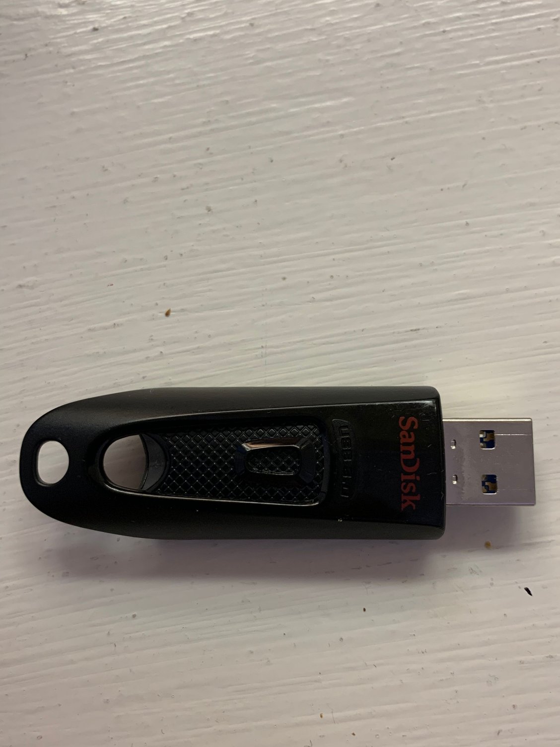

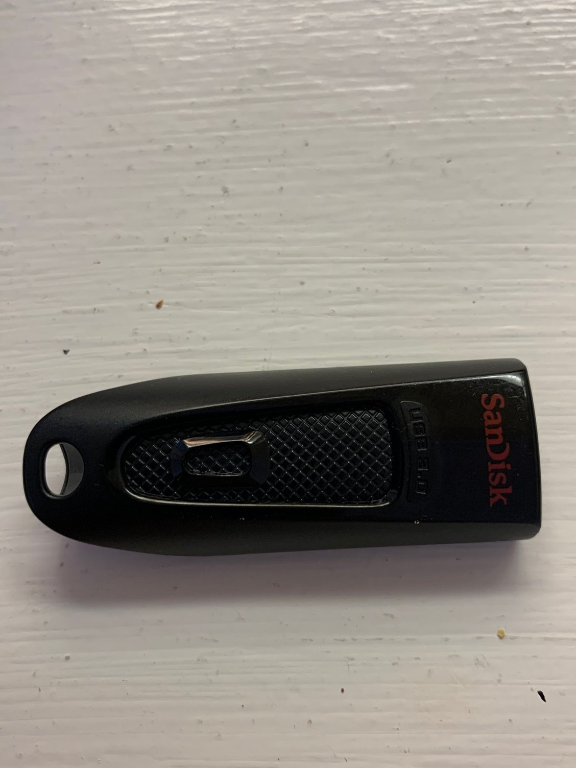

Originally Posted by undergrou6
Yeah I insert it in that port and follow your instructions and it doesn’t read usb drive for some reason.
can you share which usb stick you are using and see if that will work for me?
Sandisk 32gb

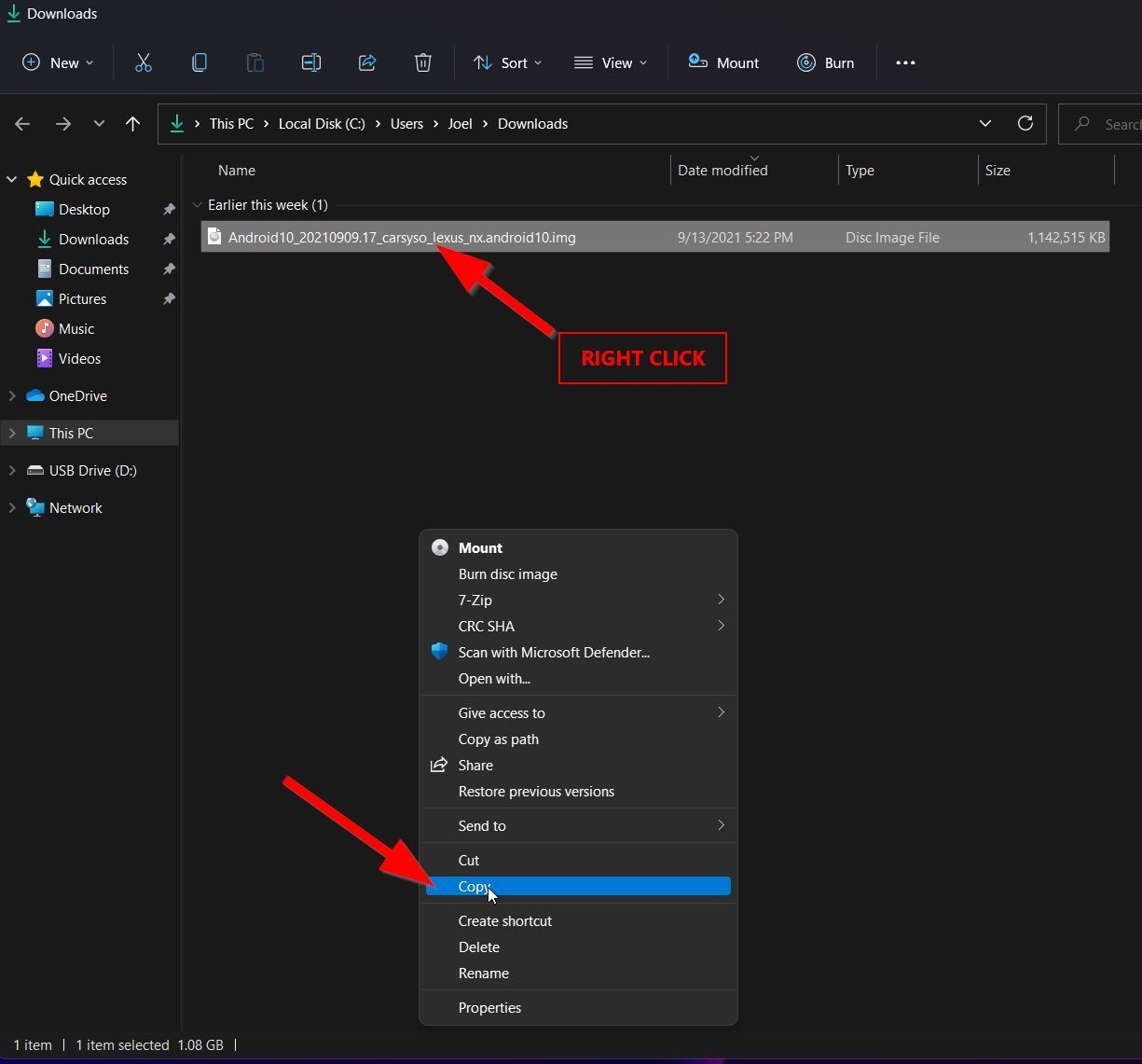

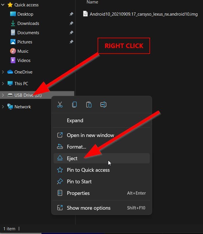

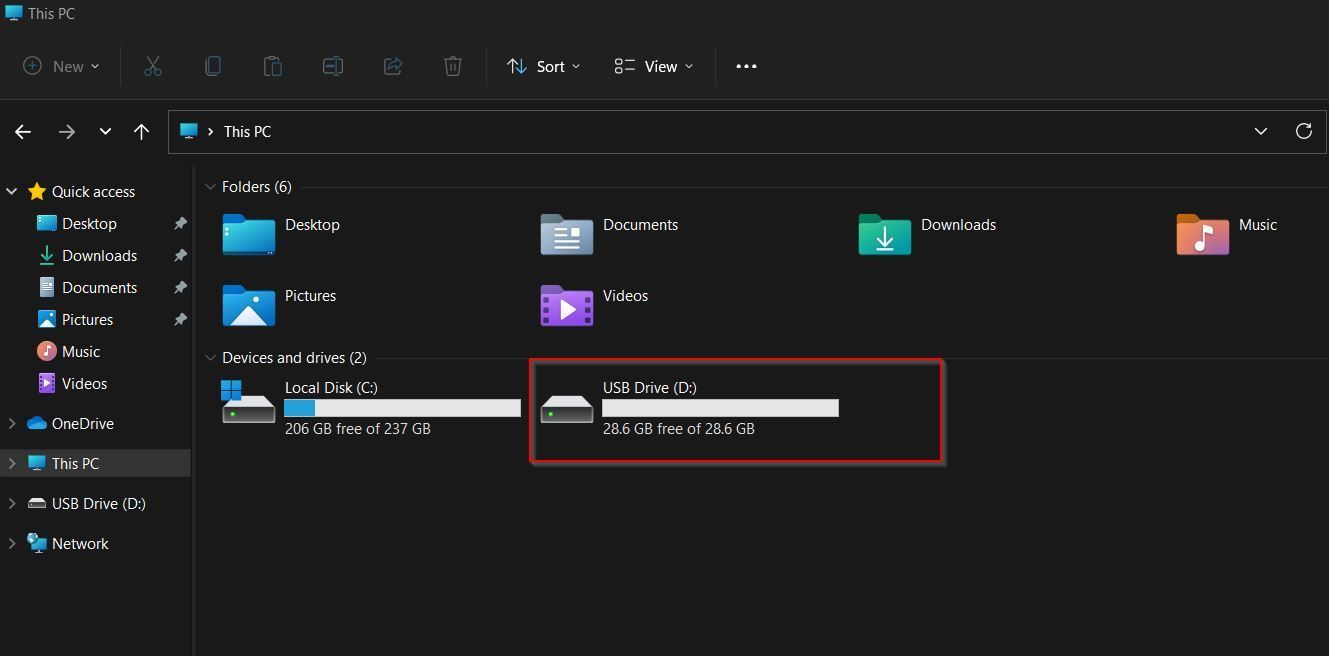

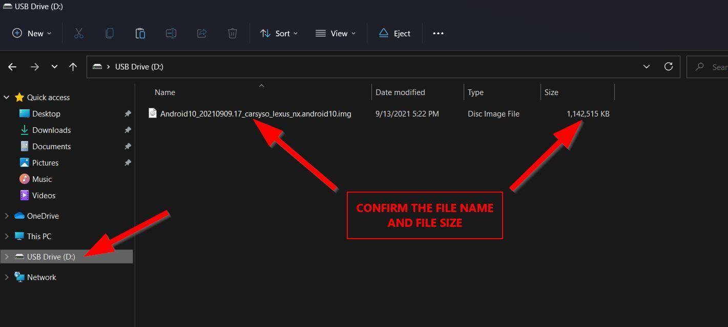

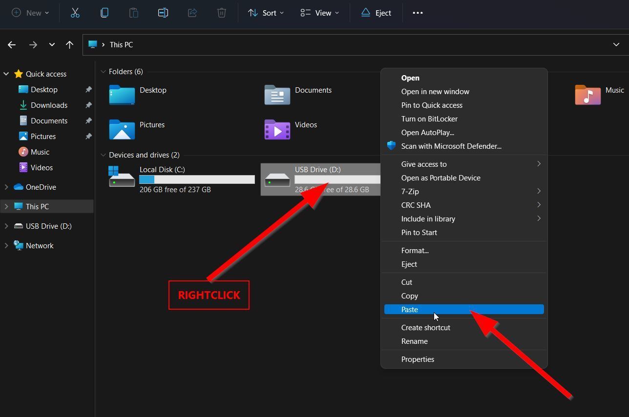

Preparing the USB stick.
1. Insert USB stick to your computer.
2. Follow DiskPart commands below
3. Open Windows Explorer. Check and confirm USB drive is visible with only one drive letter assigned.
4. Go to the downloaded file location. Right click the file and select Copy. Make sure the size is around 1.14GB.
5. Right click on USB drive and select Paste. Wait for the copying progress to finish.
6. When copying process is done, double-click on the USB drive to see the contents.
7. Right click on the USB drive and select Eject. (don't forget this part for it may corrupt the USB partition when unplugging the USB stick)
